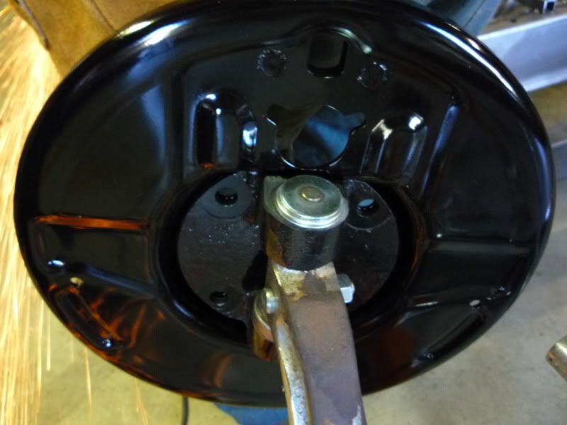

    Painted the 39 Lincoln backing plates, and machined the spindles to accept them. Mmmm...nice fit.
    Installed all new self energizing internals with 2" shoes.....stops ona dime, and picks it up too.
    Only the best....
    Bearings and races installed, and on the car they go....
    mmmhhhhmmm.......

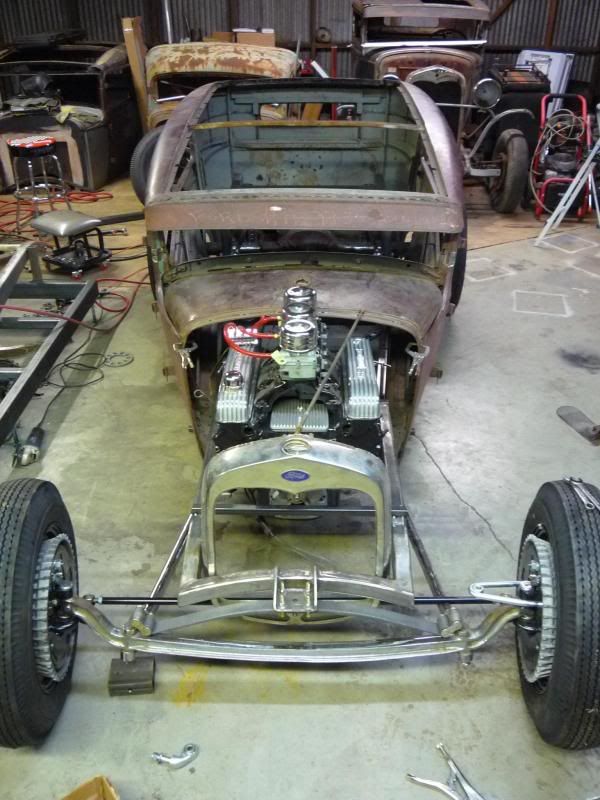

    Got the motor set in and mounts welded in.......
    sorry about the ****py phone pics, forgot the real camera at home.

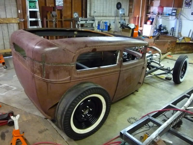

    I've been pluggin away at this thing trying to get it done (or close) for the Hot Rod Revolution in September.
    Wheels and tires mounted, rear suspension finished, front suspension finished, brakes finished and body cut up and mocked onto the frame. Rear tires are too close for comfort, so some new spacers will be in order.
    The motor will be heavily recessed (as you can see) and the top part of the firewall cowl will be removable. The body will sit about an inch higher as well.

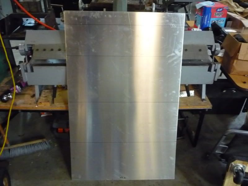

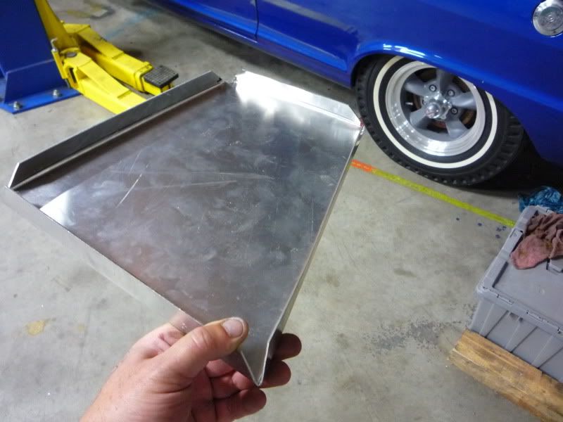

    Started building the 16 gallon aluminum tank.....
    Started with some 16ga 5052 Sheet...
    Annealed where it would be bent...
    Bent the main tank body all in one part (it was a bear getting it off the brake haha)
    Sheared off the end caps....
    bent the endcaps to shape....
    more tomorrow!
