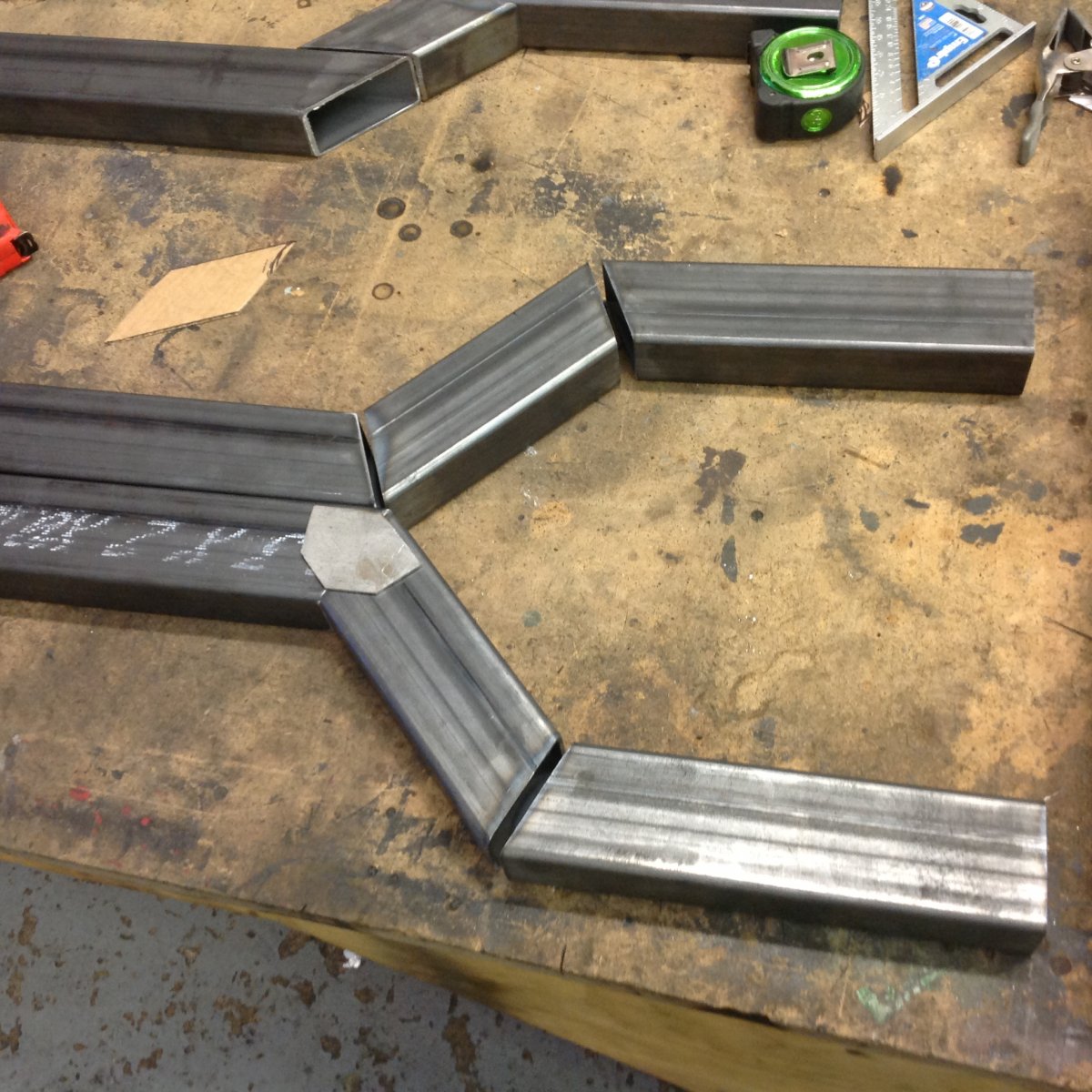

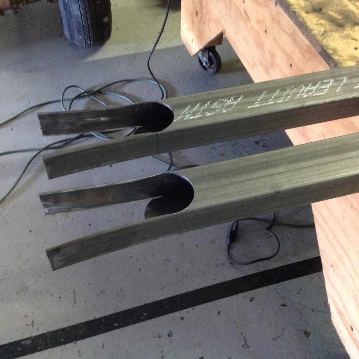

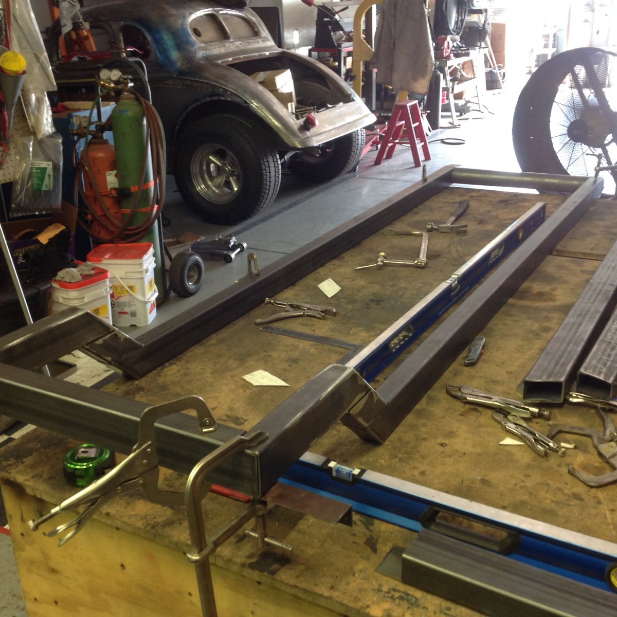

    Well let's cut up that tube and make a couple T bucket frames.
    One will be a straight frame- 26-1/2 with 45* joints and tube caps.
    The other will be a tapered frame 24" to 29" with meters and fish plates.
    I bet they are on Craigslist by the end of the day :)
    I'll post it in real time as it goes.

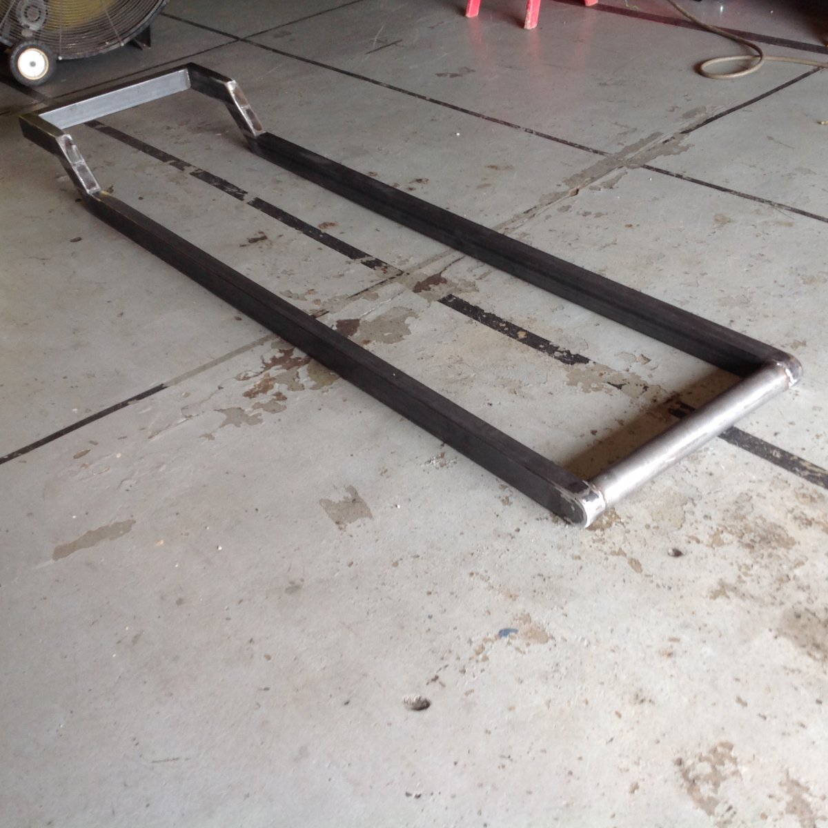

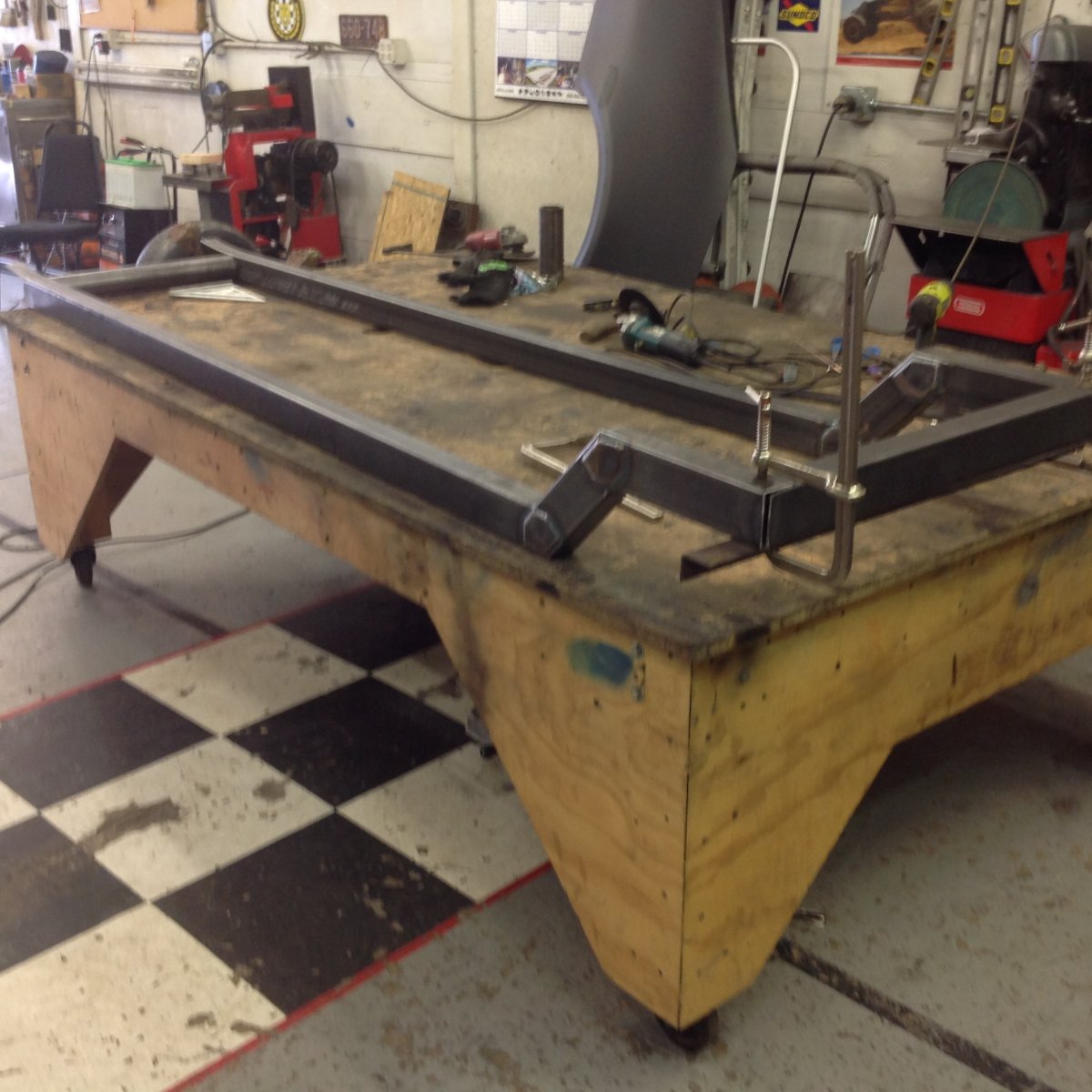

  6. First one done. Welded and ground - polished. Ready to go
    This is 26-1/2 straight
    Second one already under way.

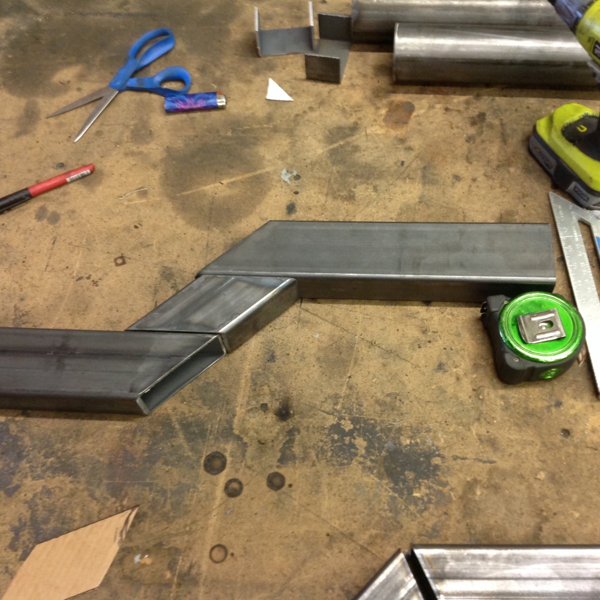

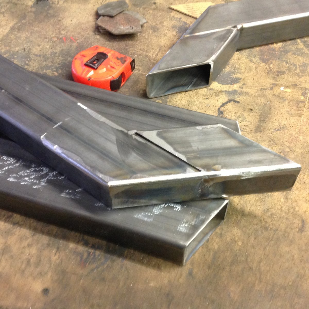

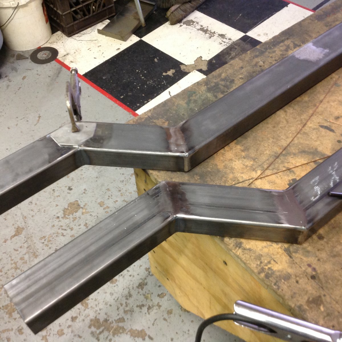

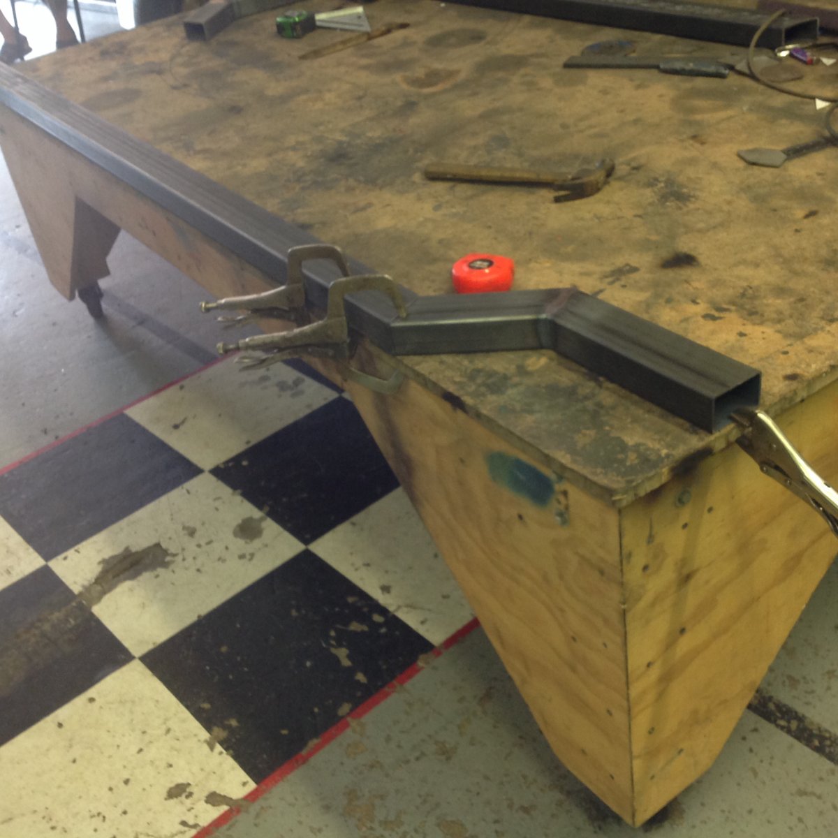

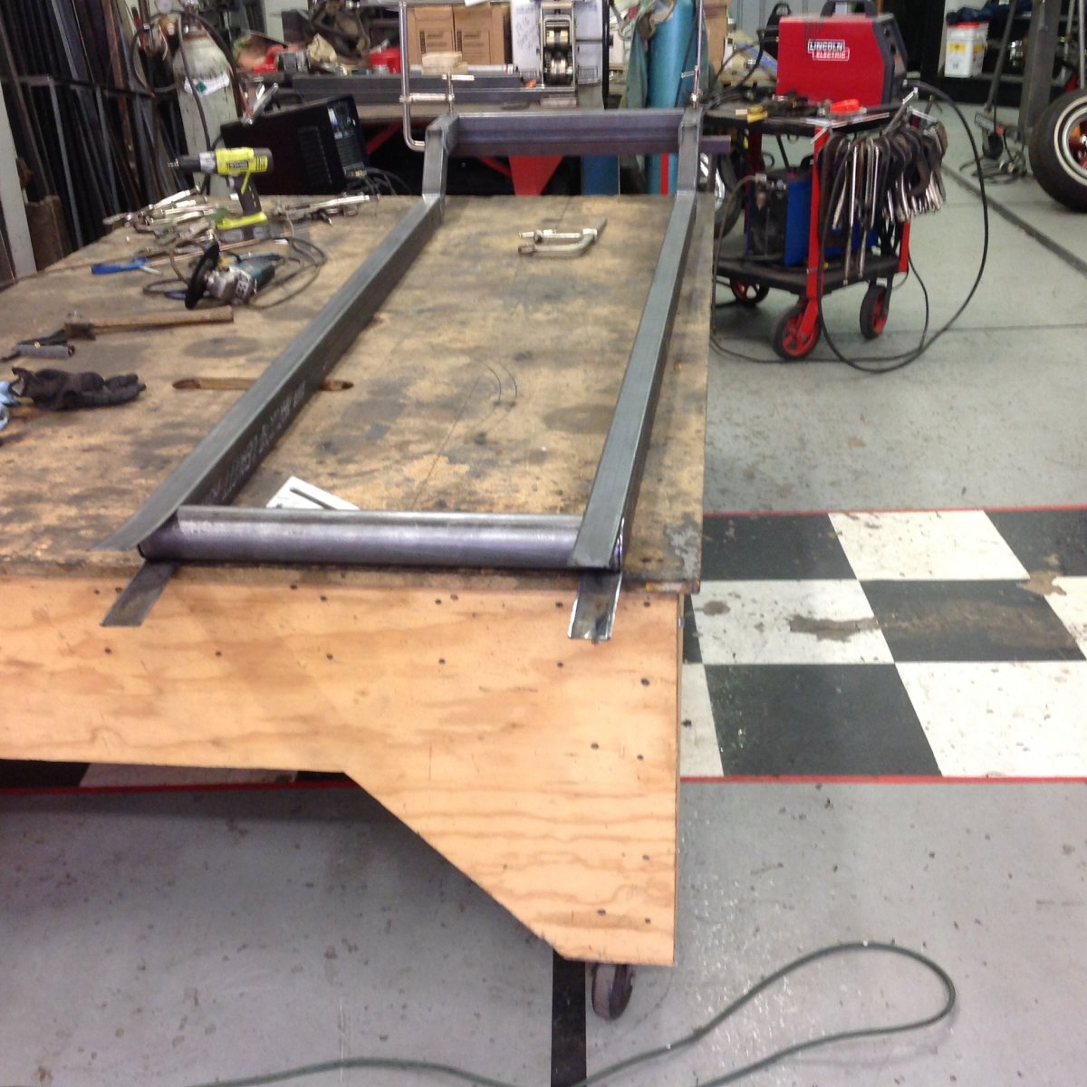

  8. Rails tig welded and ground down.
    These fish plates will take a bit x8

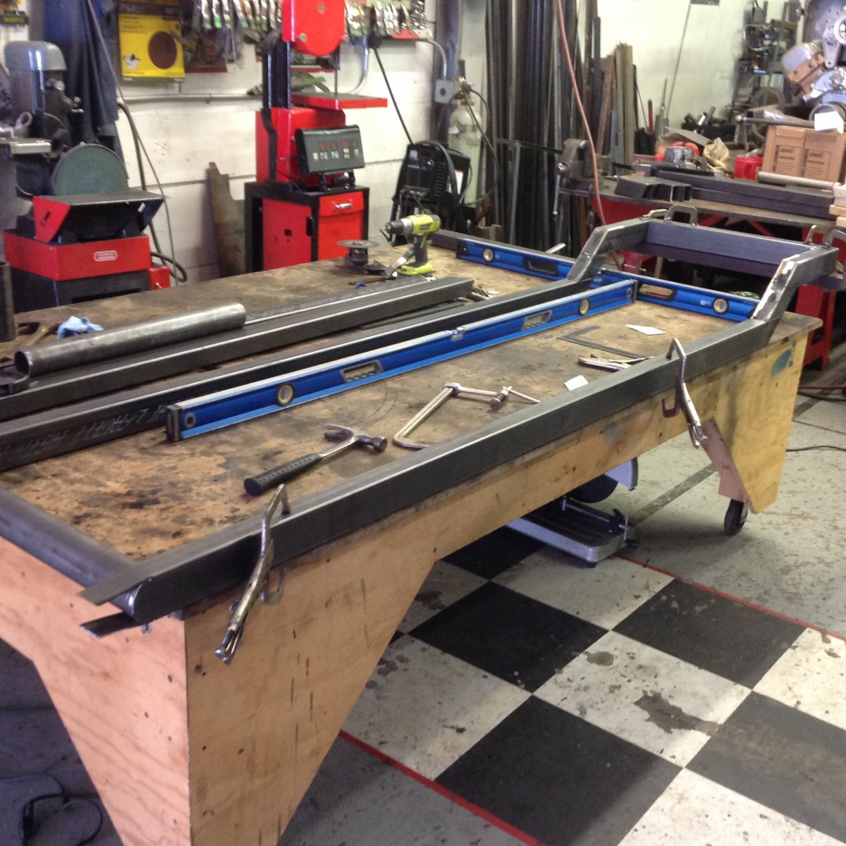

  9. 48 mins later
    24"-29" tapered frame ready to tack up.

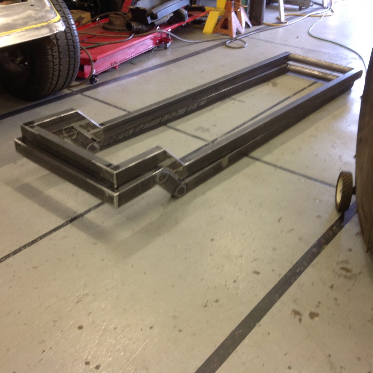

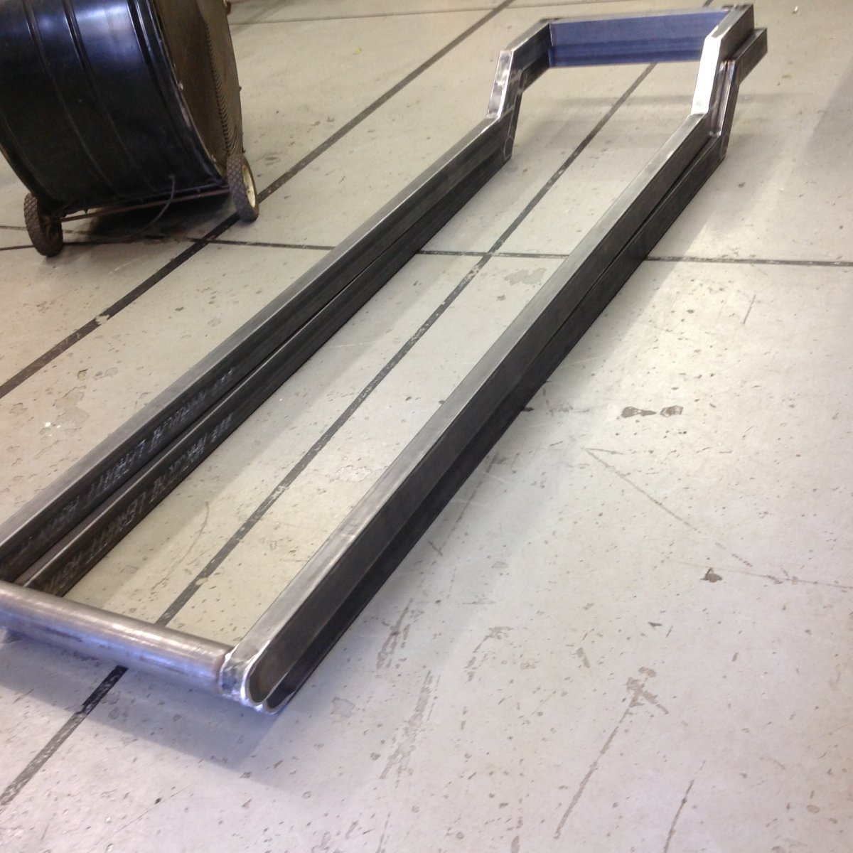

  11. Two done
    Tapered deluxe frame on the bottom. All tig welded because it a delux :p:p

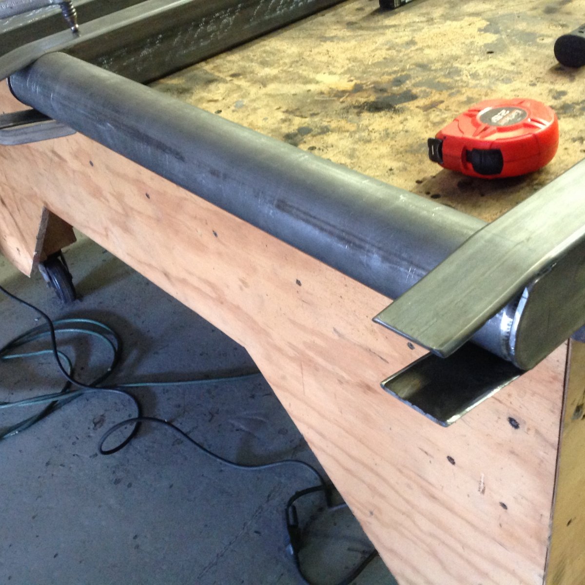

    AV8 Dave
    You do nice work! I like the way you extended the rear crossmember backside vertical ends to cover the open rear ends of the side rails. Makes a nice clean job! Regards, Dave.

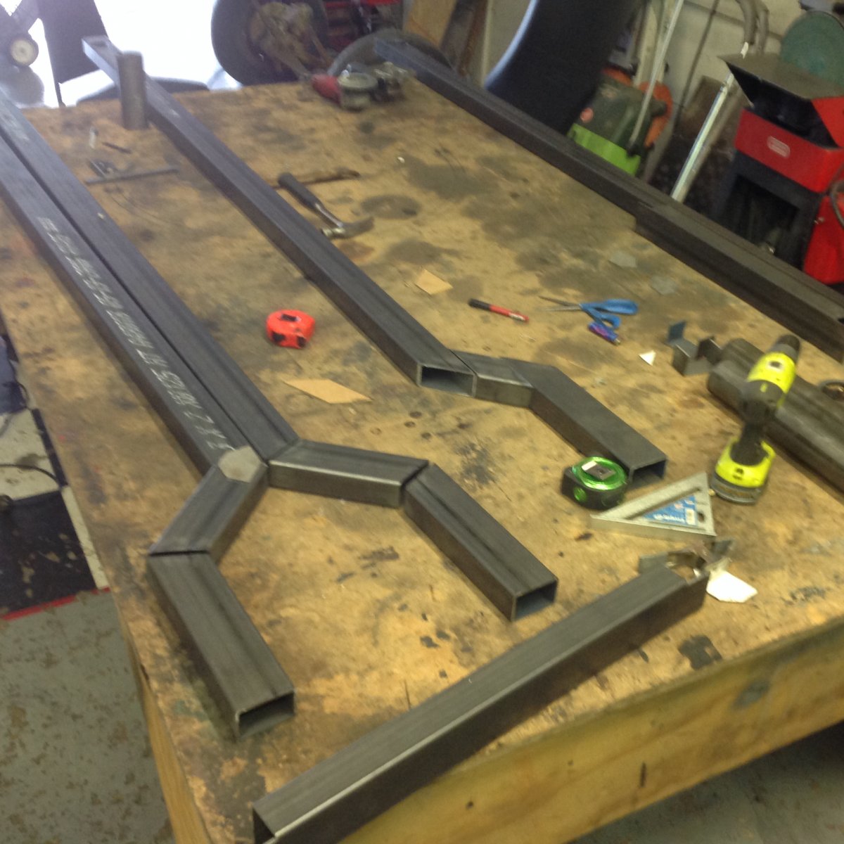

    I like you're wooden frame table. After a season of weld scortches you can just screw a new plywood top on and be like new.
    31Vicky with a hemi likes this.
  27. That's my "Everything" table. It's quite handy for just about anything.
    Very rare to find it empty.
    When doing more complicated frames there's a tube framework/ jig that sets on top.
    My steel table buts right up and makes it longer
