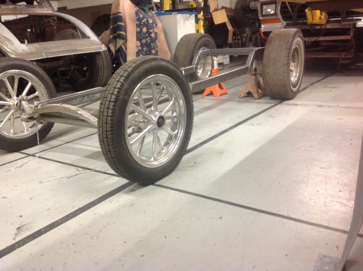

    Really nice work there, but wouldnt you have to put on a front spring perch to sell one? Just curious about market expectations - how complete do your frames need to be?
  4. Thank you !
    A study of what's available currently , well they are all over the place as far as price and included parts. It tough to make an apples to apples comparison.
    Some on the market have the perch and some don't. Some have only the perch added and some have 1 ,3, 5, 10 up to 25 extra parts welded on.
    Market expectations ? Fnck I was just bored.
    As far as the front perch goes, a generic fits all one can be added on easy enough. But what if it's not quite right for the Swap meet front end someone already has and needs to be moved up down in or out? Motor mounts are easy enough too but what if someone wants something other than SBC biscuits. Steering? Corvair, vega, cowl ? Rear suspension the same thing.

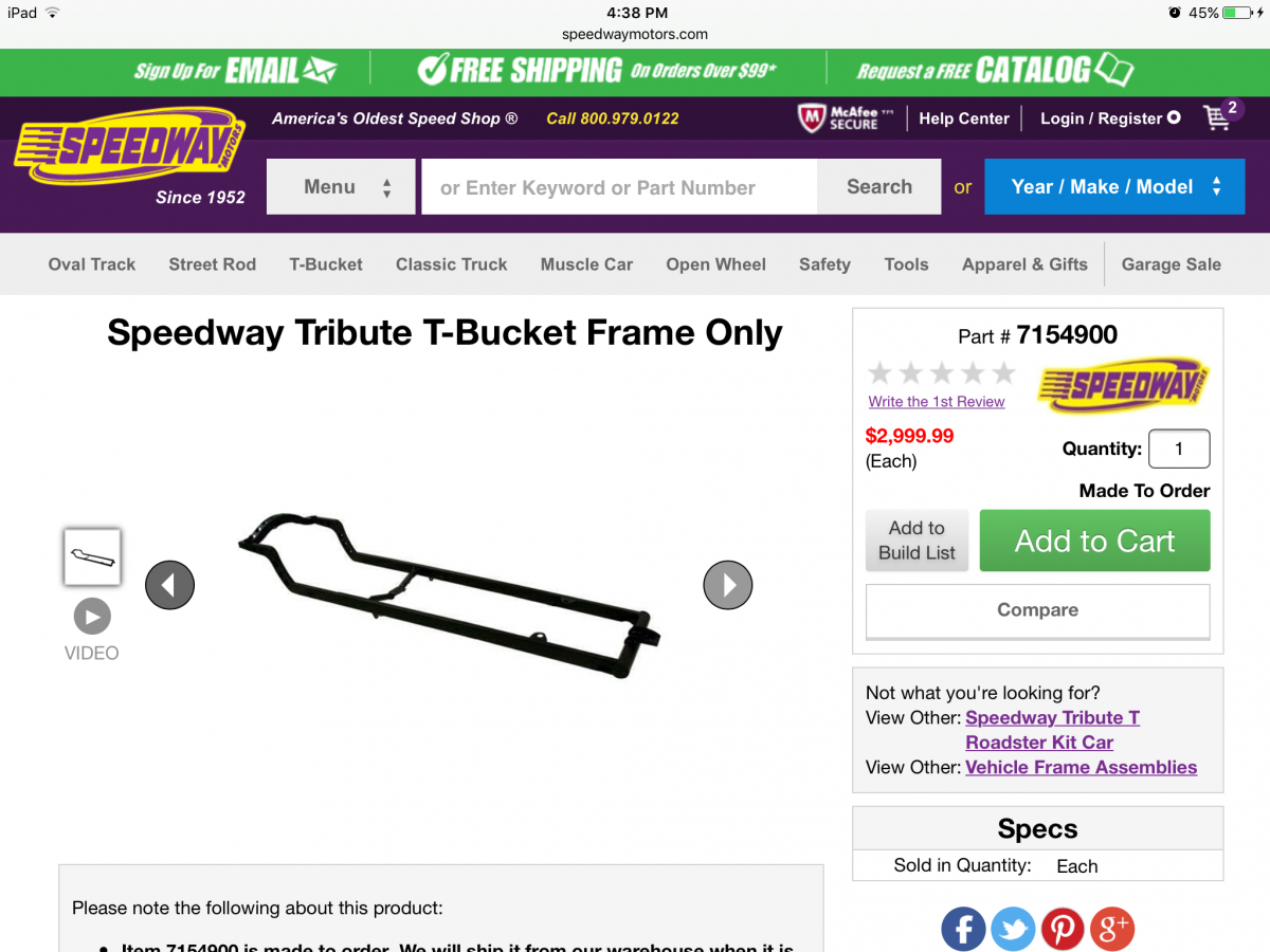

    They want 3 grand for thus one. I'd build those all day long for that.
    Now There's a stamped rear A crossmember for a few hundred bucks, a few $5.00 tabs and do-****ies and a $30 perch welded on.

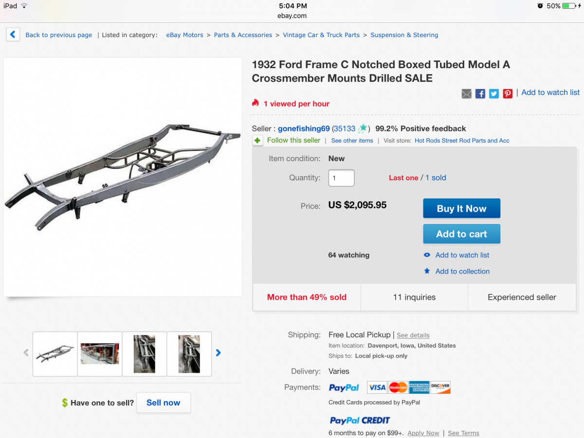

    Look here : it's the same pic, who is using who's though?

    What started this was a ******ed up Tbucket. The frame needs a bunch of surgery. I know It would take more to do the surgery than to just make a new frame. Ever bracket welded to the fubar frame is wrong. ( every single one) So I need to cut them all off, deal with the scars and then make and install all new brackets. Plus it's twisted. Way better to start from new. However the owner is young and completely befuddled at the POS he bought and is watching pennies as the dollars slip right past him. The first sale will be to him and at my cost.

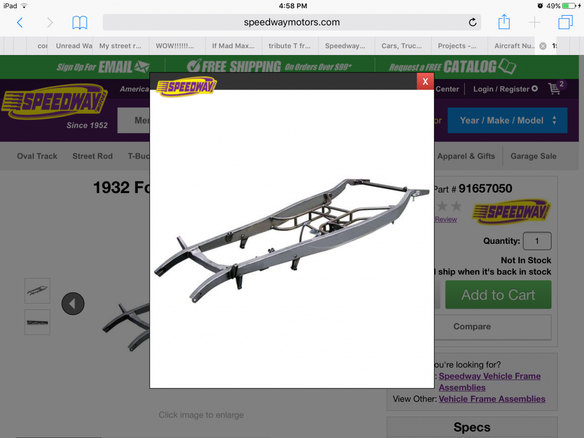

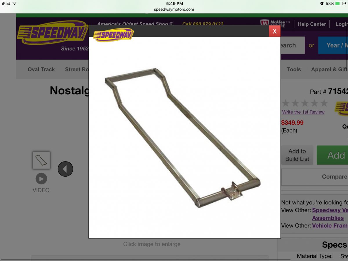

    Nice work! I believe speedways cheapest base T frame is right at 500 dollars.
  6. Thank you !
    $ 350.00 plus freight
    It's 1-1/2 x3 with a front perch.
    Weeks out on lead time. Are they made in China too?
    I used 2x3
    2.75 x 0.25 DOM tube up front ( not cheap at $12.00 LF) with rails wrapped up front.
    Plus I had it in my grubby little hands in just 4 hours .
    It's hard to tell by the pic what joints they used or and if it's 22.5 meters if there's fish plates.
