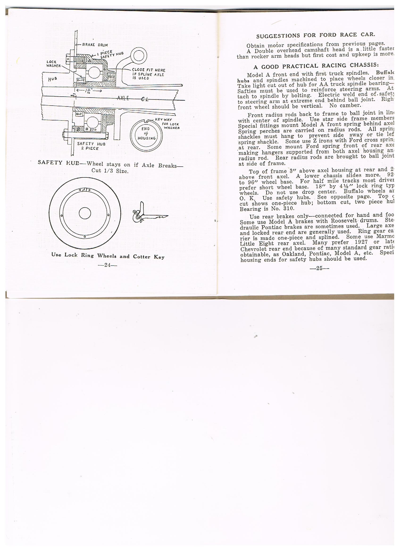

    Rear safety hubs !!! what are you guys doing for safety hubs on the model a rear having lost a wheel due to a broken axle at the taper where they usually go I am wondering what you guys are doing for safety hubs are just a simple c type clips from the backing over the brake drums enough or do you have a better idea?

    Russ here's a picture from George Riley's book: Building the 100 MPH model A Ford 1931. there's also a casting that bolted onto the backing plate with 2 long studs and required a steel ring welded onto the wheel hub, this was probablly the most common/effective way compared to the bolt on clips. Pat

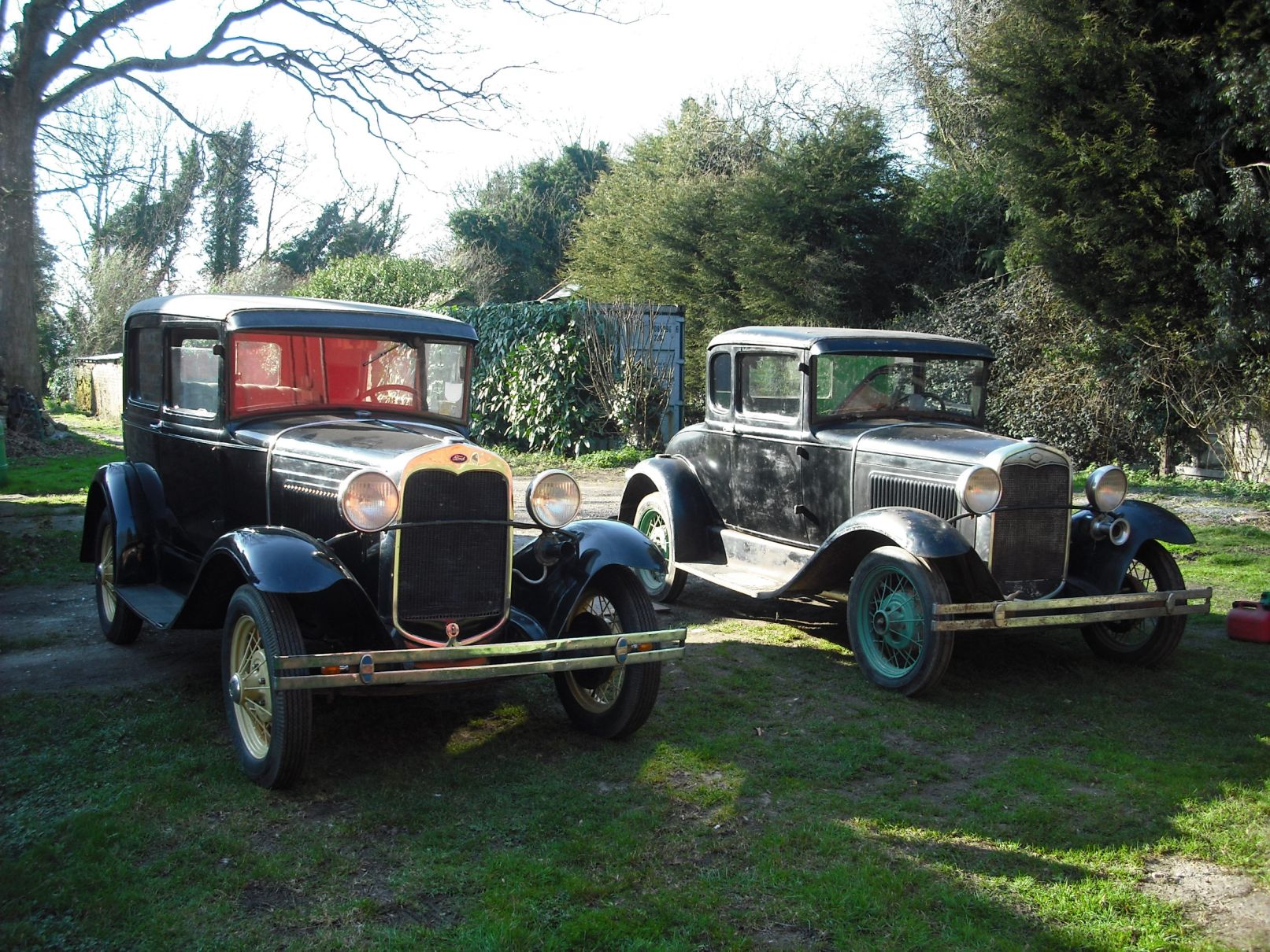

    Hi All,
    This is my first post, attached are a few pics of my projects.

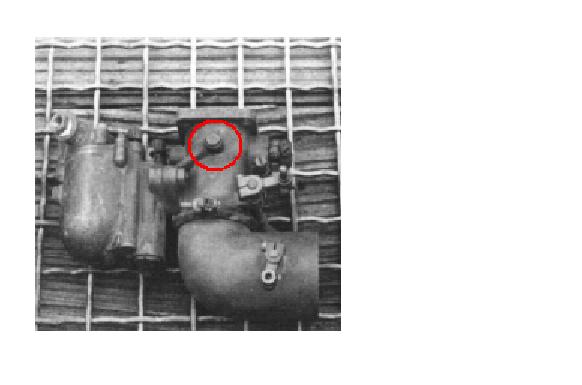

  13. Just picked up a Winfield SBU for my '28 Chevy 4... and promptly busted the idle byp*** bung- yeehaw!
    1) It was broken before
    2) It looks like it's repeairable by rebuilding the area with PC7.
    Anyway, the ball was missing from the byp***- anyone know what size it should be or what material it's made out of (steel, br***, etc)?
    Many thanks, Bill

  14. I can't follow your description, can you take a photo?
  15. Bill,
    The area that broke is circled. I am brand new to Winfields- the info I've gathered from NWVS stated that there is a ball inside the idle byp***?

    Welcome to the H.A.M.B. and to the 'Banger thread! :D
    Nice lookin' Model A's you have there, what are your plans? Normally here on the H.A.M.B. it's customary for the "new guys" to give a little intro about them selves and there projects...fill us in! :)

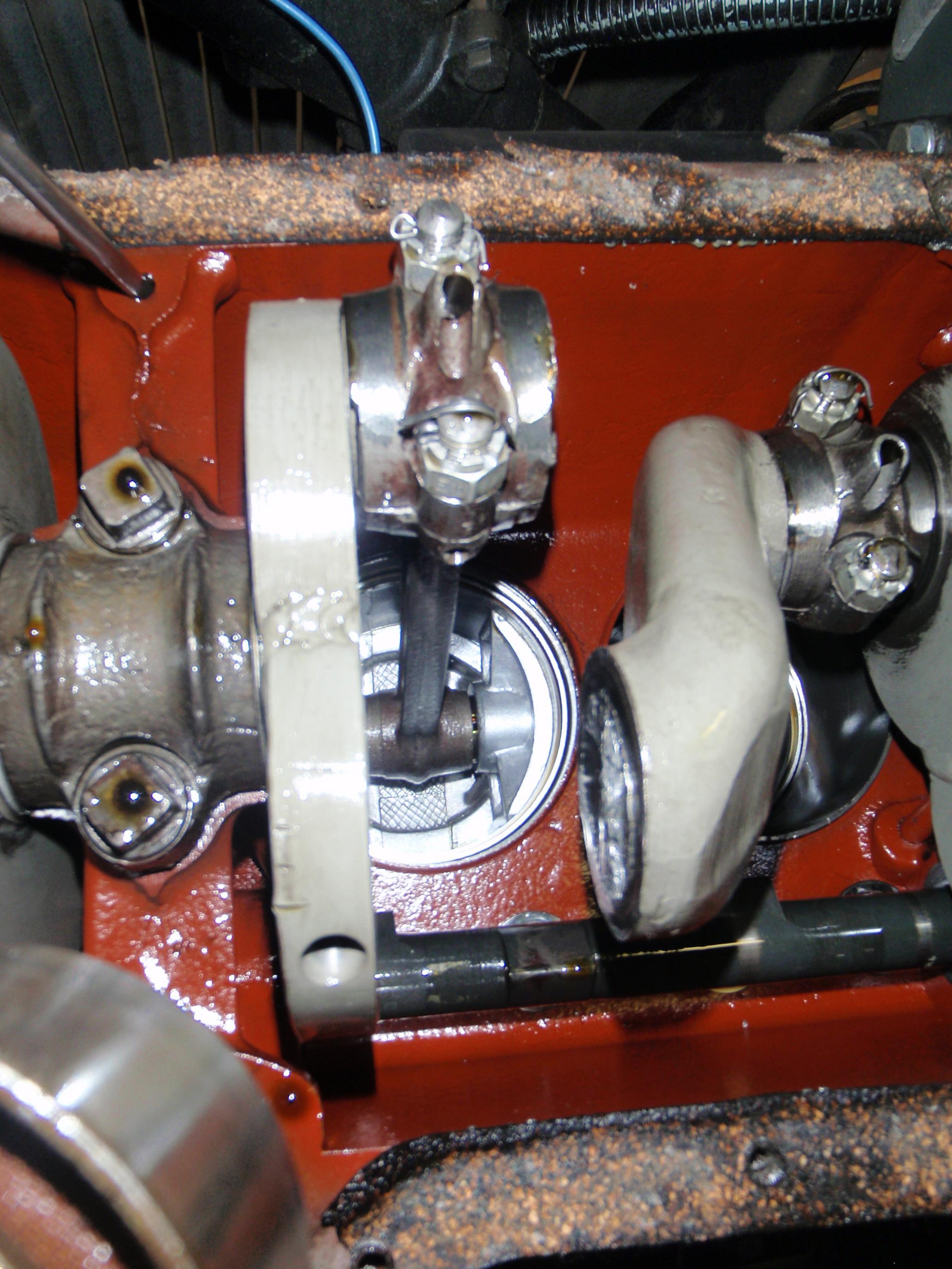

    I pulled the oil pan yesterday to see what happened. My original hypothesis was confirmed. The crankshaft sheared between the 3rd and 4th cylinder. Looks like the engien will be coming out this next weekend for some major surgery. I have attached some pics showing what I first found and what is is supposed to look like after I rotated the crank.
    I have heard about some counterbalanced forged cranks for Model A's. Has anyone had good experience with them?
    The engine was an inserted, non-pressureized Model A Ford engine with a Riley Two Port on top. Some Pictures to look over.
    Thanks, Dave
  18. I have never seen a ball in there. I have a couple of those plugs that have been reseated due to the same problem you had. I think I shortened one .090. Just make sure the fuel can flow, throw yer head back and drive!

    From what I see, looks like another case of "too small of a fillet radius"

    One side cracked off (the fitting had been glued in as well as the break glued back on), but I'll see if shaving things down is a possibility.
    Also, I reread the brochure on NWVS: http://www.nwvs.org/Technical/2104WinfieldHV.pdf
    Sorry, I was incorrect about the "ball" on "page 34"- he was talking about how the throttle is cut in/from a ball shape!
    And speaking of the throttle, I'm having trouble removing it from the inlet... do I need to remove the linkage bushing(s), or ma I just doing something wrong- bottom line is that I REALLY don't want to break something ELSE :)
  21. I'm sure that this has been covered before, but does anyone use a "metal epoxy" like PC7 that they would recommend for rebuilding the idle byp*** bung?
    Update- had an idea and went out to the garage to look at the fitting... the previous owner filed down the threads in order to glue it in- ugh.
    Does anyone know if Barry Bowyer (or anyone else) makes a replacement???

    Devcon makes the best stuff. You call them and they will tell you which is best for a particular fix

    X2 on the Devcon.
  24. Thanks you two! After getting a really good look at it last night, I may just level the area off (luckily, the air p***ages are NOT affected) and epoxy a turned-down br*** nut in place. After doing a little searching, I can probably find/make a threaded plug form what I can get from plumbing supply or Napa/Car Quest.
    Thanks again to everyone for answering my questions, and sorry if they came out in blurts- I'm just getting excited that after a few years of gathering parts, I'm finally getting to the point of having a running engine together!!!
