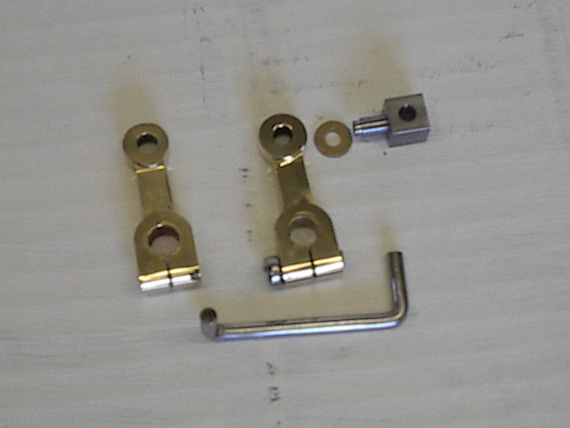

    After running around like an IDIOT from one parts store to another, I picked up some 3/8 br*** stock and a 5/16 24 die. Fiddled around with the Unimat last night for 20 minutes or so, and I now have a new idle byp*** plug (will take pics of before/after tonight)!!!
    Now the question- I'm missing the choke linkage and the other linkage arms on the carb are pretty loose and wobbly... is there anyone who reproduces the linkage OR does anyone have a suggestion for replacing the arms? Not looking for ultra-performance, just something that looks correct without the slop.

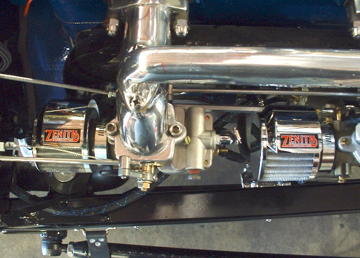

    Seeing that picture makes me wonder. Are air cleaners safe on updraft carburetors? I understand one of the reasons Henry Ford is said to have preferred them is that they reduced the risk of flooding the engine. With that in mind, it seems that there would be a risk of the air cleaner elements becoming saturated with fuel and potentially turning into a fireball.

    Dave; the carbs have a screened drain (vent) in the bottom of the throat so that the flooded fuel will drain before it gets to the air cleaner.

    i found thar a stock "A" doesnt really like an air filter . when i was running the stock updraft , i bought the filter & took the paper out . ran just the mesh for a rock gaurd . maynot be correct but it worked for me .......... steve

  21. I think one old boy didn't use the swivels, he just bent wires out of 3/16 (.187) wire or maybe drill rod and used it in the die cast arms.
    I hadn't finished the radiuses on those br*** levers. I use a .187 pin in a piece of Al. plate and swing the lever radius manually. Just find the center and dial off the radius. Cut conventional (I never cut with a climb cut especially feeding the part by hand) and start with the part against a pin for a stop and eyeball the other side or end. I started out holding the part with a 9/16 wrench to swing it but found I could do it with my fingers. Make sure to shim up under the .187 pin what ever amount you have milled off of that surface
    I start with 3/8's by 5/8's br*** bar from McMaster Carr. I cut to length. mill to .562 by .312 and drill and tap and so on so forth.

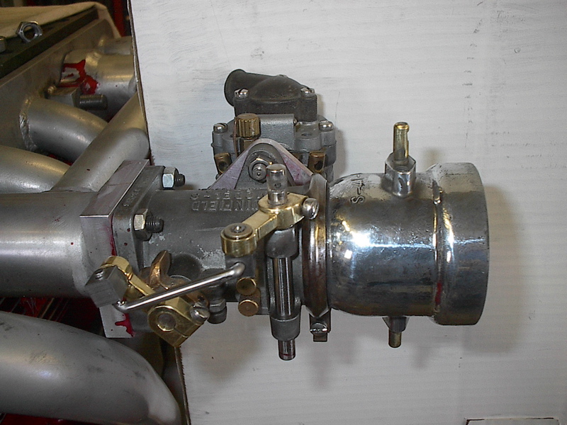

    I also would be interested in anyone making parts for these carbs I am missing choke elbows for both mine [SR downdrafts] they have velocity stacks instead yes we can make parts and yes there may be current carbs that are better but I think the point is that we are trying to build a traditional car with period speed equipment or am I starting to sound too much like a restorer.:rolleyes:
  23. On the swivels it is critical to hold the dimensions close. I use a small center drill a #1 or 2 or what ever with a 1/8 body to drill in the rivet end. The #8 washers are tight and I set them with a center punch. You need to hold the length to the washer step to within.001 to .002 of the thickness of the arm or the linkage will start out with a little slop, okay for singles but can be a problem on a dual settup.
    For the linkage "wire" I use .187 304 SS 303 will break. plain mild steel (1018) bar stock would probably work.
