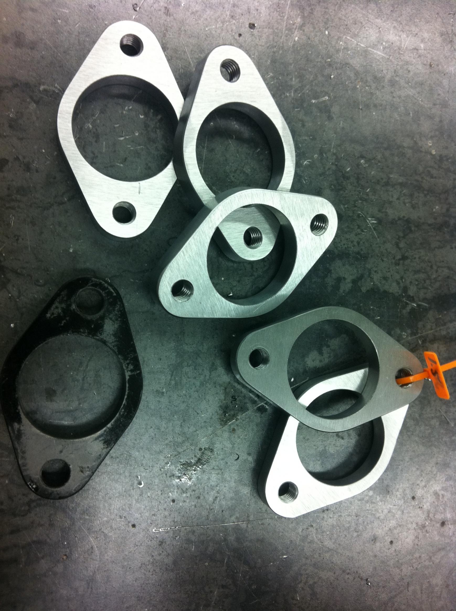

    I just made some SU flanges for a guy here on the HAMB

    Are those side-draft carbs? I actually was planning on casting a down-draft manifold.
    My original plan had been to run a single Carter BB-1 updraft, like from a ‘40s GM COE truck, but when trying to think of things to cast up, I kept coming back to a 2x1 down-draft intake. Maybe I should s**** that idea and look at casting a valve cover instead.

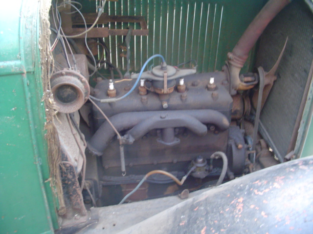

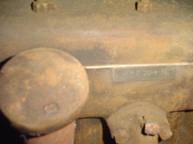

  15. Anyone know what's the engine displacement (cui or cc) of a European 1932 Model BF engine is ?
    It's hard to see, but the block is stamped BF 5272616

    This apears to be the same as a B or BB block. If so it will be 200 ci.
    Here is a link to more info:
    http://www.fordgarage.com/pages/ABenginenumbers.htm
    It now looks like the BF designation is for the smaller 14 hp block that had a 3.055 bore and 124.6 ci.
    More info:
    http://www.fordgarage.com/pages/1933modelb24and14.9ib.htm
  21. For tax reasons in England and France (as far as i know) they had fewer
    cubic inches, only i don't know how much.
    Your right that the block itself looks identical.
    Also have a Model AF engine from France and that should also be less CUI :(
  22. Crazydaddyo
    Joined: Apr 6, 2008
    Posts: 3,383
    Crazydaddyo
    I edited my oroginal post. The BF should be the small bore 124.6 ci.
