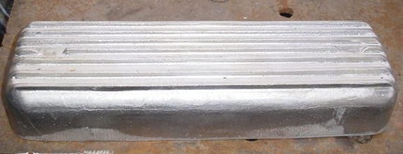

    I had a 28 chev head on a model A and was going to use two single barrel carbs from 50's ford six they are almost the same as 97's but single barrel
    I sold the motor before I got around to doing it
    I have cast a ribbed aluminum valve cover for a 23 olds and it looked like it would fit the chev head except for the step down in the middle of the head
    I still have the valve cover I think there is a pic on my page

    Kenagain ... Couldn't find the pic of the Olds valve cover. Could you post it again. Thanks

  5. kenagain
    Joined: Dec 15, 2005
    Posts: 820
    kenagain
    from so cal

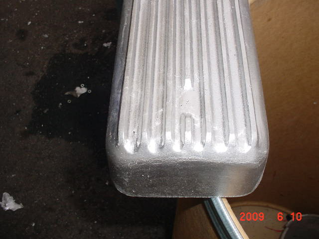

    Here are a few of the pictures, I originally had the casting process from the tin valve cover redo to the final product as done in a foundry

    Cool cover! I don't supose ya got an extra one laying around.

    Very nice cover you have yhere. i have a 28 Chev I got from JimmyB to put on my A motor......one day

    I have an extra one no holes drilled in it the olds had 2 hold down bolts at each end, and my chev head had 1 in the center. I still have the mold and can make more
    pm me for price

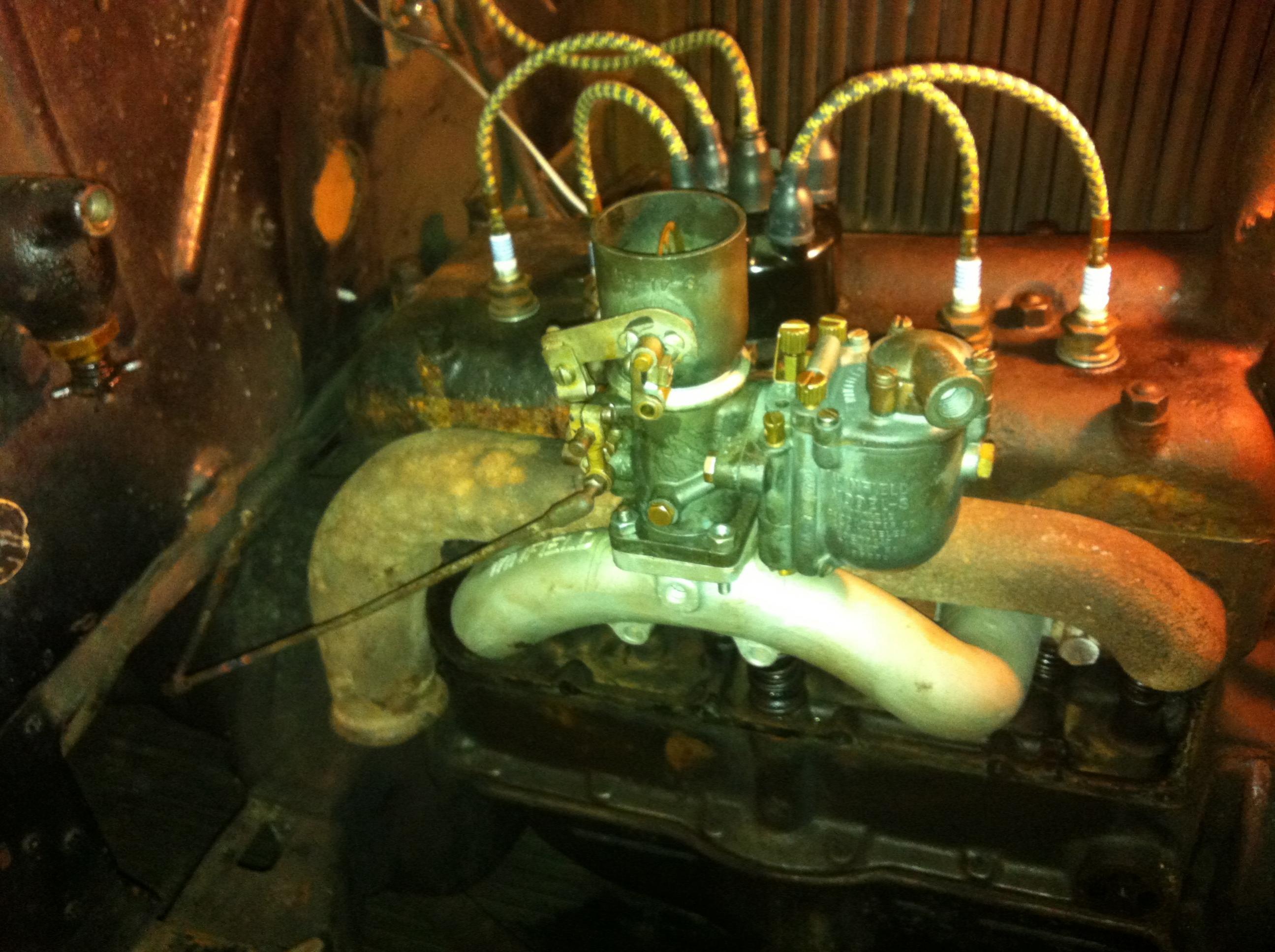

    I need to pick up some gaskets and do some pluming but the winfield is all test fitted up. Now for the joy of tuning this bad boy.

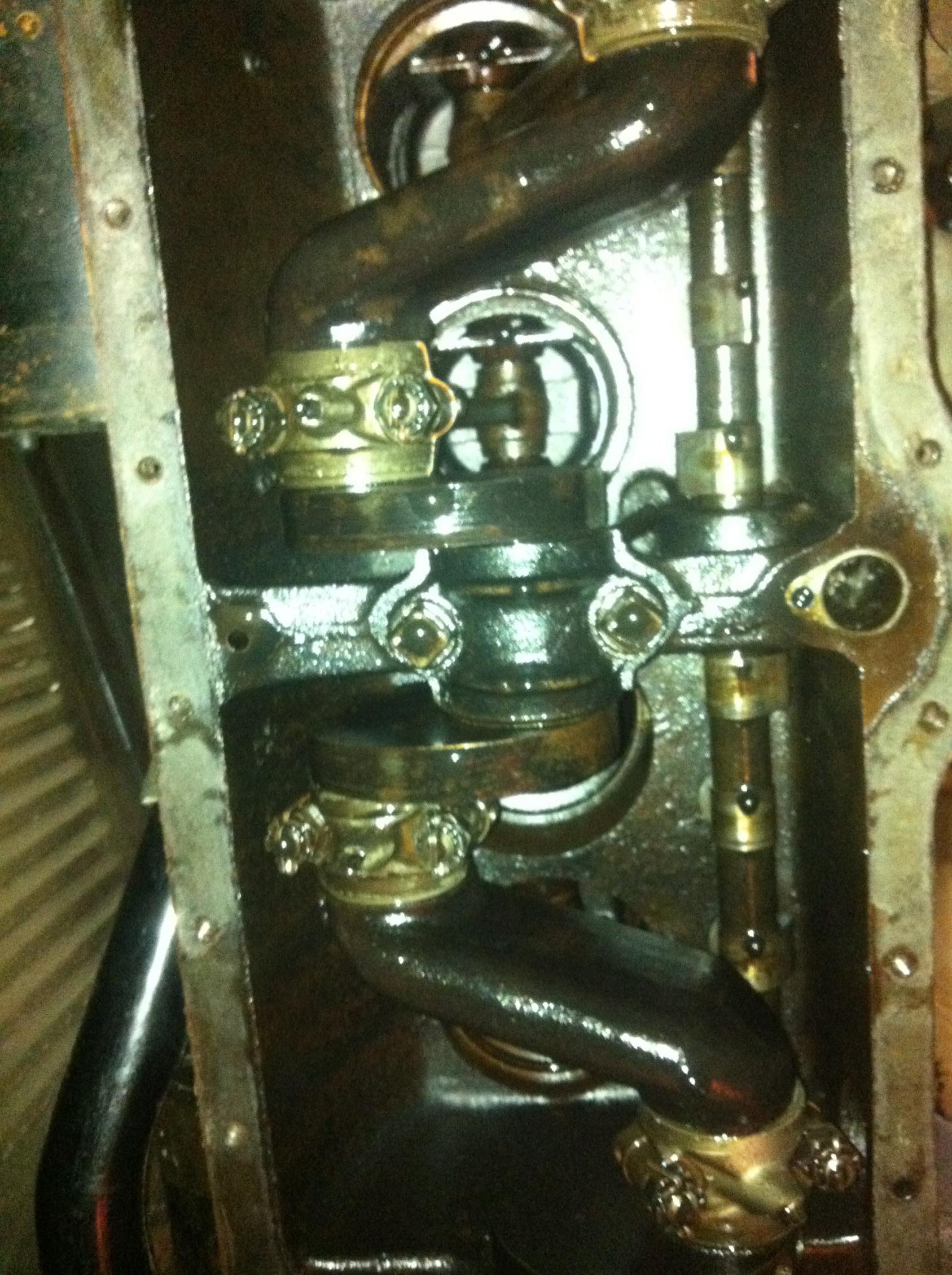

    Now it's time to pull the pan for a good cleaning. After pulling the side cover to check out the Distributor gear (it looked like a saw blade) and found 1/2" of **** I can only guess what I will find in there

    The winfield factory recommended using the next size smaller float chamber as a cure for stumbling. As to the pump, when they first came out most users didn't feel they helped so they would turn the bottom plate 1 hole blocking off the pump port and running the screw all the way down.
    Regarding tuning, I have set them according to the Winfield instructions, with a Color tune, and a Edelbrock oxygen fuel ratio meter and I seem to come out with the same settings +- 1 to 2 teeth . The float chamber must be level while tuning. The Winfield manifolds were milled within 2 3/4 to 3 degrees off level, at least the ones I have/have had were. I usually ended up with 27 28 on the intermediates on the "S" "B"'s then 5 more on the high. When tuning by the Winfield method, I use a portable large tach.The Winfield method is mostly by sound and feel. I do my initial setting at my shop, 3800' but have learned to leave them alone at Fontana, 1000'. But hey , a couple of clicks ain't going to hurt at the drags. Just remember, there are no secrets just 3 simple circuits. The little slot in the ****erfly takes care of the off idle transition. The pump was a sop to the ad men who felt the company was using old fashioned technology and needed a pump because everyone else had one.

    After my trip to the store. I pulled the pan on the Tudor and it looks all stock. I can see a big stack of shims still in the rods. The engine sounds real nice I just wanted to clean all the old oil out. Start fresh. Now that I have to do a new seal up front I think I will put a B front cover on and use my new B dist.

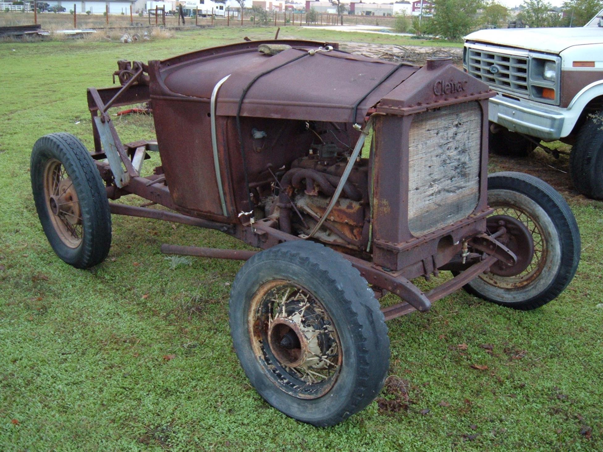

    I seem to recall reading somewhere that back in the day it was said that if you didn't have a jack, the A oil pan was designed to be able to run up on a log to get the front wheels off the ground to fix a flat. Didn't say how to get it off though.

    Maybe that's how the oil pump got broken in my "A" tractor!

    The previous operator continued to run the engine after the pump was broken, apparently molten babbitt makes a good lubricant as the crank was only slightly scratched. Another spare time project, at a yard sale I found a side drive governor for the A engine. If anyone is interested I'll take pictures of the governor, would be a deluxe piece for a tractor. Pat
