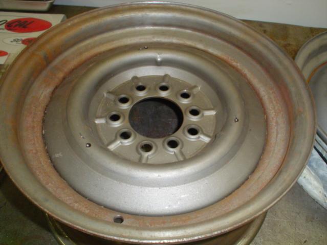

    Here is a picture of smoothies that were modified to accept pontiac poverty caps:

    Hey, the wheels on the Acadian are Paulsens steelies. And making the caps fit wasnt tricky. Let me know if you want the info...

    any pics of how you got it to work?

    Here ya go, I scribed the I.D of the caps on the wheel, drilled and tapped the wheels in a mill, and used a bolt as a jamb nut on the back of the wheel. Loctited it all and have had NO problems at all.
