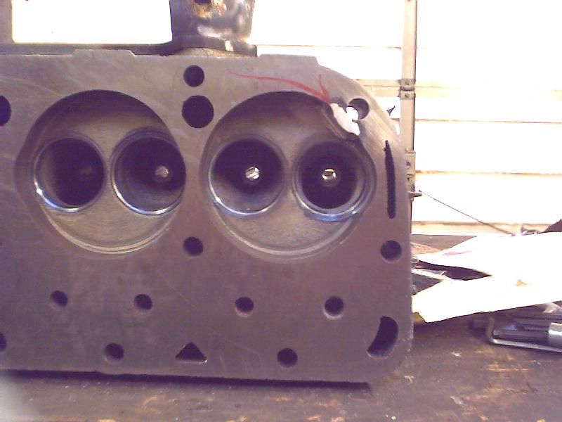

    And now a word from the UnFord group. An update on the Morton & Brett head. For some reason the two upper/outer head bolt holes were very close to the combustion chamber. Within .020 on one side. So I have had the head built up in those two places to give me something to work with. The chamber is larger than the cylinder bore for some reason, so the new lump will have a surface to seal against. Also you can see the as yet unfinished intake.

    Are you going to do anything to the other two cylinders to equalize combustion chamber volume?

    The pistons will have to have such gigantiac domes to make any compression at all that I thought I would just notch those two pistons tp clear the weld and equalize the compression.
