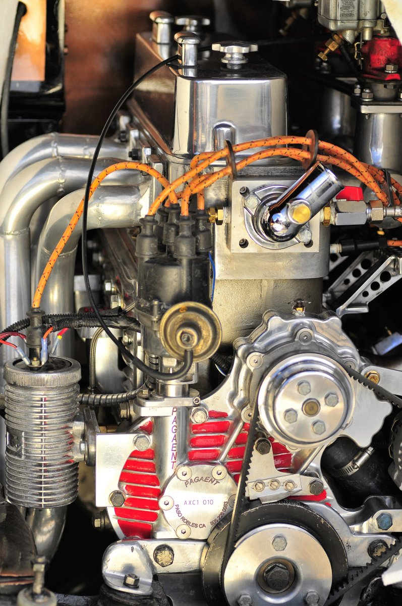

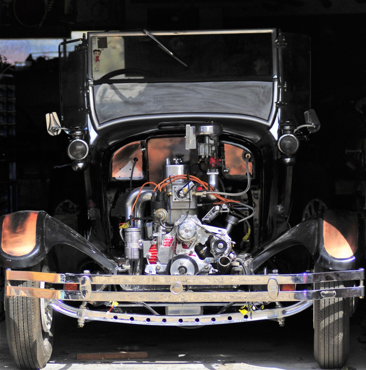

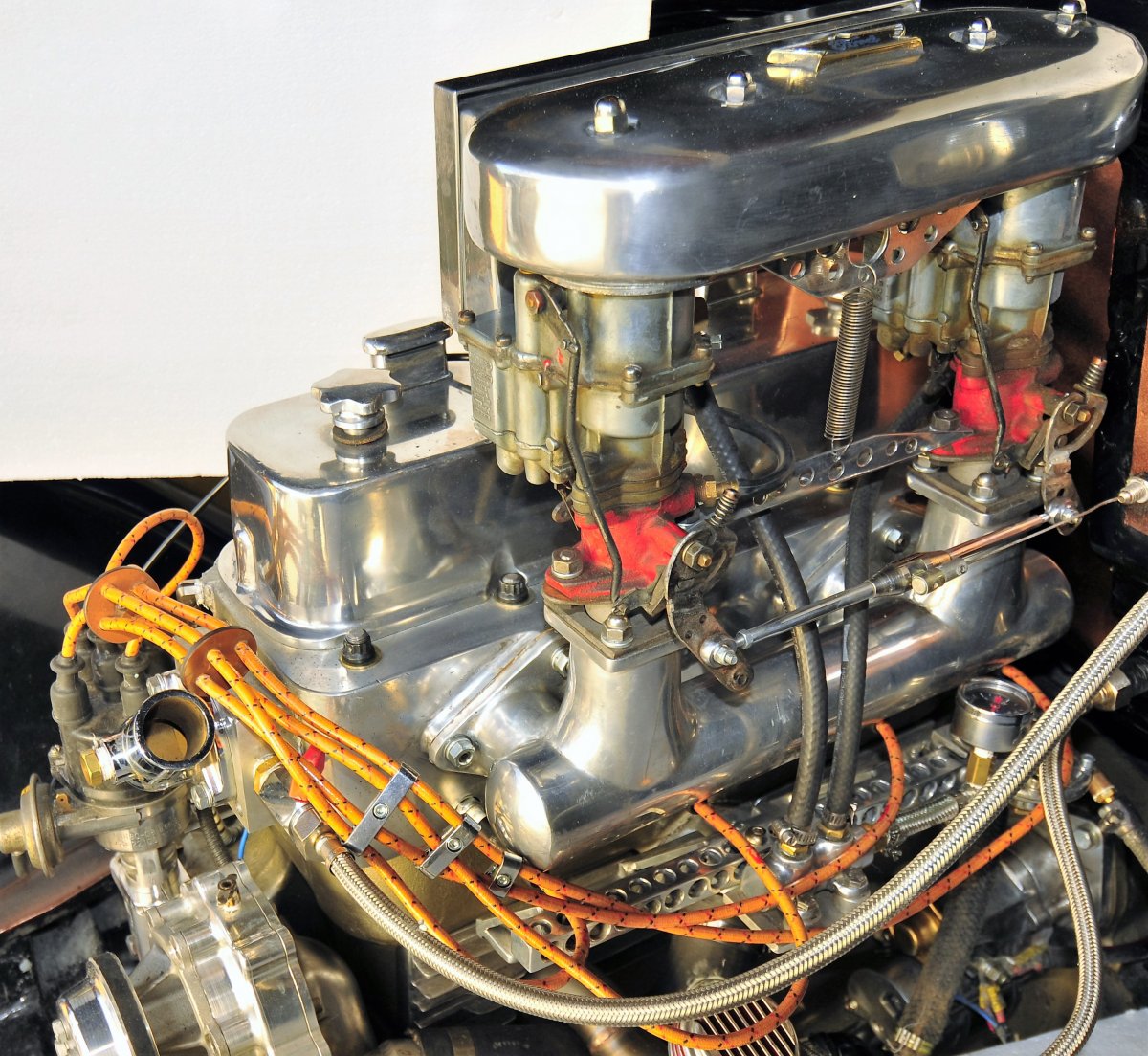

    Thanks guys this is the information I need nobody here has Winfield so its a bit of guess work it is almost for sure to much fuel pressure have the car running and drivable with two Holden carbs(similar to 97s ) but is not running well the Rutherford head has very large ports so needs air speed So I am thinking if I can get the Winfields going it should give better performance plus it is the challenge of getting the vintage Winfields on a Rutherford head running well they look so cool and this type of motor is just not seen here if anyone else has a similar set up please posts pics they all help me (a pic is worth a thousand words they say) at least it is drivable and legal now its into fine tunning and tweaking.

    got pix of the head ? don't hurt the winfields .

    Those are the holden carbs I am hopeing to replace with Winfields

    very nice set-up . I had 2 winfields at one time & they were good .
    after looking again that is a dream motor & in a "T" ! very impressive .
