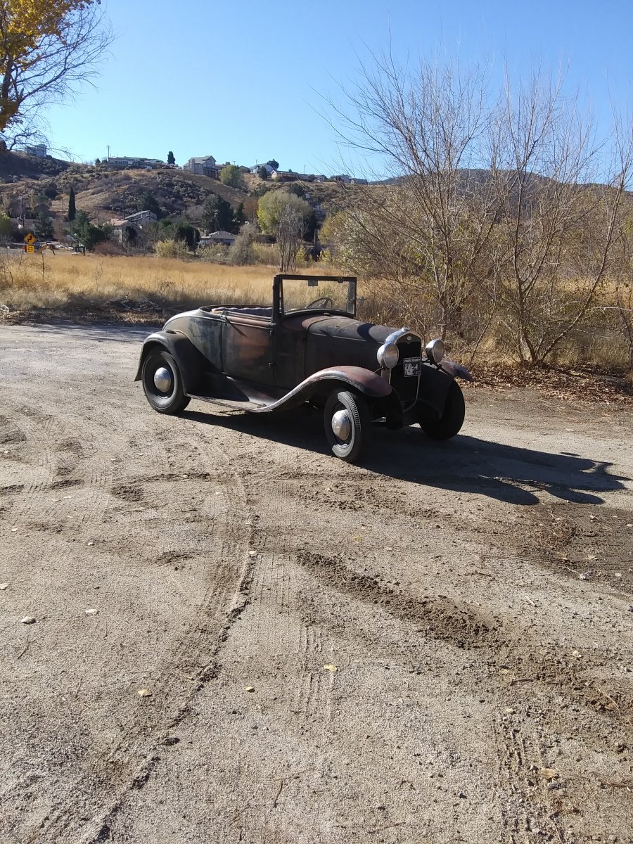

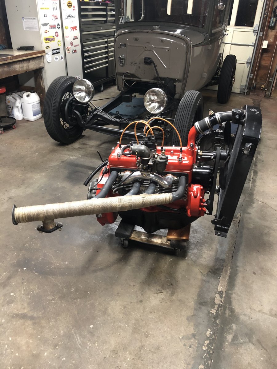

    Farewell banger friends. It was fun while it lasted.

    Did the banger sell yet?

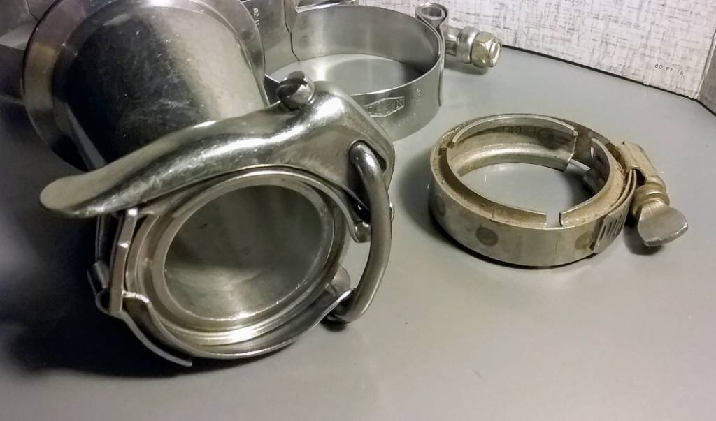

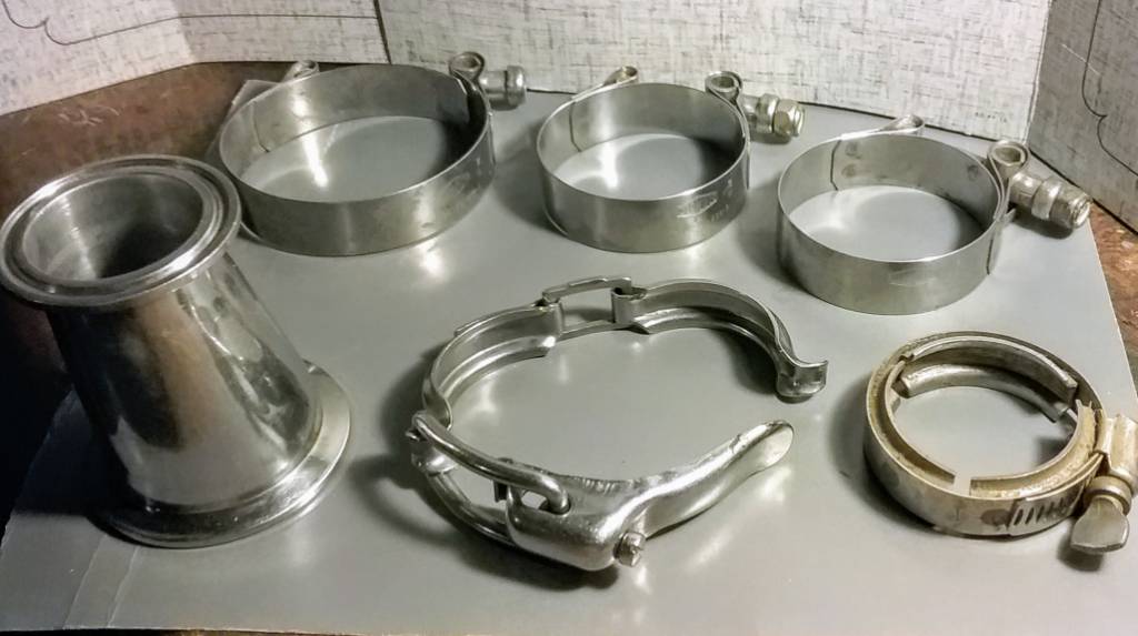

    You probably got your clamp ordeal taken care of already but another place to find that type of clamp is on some old oil bath air cleaners ...some are flat but I have had some that were V shaped..here's kind of a cool one if a quik release would help, this one is from dairy farm milking equipment.
    The small one with the thumb screw is a aircraft one.

    @railcarmover got a guy interested and said he’s coming for it this weekend. We’ll see.

    Heres to it happening,you can sink the dough in hopping up the flattie...its never enough you know,its just like doing dope...

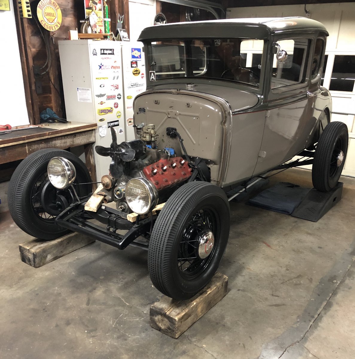

    Oh I’ve already got stuff coming. Sharp heads, a cam and dual carb intake.

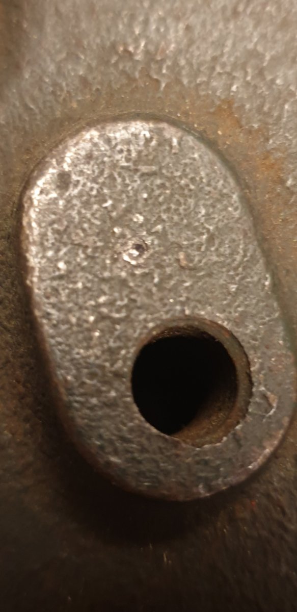

  15. No, that's an A-6019-BR cover which was supplied to service for Model A's after 1932 Model B production began.
    On the B timing covers, the timing pin hole is higher.
    You can time an A engine with a b distributor with an A timing cover though.

    I made a jigg to copy the B hole on a A timing cover. Can´t find the picture right now, but from the edge of the A´s thread hole to the punch mark for the B thread hole, it is 0,231"
    and from center of the A´s thread hole to the punch mark, it is 0,375"
