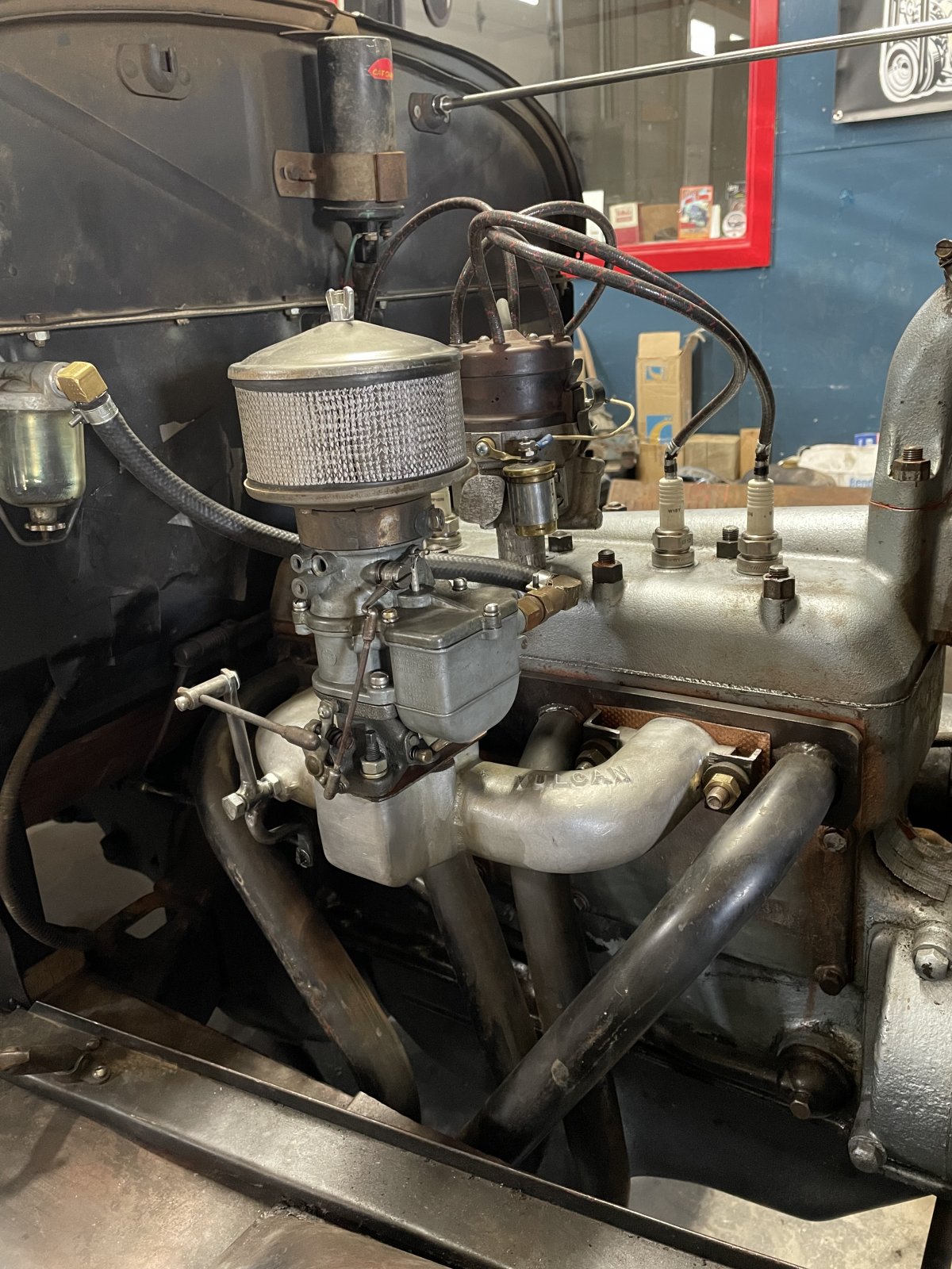

    I had to fix a crack in the deck that was causing me grief with my pickup. Got it back together with an intake I picked up a while back. I think the manifold was manufactured the same place my alum. Winfield head was heheh. Required some grinding and welding to fit correctly, but runs great! Fabbed a linkage to jog around the exhaust as it mounts the carb outward from my other intakes, but it's low so it fuels easily right down til you run the tank out of gas... C408F046-7F74-47AC-A282-C0D70700A5FD.jpeg [] ...

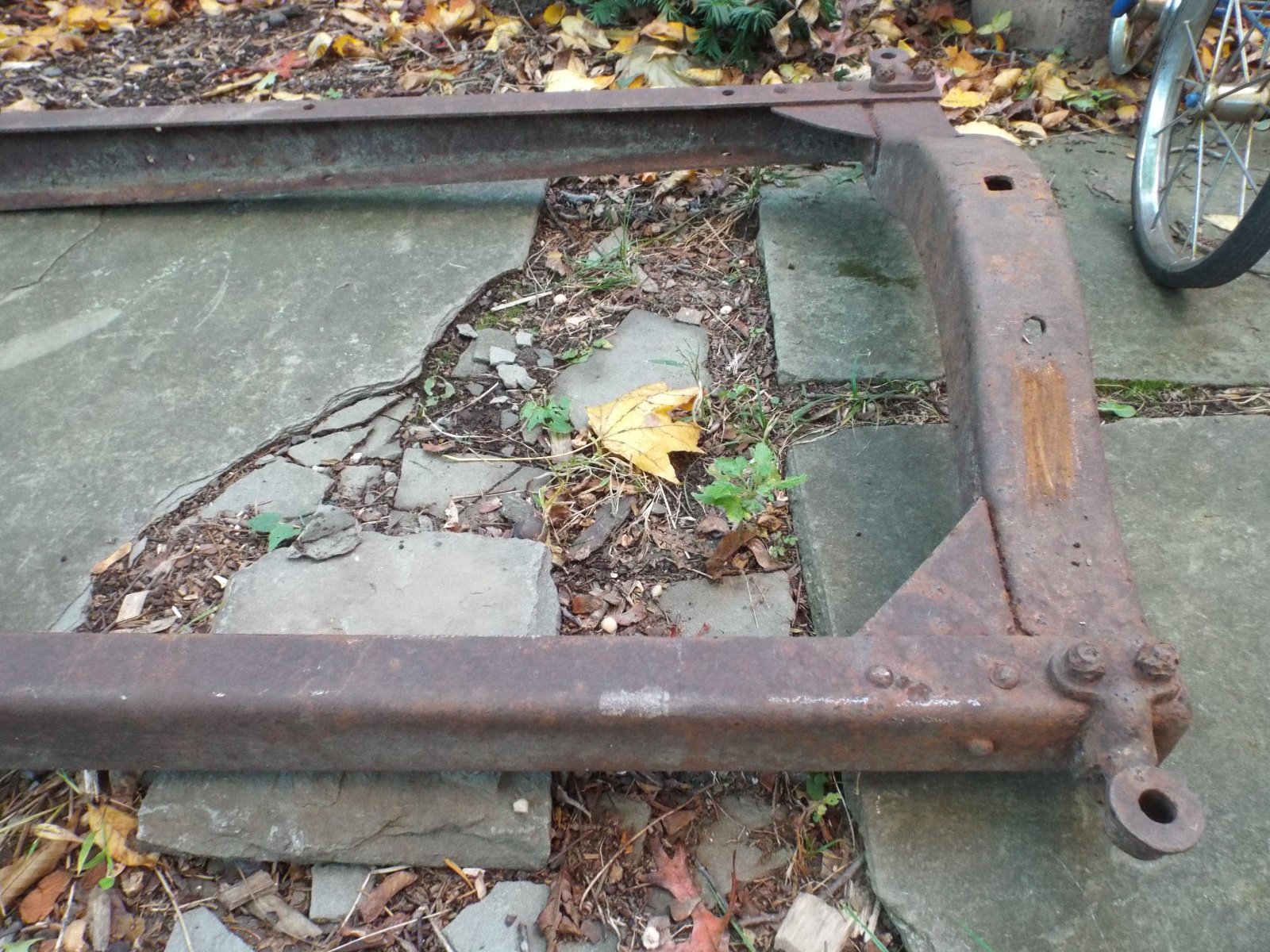

    Hershey is over, Winter will be here, may make some progress on the ba*****t projects. DSCF0095.JPG

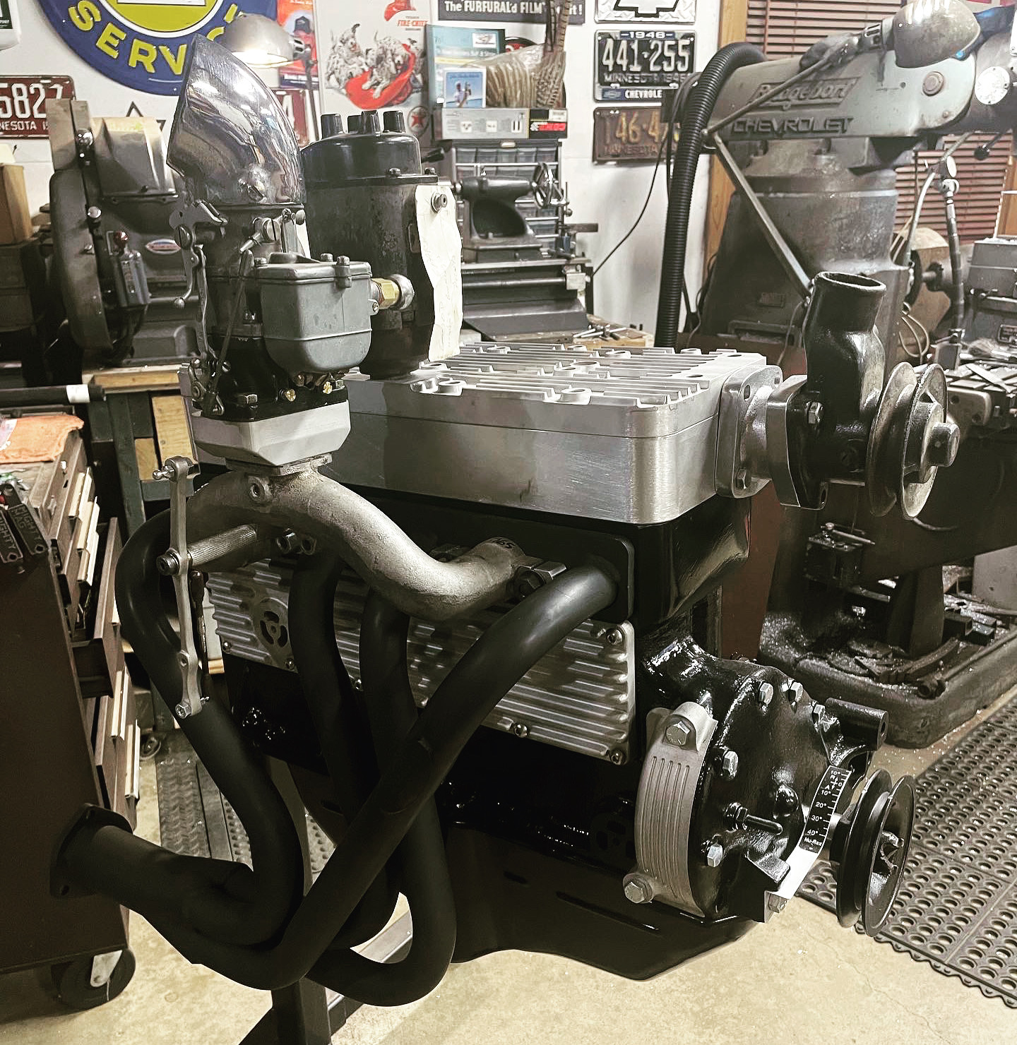

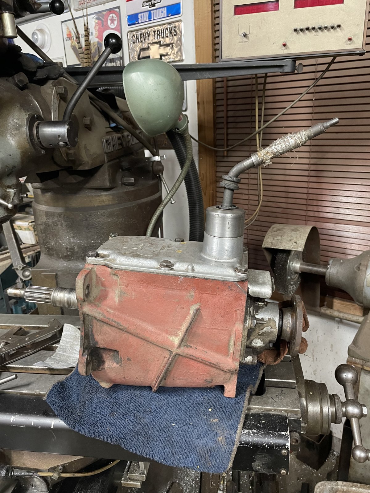

    Checking in for the month. Progress has been painfully slow but colder temps mean more shop time. Need to get this running by February 814B89BC-EBC4-47C4-B266-541FFE492ECA.JPG for the ice races. engine sealed up and ready to go back in
    Found another trans for spares

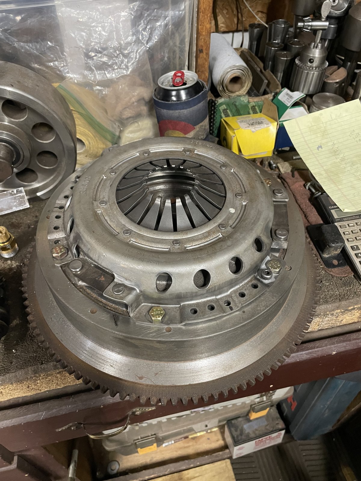

    finished mating the clutch to the flywheel now to make a throw out bearing carrier IMG_6669.jpg

    What trans is the red one above?

    volvo m-40

  20. That's some fancy pants T kit there!! When did Ford stop the cast ears?

    1913 was the last year for the short rear crossmember. Found the kickup pattern an hour ago while searching for something else. that is progress. Bob

  23. What clutch cover is that? Wonder if it’s available over here? Guess you have to adapt the matching thrust bearing?
  24. burl
    Joined: Nov 28, 2007
    Posts: 888
    burl
    from Minnesota
    I use the Volvo pressure plate and clutch. It comes from sachs as a clutch kit. I use the Volvo through out bearing and machine a carrier to match up with the ford clutch fork. I will try to take a few more picture this time .

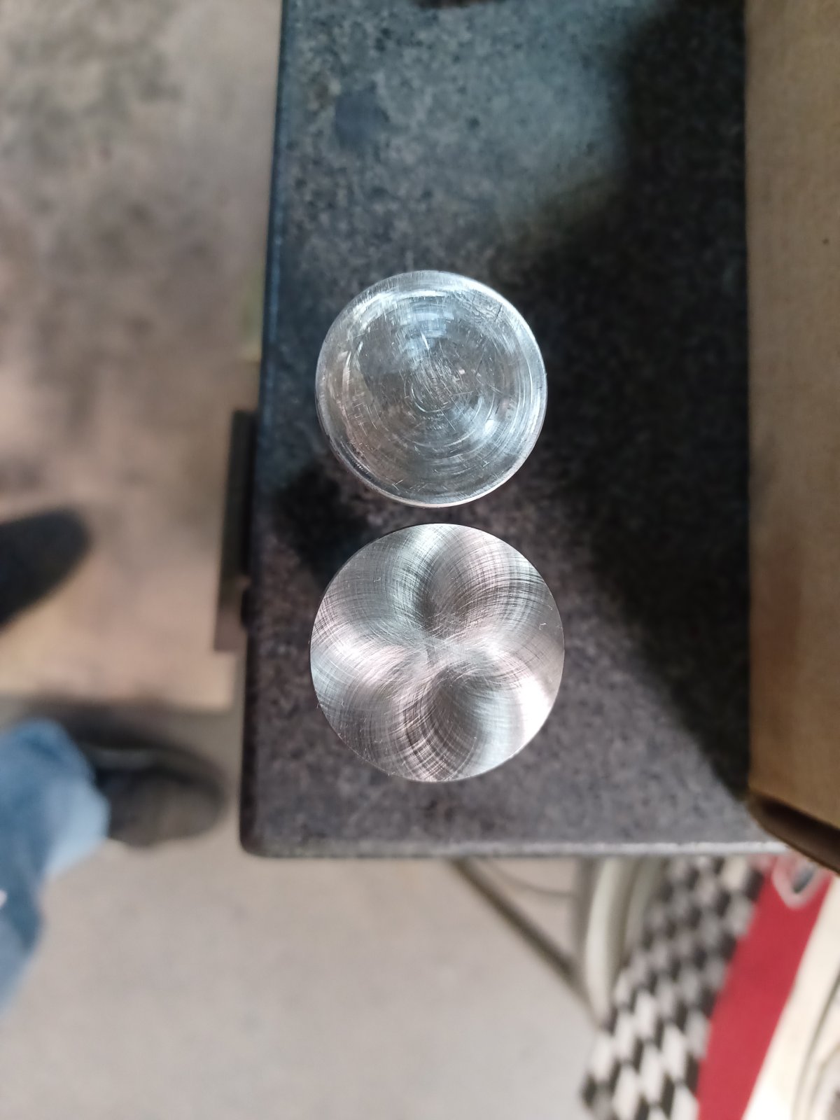

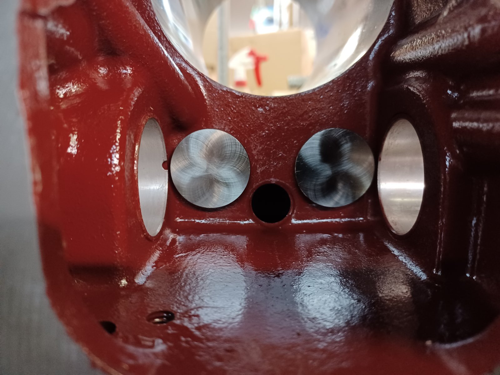

    Progress on my Burtz. Now bored .060" over, Glyptaled, and confirmation that the Chrysler lifters will work.
  30. Crazydaddyo
    Joined: Apr 6, 2008
    Posts: 3,372
    Crazydaddyo
    Chrysler lifters have a 1.285 diameter base compared to the B lifters with it's 1.120 base.
