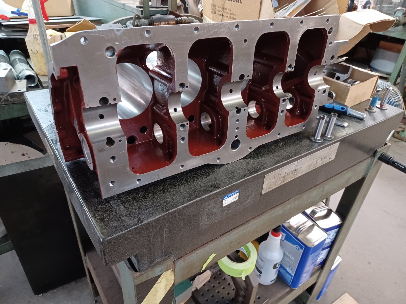

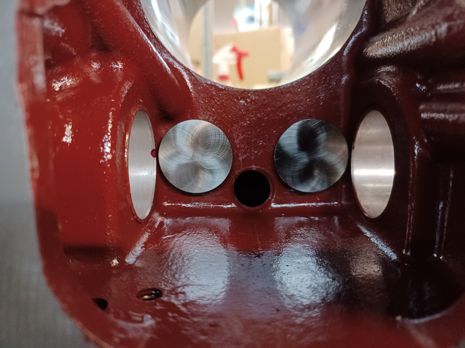

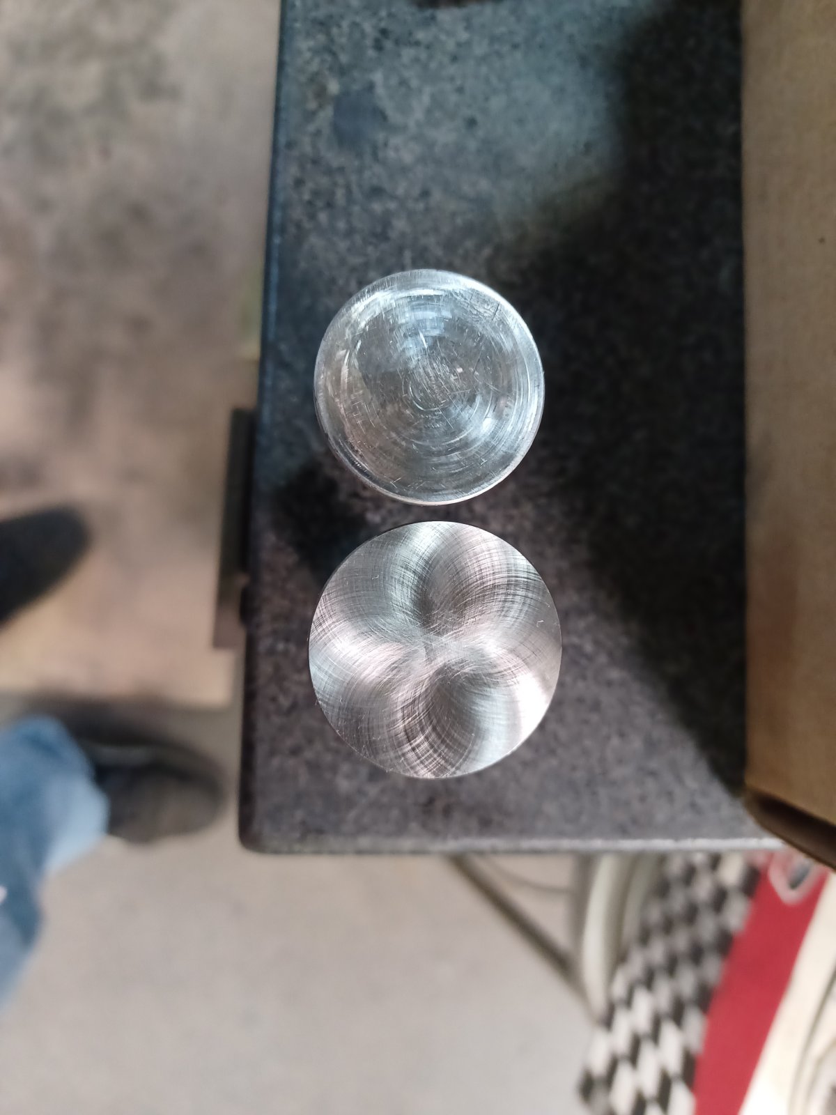

    Could you share your source for the Chrysler lifters? Thanks!
  2. Crazydaddyo
    Joined: Apr 6, 2008
    Posts: 3,372
    Crazydaddyo
    I bought these at a swapmeet years ago. I do know that Egge Machine Co. lists them as in stock. They are not a direct slide in item. You either have to open up the lifter bores in the block, or grind down the body of the lifter. I've done the latter. They are also longer and require modifications if you want to use them in a Flathead set up.

    Are those 625 or 633 dia?
    and make sure the cam bearings clear the foot
    I have seen some stop rotating it gets ugly
    john
    Old Dawg and Crazydaddyo like this.
  4. Crazydaddyo
    Joined: Apr 6, 2008
    Posts: 3,372
    Crazydaddyo
    These were .630 dia. Cam clearance is next.
    I've used them on my last 2 builds with out issue.

  5. 5280A2
    Joined: Sep 8, 2014
    Posts: 197
    5280A2
    I found interference pairing Chrysler lifters with a Brierly cam at the radii between the cam bearing journal and the shaft. I needed to reduce the lifter foot diameter 0.040 to ensure clearance for the lifters to rotate. It was a three bearing cam so it only affected the exhausts.
    My build was a flathead; I used SBI brand valves by Eaton that were the correct length out of the box to work with the taller lifters. The intakes were 1.625 diameter PN 01083, and the exhausts were 1.50 diameter PN 00504. With the shorter valves the installed valve height was just right for providing 60 lbs. of seat pressure as recommended by Jim B. using stock A valve springs.

  7. Dan
    That sounds great, those are the only ones I use
    I have beat the **** out of them with seat pressures in the 180 lb range and spinning 7000 rpm
    Just send out to have refaced and use them again
    Don’t try ti coating, didn’t help
    There is a mold treatment that does work but is extremely expensive dictonite I think
    j

  8. Crazydaddyo
    Joined: Apr 6, 2008
    Posts: 3,372
    Crazydaddyo
    John,
    I don't plan on working them that hard. This engine is for pop's truck. I have been using a thin dense hard chrome at work and like how it works in extreme pressure conditions. I would consider it if a coating was applicable.. Very hard, only a couple of tenths build up and does not flake or peel. doesn't need a high Rockwell base either.
