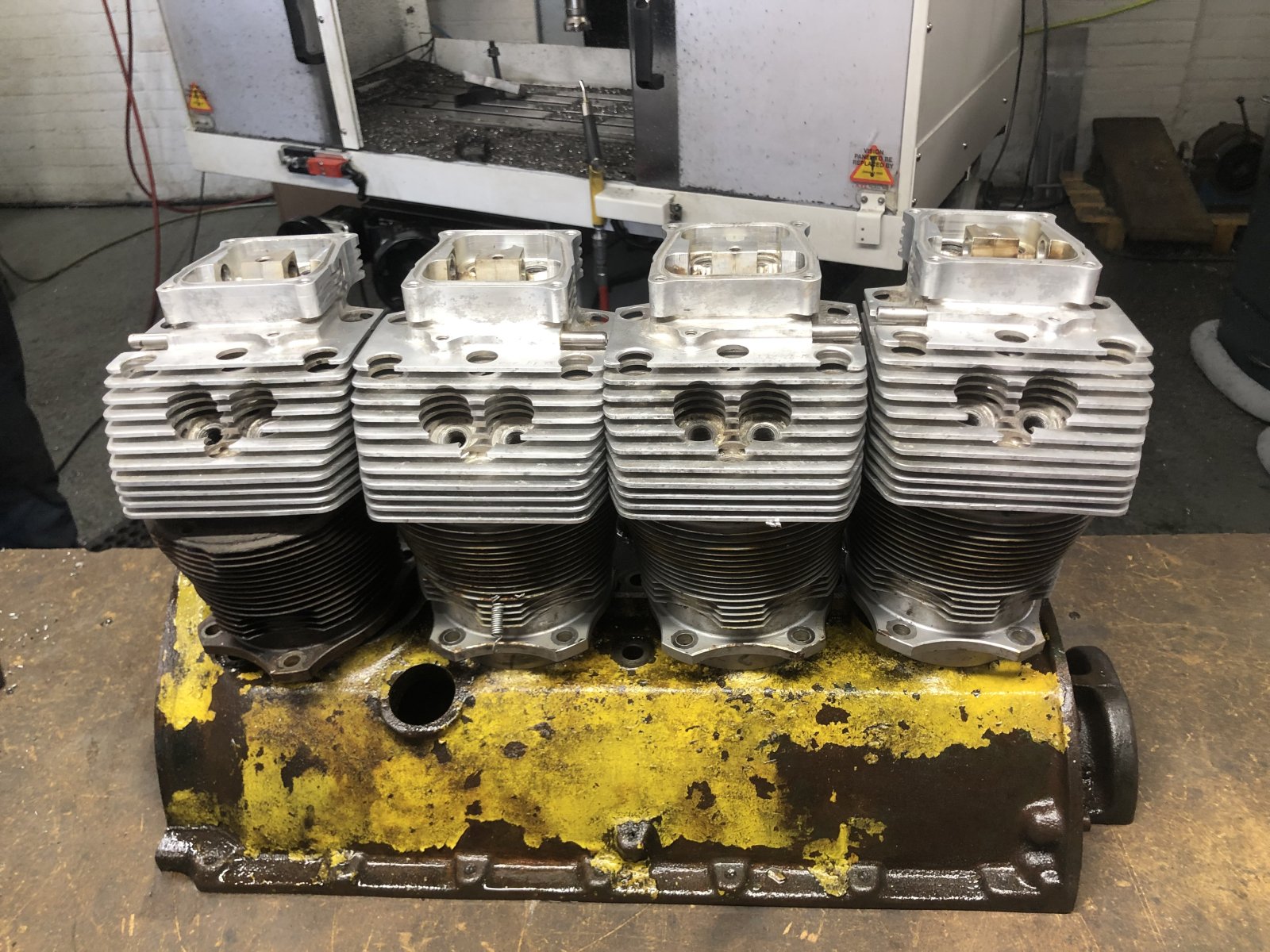

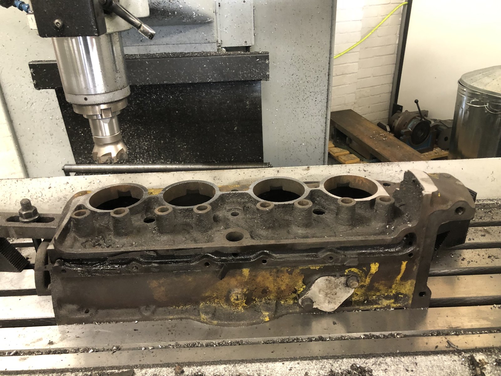

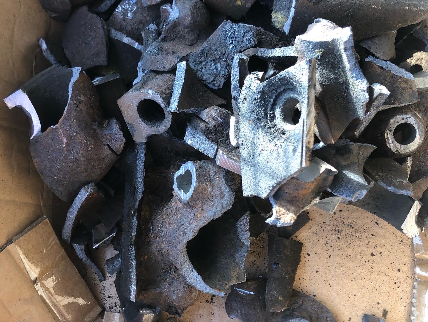

    314661682_10160838739317033_4744716233149322969_n.jpg 314717482_10160838739162033_7645079214768950155_n.jpg 314754702_10160838739772033_8215853899621365408_n.jpg 314937325_10160838739222033_2521564789864594869_n.jpg 315005359_10160838739342033_6883502288325474462_n.jpg 315535614_833569344456189_2873585051572395013_n.jpg Some interesting photos from facebook group FourBanger's Ball I suspect the B block had an unrepairable crack on the deck...

    Some people would have cleaned the bottom half of the B block you cut the top off of, but there are guys that weld rusty sheet metal too. Your shop to do with as you please.

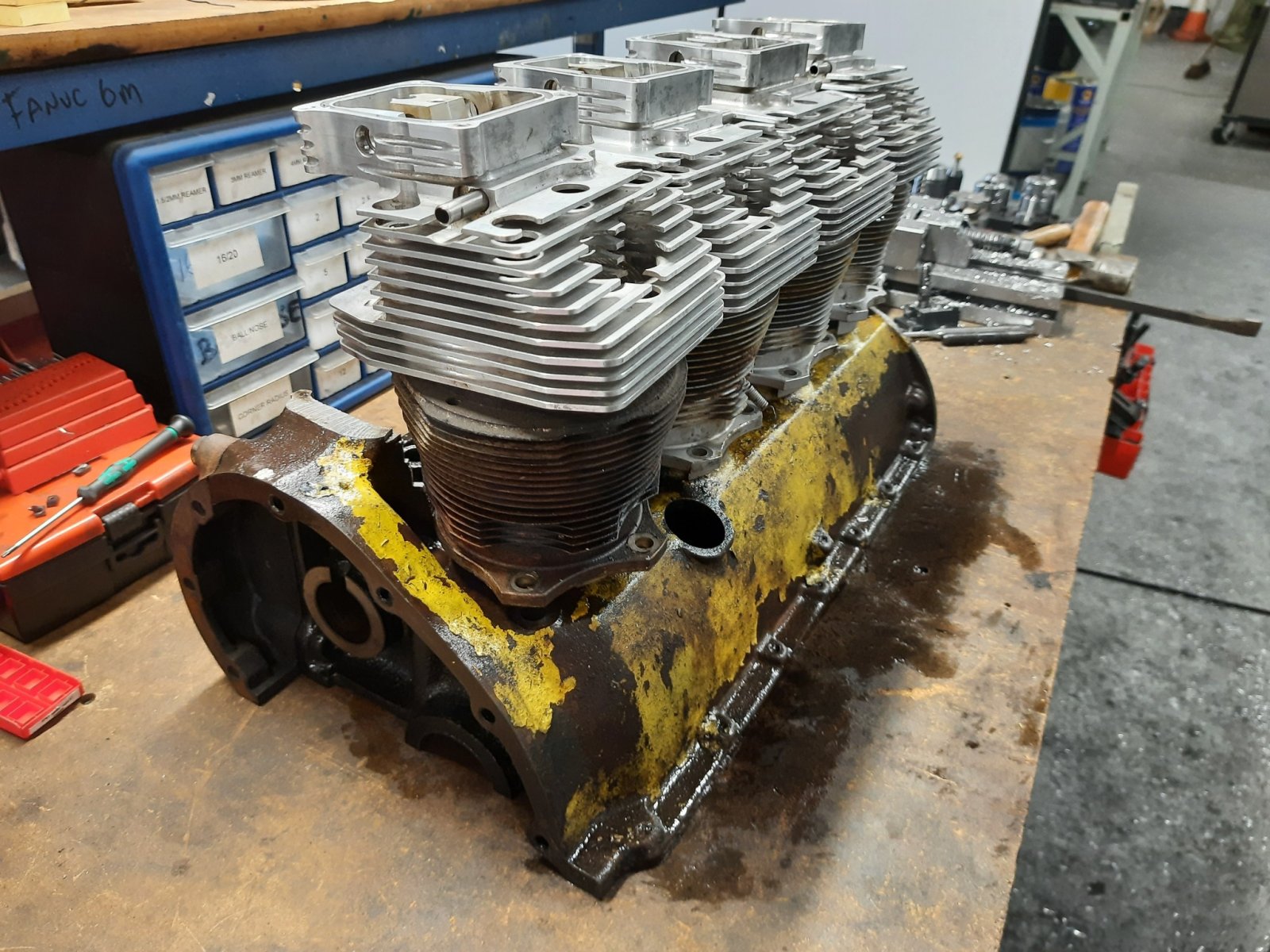

  22. 32B5C1E6-195D-4A8A-9B5E-A8B701EF5C0F.jpeg I meant to post earlier. Went to help Craig at RKE Engineering skim his block… It was an old BF engine with good white metal. He’d been donated some aircraft cylinder heads. Plan is to make a deck plate and new cylinders. Trimmed the block down leaving the cam tunnel and lifters in place. Going in a little single seater. He’s making barrels next.
    Outback, Jet96 and Old Dawg like this.
  23. The original aero engine is a 2.2 litre flat four. Similar bore size and a 3” stroke. Craig is planning to make nikasil coated aluminium barrels. Around about 4” to use a smallblock piston.

  28. The deck was fine although we found a crack in the water jacket whilst is was coming apart. Took a good few cuts to get through the deck 3mm at a time...
    It's a BF block. Small bore - you can see the rod clearance slots in my first picture. So pretty much useless for anything. The valves are angled closer to the bores like the flathead V8. But it came with a counterbalanced crank and good white metal.

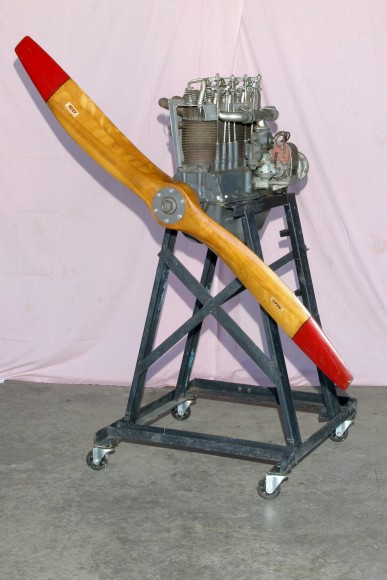

  29. Does anyone have knowledge on this distributor drive stand on this KONG cover?
    I think I took the photo from one of the SoSS magazines, but cant find which one.
    I've got a blank, and am looking to make some sort of drive gear for it off the camshaft. 288503714_582161710094860_4513811346712342088_n.png
