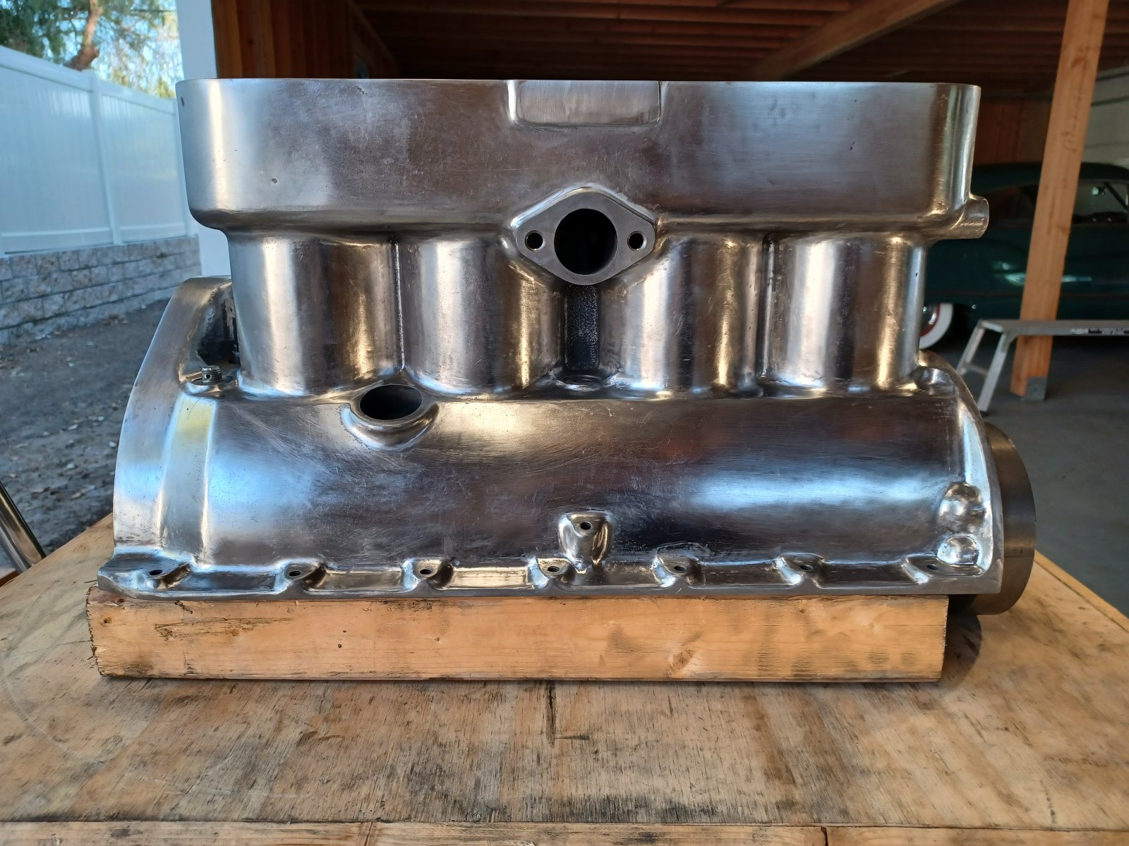

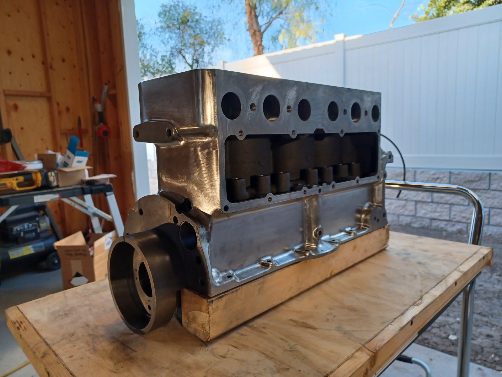

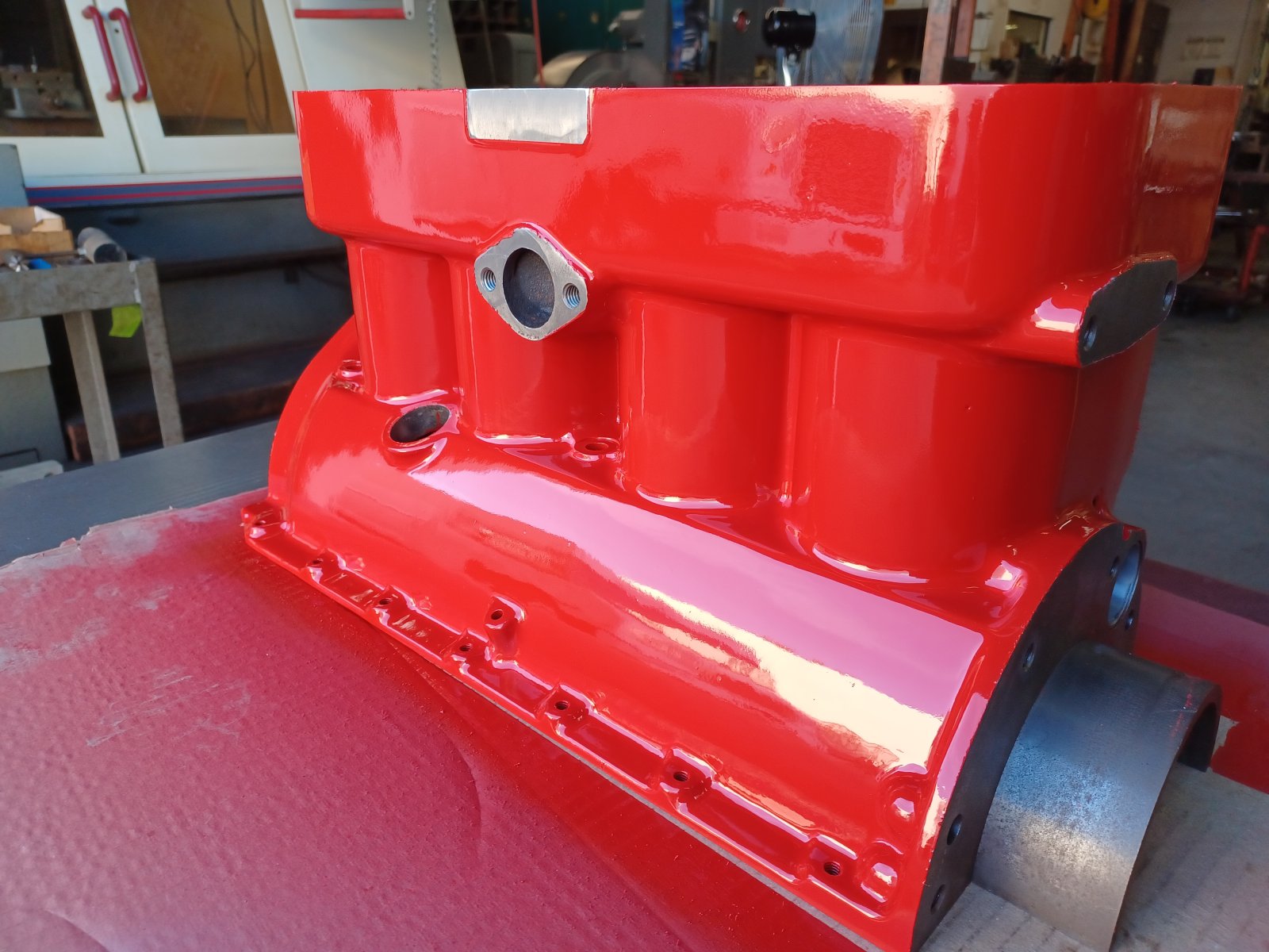

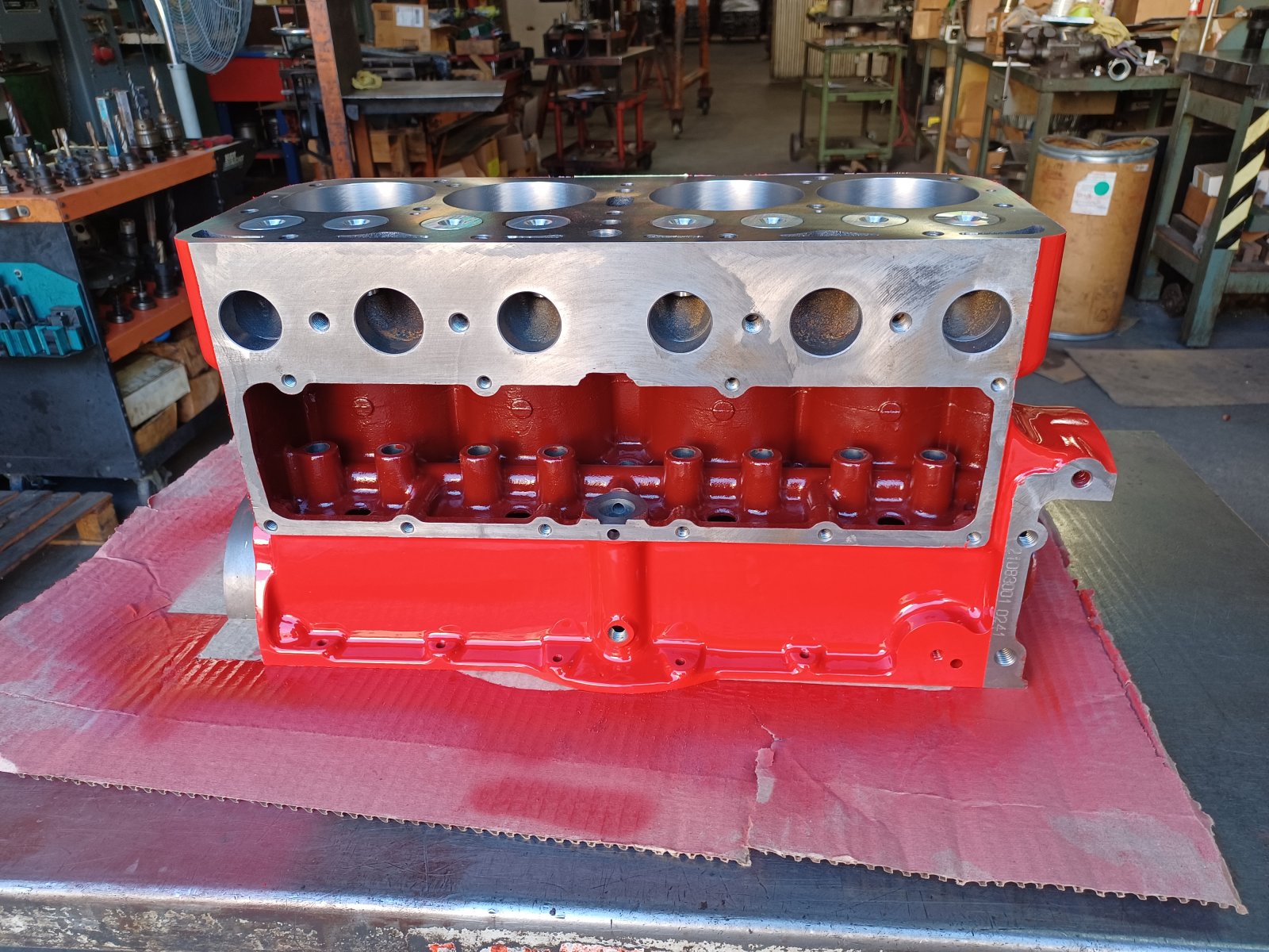

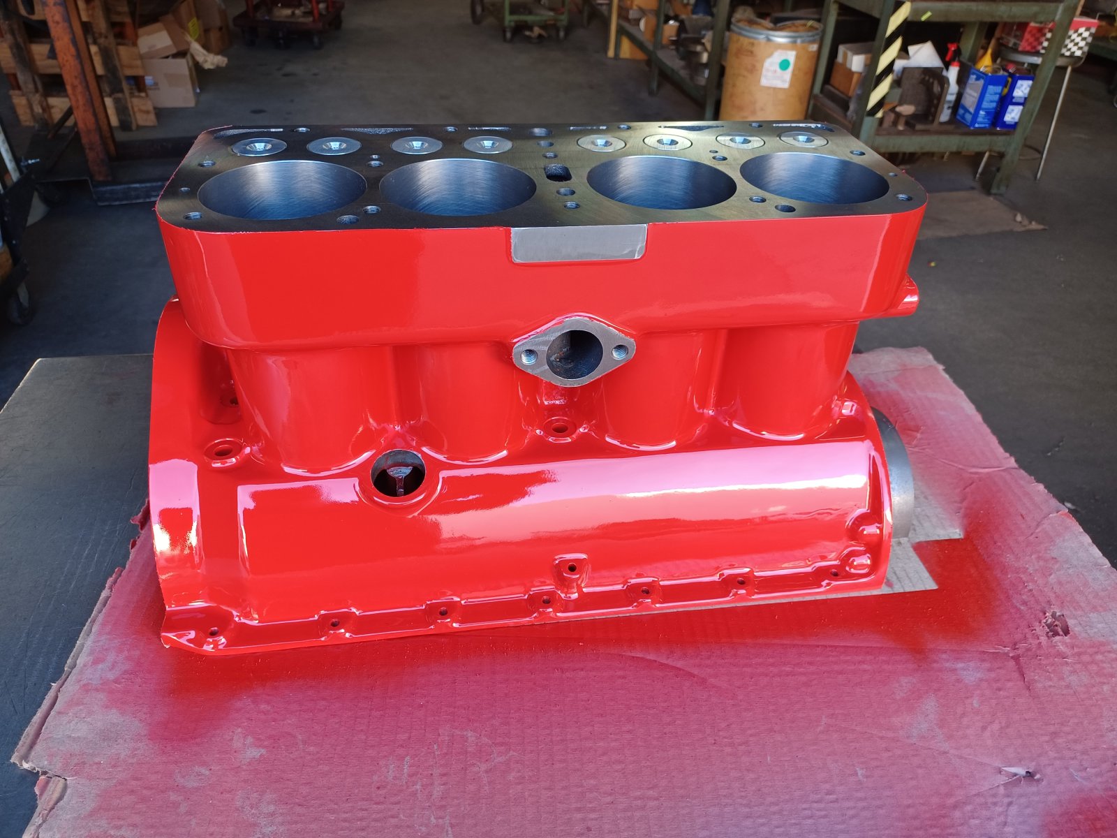

    Got the block painted. Slow progress.

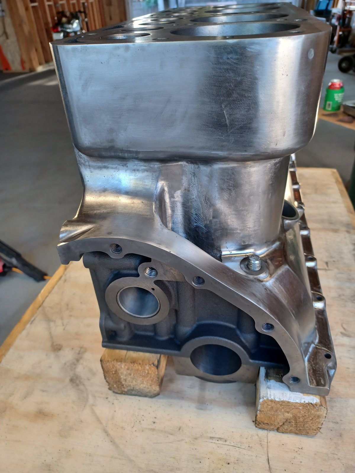

    @Crazydaddyo - Do you mind sharing how you got that so smooth? Just a lot of hours with the die grinder?

    Yes, hours of cleaning cast iron out of my hair too.

    Thanks @Crazydaddyo - thanks for confirming. Bonus points for sharing that beautiful block. Nice work. Looking forward to seeing what you're doing next.

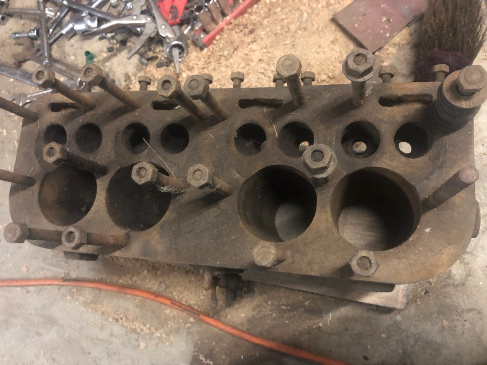

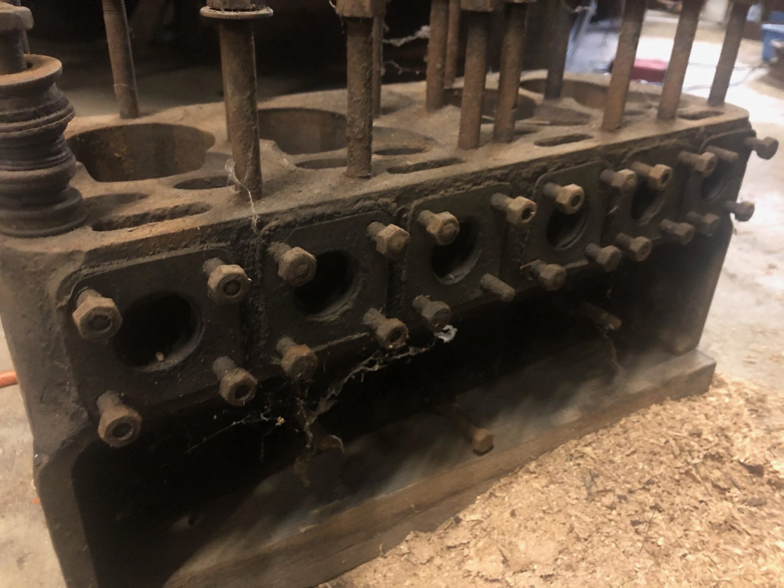

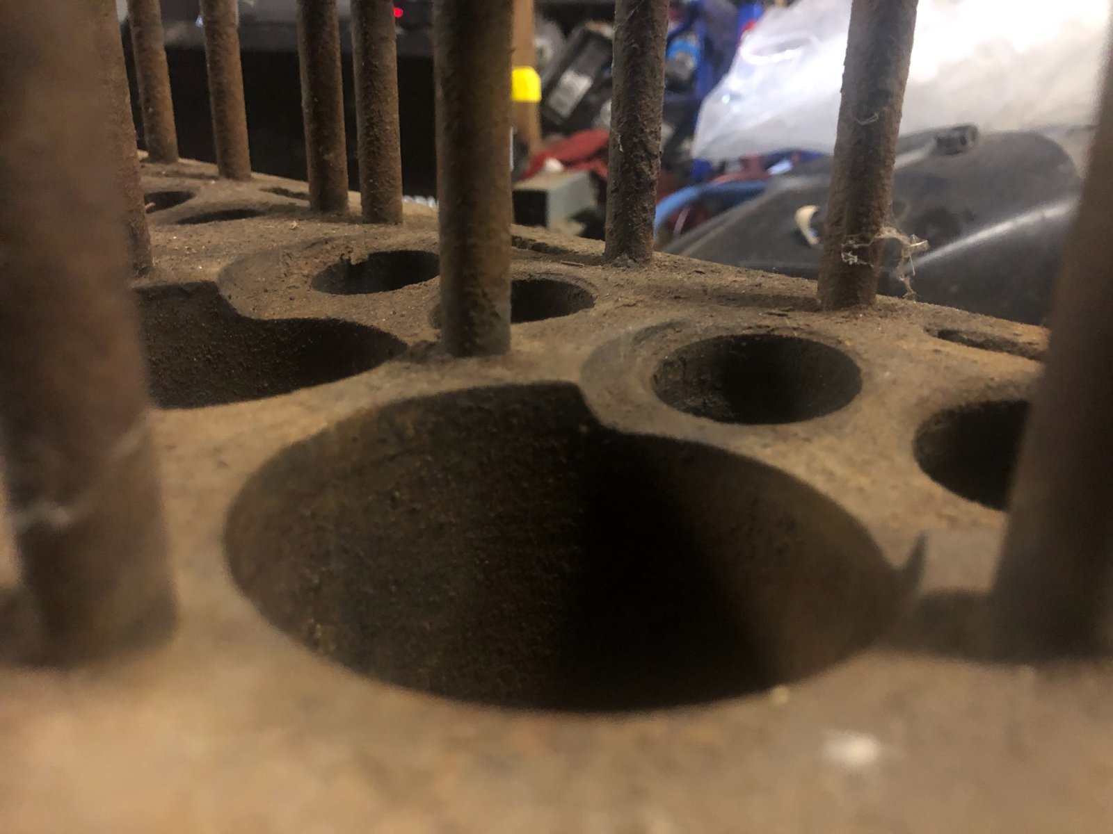

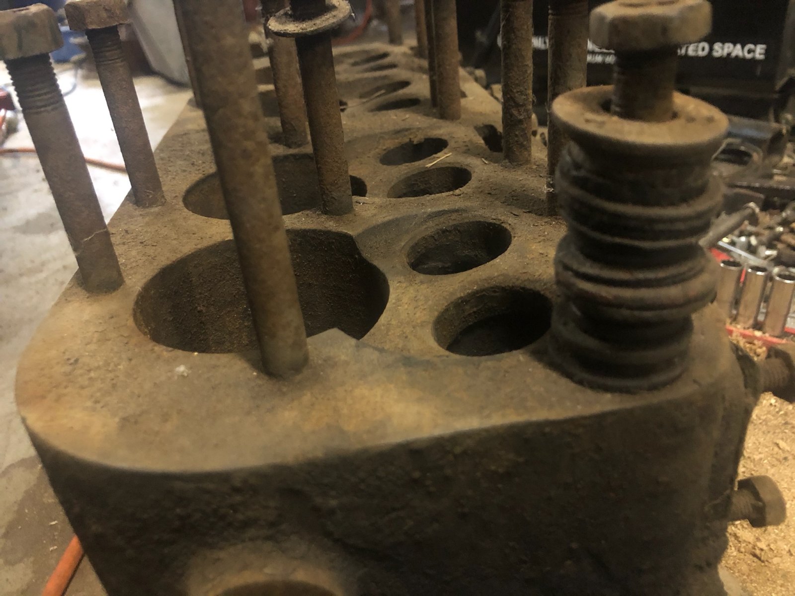

    Here's another English banger from the early 20's, this one is a side valve & one that I'm hoping to build with some American hot rodding influence. I think that you will agree that the inclined valves
    porting/ relieved block is quite interesting along with a Ricardo designed head.
    G Baese, Jeff34, fur biscuit and 3 others like this.
  24. How does the cam act on the valves? Are there rocker arms or is the whole cam bank offset to accommodate the angle? Very cool!!

    Yes the whole Cam/lifter Bank is angled in line with the valves. The block is separate to the crank case & has a full pressurised bottom end. It has 3 main bearings & is 140 CI

  26. Must be a design similar to that of Ernest Henri who brought forth the Ballot and the Peugeot engines in the early 1900's. These in turn were the basis of Harry Millers ideas that Leo Goossen put down on paper. All of which resulted in engines built by Offenhauser and Art Sparks.

    I'm not sure of the History of this engine design. It is a Vauxhall the little brother to the big car's - 30/98's - this is their 'cooking model' but includes some nice features. By 1924 (ish) they gained 8 ports & a 4 spd.
    I don't know how much benefit the extra ports would be, would be interesting to flow bench test them.

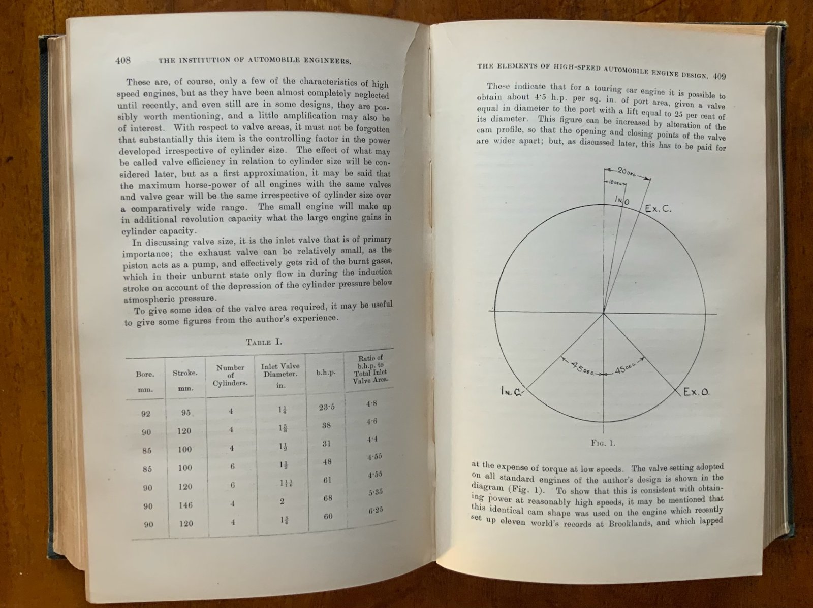

  28. If that's a Vauxhaul of that particular vintage, I'd guess and say Laurence Pomeroy.
    Attached is his write up from his presentation to the 1918 sitting of English Society of Automotive Engineers on cam design and spec'ing basis engine bore and valve sizing. Wonder how close he got to those numbers. Interesting book if you can find a copy. Not entirely certain, but maybe the first recorded use of I/E overlap in cam design.
