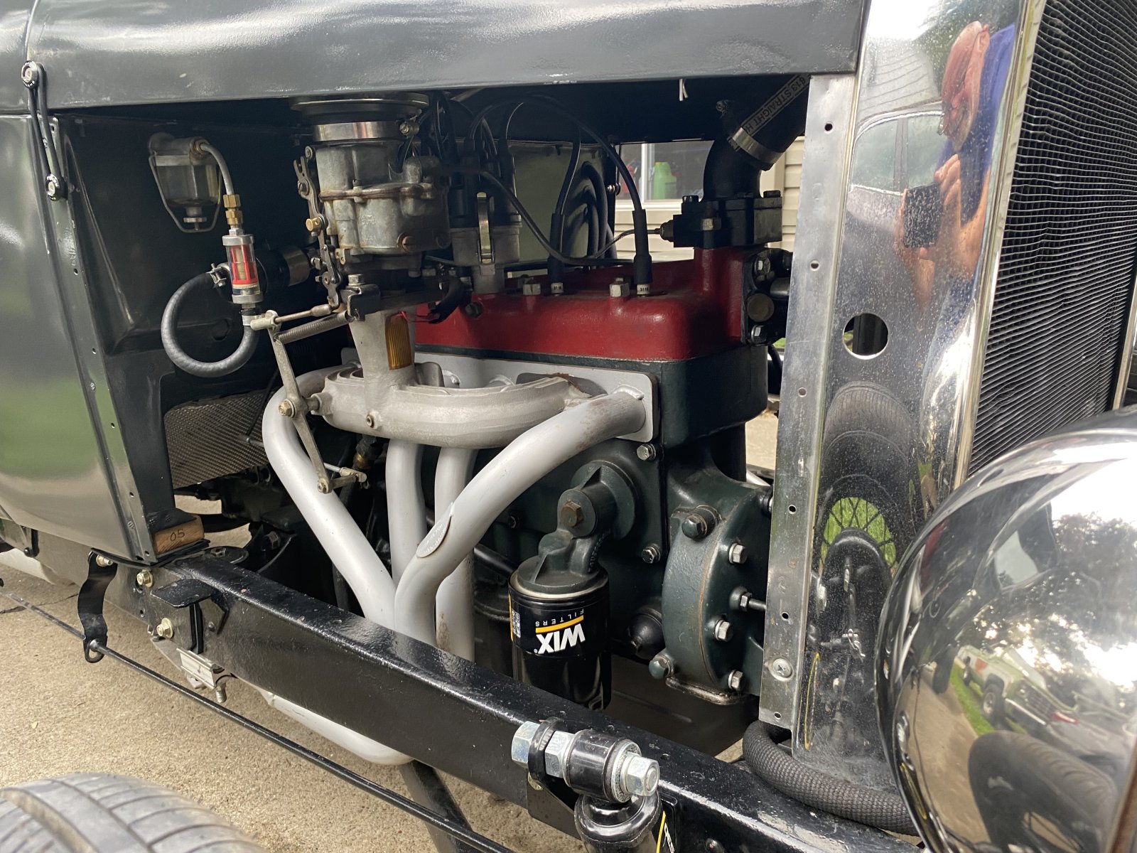

    Question for the banger guys and I'm sure it has been covered already. I have a stock model A engine and I want more HP. Everything I read says buy a head. Can you mill a stock head and get more oomph? If so, how much do you remove? If not, why?
    Thanks for any information, Ron

    If you want to go the easy way with a new exhaust / intake, these guys make pretty ok stuff and the prices are very reasonable in my opinion.
    http://lakeheaders.com/model_A_Banger_intake.html
    to wheeldog57- don't bother trying to mill a stock head to get more compression, as the results are not very productive given the amount of material that needs to be removed.
    Look into buying a head from Jim Brierley or Dan Price. Jim's head is a new design, and Dan's is the Thomas Head.
    wheeldog57 likes this.
