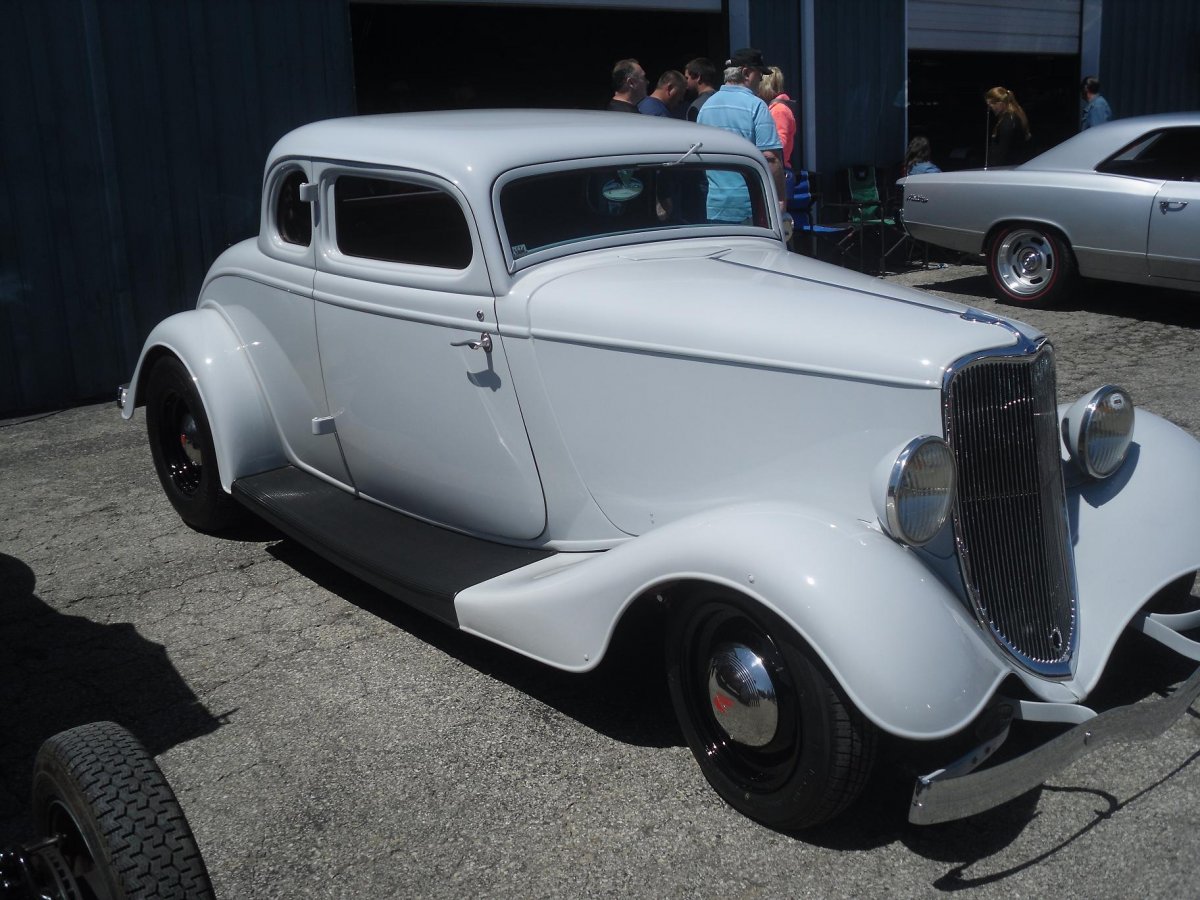

    looks great.... I chopped mine 4" 13164219_1262484633765032_4230557700881137556_n.jpg

    OK at the risk of "death threats", I will say it first, that chop would not have been my first choice as far as side profile but not everyone has the same taste! More appealing to me is texkbc '34. I would have to see the finished '34 maybe it will all fall together nicely. Having said that, do I have the talent to do what you are doing, I will know soon! Still watching to see where this goes..................................
    falcongeorge likes this.
  17. the only difference between my chop and teckbc '34 is 1/2".......

    My untrained eye say's there's more than just a 1/2" diff. just in the "A" pillar.
    This is a good example of why I don't post build threads, because of people like me!
  20. it's easy to make that mistake because there's no windshield frame in my hot rod. The frame fills up the opening and makes it look smaller. You'll see.....

    What catches my eye between the 2 chops is how teckbc top of door and front roof line have a clear downward slope to them, it's 2 diff. style chops. There is no rite or wrong just 2 diff. styles. Many years ago I personally didn't like "A" pillars leaned back, I liked the stock angle. Now at almost 70 I am leaning (pun intended) towards the "leaned back a little look" A pillar. Times change, I change but what hasn't changed is the little things that turn ones crank..........................
