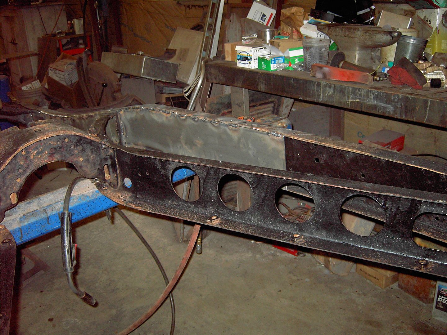

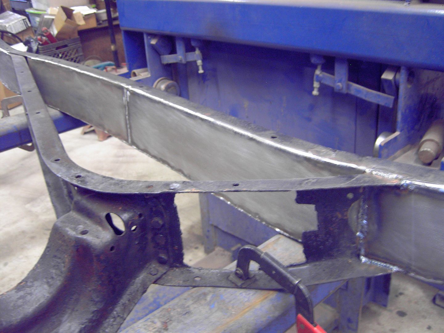

  4. well, I working on boxing in the frame........
    Icufltrn likes this.
  5. frame boxing completed, ready for the next step..........rear parallel leaf spring set-up....

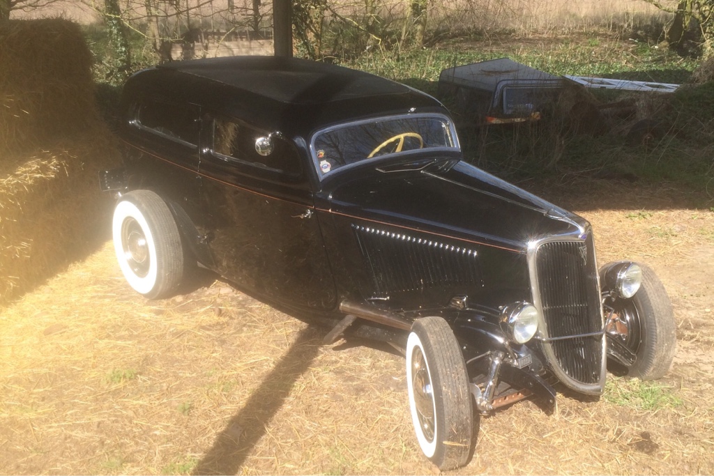

    Someone mentioned throwing away the left over parts from the chop. I hope I'm not repeating myself but I saved all mine and lo and behold. a friend of mine bought a '34 5 window chopped top car that needing some "changing". I gave him my left overs and it was a definite improvement. Pictures below. 005.JPG 002.JPG

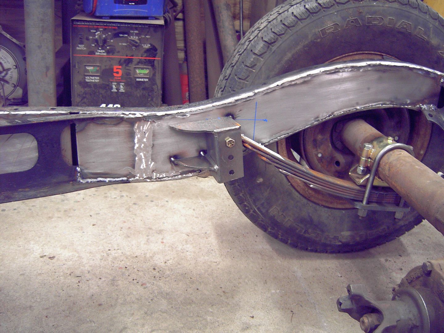

  7. well, we got the rear parallel spring set-up mocked in.....looks good and tires are dead center in the cars wheel wells......

  8. Looking good! How did you weld in those boxing plates without warping the frame all to hell??
  9. thanks man........
    you just keep alternating your welds, side to side, back to front.I usually just weld about 1/4'' spurts ,then after time the unwelded area decreases, then tie them all together.Plus, I had the frame secured to the lift bars.

    Are you going to put c notches in front and rear for suspension travel ???

    FYI, I C Notched my rear frame rails and put the rubber bump stops in the notch because with two grown adults in the back, it would bottom out. But I didn't C Notch the front. My rear is also hung with parallel leafs with the super slider springs, almost identical to what your doing.
    Looking at how little travel you have between the top of your rear axle, and the bottom of your frame, you're going to bottom out.

  17. I don't know about c notching yet. I have to get the front ***embled, wheels on ,motor and trans between the rails to get the front ride height. Then I can get my rear ride height and work on the stance I want.
    I'm not there yet. I have more to ***emble then I can make a accurate decision. I might end up putting the springs on top of the axles.

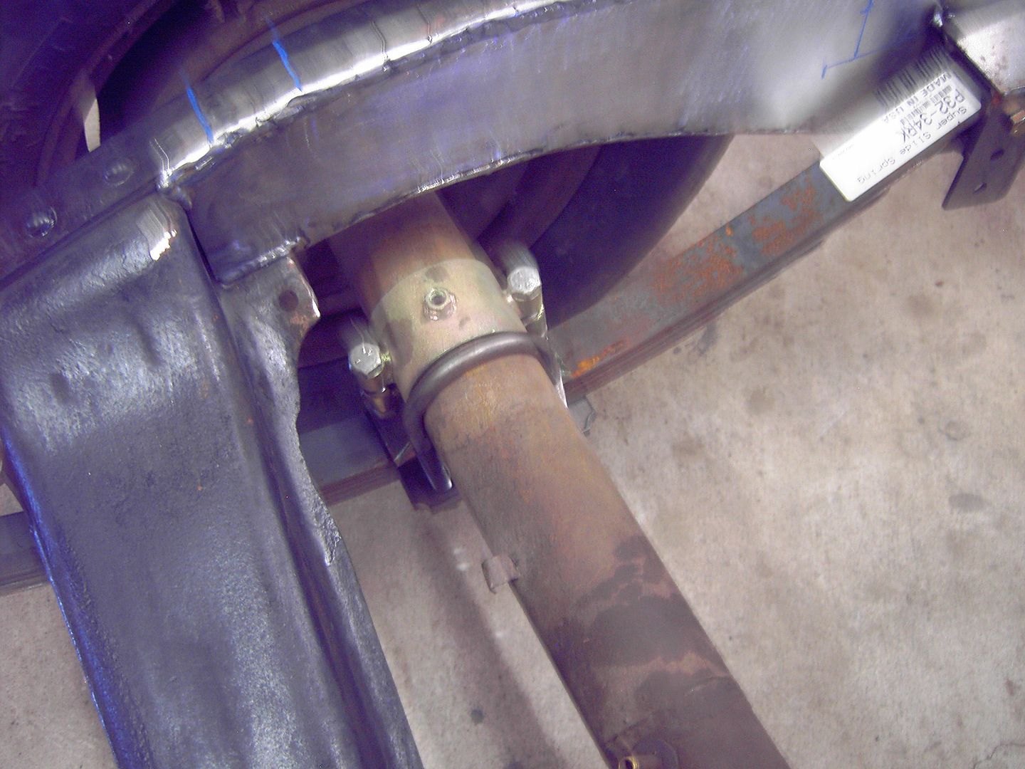

    Here are some Picts of the how my rear end is set.

    To use the f 1 front hubs ,you will have to use different inner bearing. If I remember the brg # is 14116. Also use a different inner seal and I can't remember that #. Use the search feature here there are several threads about the swap. With the rear springs in the top position of the front mount ,you will definitely have to C notch the frame. Might work in the middle or lower position, but you won't know until you mount the body , gas tnak , interior ,etc !!
  22. thanks 47 ragtop..........I moved the rear spring to the lowest hole now . I want to see how far the hemi pushes the front down ,then address the rear.

    Tim, I think its a kit from Speedway from a really long time ago. I didn't build the car originally, I got the car as a running project and have been re-doing things on it over time. I didn't change how the rear end is hung though, but I did pull the 8 inch rear out of it and put a 9 inch rear under it. But my rear spring are definitely the Posies Super Slider springs and the rear shackle and boxing plate is identical to 2345coupe's kit. The only thing I see different from his kit vs mine is that my front eyelet bracket is welded under the frame rail instead of inside the frame rail.
    You can see what I'm talking about in the picture above. You can also see that my rear axle tubes are on top of the spring and you can kinda see the "C" notch where I cut out the frame rail and welded in a piece of tubing. I think I used a piece of 5 inch diameter, 1/4 inch thick tubing cut about 3 inches in length, then cut in half. I didn't notch it all the way to the top of the frame rail; its an inch down from the top of the frame rail and the frame is boxed. I put a rubber snubber in the "C" notch and I checked the other day and I don't see any scuffs in the paint on the axle tube so its no longer bottoming out.
