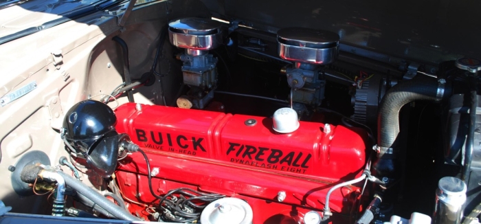

    Pre mounting gen/ alt. before painting the motor.
