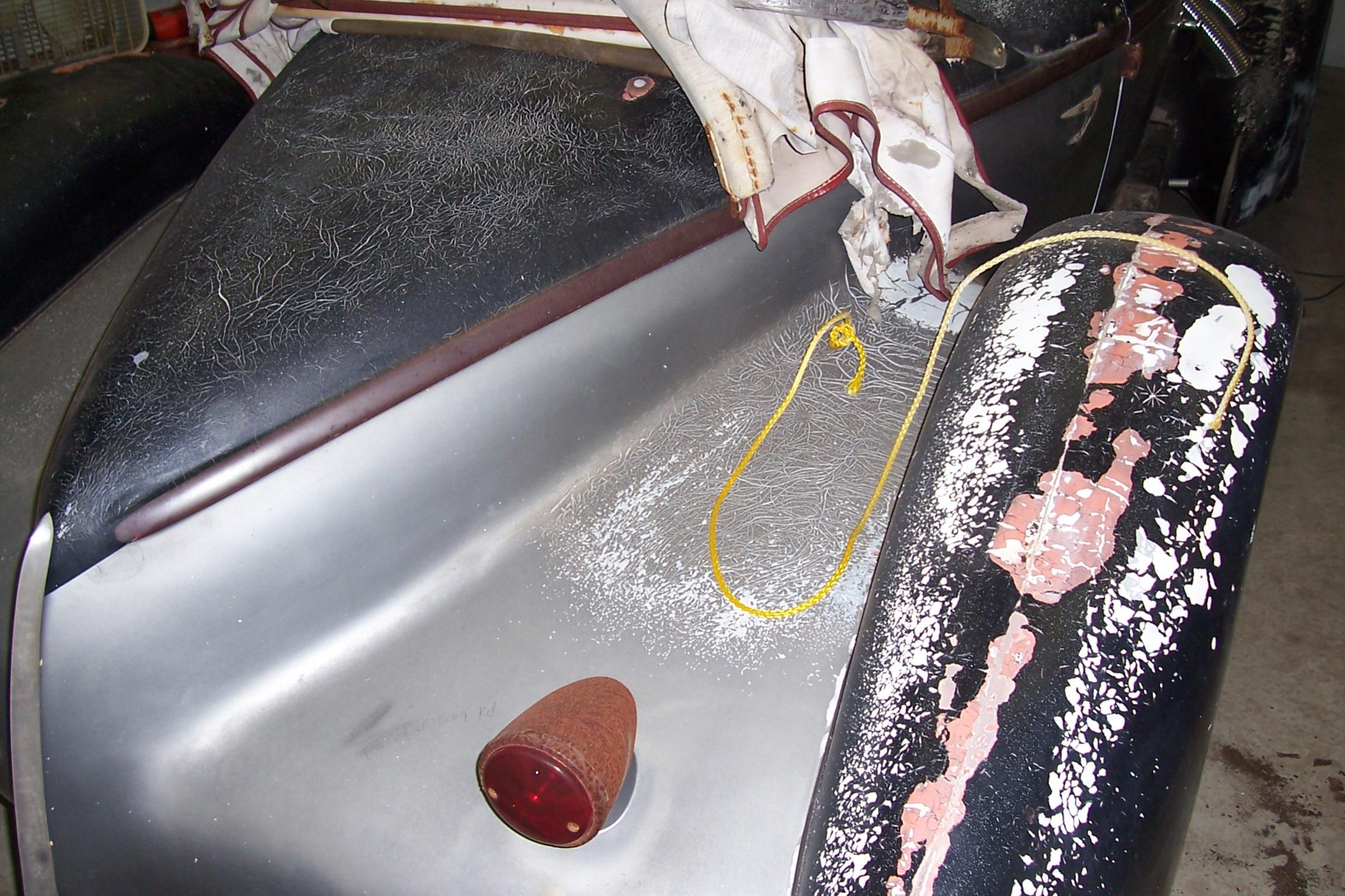

    What caused the paint on this fibergl*** car to do this..and what would be the best way to remove it without damageing the bondo or other filler on it paint remover or sodablasting or.....????

    The bondo's already damaged... anywhere uv or water came into exposure via the cracks.
    I'ts probably old old laquer. laquer dries hard through and through and is inflexibile. enamel skins over and takes much longer to harden. the door of my 62 galaxie looks just like that. 100_1383.jpg

    On the boat tail thing with the paint failure, it looks like someone sprayed lacquer right over the gel coat, incompatibility issue. I would first try brushing on some lacquer thinner on a spot and see if it will lift. As loose as it is, it may just bubble up and wipe off...if you're lucky.
    Back to the Cobra, considering it's summer I would first sit that thing out in the sun on a really hot day and let her bake before doing anything. Heed the warnings about getting all the release agent washed off before doing anything to it. I would use poly based products all the way.

    Hey Flathead okie... I suspect the others are correct. That looks like an aged lacquer paint job to me. Lacquer gets so hard and tends to shrink.The fibergl*** swells and shrinks. Virtually every old lacquer job looks like that.

    Featherfill will get it done top notch, but be sure to get all the release agents/wax off of it before you prime it out...

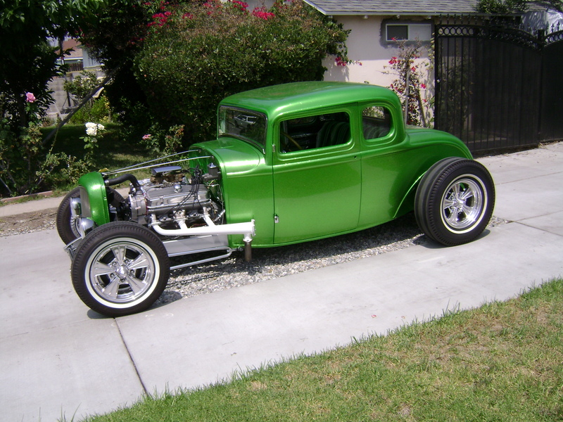

    groucho had a beautiful 32 5 window that was a gl*** body, maybe he might have some pointers as well...
    here' a pic:
