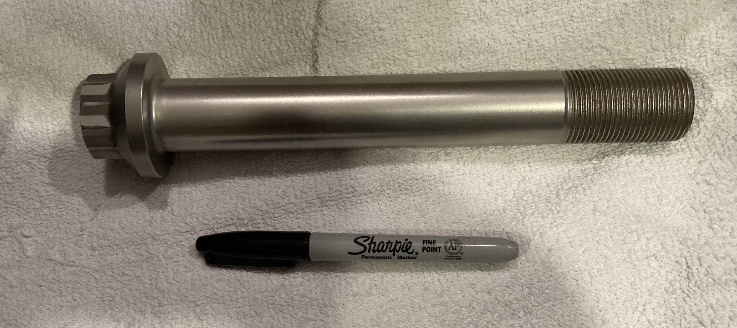

    I know we’ve talked about nuts and bolts before, and with the changing times we are living through, I started wondering where everyone was purchasing quality fasteners from. That one in the picture is one of three that held the engine stanchion on the wings of the DC10s, which as you may recall, lost engines on occasion. The worst accident took the lives of everyone on board. I had a contract with the aerospace fastener industry to perform certification tests for a new generation of fasteners, in particular the materials used to manufacture them, after that accident. The FAA requires a series of tests before they will approve the use of the new fasteners, and there is a series of testing that is performed in groups of 3. Ultimate tensile strength, fatigue resistance, stress corrosion cracking, and 4 other tests, which I cannot remember. The company sent me 24 of these bolts to test, and at the time, approximately 1987? they cost just under $400/each!
    That bolt above has been on every one of my desks at the labs I worked at since, and has never corroded from being handled. I have never oiled it, or even purposely wiped it off. It still looks new. I would love to use that quality of fasteners to ***emble the whatever project, but I think I would go broke buying them. So now I’m looking for information about reputable brands and sources of quality bolts. The first one that came to mind is ARP, and they have lines of non-engine specific fasteners, however they are expensive.
    So, bottom line, besides risking hardware store fasteners are actually grade 5 or grade 8, where do you all get your fasteners from?

    One thing and I'm sure you're well aware of is aircraft hardware specifically bolts and nuts are chosen for specific stresses and applied accordingly. So while it might be strong as hell applying it to a automobile application may lead to catastrophic situations including death.
    So what I'm saying is being an Aircraft Fastener doesn't mean it will work anywhere. The other caveat is the same principles apply to ANY fasteners used in Automotive applications...
    I am a former MDC employee so yes that's a beautiful Bolt and it looks like ***anium...
    I recall using a ***anium bolt in my mechanical brake clevis on my rear brake rod of my 1957 Hydra Glide and in a period of a year or so it wore half way through the bolt. So I was surprised but obviously not aware this type of moving contact was not a strength of ***anium.

    @Dave G in Gansevoort, that bolt was used in an application were all members involved did not move...the stresses were there but nothing that would wear or stress the bolt to failure under approved flight and maintenance procedures.
    The accidents you mention were caused by improper maintenance operations by the Company that purchased the Aircraft. They literally used a forklift to wrestle the engine off or on fatiguing the structures. Not the right method at all.
    Unfortunately the big finger gets wagged towards the manufacturer in the process. Didn't mean the culprits didn't pay for it as well...but it was ugly...we made those wings too...:oops: That aside Manufacturer's are also not immune to failure either. In the case above they were immune although affected.
    We feel the pain no matter the cause...

    No, it’s a cobalt alloy, and extremely tough, while also having a very high ultimate strength of 190,000 psi. It had approximately 15% elongation at yield. That bolt was 1.5 inch diameter, so when one finally broke in our 1 million pound load frame, it sounded like a cannon firing!

    Yes, I know. We had those new bolts long before the results of the accident investigation were released. And what prompted me to start this thread was I saw a show on Science channel or National Geographic that was about that exact failure. Battelle people were involved in that investigation, and probably were helping with the fatigue investigation, as they had one of the most powerful SEMs in the country to evaluate the fracture surface.
    That show was a bit misleading, inferring that the cause was determined within weeks of the accident. I believe it was more like a year or more.
    So back on topic, yes I’ve used Supertaneum fasteners, but thought they had gone out of business. My friend Jim had one of their selection setups, that the regional rep would stop by and refill on a routine basis. Jim was a fabricator and built race car ch***is along with the other work he took on to stay in business when the car side was slow. So it’s good to know they are still available. We have a Fastenal locally, and I’ve bought some fasteners from them, just didn’t know what the quality is.
