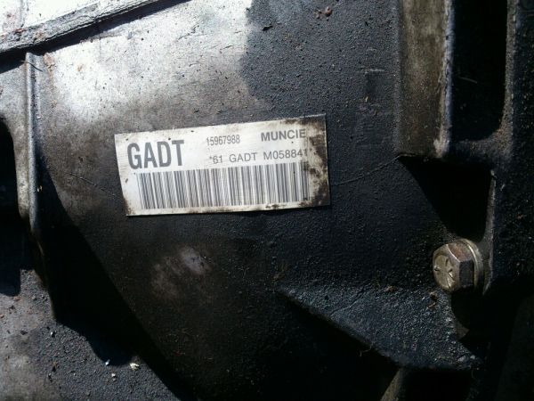

    It needs a 168 tooth flywheel, 11" clutch from a 1998 C1500 2WD 4.3L, The hydraulic throwout takes the place of all the old stuff. Unfortunatly the OEM one has these weird press lock fittings, so you have to run OEM style clutch line unless you do this.
    buy this fitting, press the roll pin out of the stock hydraulic throwout and you can run standard line instead of the modern Push lock stuff. will help with throwout issues.

    Ive tried looking up the numbers on the tag but it keeps coming up empty?
    Heres the tag if somebody can help me identify what Im working with? Thanks guys
