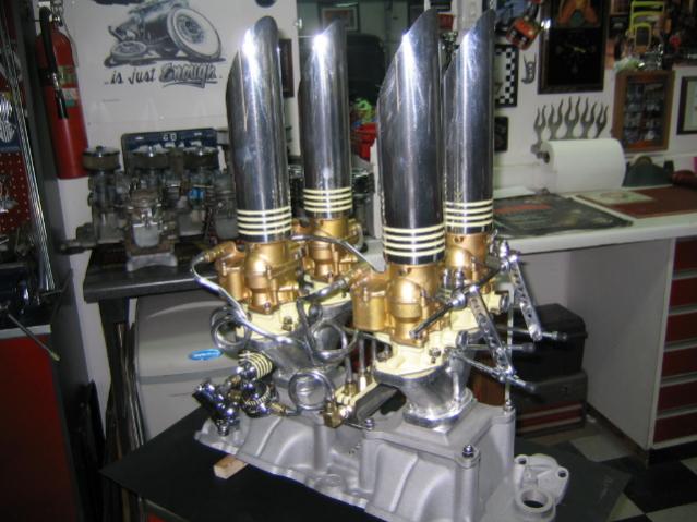

    Wouldn't that run lean when the two fueless carbs dump a bunch of air into the motor?

    I had collected parts (two 2x2 adapters an a 2x4 intake) to do that originally on my 29 before going with the 6x2 set up.
    that looks really good. what dual carb intake did you start with
    pastduebill, you block off the fuel to the two carbs you are not running in addition to blocking off the bottom of the carbs to the intake (thin sheetmetal plate) so no fuel or air is going thru them

    I need to ask a question..wouldn't it be much safer to run steel lines from the fuel pump up to the carbs or fuel rail?
    and use hose for the area that would be subject to "flex"? like from frame rail to fuel pump?
    rubber hose on top of a hot manifold just looks like a fire hazzard to me.
    and if you are going to run dummy carbs ..I would agree to at least make them look like they are in opperational part of your set up.

    I was wondering if anyone had done this...

    Sorry guys, this is nothing new, "been there, done that, got the t-shirt, and already wore it out". I have built a number of these over the past few years and they work well with all 4 going especially (and you'll like this Duane-Stromberg97) when using strombergs.

    Awe thanks , check out the attached pictures. Now can I have a HAMB shirt, size 3x in a real man's size?

    would rochester 2 cg's work on there?

    No, there are to long. You couldn't get the dizzy in. And by the way, that's 2GC's.

    Its different, and I like it. Lets see updated pics with the better fuel lines hooked up!

    I tried a couple years ago to put a couple of those adapters on a tunnel ram, but the center carbs wouldn't clear each other. Looks cool!

    Hey ****ster set up looks cool, how does it run with those spacers on the 4x2's. Does it clear the dizzy o.k.??

    Yip, a Mallory falls right in with not only dizzy clearance but the wires aren't jammed either. The risers help to atomize the fuel for a little better efficency, plus is necessary as Dixon states to clear the dizzy.

    Hey brother, welcome to the HAMB. And to everyone out there, Brandon has this set up dialed in and it runs as great as it looks. Dixon is an innovative young guy who builds his own ****, and does it damn well - his hot rod is driven and raced every chance he gets. Plus he is one hell of a rockabilly b*** player too!

    Tell me about it please??
    Who made it?? Custom??
    What distributor fit's that thing...stock points style clears the rear carb?
    Very nice!
  24. Well, it's not custom but an aftermarket cast aluminum intake. The manufacturers name has been ground/polished off. As far as distributor, it was originally set up with a distributor angle drive to clear the rear carb - I'm trying to find one as I WILL run this setup on a SBC in something, just not sure what yet. Have a nice, low mile 327 on the stand as we speak, may go on it.
    Oh, and it's an Inglese intake, it actually was equipped with 4 Weber DCNF downdraft carbs (which I also have). Makes a smallblock look kinda like a vintage Maserati V8.
