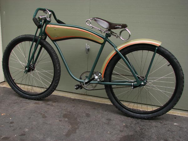

    Seriously though, along the lines of what Jeem said, do your legs or knees hurt with the seat that close to the pedals? Do your legs get extended enough at the bottom of the pedal stroke?

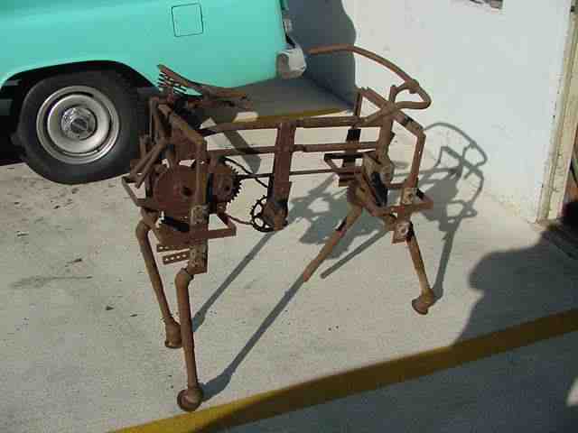

    Very nice but it doesn't walk :eek:

    Maybe an optical delusion, but in the 1st photo it looks like maybe the fork is bent back like from running into something in 1950?[​IMG]
  7. SUHRsc
    Joined: Sep 27, 2005
    Posts: 5,098
    SUHRsc
    thanks guys
    it doesnt walk.....but that looks like a project for the future! :)
    the forks were bent on both bikes
    i straightened the one i used a bit...its not bad now

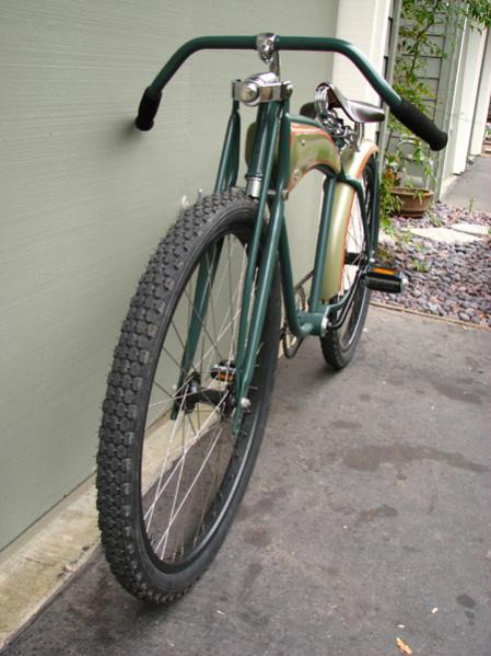

    Zach, did you just use mild steel tubing, or did you use a reynolds/nova/etc tubeset? I've just been getting going with my TIG, hoping to get good enough to weld up my first bicycle frame this winter. Do you back purge the tubes, or just leave them open?

    bcarlson,
    i just used mild steel tubing, no back purge....didnt think it was that crtical for a cruiser bike
    i used mostly .063 thickness so its a bit overbuilt anyways
