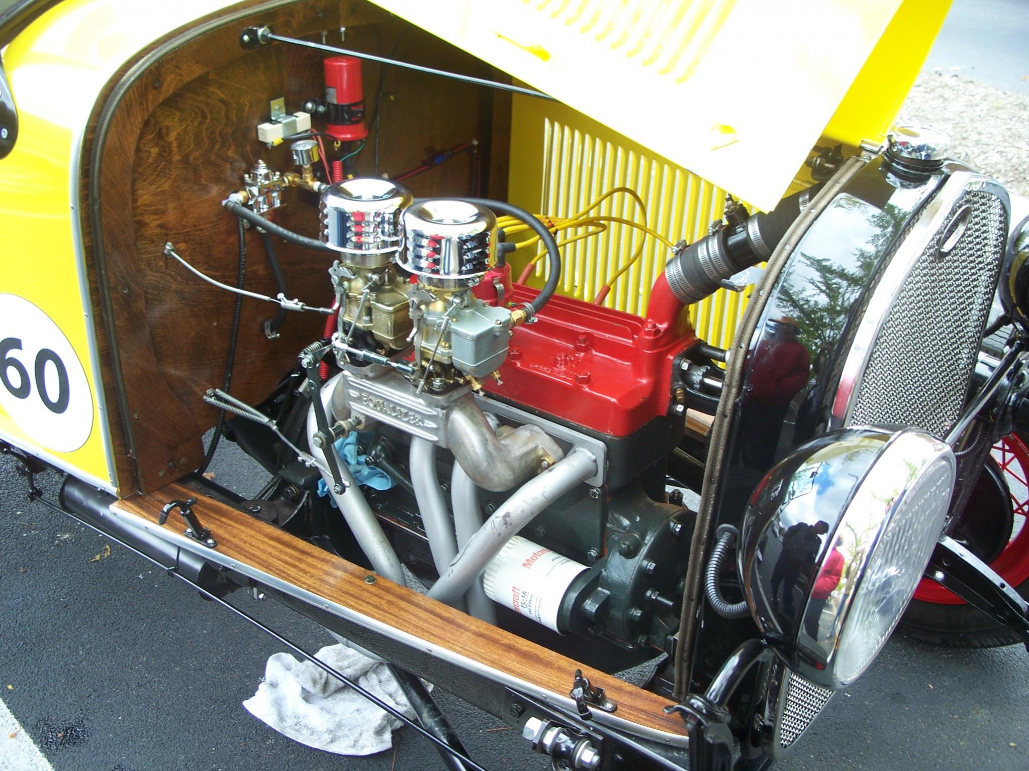

  26. If you check back to post 92 of the August Banger 2011 thread; you will see that I had a problem with the "B" four banger in my new roadster.
    I asked for help to solve my problem of the new Zeniths flooding and our Pal Bluto came to the rescue with many things to try in post 93. After checking off the to do list this is where we were at....
    While I was trying to get it fired on Monday after getting the Zeniths back together, I thought I had better check the new Mallory distributor. I filed the points and It started right up. It ran for a bit then it just stopped and it wouldn't restart until I filed the points again. I took a close look at the points and found the litte felt pad that the lubricates the contact arm was getting screwed up and changing the gap on the points. I thought that with all that I would be driving the car, I removed it and reset the gap. I had the little roadster running on Tuesday, better than it has ever run before. I wanted to take it out on the road Wedneday morning when there wasn't much traffic so I did bounce up and down on the front of the frame while it was running just to check if it would flood and it seemed fine. Car starts nice and runs great so on Wednesday we did several laps of the neighbourhood and guess what.....no flooding. Now Bluto, I was wondering if in fact my primary problem was the points all along and because the engine started back firing and not burning the gas the way it should, the gas was flooding out the throats. It did have an electric pump on it at the time but now it has the rebuilt mechanical B pump. All because the little piece of felt was screwing up the gap. It will be interesting to hear what you think.:confused:
    Thanks for all of your help Bluto,
    Ron
