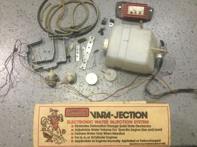

  10. tomcat11
    Joined: Mar 31, 2010
    Posts: 1,156
    tomcat11
    Torco or Klotz.
    Remember these: Vara-jection.jpg from the 80's

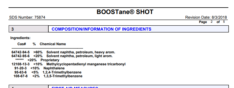

  21. Mimilan
    Joined: Jun 13, 2019
    Posts: 1,251
    Mimilan
    You need to download the chemical properties
    Basically Liquid Mothballs
    Tman likes this.
