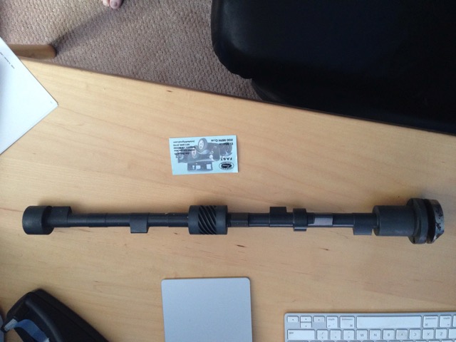

  5. So the "lobe" on the right half of the cam (halfway between the center and end bearing surface is for the fuel pump?

    1. Ford A and B speed
    This should help, you can see the fuel pump looks green for some reason. cam 2.jpg
