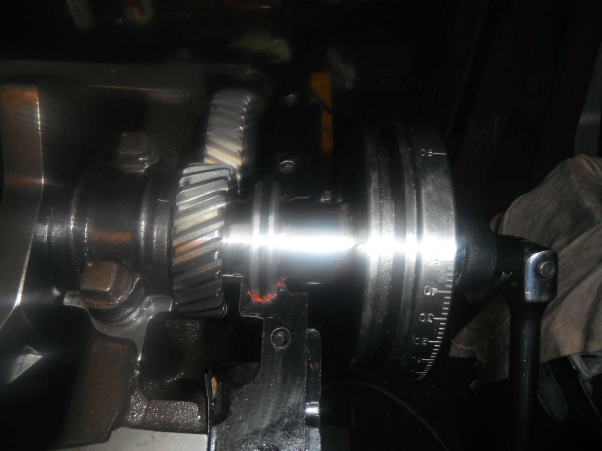

    Sandman, I too feel your pain. I broke two Model A crankshafts with my set-up before changing to a Burlington crank with billet caps and Skokie forged rods. Apart from the rather high compression you noted your engine as pictured does not appear to be too radical, so I am a little surprised at a new crankshaft breaking in so few miles of use.
    That being said, I am convinced that the biggest contributor to my crank breakage was too much timing; in retrospect I could feel the engine fighting itself at higher rpm's, which I believe was creating the twisting forces that lead to failure. If you are running more than 24-26 degrees of total advance I would dial it back and start tuning from there. I have a crow's-foot Winfield and use 24 degrees of total advance since I installed the Burlington crank. First two cranks lasted about 800 miles each, but Burlington is now on its fourth season of use (we have seasons in MN).
    530sandman likes this.
  12. Thanks for the advice. I'm not exactly sure of where my timing was. I was actually thinking about advancing it a little, I have already killed two expensive digital timing lights with that Wico Magneto and solid copper core wires. I think it was around 23. Anymore would've killed my starter, actually it did kill it and I just installed a gear reduced snap starter two days before. It would start with just a bump of the ****on. And it has never dieseled. This is why I was thinking of a little more advance, but I was gonna play with it up at the hill climb race site while changing the jets and swapping out the quick change gears. I've been told that OHV use more timing than Flat heads. Sometimes I wish I just stuck with my Winfield red head crow's foot and single Winfield downdraft carb and just added oil pressure.

    Here is a harmonic balancer I been using for years to save my cranks
    It is a unit made for formula ford and like Dans needs a adaptor sleeve it is just 1/4" dia larger than a stock pulley 33 engine 002.jpg 33 engine 010.jpg
    Model A/Bs have just about the worst harmonics that you can find in a crank design just try revving 1 at 5000 rpm with and with a harmonic balancer and you have your answer

  21. I find starter drive breakage is usually from too much advance at cranking speed. This is from my personal experience. I also feel that the import drives have brittle gears as compared to older domestic gears. This is pretty common with the conversion needed with a flathead V8 flywheel. It occurs when the gear doesn't engage deep enough, I think.
  22. The stock starter didn't have a problem starting my Winfield 7 to 1 red head with Wico mag but when I changed to an OHV with 10 to 1 even with exact same timing the starter didn't last!
