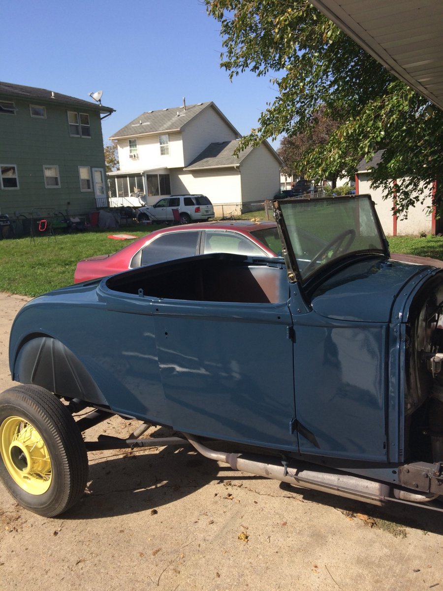

    Sprayed a little paint on my roadster today

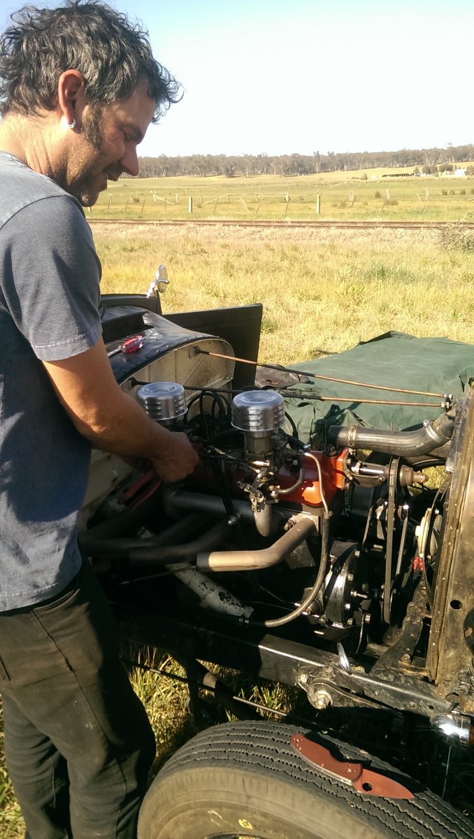

    870 miles round trip avoiding the highways to do a little dirt dragging at Chopped ( Newstead, Victoria, Australia) roadside repairs, and camping under the stars. Pretty darned good fun, all up.

    Sounds like a gas edfueler! I love road trips, especially out of the norm ones!!
    More pics and more of the story if you can. Great looking cars too, more info on them as well.

    The paint color was supposed to be ford dark blue but the kid messed it up and it came out light blue, so we added more blue and a bit of black. I can get the formula if you'd like.

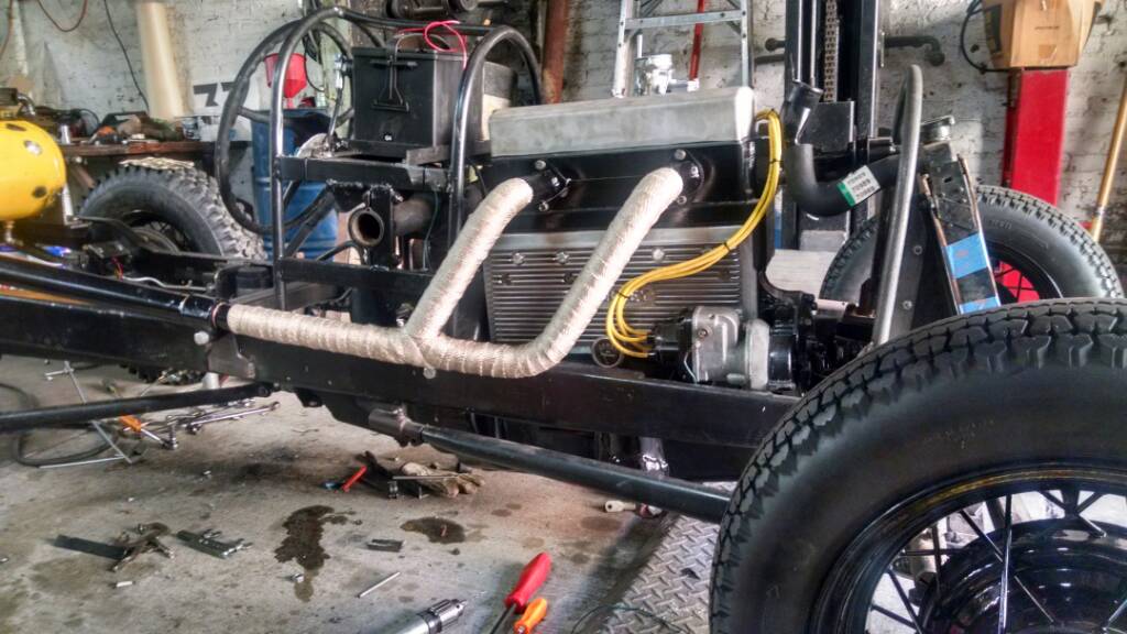

    That Newens overhead motor is in and its a rocker. Can I post video on here? If anyone wants to see it, I'll have it in Wildwood this weekend.

    Here are some other photos of the bangers we drove to Chopped.
    They were built by my friend Joelo Rock'n'rollo and myself, outside in the driveway and in a small single car garage, winters and summers, days and nights. I would call them "poverty-rods", definitely not rats but they are made with a lot of re-purposed found objects.... and some purchases from an online auction site. Snyders has been helpful, as has Henry's in Australia. They are changed continuously as they are driven.
    The US left hand drive RPU is mine. It was bought as the stock running gear from under a coupe that was getting the SBC/Jag rear end resto-rod treatment. Some fabbed bodywork from someone's discarded project was acquired along with an original Right Hand Drive 1928 early Australian delivered cowl. (all bought because it was cheap). The grille and lights are stock 31 which came with the running gear. They'll be changed to something a little sleeker when the priority is there.
    Unfortunately the diff appears to be a 4:11 (great for dragging and second gear starts on the dirt but hopelessly slow on the open road). The interior and bonnet panels were made from some interior aluminium panels from a 1947 Albion Double decker bus. The seat now comprises some industrial foam skinned in the leather from my folks' old lounge suite. Before it was a couple of yoga mats covered with potato sacks. The tailgate is a re-purposed revlon make-up display shelf.
    The engine is babbitt and splash. It has a gentle touring grind cam, Thomas re-pop 6.7:1 the 97 only seemed to start working with 41 jets (seems really small to me) and an electric pump. Previously an 81 with 39s with gravity feed with a really fat hose seemed to work. I have a FS zipper as of two dizzy changes at Chopped. It seems to advance a little much for the compression I may have to have a look at the stops on it. The 35 wires were gathered from all over the place including a wreck out in the desert. They were painstakingly torched and beaten straight by us. The 7.50 tyres look too big while it sits at stock height but I needed all the help I could get before the taller diff gears go in. Until the re-babbitt and engine machining, the tyres were the single most expensive thing on the car.
    The Turtle deck roadster is an early 28. It was a broken down shooting buggy that stopped in 1971. We got it to fire but you could move the pistons around with your finger..It had coca cola box cardboard for gaskets. The ch***is has the early solid engine mounts and dog bone equaliser brakes (Teds floater kit in the front) It now sports reversed rear spring eyes (we did this in a press) a few leaves out, front and back and a channel job over the frame. The radiator is a 31 that hangs over the front crossmember in that old and awkward get-it done fashion but is nicely concealed behind the original 28 grille. We hand beat the cowl and put a chevy truck cowl vent in. We rolled the doors up ourselves as an experiment in bead roller use. The tub and hood sides are '28 dodge narrowed and lengthened accordingly. A sort of scaled up 22 T model turtle deck was fabbed by Joel. It has a babbitt and splash re-sleeved motor we put in on the thursday before leaving. It has a Snyders 5.5 head and runs a Holden six cyl stromberg single barrel carb on a modified B model manifold on the road and a pair of them with straight pipes that get changed out on site for track duties.
    I guess the spirit of these cars is to be as traditional as we can with the pragmatism of using readily accessible and found items (we run old alternators that were kicking around the yard instead of generators for instance..Shamefully, the subframe rails are all just RHS steel but we try to keep those dirty little secrets hidden. They are intended to put smiles on the faces of children and old people alike (klaxon horns are a must...Joel's came out of a dumpster) but also so that we could enjoy tasting the idea of racing using early and esoteric equipment.
    During the Journey to and from the drag strip we had failed fuel pumps, fouled plugs, carbs to re-jet (Thanks Rod Hadfield), a broken water pump, a pulley needed to be grabbed from a rusted motor in a friend's yard in Glenrowen (Thanks Outback Glenn), a replaced distributor (Thanks Keith) but our breakdowns seemed to entertain the onlookers and we were never halted in our progress.

    damn nice motor ! congrats [​IMG]
