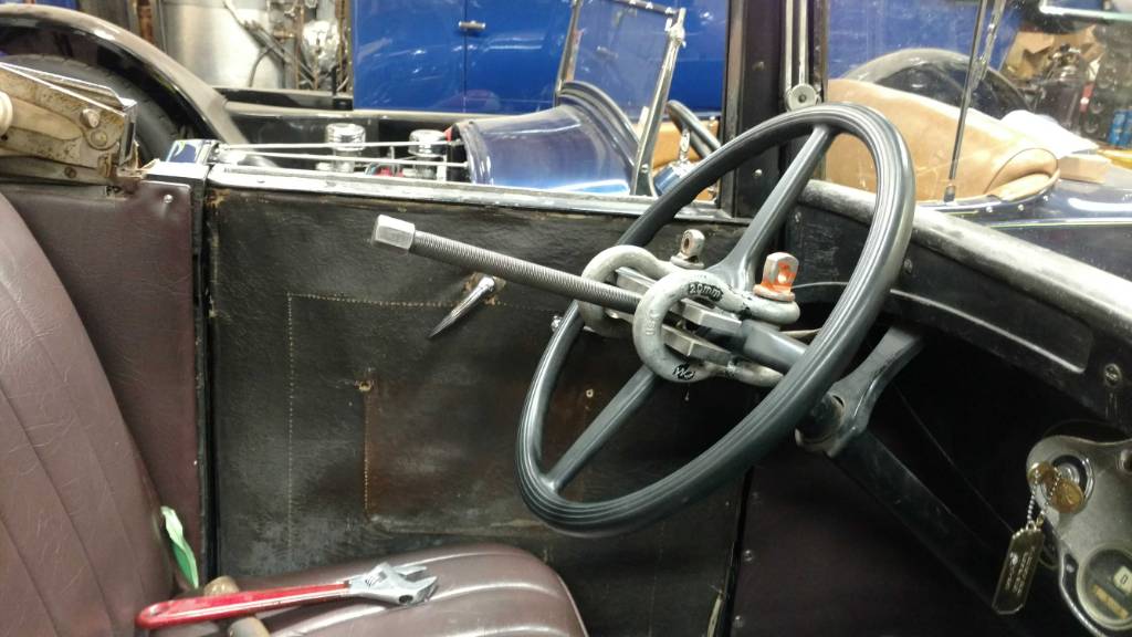

    Got that stuck steering wheel loose off the shaft. Bet it's the first time off since Henrys crew installed it. 1603835234541.jpeg

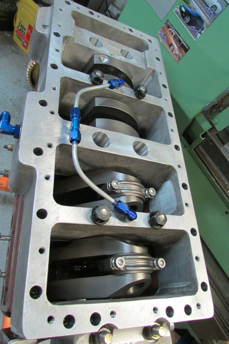

    I have a question, I see the middle mains are pressure fed, are the front and rear mains also?
  15. Yes, you are looking at #2 and #4, fed from bottom of girdle.
    1,3,5 (front center rear ) are fed from the top in the block.
    J
  16. Who's girdle is that? Yours?
  17. Yes, this was one of the first, on gen 3 now.
    Good in stock, John

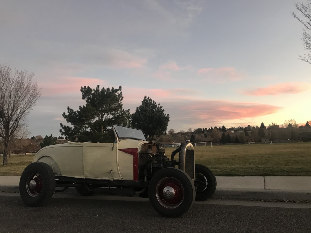

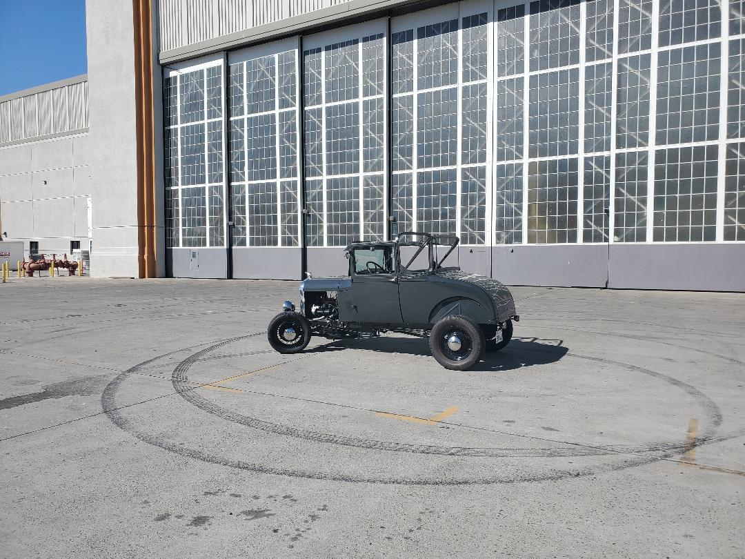

    B883BFFE-7CC2-4749-9CC9-D5D26529BA8D.jpeg I hate to shift the thread to low-tech... Went out looking for leaf piles to kill tonight, roadster is running absolutely mint! Might get my sweetie to go out in it on Halloween, this will be the first year in about 15 that it's supposed to be nice and not 10° and 40 mph winds!
