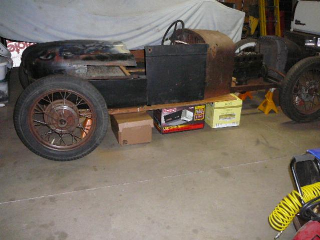

    More speedster parts. Previous total 297.68. I met a Shawn via Craigs list who was giving away some early 50's ford pickup rear fenders and a hood. The price was definitely right for my budget. He lives in Loveland and i'm in Parker, Co. So it was a 85 mile drive, cost for gas, call it $30. Shawn's a cool guy, has a really neat early 50's ford truck and does some nice pinstripping. See pics... I think the rear fenders have a nice speedster type of nose in them and the hood will end up as rear body work after some slicing/pie cutting and re welding. Going to try and cut out the hood side louvers, turn them around and put them back in place. The remaining pieces of the rear fenders might end up as lower rear body work. Will post more pics after cutting is done. Also, 10 more cutting disks at $32.11 brings up a new total of $359.79.

    Hey guys, thanks for the pics and ideas. Spent the rest of the afternoon wacking those fenders and hood apart. front part of the fenders became a speedster nose. It needs to go on a serious diet, just too fat. The rest of the fenders became lower rear body work. The hood got shortened, 2 pie cuts and the louvers removed. They will be reversed and put back in later. Each time i look at the rear of the car, i like it a little more. I need to make some sort of fill piece between the doors and the rear bodywork. I want to make the hood (now rear/trunk cover) hinged and locate the gas tank & tool box there. Let me know what ya think.

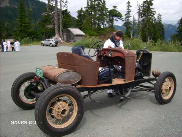

    Hi, I just noticed the cowl you have and though you might like to check out my speedster project. Its a 31-31 ch***is, B motor, chevy cowl, and a fordson gas tank, V8 steering box. It's a blast to drive!! I have about $2000 in the car and built it in a weekend.
    Since the pic was taken I have added an Al windfield manifold and a Holley 94, the head was mill approx. .125" and built a custom header for it. trimmed the seat back and threw a blanket over them, there pretty ugly but comfy as hell!! oh yeah and it got a rattle can black paint job.

    Hey T.N.A. - I recognize that cowl for sure. Couple of questions; fordson gas tank - you mean fordson as in the tractor?? and v8 steering - what year and model did you use? Do you have any other pics?? Thanks, Mike

    Here is another pic from the back. Yeah, it’s a fordson tractor tank but is not the tank that is divided, it only has a single opening. I’m not sure of the exact year of the steering column and box, It out of a flathead v8 and has the locking column. Maybe a 37 or so?
