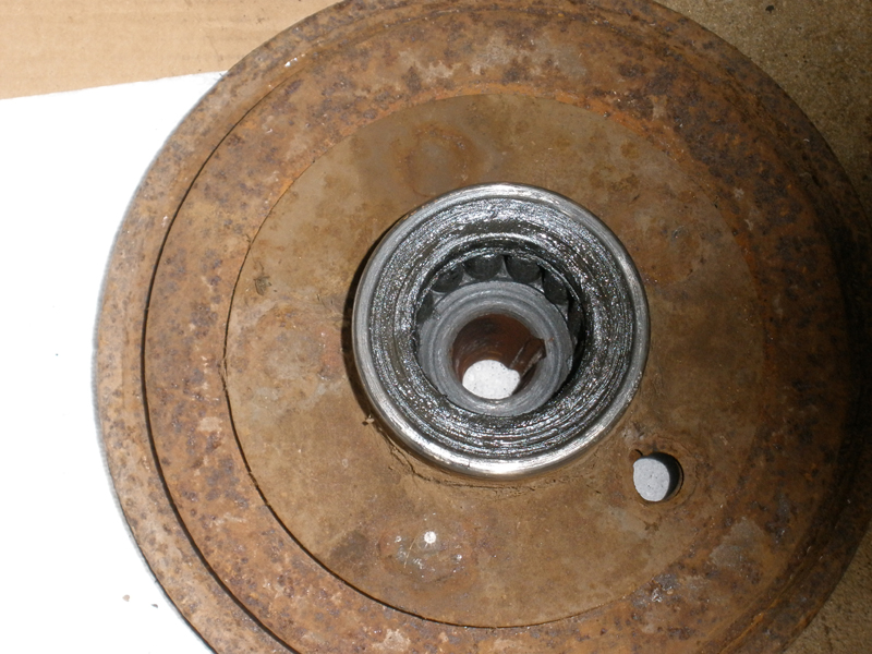

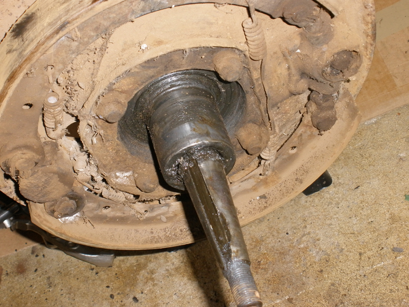

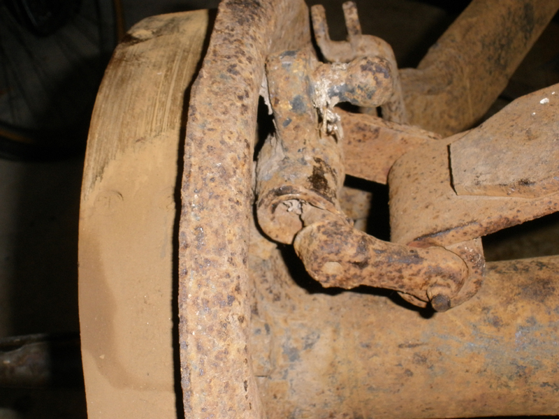

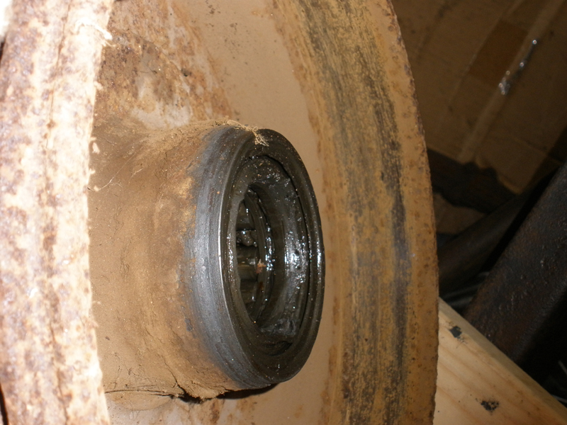

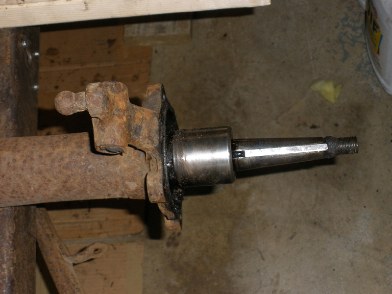

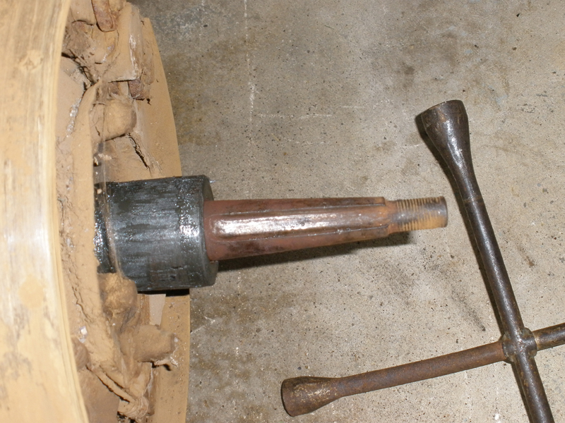

    Found some carnage today working on the ch***is.
    I picked up a spare rear for rear brake ***emblys as the oringinals were missing the parking brake and backing plates were sho and one of the bones were rotted out.
    The spare brake ***emblys though covered in gear oil look great. I figured I would swap them today and pull any parts from the oringals for spares and junk the rest.
    I found that the hubs were hand tight, axle keyways shot, and one axle tube race was hammered out and the axle moved up and down and around way too much.
    Also the right hub had all the lug studs welded on.

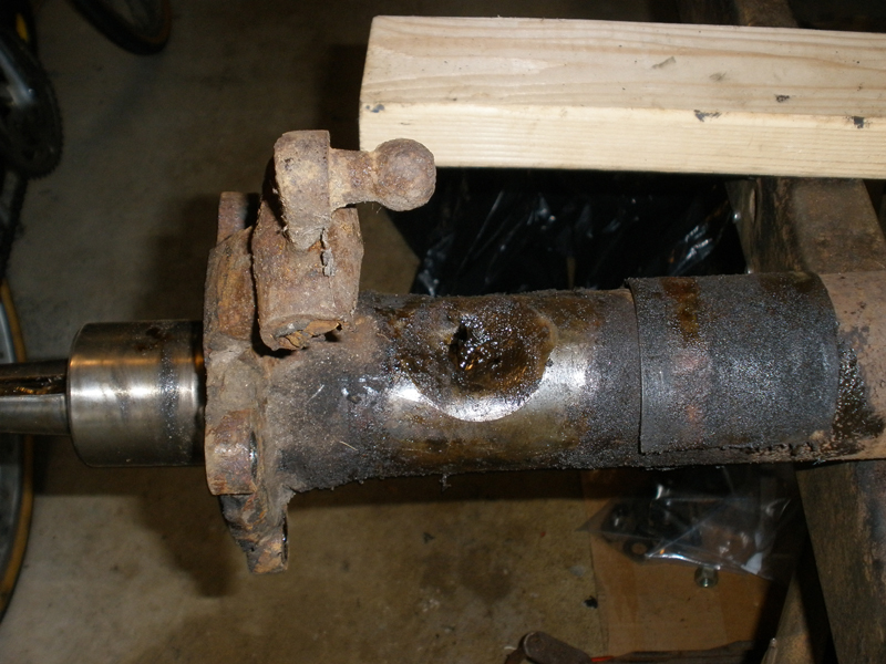

    Ok so I figure I'll just put the spare rear back together and swap the whole thing.
    Then notice a piece of sheet metal and a hose clamp around left side axle tube on the spare rear, pull that off and find a huge hole, someone must have rode with a broken shackle.
    Well I guess I will take the best of the two rears and make one. Teh spare rear has good axles, hubs, and brake ***emblies and one bad axle tube. I will take the right axle tube from the original and make it the left on the spare rear. I ***ume the left and right axle tubes are the same, hopefully.
    What is amazing the abuse these cars took and kept on going.
