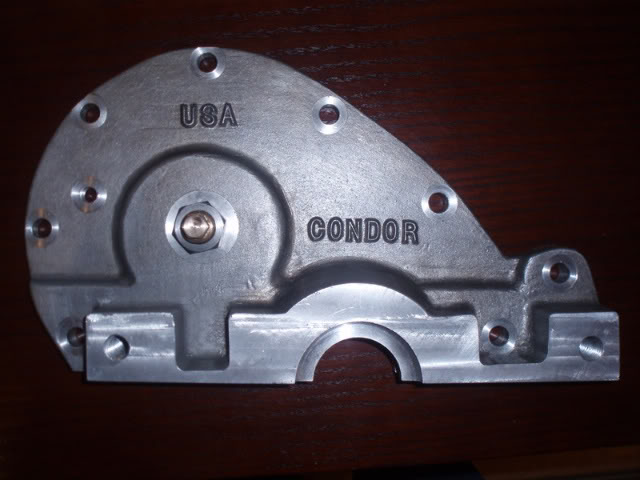

    Hi guys,
    last year in the may banger meet I saw the 'Condor' timing cover.
    Where can I get one for the 'A' engine in my coupe? Maybe I can pick one up next januari when I'm coming over for the Grand National Roadster Show in Pomona.

    Eddy,
    Sawracer here on the HAMB is the one that makes those covers.
    His info:
    amsando@socal.rr.com 714 614 1974

    Hey if sawracer doesnt have one I have an extra PM me or email me
