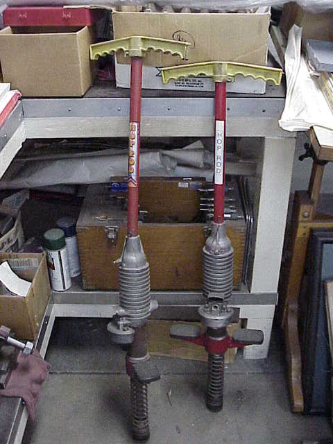

    Are those gas powered pogo sticks in the back ground?

    I will need kits for them, but not right now.
    Yes, they are motorized Pogo sticks.

    Strange! Found a website on 'em.. http://www.thehoprod.com/

    Do they run and if they do can you bring one with you tomorrow morning?
  10. Crazydaddyo
    Joined: Apr 6, 2008
    Posts: 3,371
    Crazydaddyo
    They haven't run in some time. The last time I rode one was when I was 10 or 11 yrs old. And I'm too scared to ride one now ;):rolleyes::eek:
    I will bring one tomorrow for show and tell.

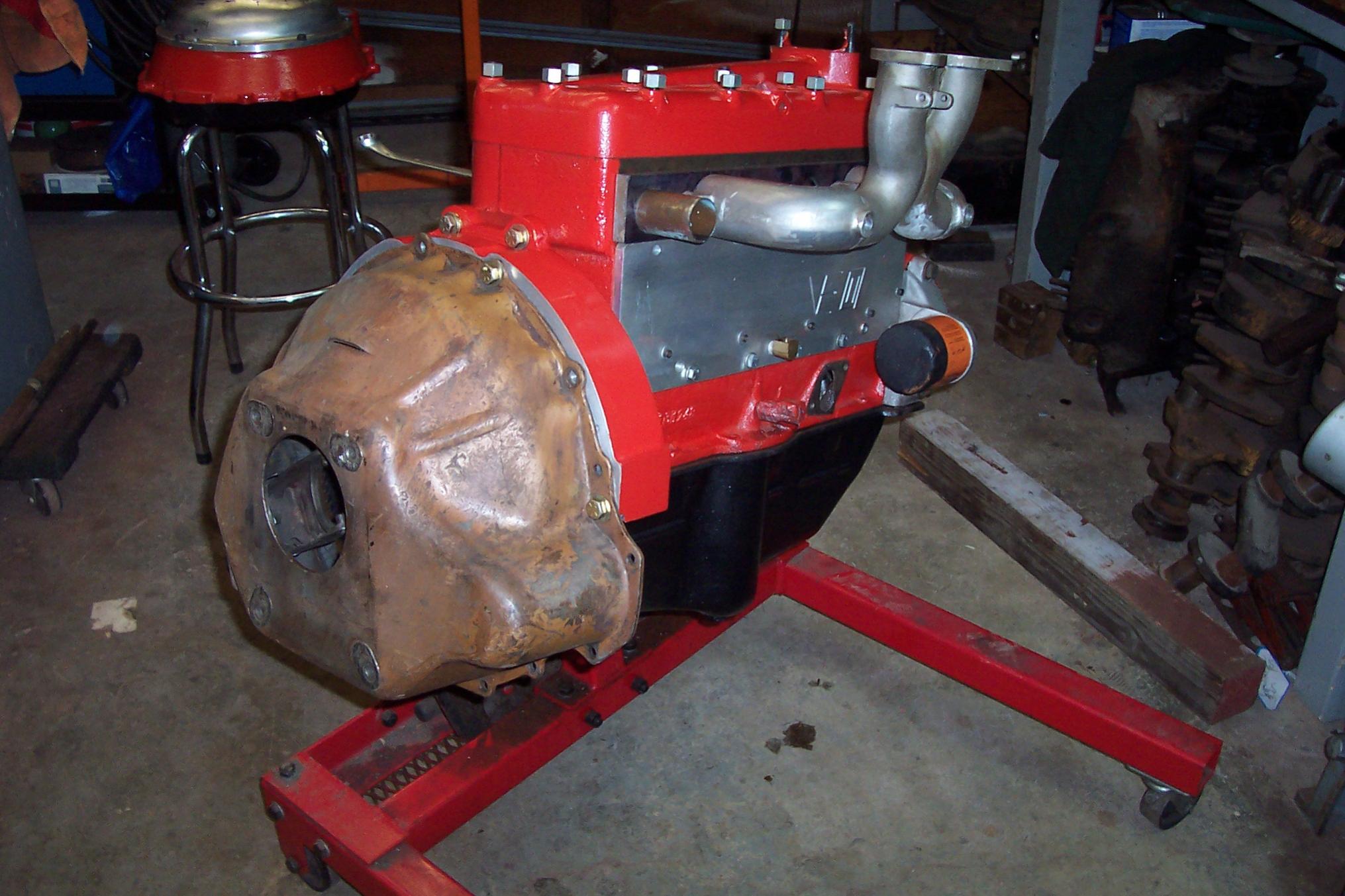

    My new hopped up motor built by Go-Devil Garage <--click.... just picked it up at Hershey...
    going in this.... strictly for the dirt tracks

    Tell us the specs Zach. Whats inside her? :eek:

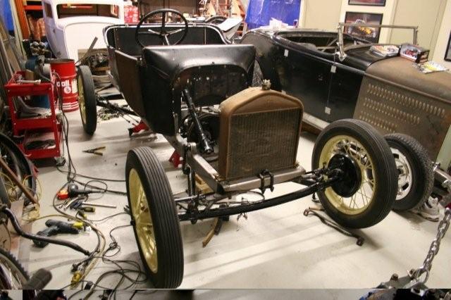

  20. Thanks mate.
    Just remounted the steering box. Finishing the body and have mounted the gas tank.
    Exactly one week to go before our club rod run......
    Will post pics soon
  21. More pics on my build thread

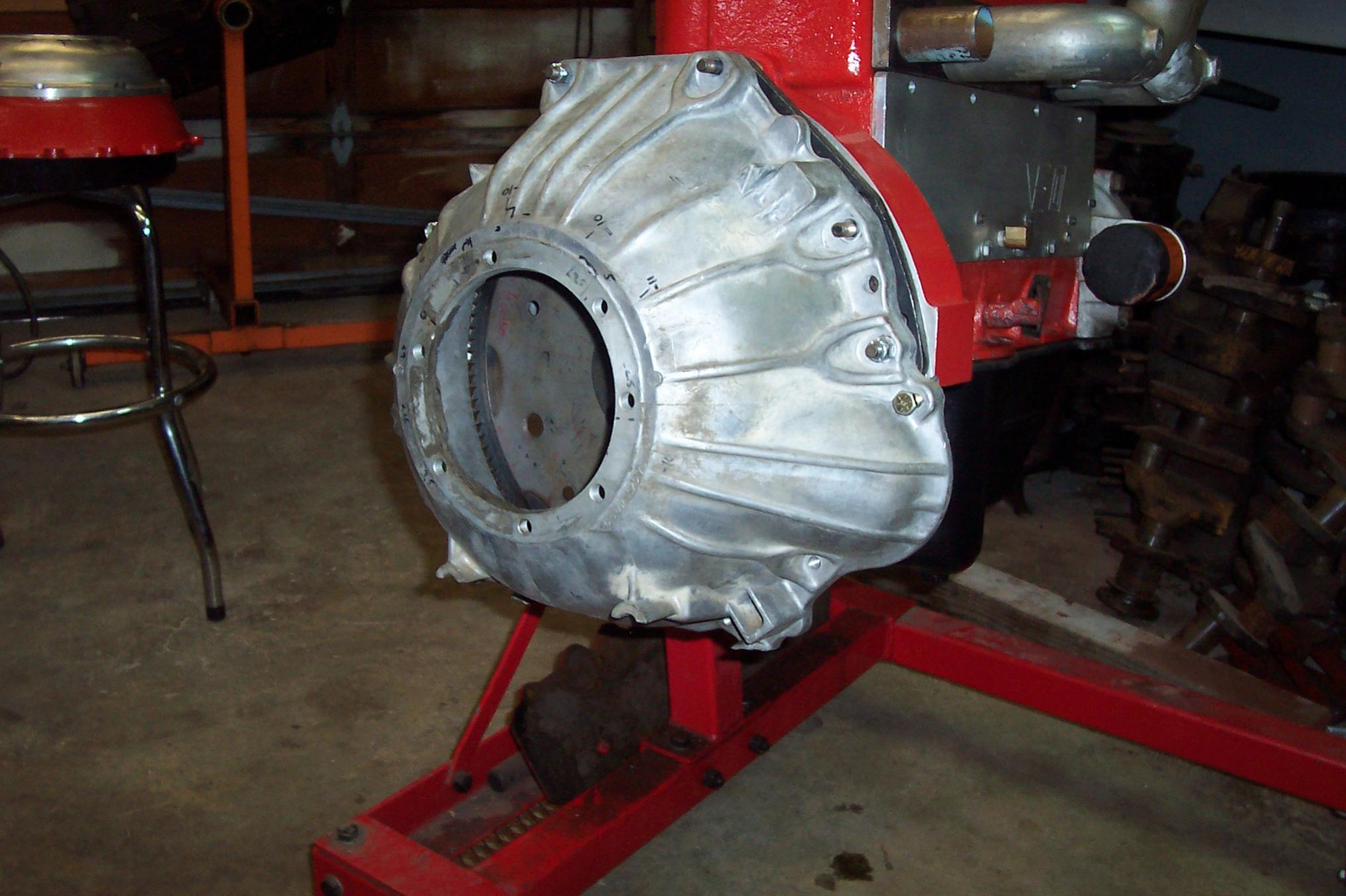

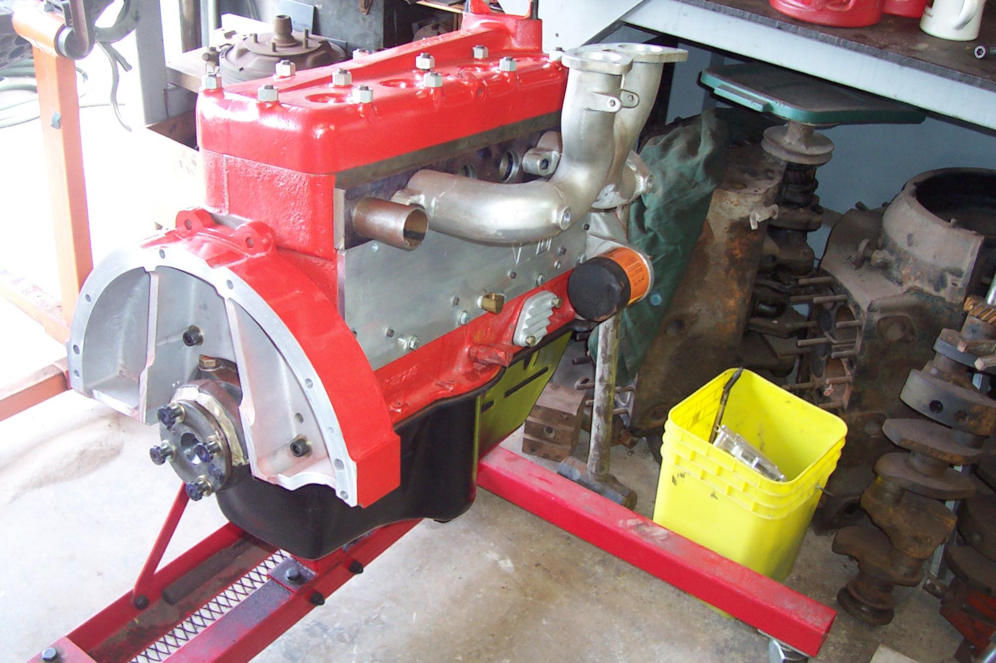

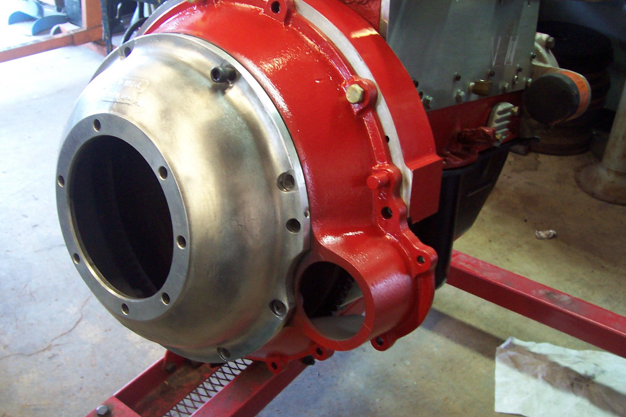

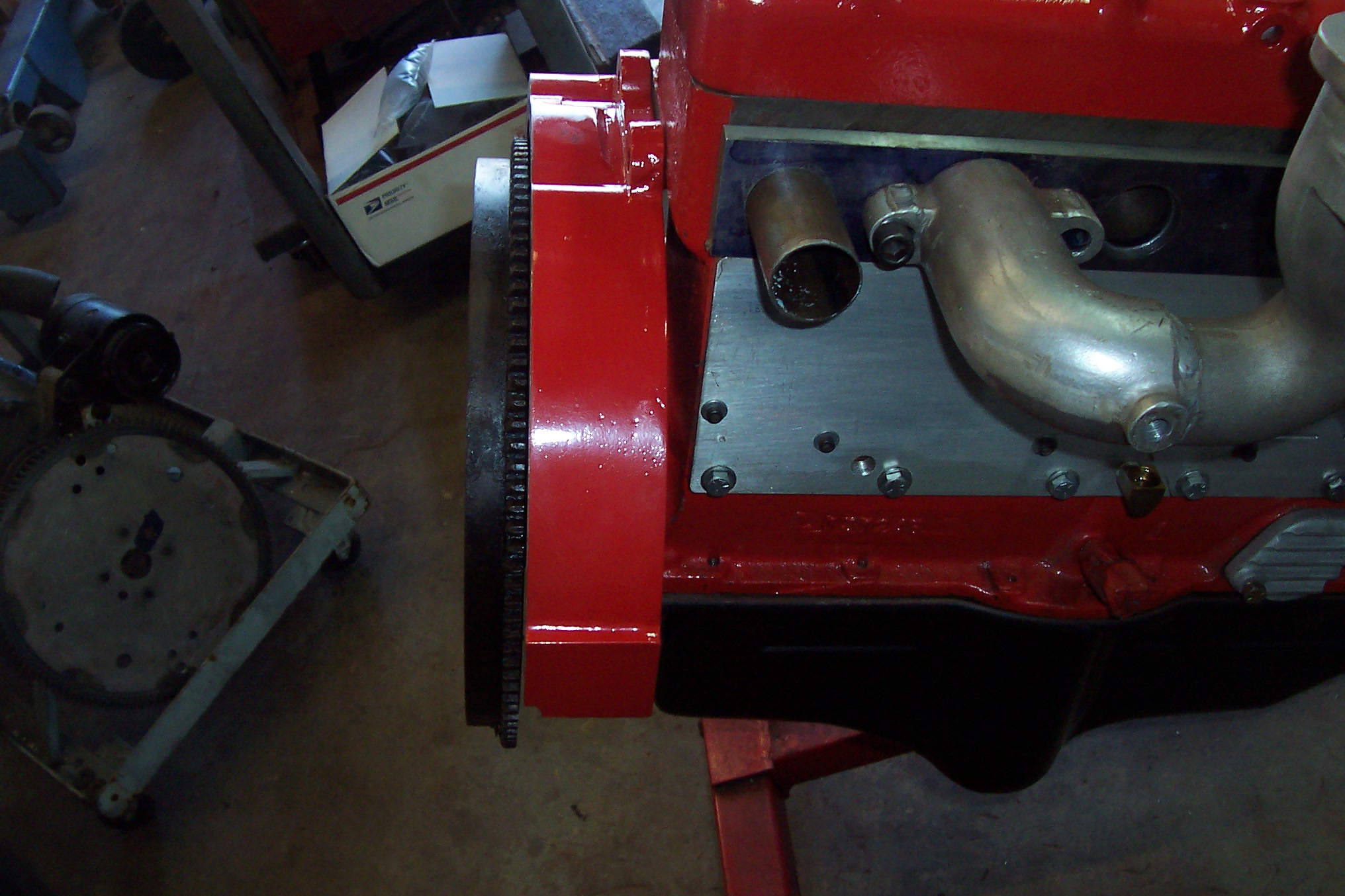

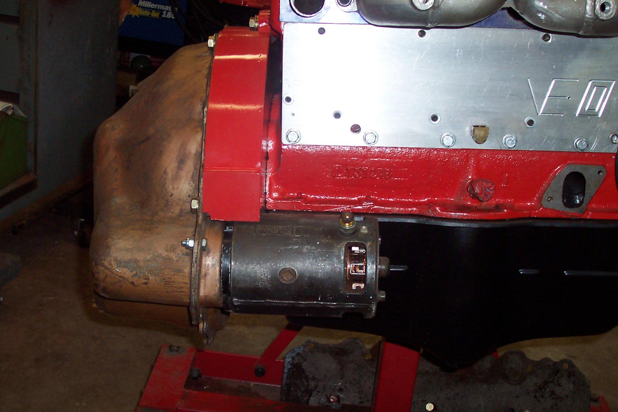

    T Bone contact Bruce Norlie at bnorlie@sbcglobal.net for more details, I 've attached more pics with different set ups. First two pics are bare housing, 3 is 8BA 4 is truck ring to flat-o, 5 is C4 bell to speedway C4 adaptor, 6 and 7 show starter layout. Bruce used a plate adaptor to mount a T5 to 8BA bell using stock 8BA flywheel in his RPU.

    the motor isn't a real monster... just something a little more rowdy to play with at the race track
    counterweights on the crank, little higher oil pressure, 300 lift cam 284 duration(I believe a Harmon & Collin's grind) 7:1 Winfield head...
    It'll get a pair of 97's and some sort of light flywheel... either cut down A, cut down V8 or aluminum V8.... hooked to the stock A trans
    The car will have rear brakes fitted with hydraulic cylinders leaving the mechanical emergency brake... no front brakes
    We're cloning a car that my dad's uncles built around 1945-46 to race locally in PA
    It'll look like this hopefully in the end... the driver was Mitch Smith who went on to be a pretty big name in Sprint Car racing... this was his first race car
    and if anyone has a box like is attached to the cowl... its an accessory spill box for a 28-9.... we're hunting for one

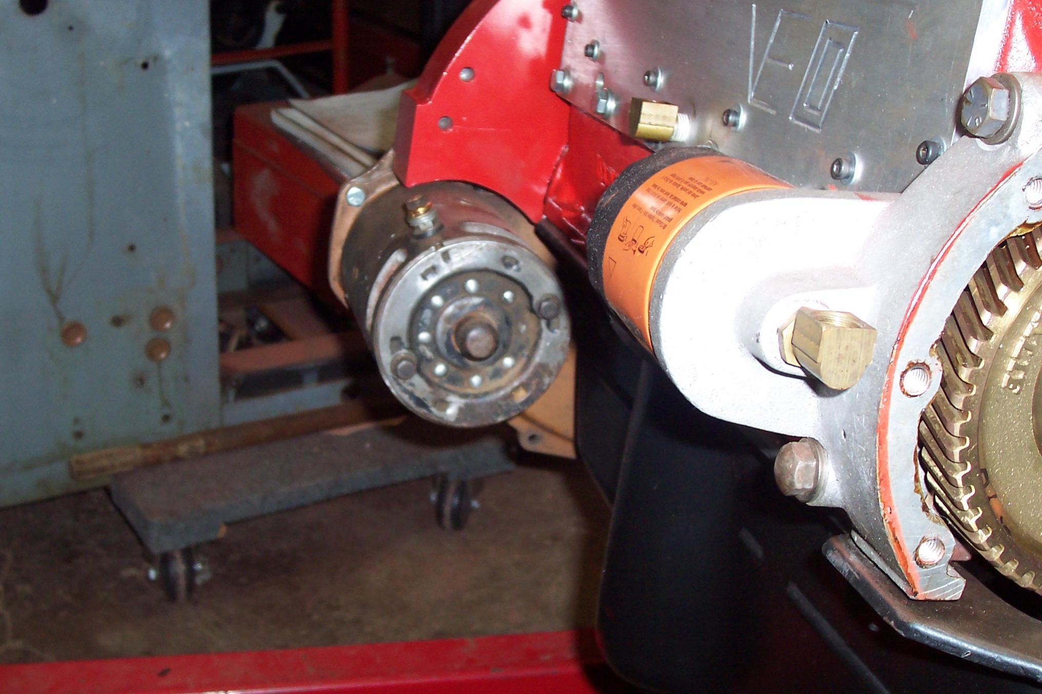

    Dan, can you use an original "B" engine mount on this front plate?

    Mark,
    I don't think so, but I don't have a B timing cover here at home to check. If it helps, the two mounting bolt holes are 9" on center.
