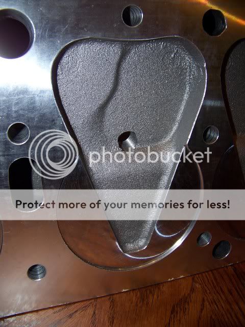

    Nice pieces Bill. Can you post a picture of the combustion chamber on the head please?

    polish inside of each chamber to a mirror finish. get rid of all edges inside the chamber. do not change shape of chamber. looks to me like the sixties harley racing design thing going on with the step down and all. it proved to be very good at the time. make sure they are each equally cc'd. run it like that and see what you think.
    again i have let go of 2 pennies! :D
  29. is that a new head, if so who makes it? looks very tasty!
