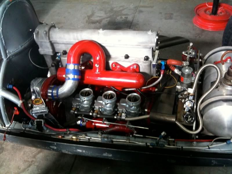

    Hey Banger Bros.
    In case you don't see the other thread about the Old Crow, I thought I'd post some pics of our latest abomination. We just got back from Bonneville, and had our fastest run at 153 mph . We set two new records. We were sponsered this year by H and H flatheads and Stromberg Carbs.
    Gemsa single stick, Model B 3 main block, Mculloch/Paxton blower and 3 strombergs.
    20 pounds of **** in a 10 pound bag. LOL
  26. Dumb question, but is that the engine from the R&C article?
    And congrats!!!
  27. Bobby Green
    Joined: Jun 9, 2001
    Posts: 1,318
    Bobby Green
    No, If you notice, that motor was all polished and pretty. This one,... not so much.
  28. Crazydaddyo
    Joined: Apr 6, 2008
    Posts: 3,370
    Crazydaddyo
    Bobby,
    Great Job with the Old Crow and the new single bump stick.
    What are you using for ignition?
