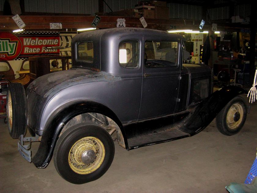

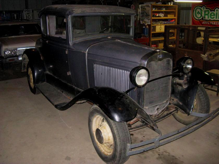

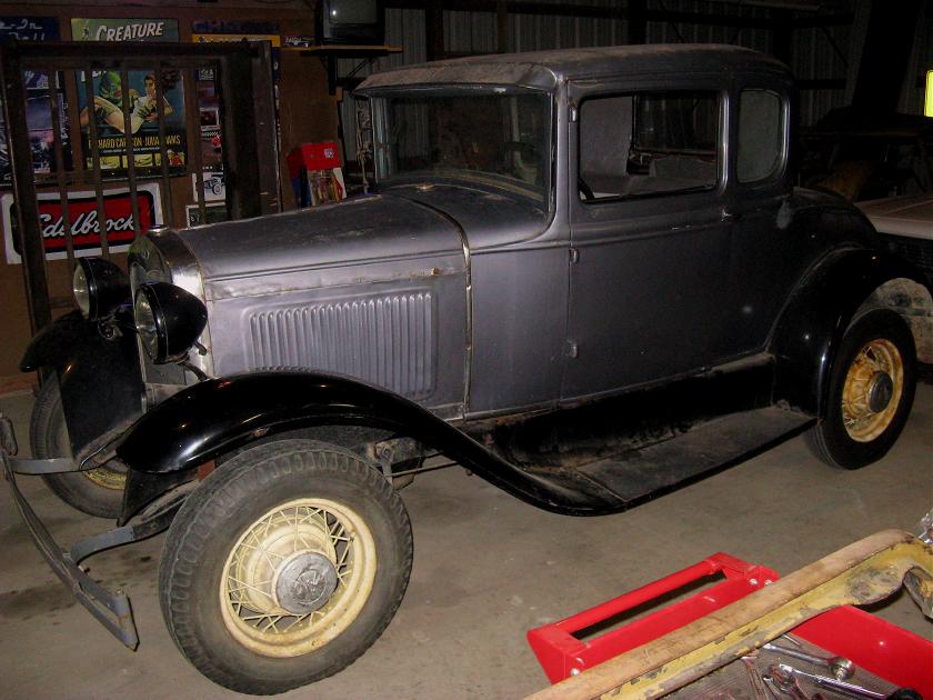

    Not to but in guys, but I want to climb on the band wagon! About a week and a half ago I picked up this 5 window, because of the completeness of the car and a couple banger buds I've decided that this one should not end up being chopped up. Maybe a few body piece removed and stashed, but that's about it.

    very nice ride...

    Looks like a really nice '30!!

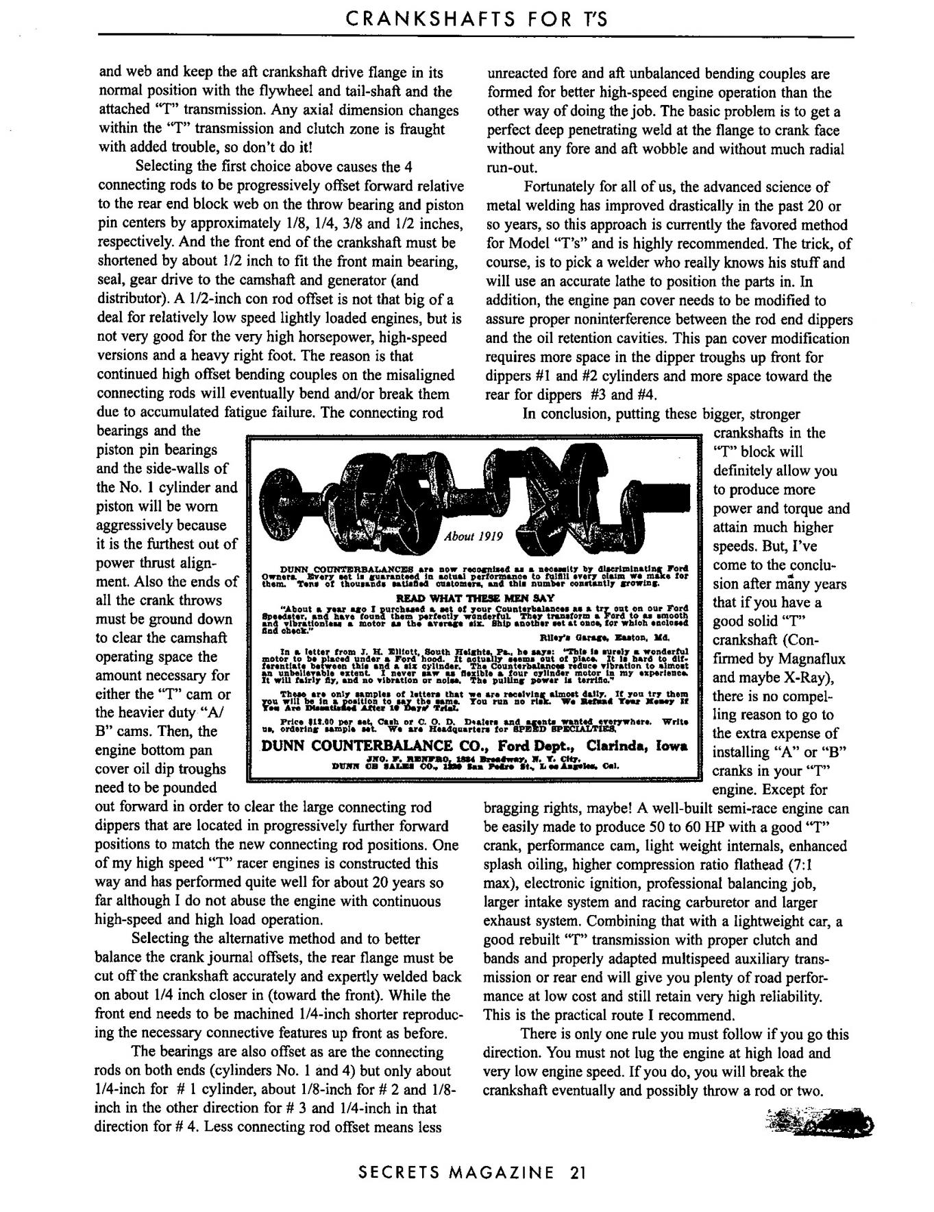

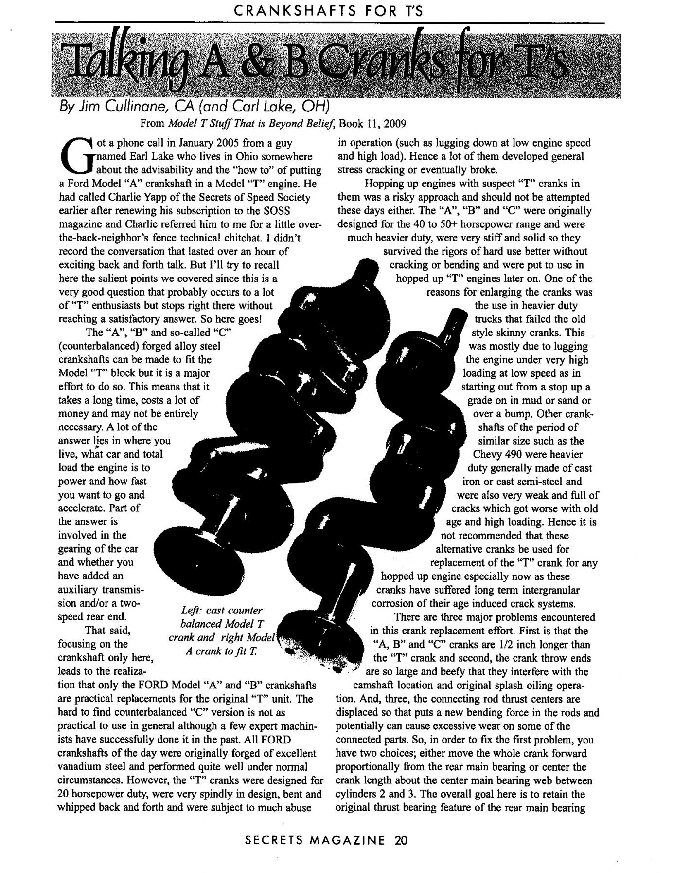

  11. there are a couple of ways to cut down an A crank...all of them that cost almost the same as bying one of the new cranks from any of the suppliers.
    To do an "A" crank into a T block is bit of work, but a short summation below:
    1. Cut rear flange off crank, shorten rear main to T length, re-weld flange on (if you want a more technical description let me know). Install an "A" cam (ditto as above for Technical)
    A. Grind both the crank and rod journals to model T size, Shorten T rods. notch cam and go.
    B. Pour new babbit in block (oversize to Fit "A" crank), purchase cut down A rods. Notch camshaft.
    more?

    just found this
    http://modeltengine.com/ModelACrankConversion.htm
    seems even simpler? and that line boring jig looks simple enough to make too!
    only would have to farm out the cutting of the main journals then on the crank....
    you could pressurize the mains and cross drill the crank, close in the rod dippers...
    maybe i should just run my stock '25 crank till i have a problem and gradually build a 2nd block for the future...

    Here is some info on the T&A crank swap.

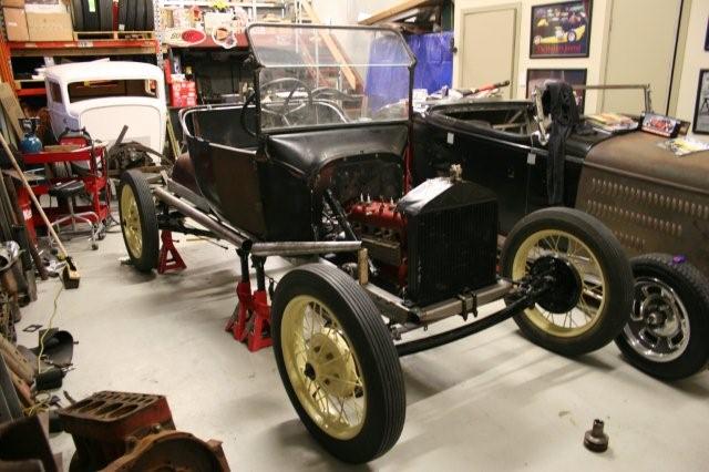

    I have the car in a million pieces... motor down to nothing, just thinking i might as well go all the way since I'm starting from scratch

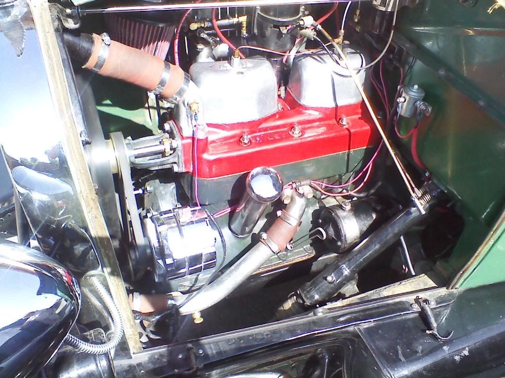

    Like this:

    just like that :D
    any pics inside that motor?

    The engine is out of a 1914 racer my uncle has had for the last 25 years that he has never done anything with. He was convinced to get it running by his fellow T club members. I'm helping him with it.

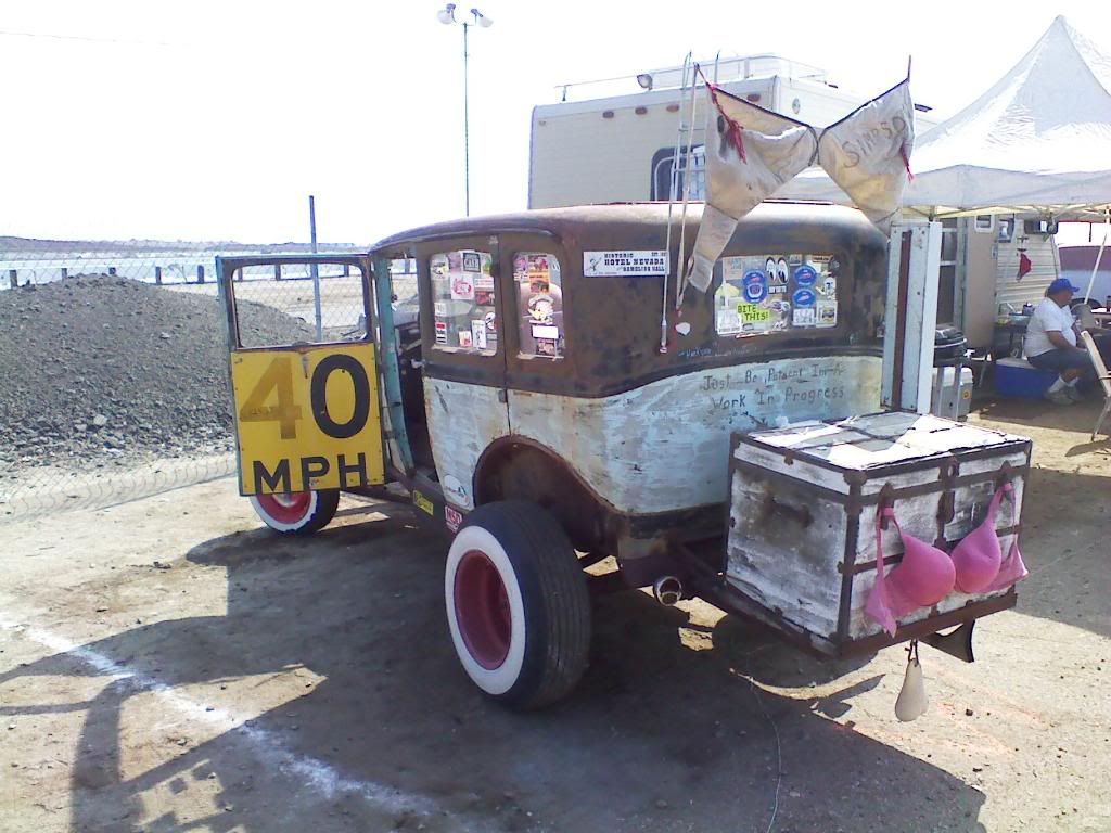

  30. Okay so I snapped some shots last weekend at my Model A club of Bakersfield Meet in Frazier park before I went out to Winfields in Rosamond.
    Riley, Dual 81's, stock roadster with history.
    Winfield undercover lol, stock model a paint job.
    And then there was the disappointment of CHHR and lack of bangers present. :confused::confused::confused::confused:
    I saw 2 bangers while there this weekend. Only pictures I took this year. I see this fella quite a bit at Famoso and also have seen pics of him elsewhere. This car gets some serious miles put on it.
    Model A Dave came out to "represent". He through down a challenge to me about running the bangers at Dragfest this next year and I accepted. He gave me some hints on what I am up against with his truck. I followed him out last night and he was hitting 65mph+ on the way to the Famoso Chevron for some smokes. "Damn" is all I can say. Hope you all enjoy the pictures.-Weeks
