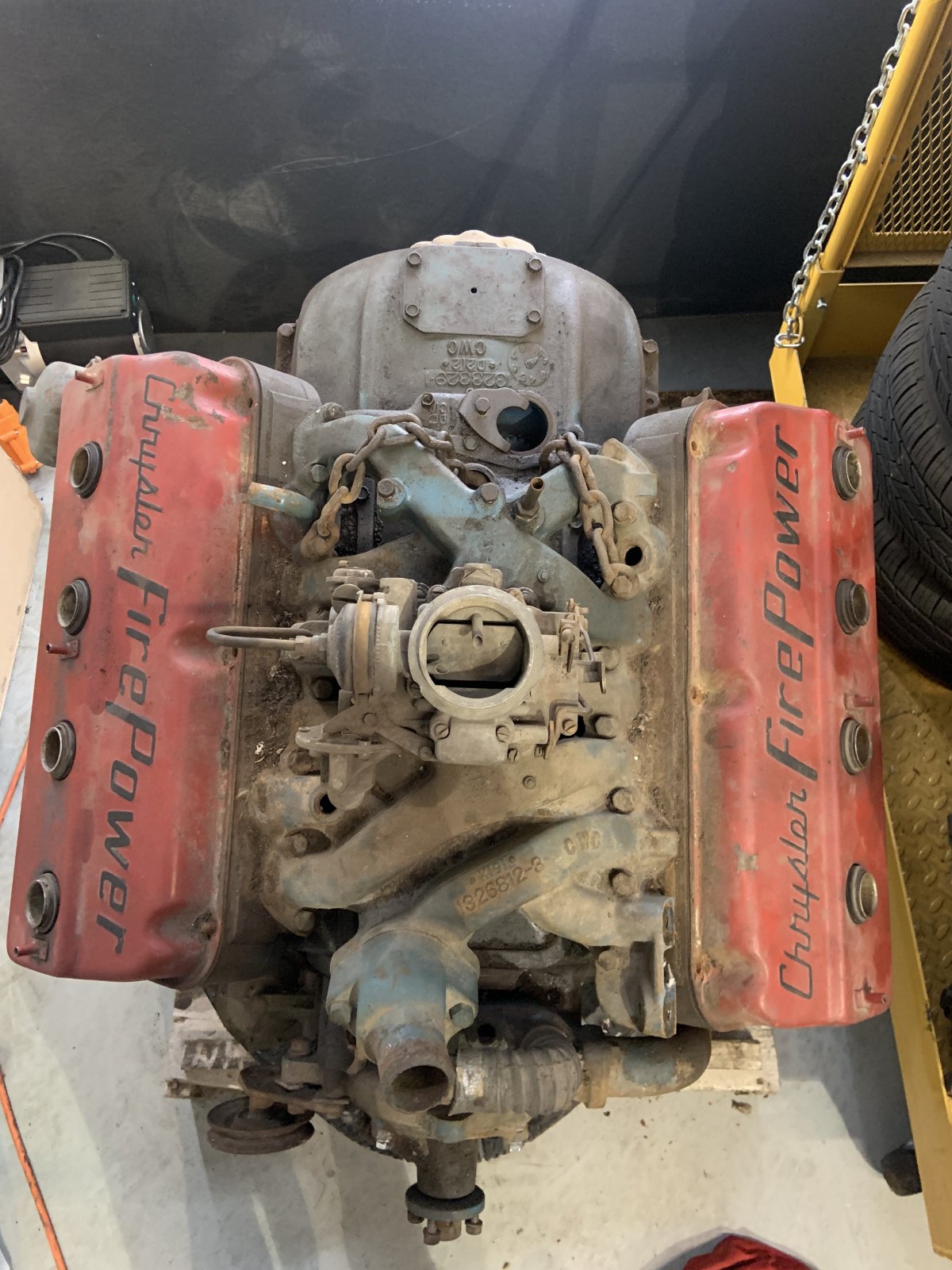

    Hello everyone,
    This is my first post on the forum and my first venture into the world of traditional hot rods. I've typically been into modern cars or vintage motorcycles. I own and run a heavy equipment hydraulic repair shop, as a career.
    Im going to be building a "period" 28-34 ford for my son over the next couple of years and look forward to soaking up everyones knowledge as I brows the forum.
    I recently acquired a 331 Hemi but I'm having a bit of trouble with the serial number. The engine is out of a Chrysler and appears to be a 51 to 54 but the date code/serial number is "C55-1790C"
    I've done some digging but can't find another example of that "C55" beginning.
    Was this a factory replacement in 1955?
    Please help!
    Thanks in advance
    Chris

    I also don't know what "C55" indicates. The stamping is clean and straight and looks very much like an original OEM stamping, but that C55 code is not do***ented anywhere and 1790C is not a standard engine number. Maybe it was as you say, a service replacement issued in 1955.
    The engine you have there has a wet intake and an extended bellhousing, which narrows it down to a p***enger car '51 to '53 331 Chrysler. Good news, there are new and vintage adapters out there that allow you to bolt several different transmissions up to that block without modification. Search for "Hemi Tech Index" here on the HAMB and you will find an amazing amount of information. Here's the thread on adapters:

    I have nothing here. I have the same info that I’m sure everyone else has. Given the extended bell housing it should be C51-8 C52-8 or C53-8. And nothing in the industrial comes up. I’m not even sure they used the extended bell for industrial stuff but I could be wrong 02EEA740-7063-4466-8FED-2CB0E6366930.jpeg

    So @George has figured out that the engine is from a 51-52 Saratoga. The engine being stamped with the ch***is code rather than the typical nomenclature - Saratoga being a "C55"
