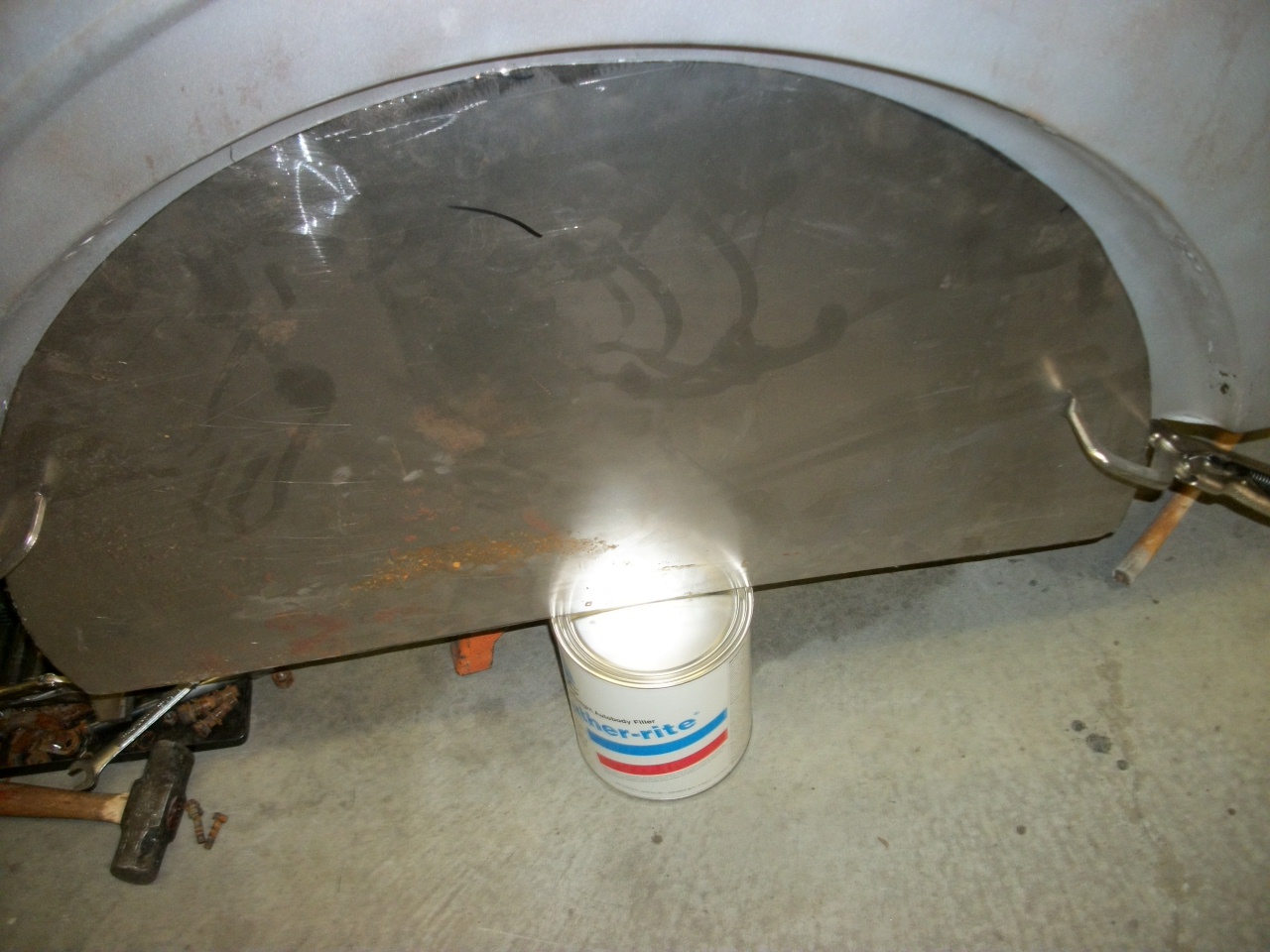

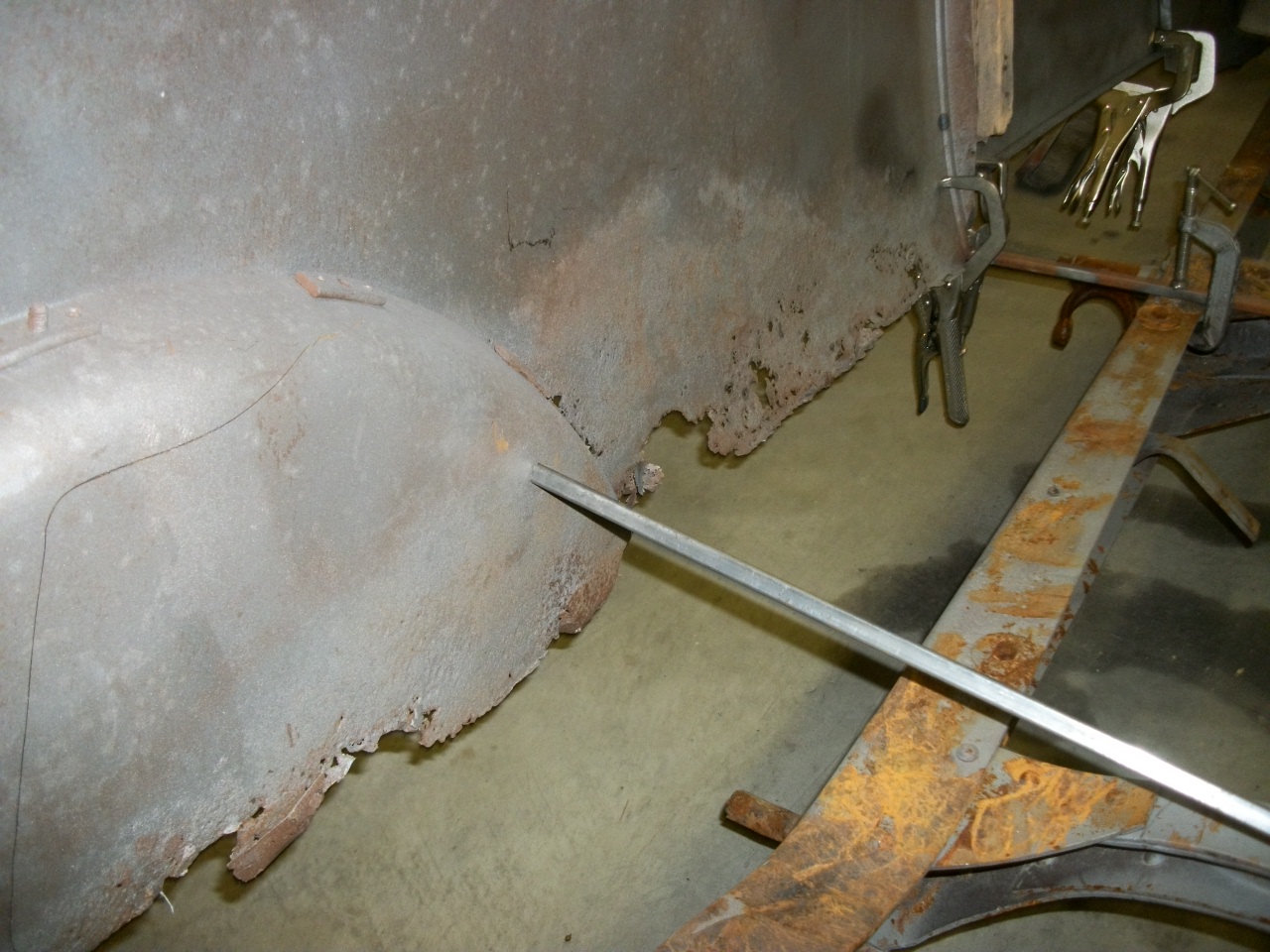

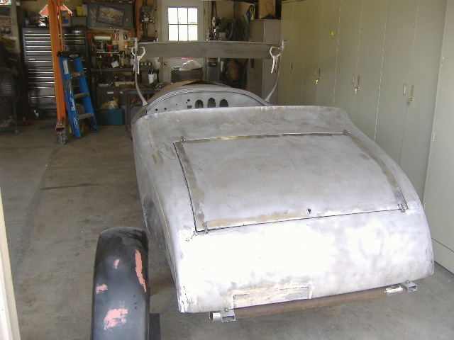

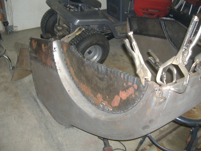

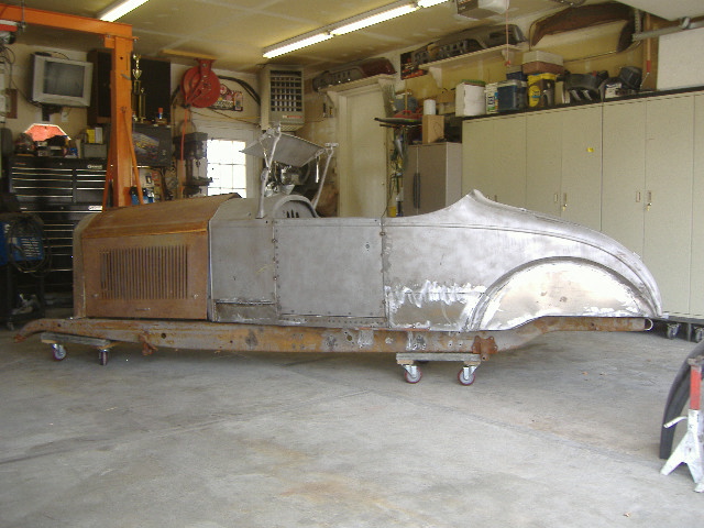

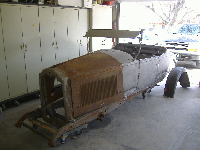

    Well I decided that the 120 inch wheel base was too long for a this car and it made the car look like a limo. and the standard model was 114 inch. So 6 inches has to go. I measured the seating area and there is enough room in there for 3 large basketball players to sit, so this is where the 6 inches will come from. I am 6 foot tall and there will still be a large amount of room for me to stretch out in this car. I got the plasma cutter out this afternoon and made all new lower panel since the bottom of the body is paper thin in spots and need to be repaired. Now I have to install them.

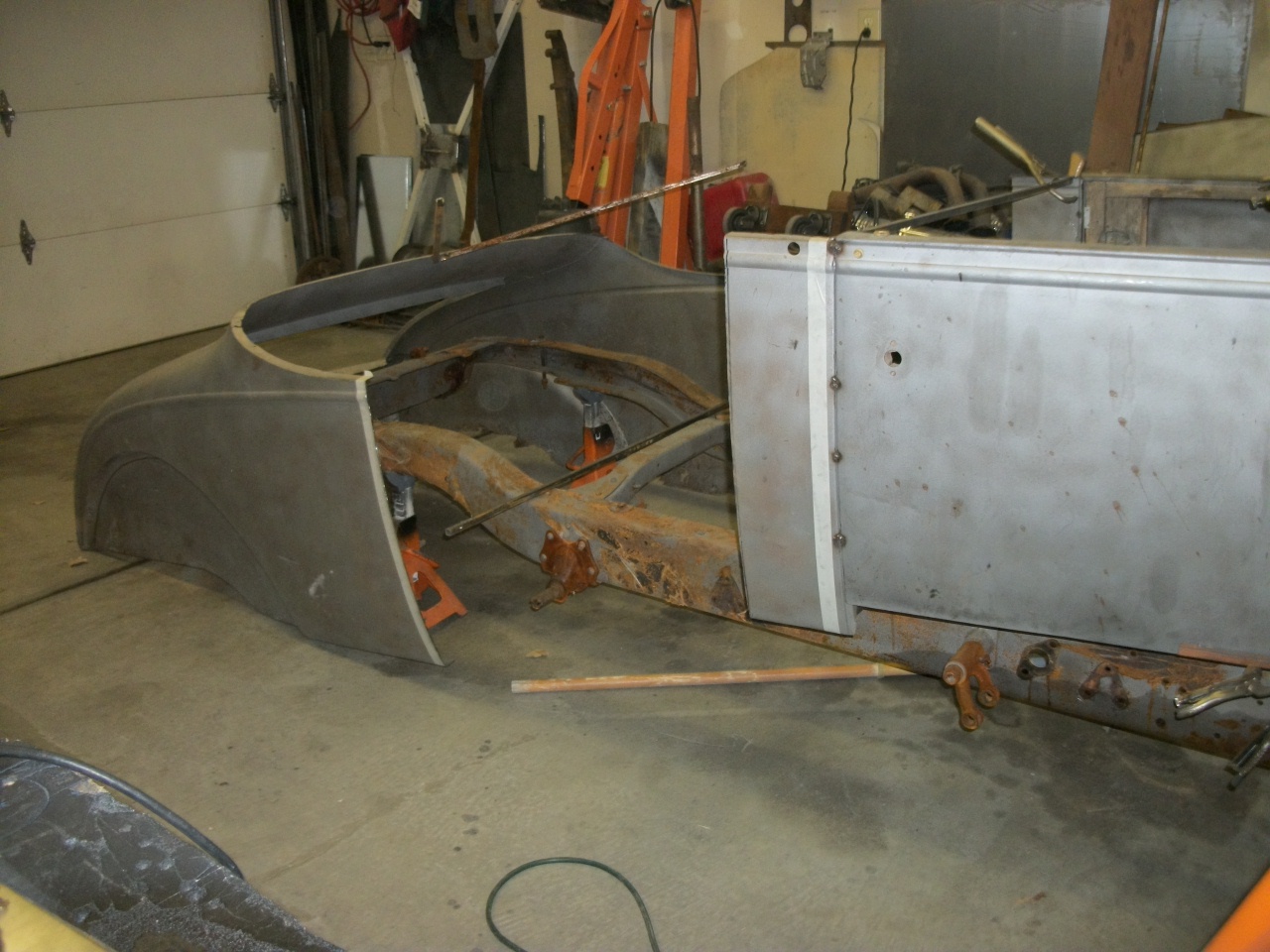

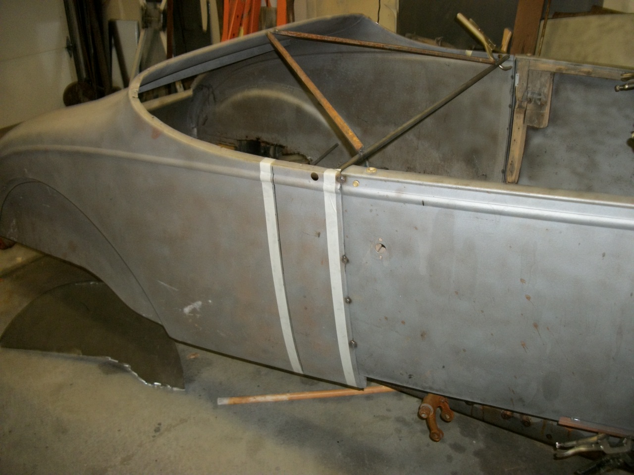

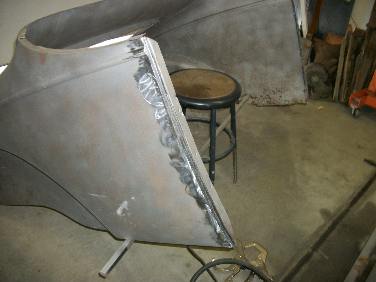

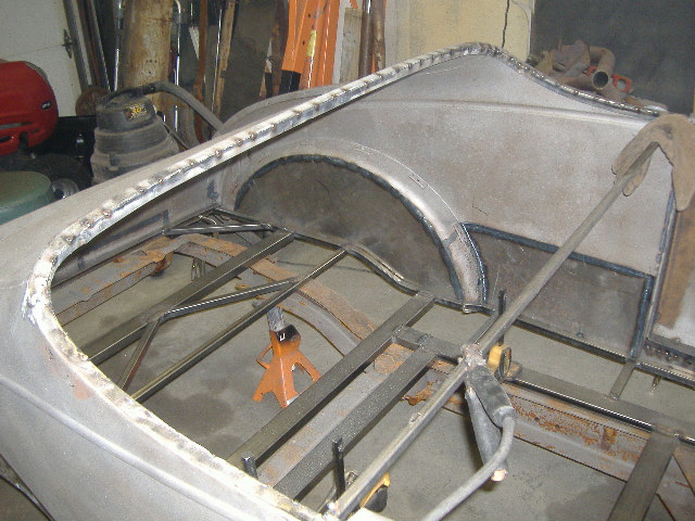

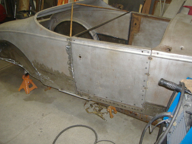

    I did shorten the seating are by 6 inches today. I still have 42 1/2 inches from the dash to the rear where the top would fasten down. It looks a whole lot better and the proportions are where I want them. the frame will also have to m***aged 6 inches to get me my 104 inch wheel base. I also installed the new drivers side wheel tub and lower quarter panel metal to get rid of the rusted panels. It's getting there.

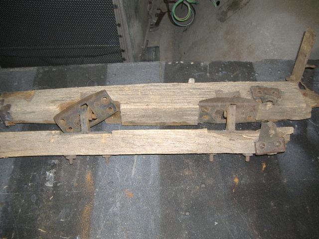

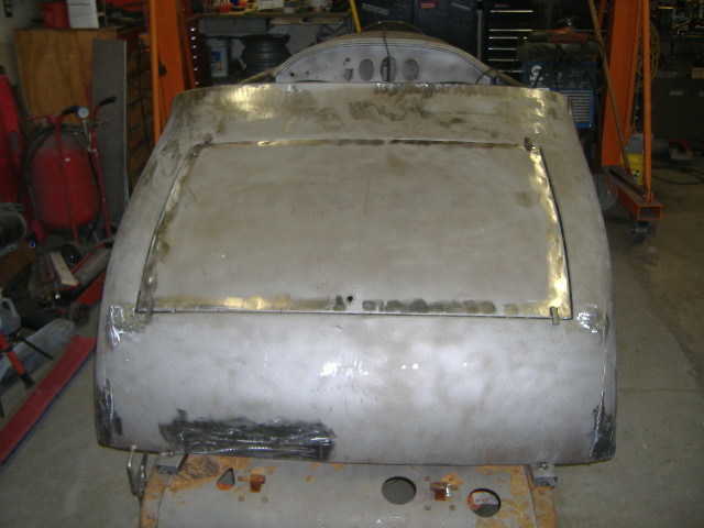

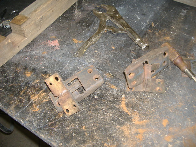

    I went ahead and put all newer panels on the rear body. I didn't trust the thickness of the metal back there. I took a look at the door hinges and they are pretty cool, but are a little flimsy for todays roads. they consist of a two piece design that is hinged on a single 1/4 inch dowel pin about 3/8th inch long and have flimsy riveted piece of metal that if you move it to one side the door can be taken off for a jeep like adventure. Since the hinges were a hidden design from the factory, I am gonna replace them with a newer hidden design, and I will probably put a more modern bear claw latch on the roadster also.

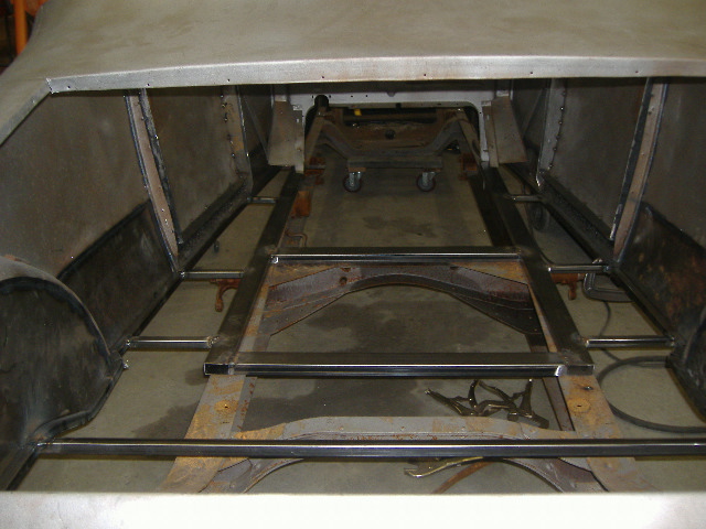

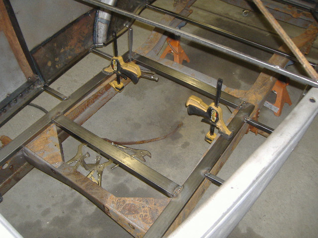

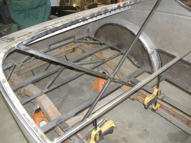

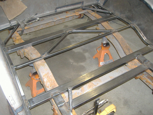

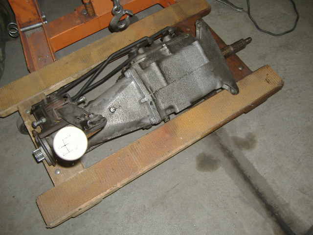

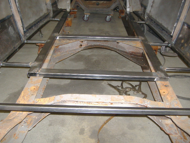

    Thanks, but I am not as fast as I used to be and time is all I have for awhile. With the hot rod budget that I had left I was able to get the bell housing and all the parts to install my new 4 speed and hurst shifter behind the 401 nailhead. I went with a saginaw out of a 68 camaro that had just been rebuilt and the greese was a real pretty gold color. I hope if I don't abuse it it will last me. I have finished all the lower patch panels and started to build the sub flooring. I laid 1 inch by 2 inch 16 guage tubing on top of the frame and am building all the structure off these it should be strong when finished.

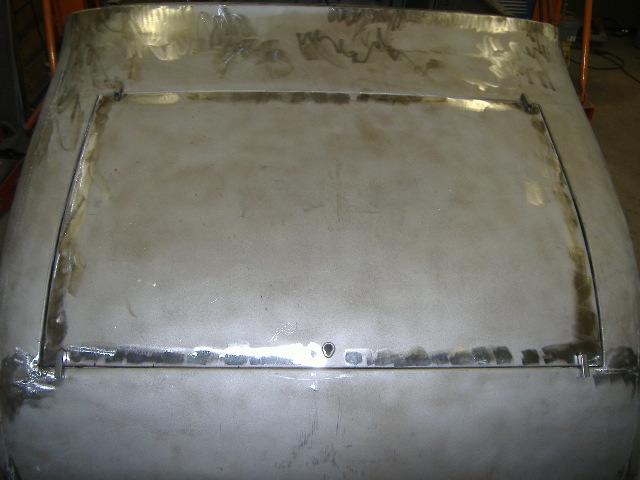

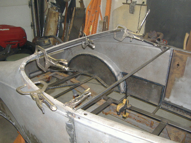

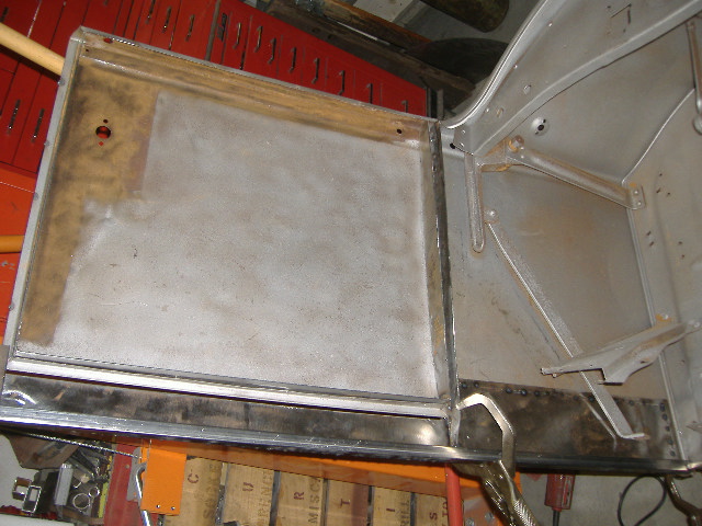

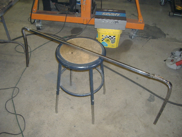

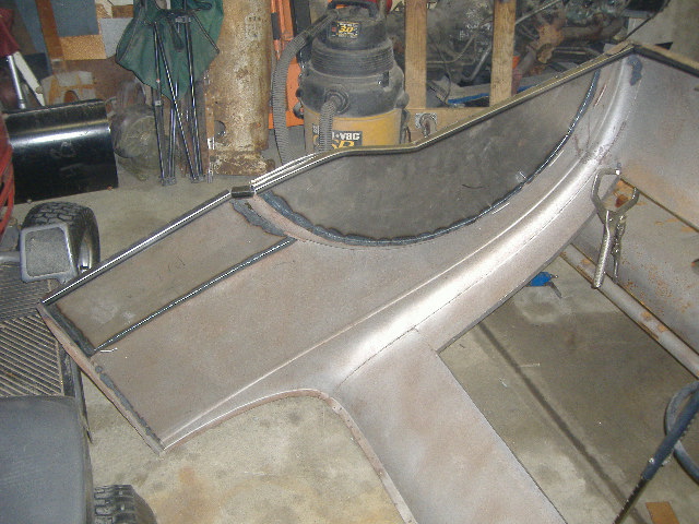

    I finished up the sub flooring at the rear of the buick, then moved on to bending 3/4 inch square tubing to wrap around the package tray or seating area, this was tough. I was able to bend most of it by hand using my vice, but for the tight curves a few well placed cuts and then welding it back together worked best. I then installed some cross bracing for the back of the seating area this will also work as a support for the buffer material between the trunk and driver area later on. I got to thinking about the trunk lid, and if it was gonna fit the hole it was designed for so I installed the interior drip support and then used a few pieces of metal to support the lid, and for the most part it fit well except on the lower body driver area was too low from previous damage, but with my porta power doing most the work it fits like a glove now. Now it's on to hinges for the doors and trunk area. Have a look

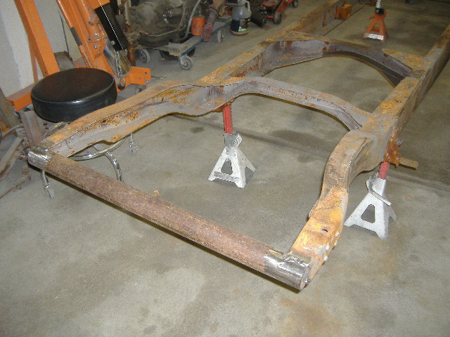

    I haven't been too busy with the buick lately, but I have worked on the frame a bit. After taking 6 inches out of the body the frame was next. It wasn't to tough to acomplish this, but I still need to plate this area, and do some boxing for strength. I also did not like where the gas tank was mounted at the rear of the car it looked like a hog with a hernia hanging out, so I operated on it also. This should clean up the rear after I put a small rolled pan back there. I did install a cross brace made out of 2 1/2 inch round heavy guage pipe to replace what I cut off, and this should also act as a hidden bumper if heaven forbid it gets hit. I am just trying to clean it up a bit. Here are a few pic,s.
