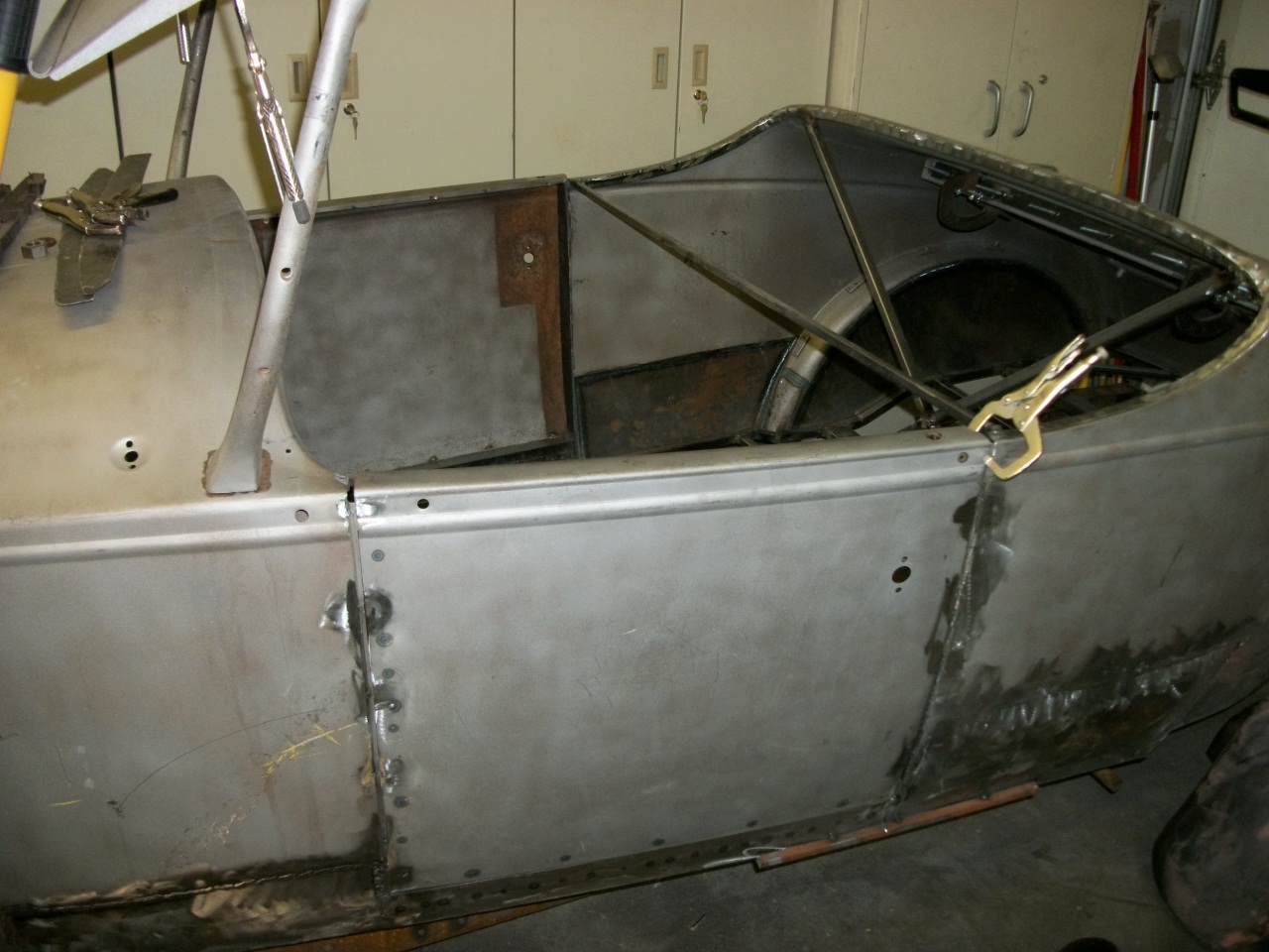

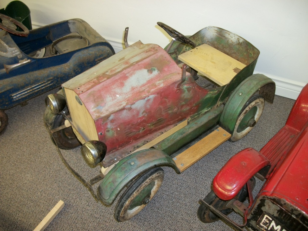

    WOO HOO I finally found some time to work on the buick and got the drivers door operational. I ended up using the original hinges with a little modification for adjustment still needed, but at least now it opens and closes real square to the body. one more thing to check off my list. I also found but couldn't buy when I was in Atwood kansas a couple of week ago this nice little buick roadster peddle car. I believe it was between a 26 to 28 model year. He had just got it for his collection and it was out of my price range.

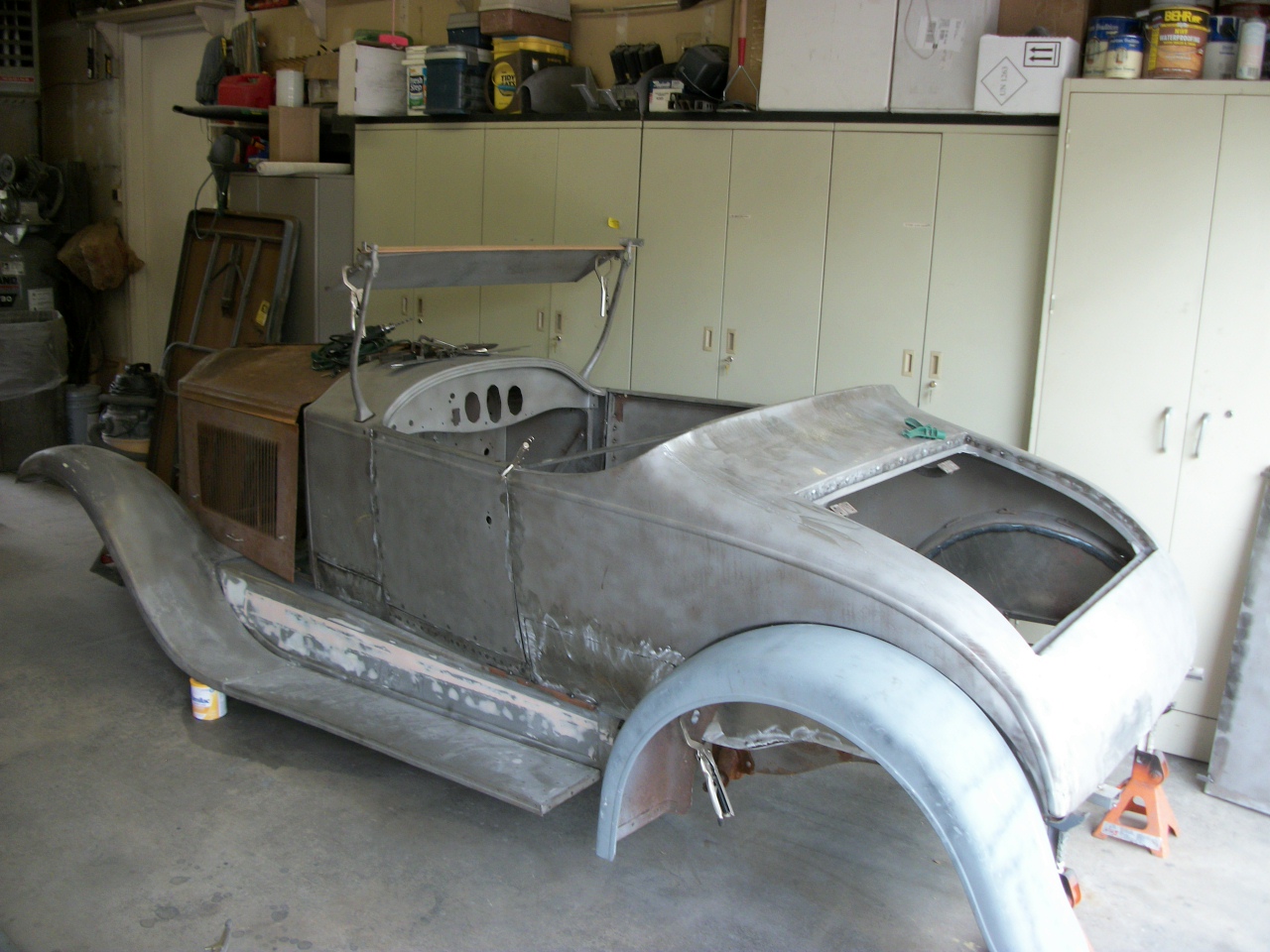

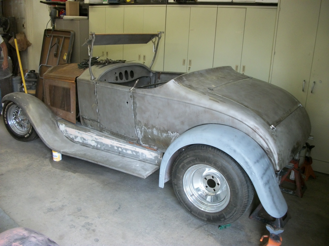

    I spent the morning mocking up some old fenders and such on the roadster. I am still trying to decide fenders or not, and right now I really do like the fender look on this car, The hood sides will still have to be removed for the lake pipes, but other than that. who knows as I said before. It's still early. What ya think?

    Hope you have enough room in that roadster for your knees, it looks like it is channeled pretty deep!
  14. I like the fenders! Bobb the rears a bit maybe? Looks great John!

    By all means keep it full-fendered. Great lookin' car.

    It aint channeled at all. It's just the way the fenders and running boards sit on it. Plenty of room inside for my old knees.
    Thanks buddy. I am planning on either rolling the fenders forward a bit and t******* them from the front or bobbing the rear.
    Yeah, I think the fenders look good on this buick. Thanks.

    fenders look good---bob them

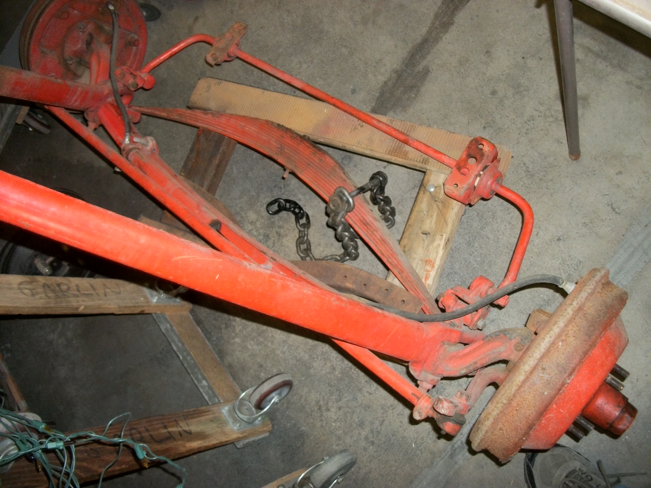

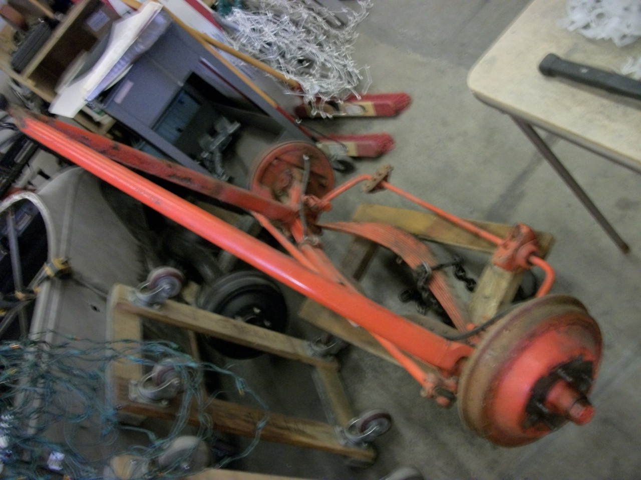

    It's been a long while since I posted anything on this buick probably because I haven't done much. I did get both the doors and trunk hinged. and I am gonna start on the flooring soon. I also found a 40 ford coupe front suspension the other day on craigs list. I am gonna use it on the buick since there was no front suspension on it. I am gonna have to get rid of the orange color though.

    Nice score on the front end, complete with sway bar, too!

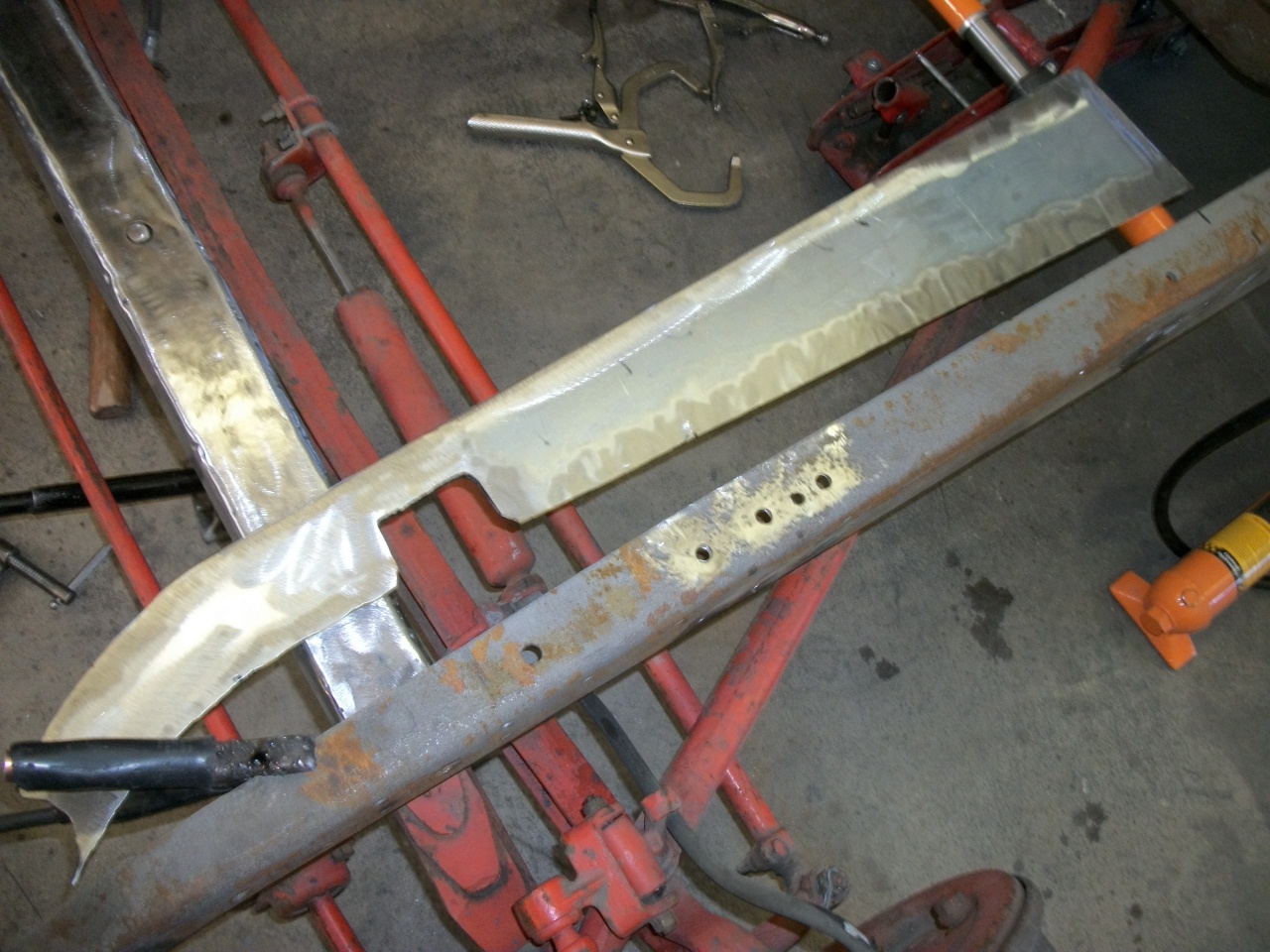

    I spent a little time shaving all the old spring hangers, crossmembers, front spreader bar and ***orted other **** off the front of the frame. I then mocked up the front axle and cut some steel for a new crossmember for the ford suspension. Once the crossmember was lined up and degreed to the front axle and spring I tacked it in place, a new spreader bar was installed on the front, then I cut some boxing plates for both sides of the frame and installed them. I wanted to split the bones to the outside and under the frame, and did not want to heat and bend the spring hanger on the front of the bones this much so I cut a 3/16th wedge from the bones just behind the axle and pulled them to where I needed them and tacked them. I still need to get the threaded bungs and hangers for the bones and then take it all apart to finish weld and strip the old orange hotrod paint off everything.
