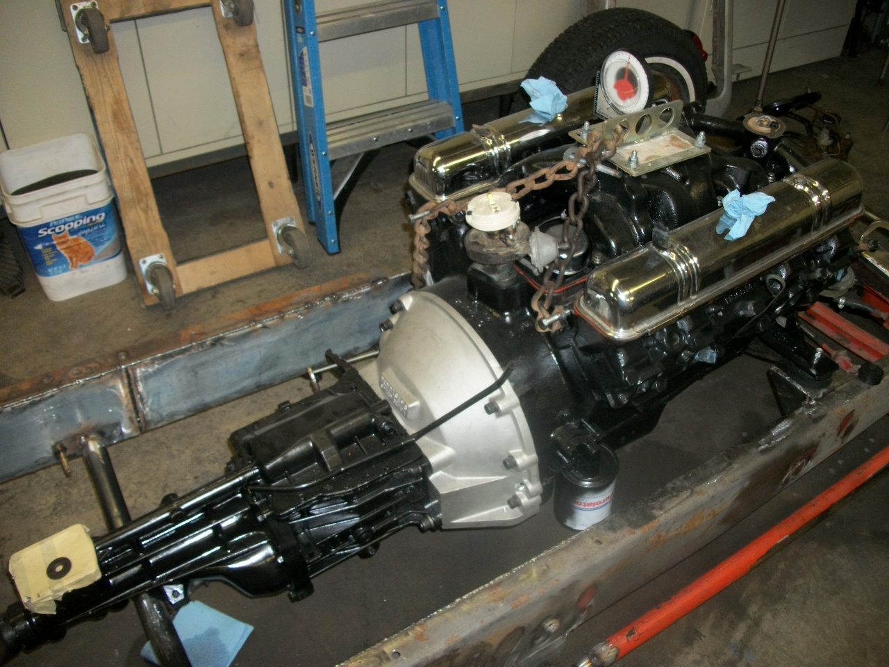

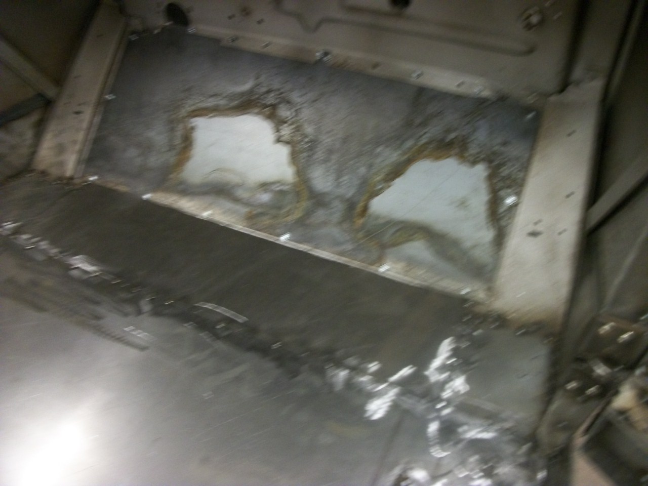

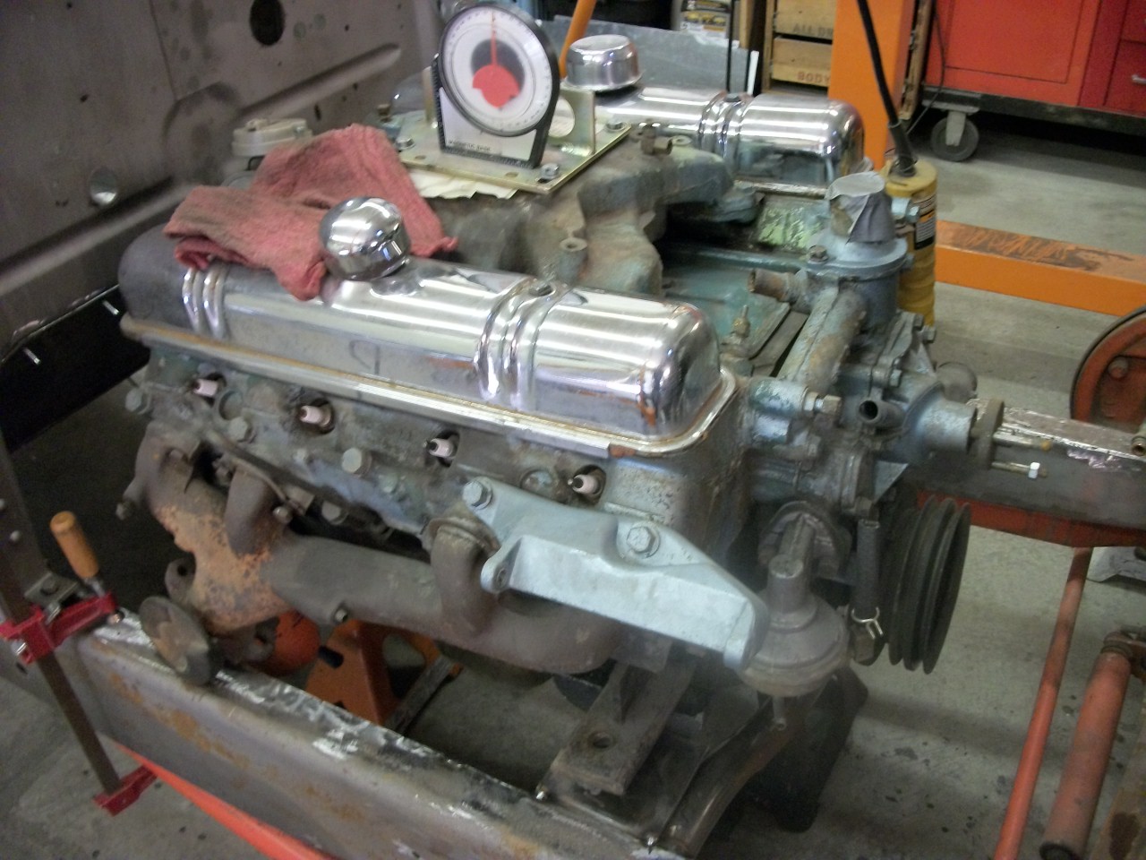

    A few more projects worked on for the buick. It seems I have been bouncing aroung with this car, maybe because I am building this car on a budjet and I also tend to get bored with some things and just go onto another area of the build, either way I am getting some things worked on. The floor board is installed from the trunk to the toe board so I decided to start the engine mock up this way I can check if I am gonna need a trans tunnel. (I will probably need a small tunnel.) The front engine mounts on the ch***is are lined up and tacked in place. I used a 1 3/4 piece of chrome molly tubing for the engine cradle and built the mounts off this, and the frame. The old mounts on the engine will have to be adjusted and cleaned up.

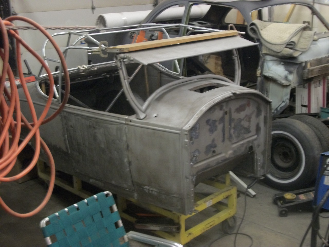

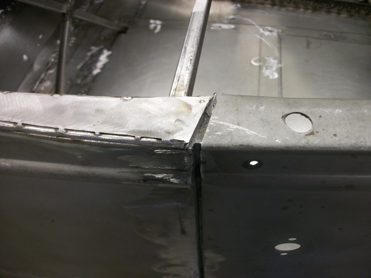

    I keep chugging along on the buick. I decided the transition from the door closure area and the rear boot needed some attention. I used some brake line tubing to shape the transition area and then covered it with sheet steel. It still needs some detailing but at least it's got the shape. I then started to shape the door closure area at the top gap.

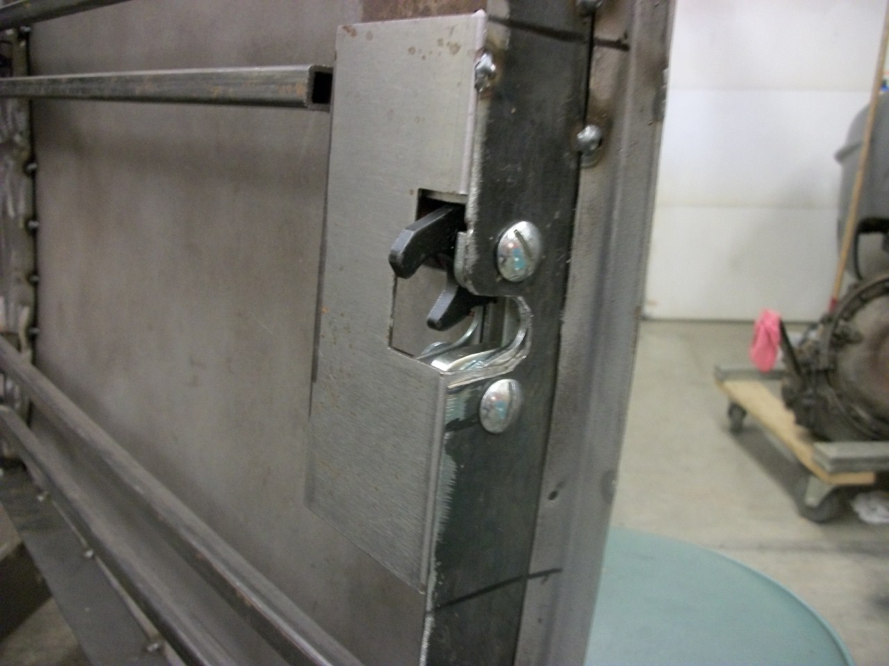

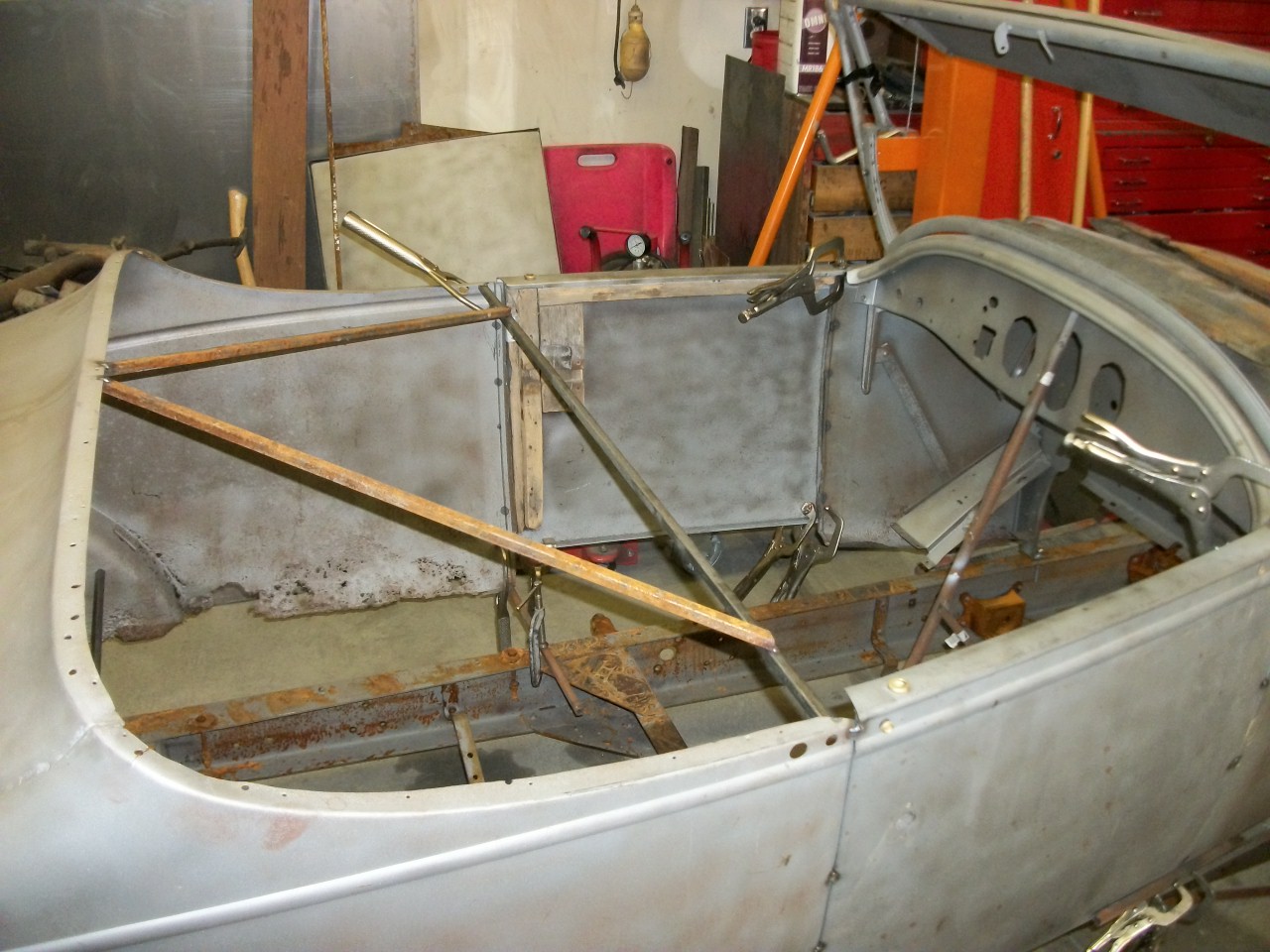

    A little more. I installed the slim line bear claws on both doors and that went well. What I am trying to do is use the original 26 buick outside door handles along with the bear claw latches, and it's looking like it will work great. I also figured out the placement of the brackets to frame for the split bones, and in the process I figured out I had the spring crossmember crooked in the frame, so with a few well place cuts I had a remedy, and using a tape measure and degree wheel the front suspension alighned out well. I feel I dodged the bullet on that one. I was going to fire up the 62 buick 401 engine on my garage floor, but what I figured out is I need a 64 to 65 401 starter to work with my bendstens 4 speed adaptor. oops. I did get a leather bench seat from my local s****per in trade for some of my s**** metal.

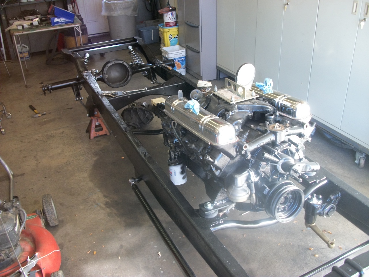

    Well I have been trundling away on the buick roadster. The frame is done and painted for the most part. Installed the body mount bolts, triangulated rear suspension, coilovers, front suspension. engine and transmission, steering box. I am waithing for the gears to finish the rear axle. I did fill all the holes in the firewall except for a few that I think I will reuse. The brakes on the 57 ford axle are not easy to come by, and even harder to get all the small parts if they are missing. I did manage to ge em rebuilt.

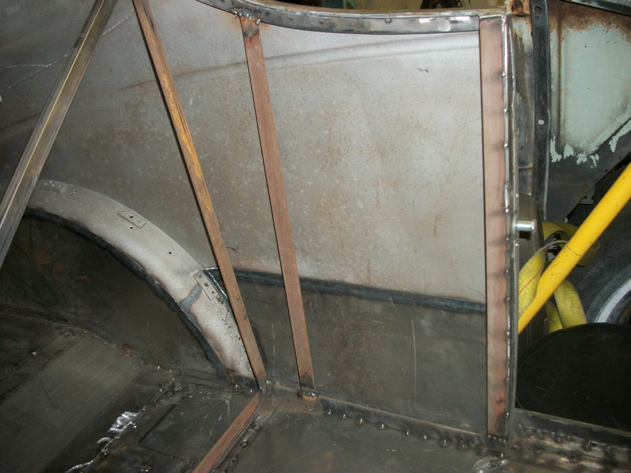

    I agree some progress is better than nothing at all. Most of what I have done has been in the last month . In the last week I built a new dash because the old one had a lot of old guage holes and it was rather thin metal, but the new guage configuration looks like something from the mickey mouse club. I think I can clean it up with the guages and by using the head light and ignition switch in between the large guages. The doors and body still had quite a bit of flex so I added some 1 inch by 10 guage metal to the edges this will also give me a place to mount the upholstery in the future. After checking the T 5 transmission location to the floor a small trans tunnel was needed, I also cut out for the shifter location.

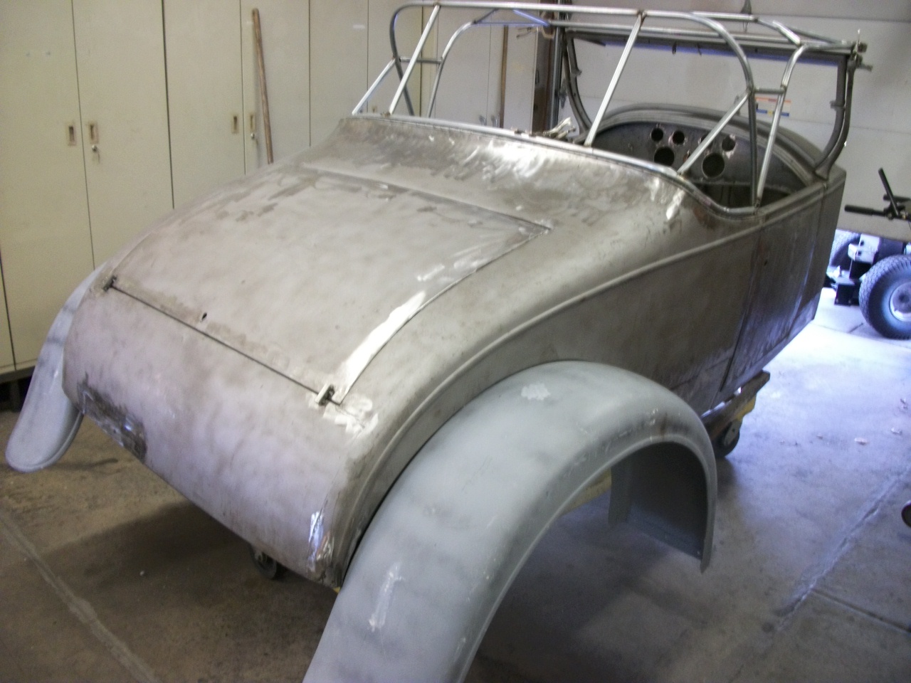

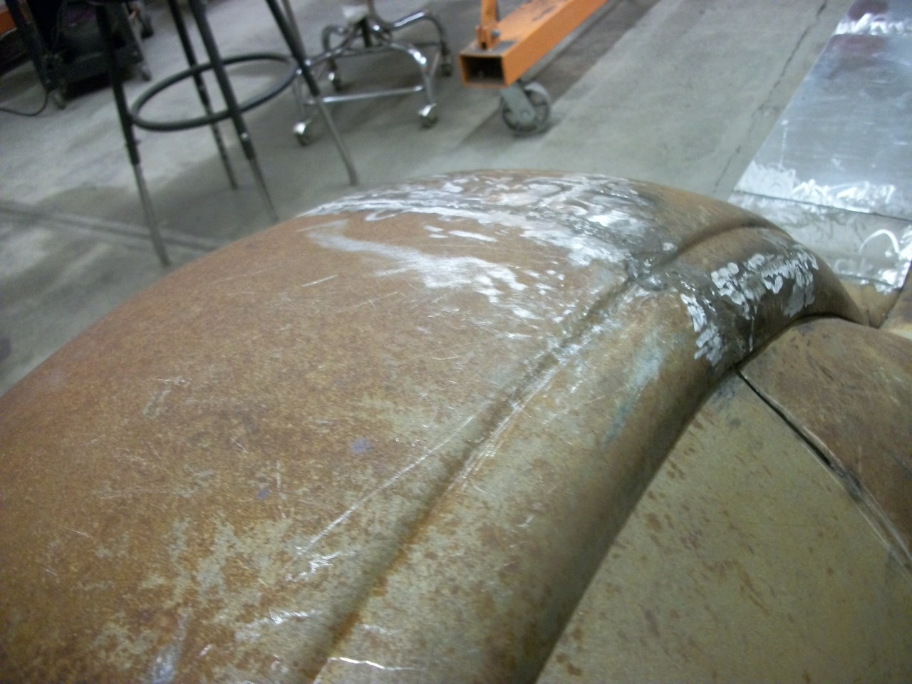

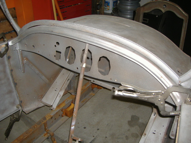

    I decided I didn't like the original height of the windshield posts so I cut 3 inches out of them along with the upper frame. I had some tubing and bent it for the removable top cage mock up. now that it's tacked in place. I will study it for awhile to see if I like it.. I had these fenders sitting around but they weren't originally for a buick car and did not fit real well on the drivers side because the arch was a litle tighter than the p***enger side. I had to split the fender into a couple of pieces, and cut a couple of relief cuts, but it all better now and I thnk I will use them. I am still looking for 28 buick front fenders.

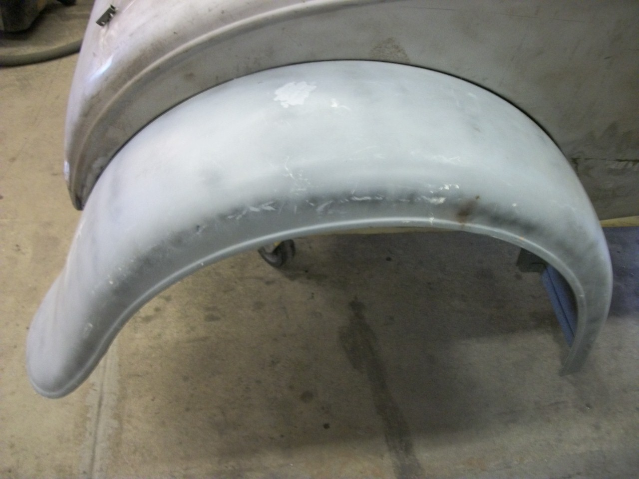

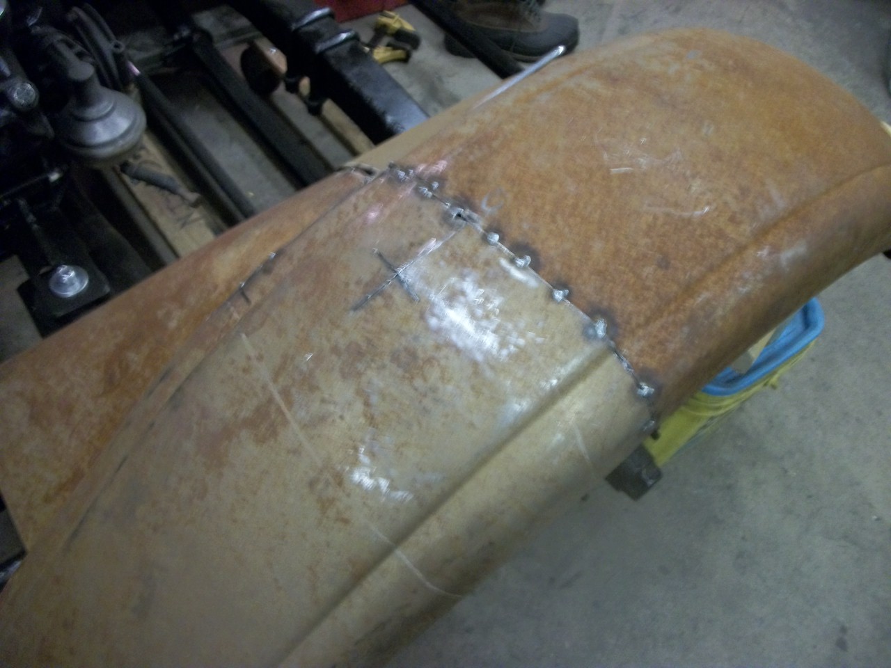

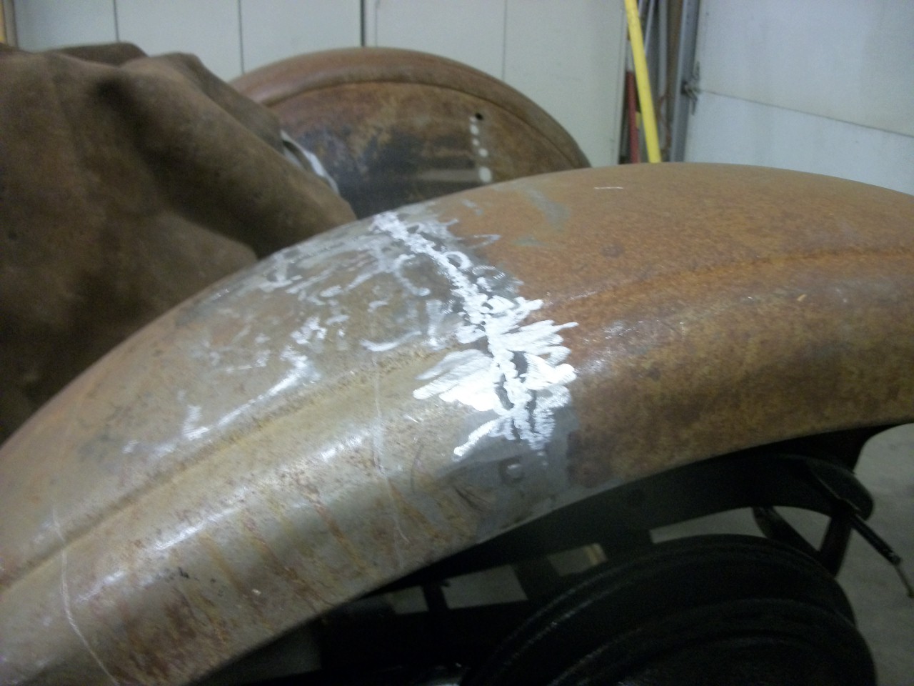

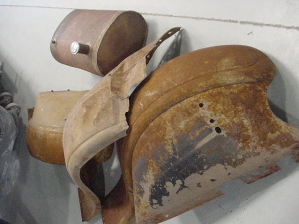

    Been getting after it again. I decided to try the front 26 fenders I have and see if they could be fixed. The drivers side was usable, but the p***enger side, I had to use two fenders to make one and they will still need considerable work. I did cut them and made new mounting brackets so they will sit lower on the frame and over the tire. In my shed of parts I found a set of 32 chevy splash aprons, even tho they were short in length I was able to fix this, and got them to fit the flow of the fenders up front
    kiwijeff and Kevs56 like this.

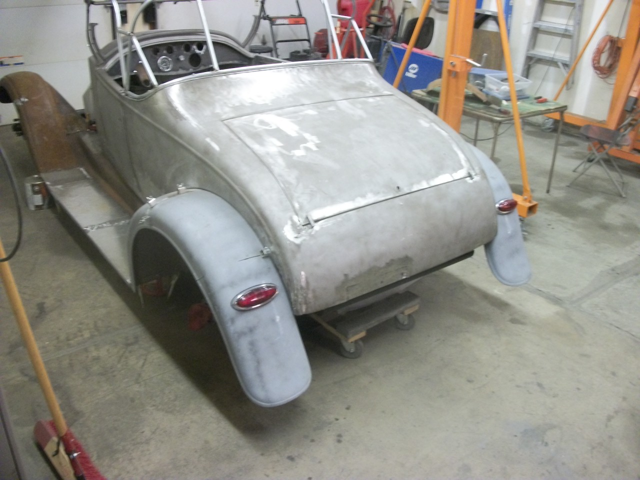

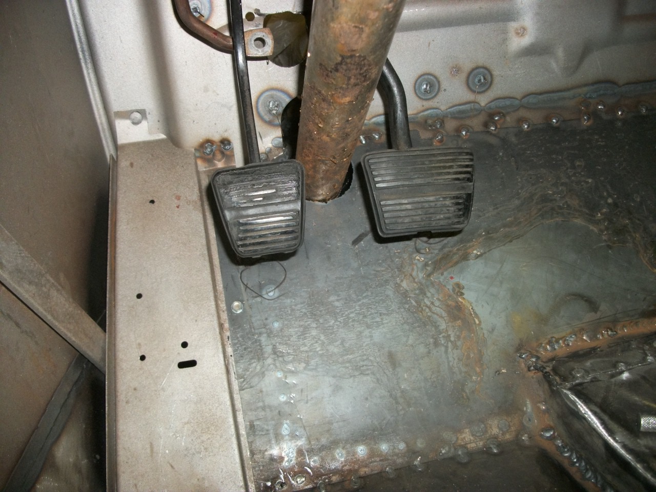

    The spoiler as you called it is original to the winsdhield of this car, and I most likely will keep it. I have been getting a few other items checked off. The running boards are fabricated along with the damaged trailing edge of the front fenders where the boards mount. The clutch and brake pedal from an 89 camaro is mounted and will give me the hydraulic clutch I need. Gas pedal is from a 89 buick, and I replaced the camaro shift arm with an old hurst indy style for that old hot rod look, other that that a lot of welding and hammering on the fenders. I did fabricate a grille insert for car. Have a look.

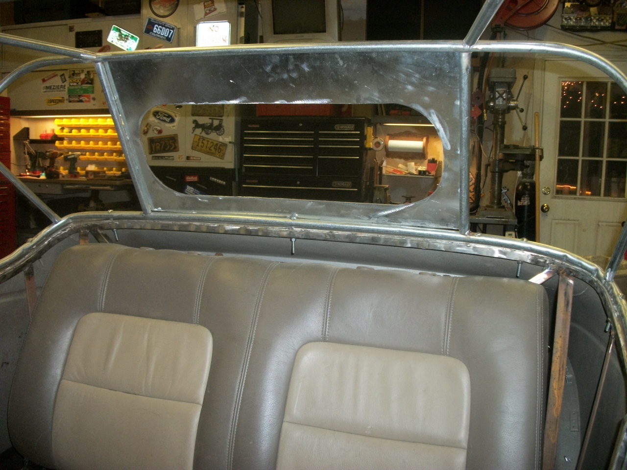

    I decided on 49 to 51 ford tail lights for the buick for three reasons. They aren't used nearly enough on hot rods, they fit the curve of my fenders, and are large enough to let the people behind me know I'm there. I also cut the rear window shape out of a metal panel and tacked it place so I can stare at it for a few days to see if I really like it.

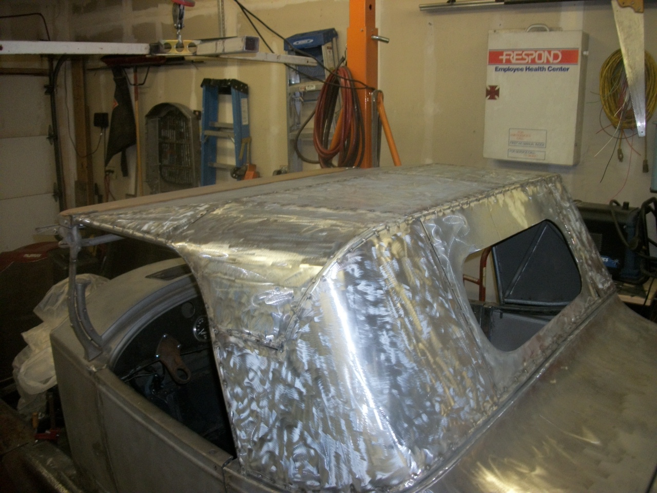

    Thanks guys. I spent the morning making paterns for the 20 guage steel roof underlayment, and the afternoon cutting and installing the metal portion. When this is finished the rag top material will lay over it so it will still have that rag top look. With only six bolts holding it down I should be able to take it off once in awhile and leave it at home.

    I finished up the metal on the roof of the buick, and finally got the rear gears installed so I could get the axles and brakes installed and make it a true roller.
