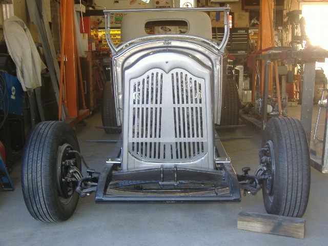

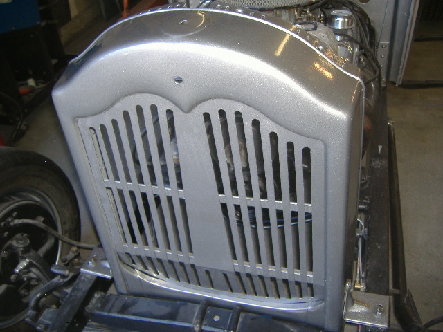

    I've been cleaning up some of the body metal mostly the front fenders. Hammer, grind, weld, over and over. So I decided to make some header flanges because there is not a lot out there for a nail head. I got them finished up, and then changed my mind on lake headers for this build, so an old set of sbc headers that were prime for cutting up and got new life as my new 401 buick headers.

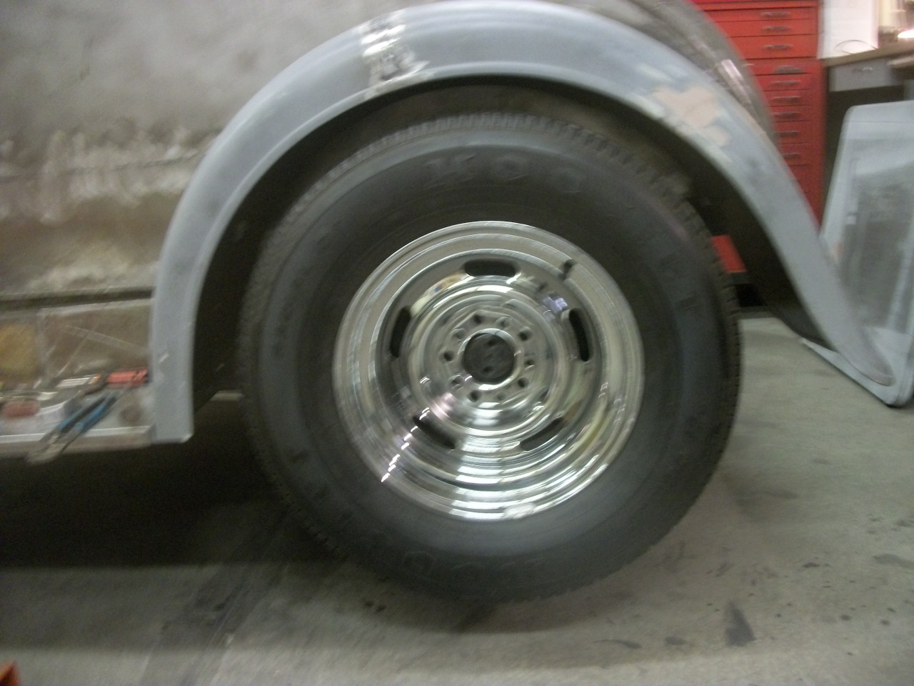

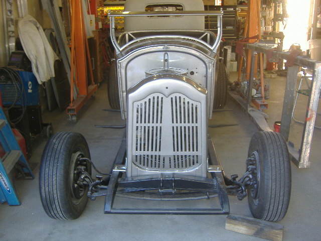

    The roadster for the most part is completely torn down and in the body work stage. YUCK. The rear fenders weren't for this car, and I didn't like the way the wheel opening was surrounding the tire, The radius of the fender edge because of some modifications I had done to the fenders sat high at the rear of the car and made the rear axle look like it was knocked off center, so I put the fenders back to shape and cut the quarters to make the two fit together and get the radius around the tire. The first two pictures are the before shot, and I can live with the way it is now even though it was a minor change.

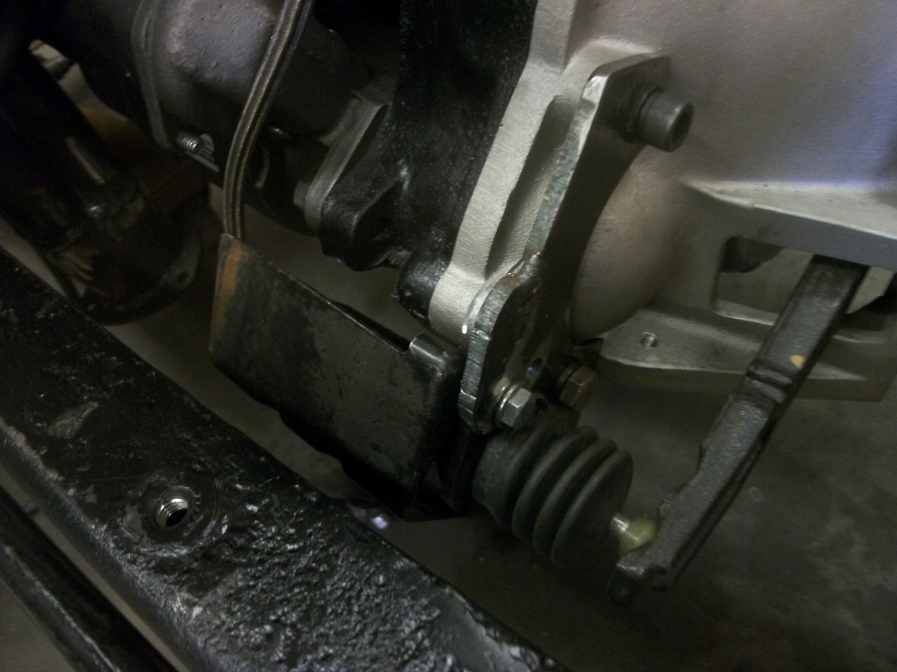

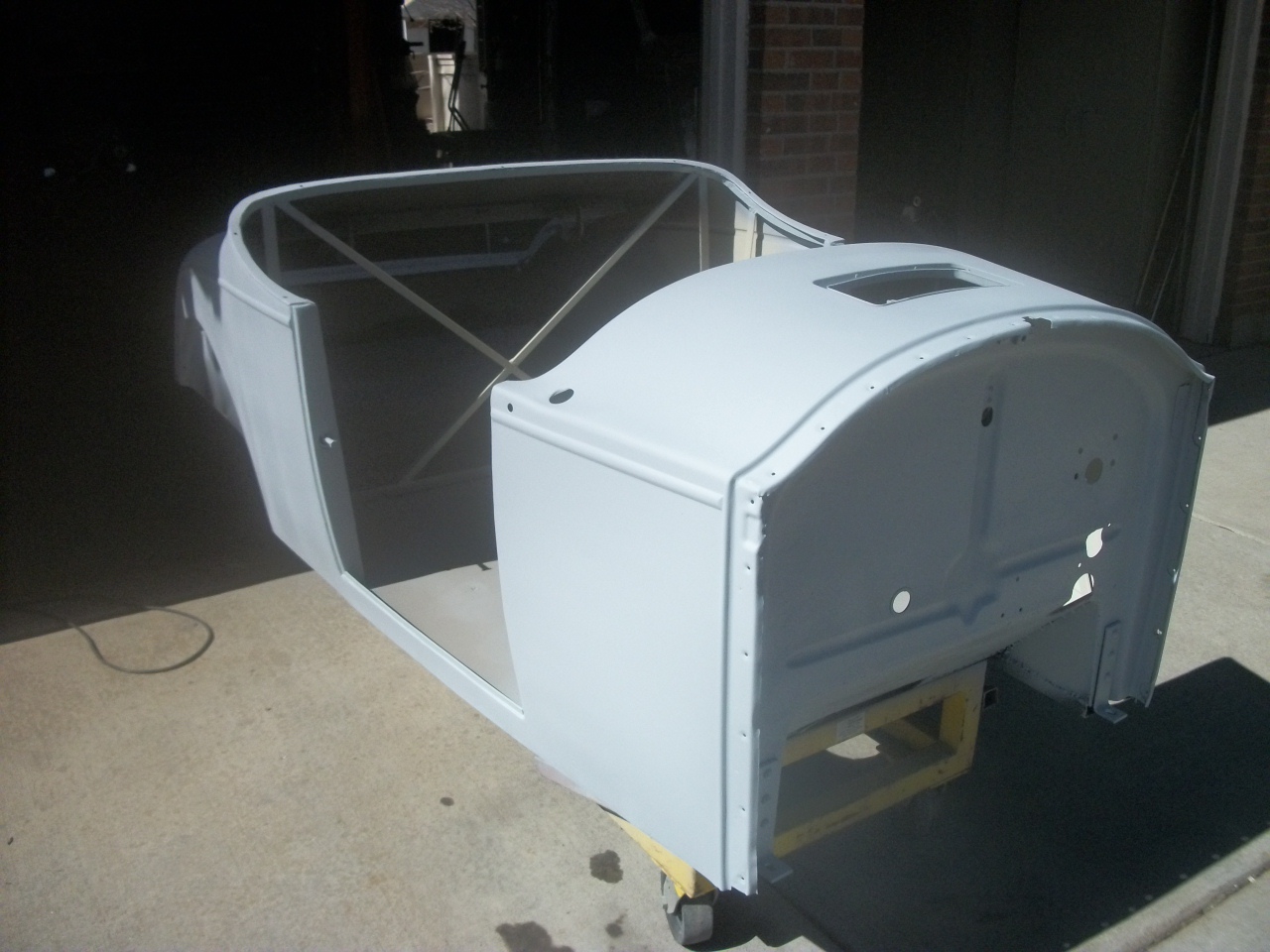

    The roadster is stripped down completely, and the main body was stood on it's nose and the underside paint and undercoating is done. the body, doors, and deck lid, has been body worked, primed, and blocked down once out of how many times??? I was also able to get the slave cylinder mounting bracket built, and the exhaust installed, except where it will exit the car.

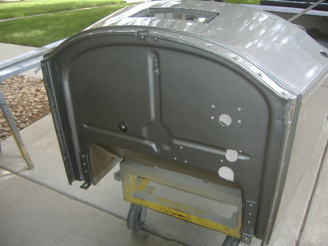

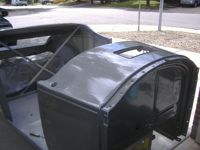

    Ghost28

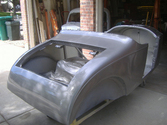

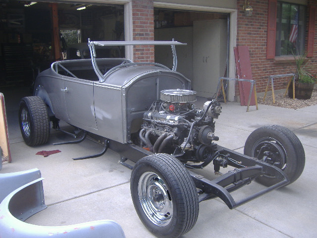

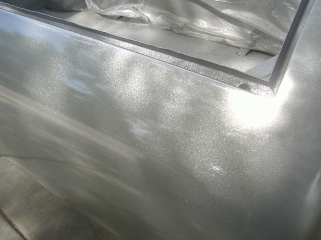

    DSCF2934.JPG DSCF2933.JPG DSCF2934.JPG DSCF2934.JPG Its been awhile since I posted anything about the buick. I finally got the body work finished and decided on a mid grey single stage paint with a heavy dose of metal flake. I was just gonna jam the car, but it looked good and I was on a roll so I shot the whole body in about 3 hrs last night. I got the fuel tank, battery surround mounted, and the block for the main power cables installed through the floor. I need a wiring harness and a few smaller items and then ***emble it. Maybe I can still manage a shakedown ride this summer.

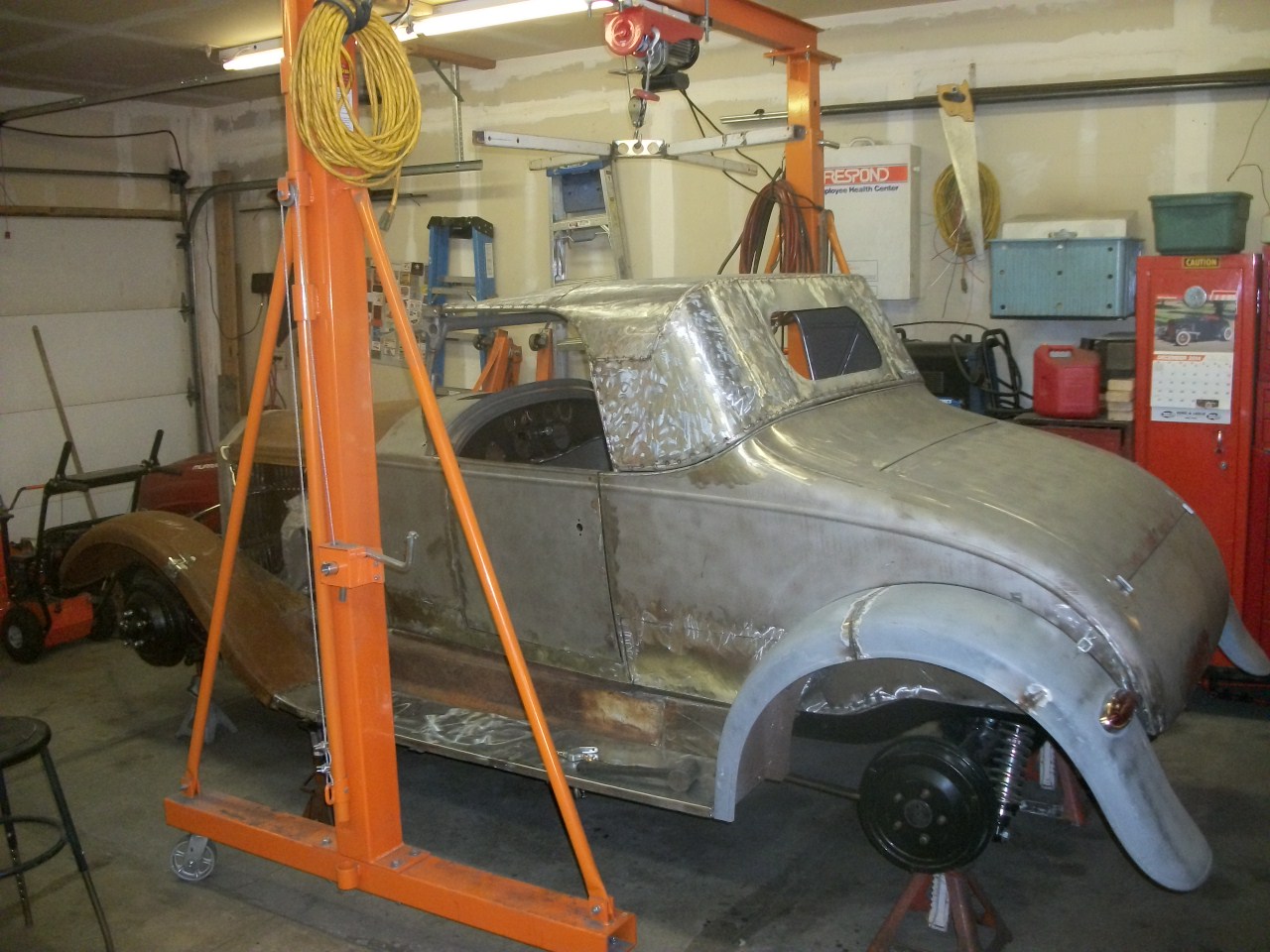

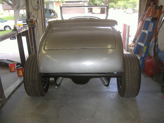

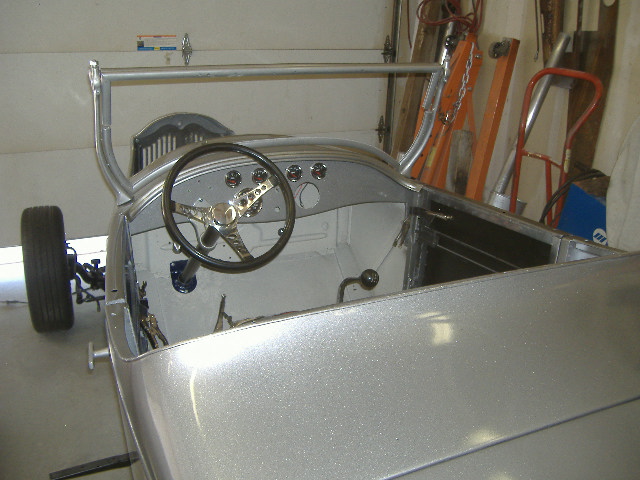

    DSCF2965.JPG DSCF2964.JPG DSCF2963.JPG DSCF2962.JPG DSCF2958.JPG DSCF2960.JPG I finished up some of the small painting. The wishield frames, posts, and the door handles are a chrome silver a very slight diference from the body. Since I was just sitting around I used a gantry crane and some carefull bracketry, and was able to lift and mount the body on the ch***is for the last time I hope. The fenders, running boards and splash aprons are gonna be a dark charcoal with the same metal flake, and the same brand paint. I hope it turns out like I visualize it.

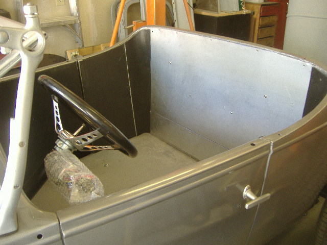

    DSCF2983.JPG DSCF2984.JPG DSCF2975.JPG I started making the interior boards including the kick panels. The boards area 1/8th inch thick plastic upholstery board that's smooth on one side and textured on the other, what I like about them is they are easy to shape for the tight corners with either a small propane torch, or a good heat gun, and stay in shape. I also made the bulk head between the trunk and p***enger compartment using a 1/8th inch thick sheet of aluminum. This will also get a upholstery board over it, and they will all be covered later on with material. The clips I am using are a chrysler item and work well with a 1/4 inch hole.

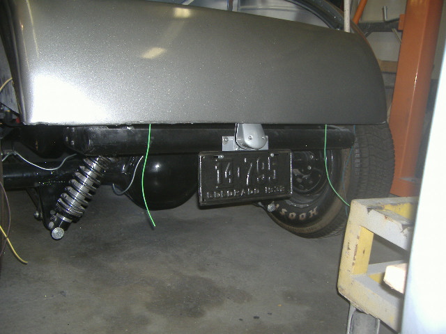

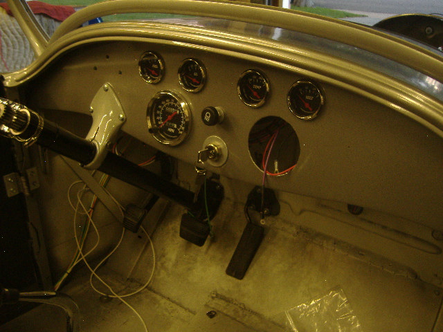

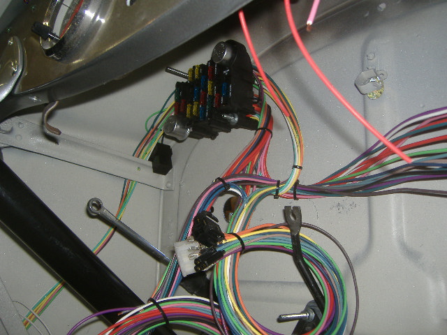

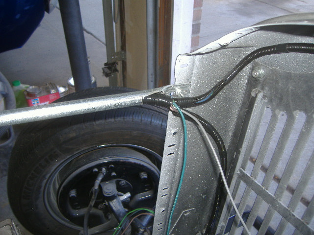

    DSCF2998.JPG DSCF2997.JPG DSCF2989.JPG DSCF2988.JPG DSCF3000.JPG I have been busy wiring the buick and it is now complete except the lighting front and rear. I was able to refurbish a old licence plated holder and light, not sure where it came from, but now it's buick. I have wired up the clutch pedal for a neutral safety switch, and the transmission for the backup lights if I so desire. I did find a couple of small interior lights for both kick panels, and the floor is lined with a eastwood heat a and noise barrier. fuel lines are ran and most of the brake lines have been completed except the front wheels. I did find a place for the porcelin buick emblem that used to be on the old tail light housing. Hell I might be able to drive it soon.

    The paint brand is called 5 star extreme. It's a single stage paint with the heavy dose of small metalic allready in it. Fairly inexpensive, about $140.00 for the paint gallon, hardener, and a gallon reducer. I bought the silver metalic, and the charcoal metalic and mixed them equally together to get it a little darker than the silver by itself.
