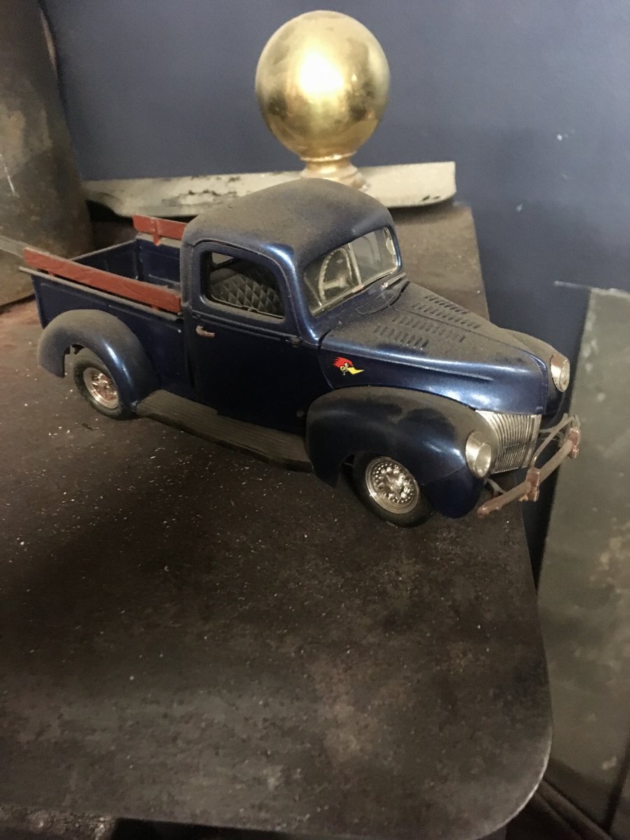

    CD5DE7A7-E2AB-4419-93F4-5EC3363D9BA2.jpeg A spare the same height as rear tire in case you ever have to use it.
    If my model i built decades ago is any indication there’s no dimple in fender
