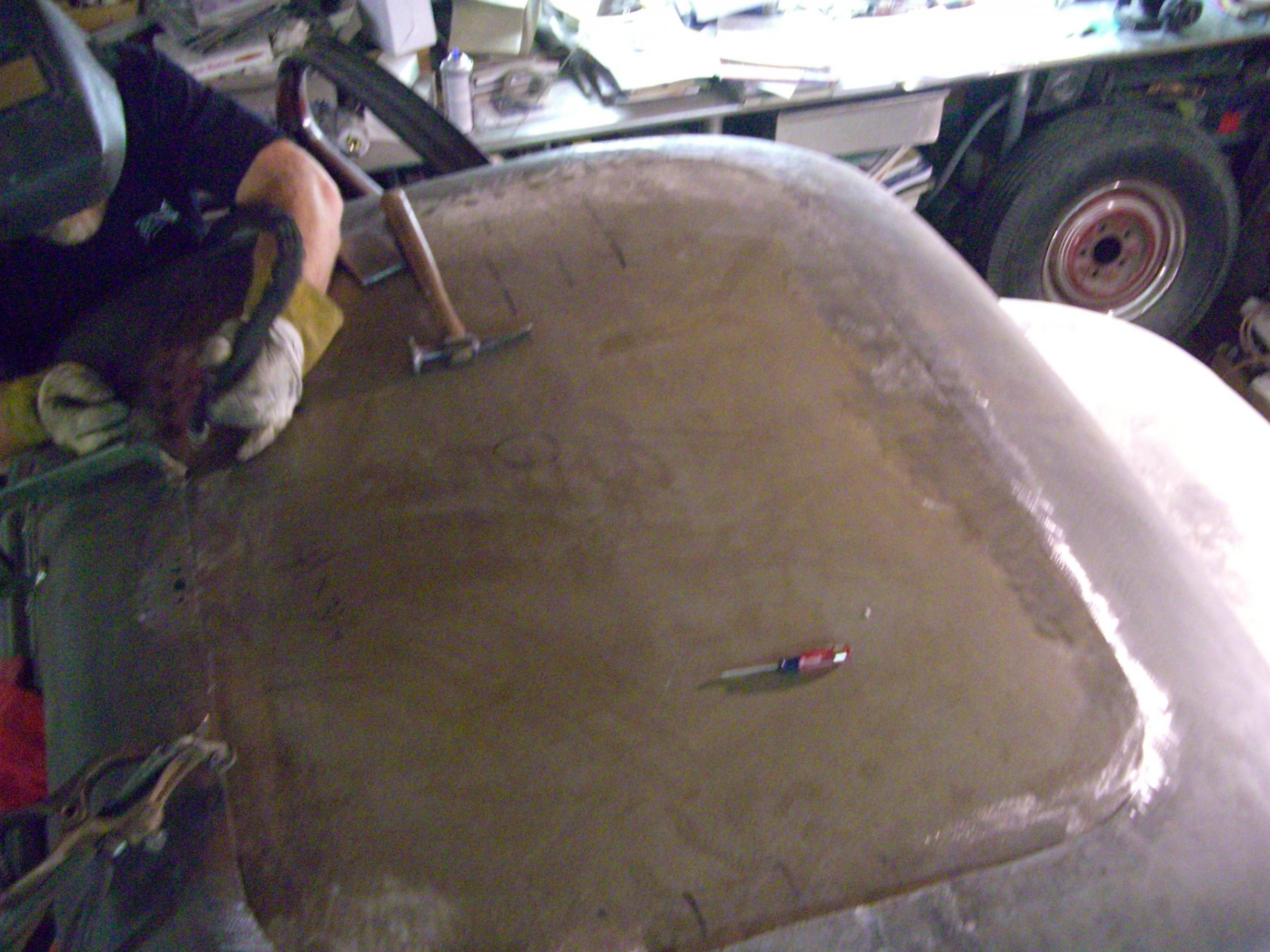

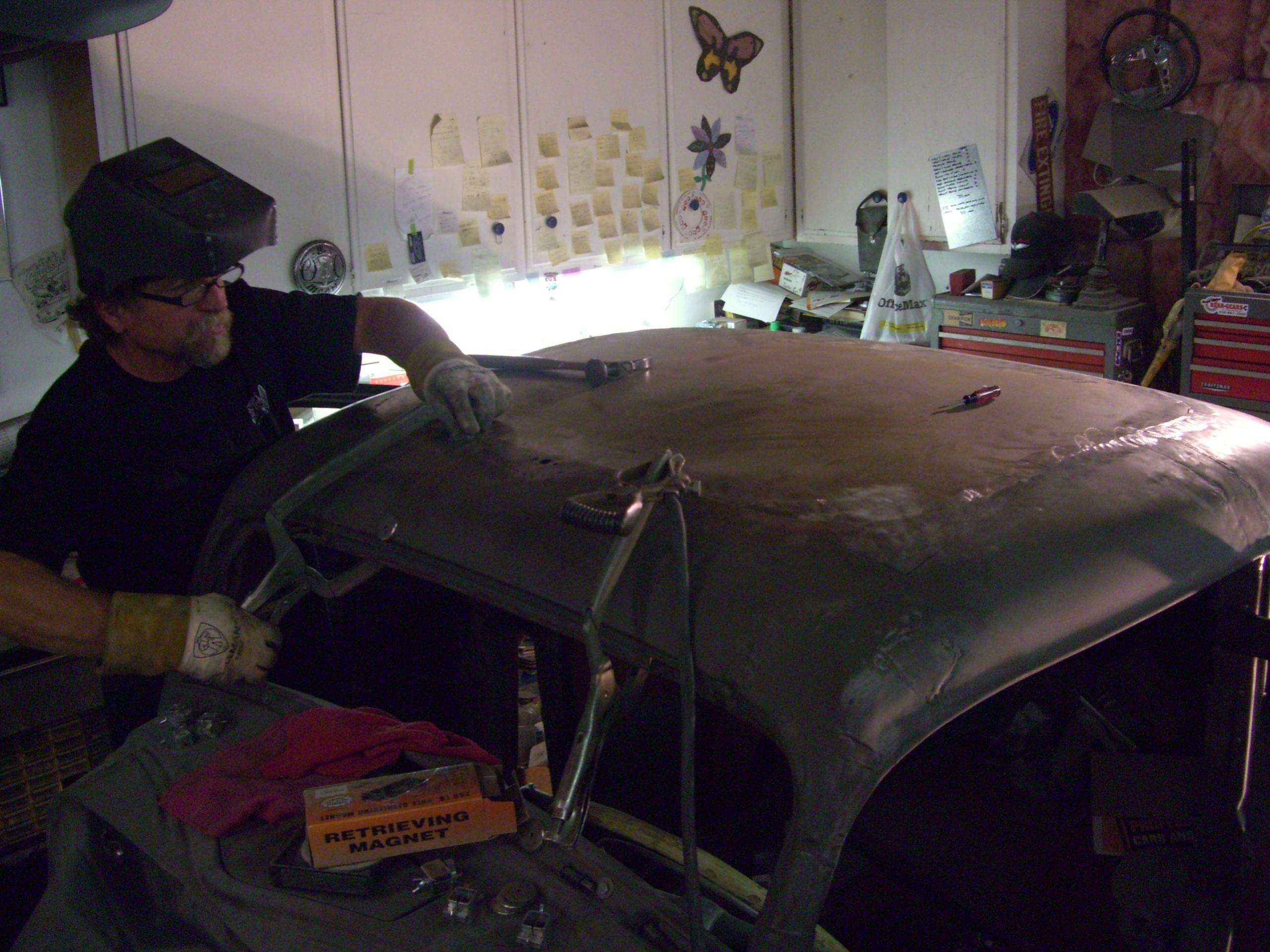

    filling the top

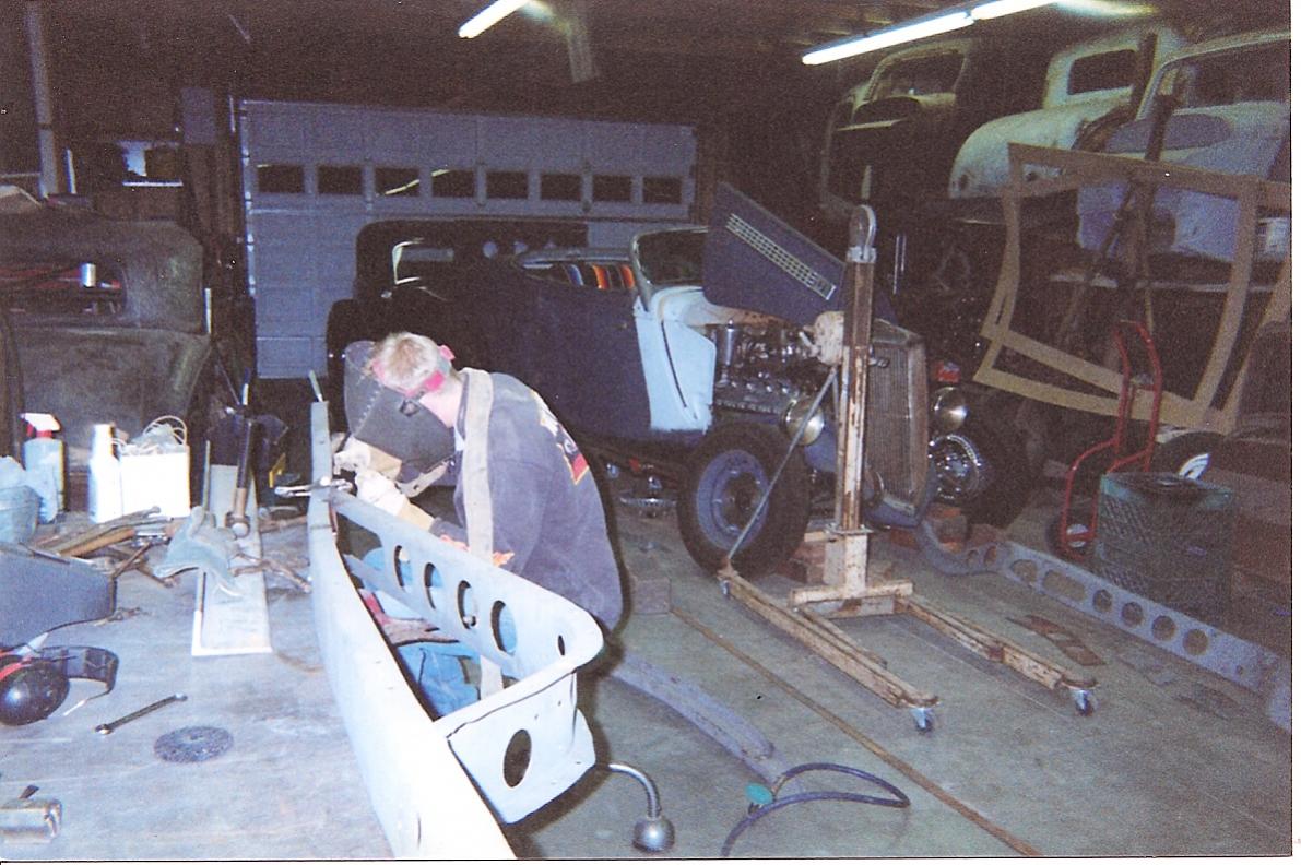

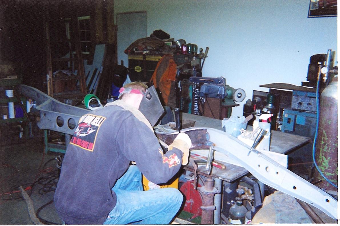

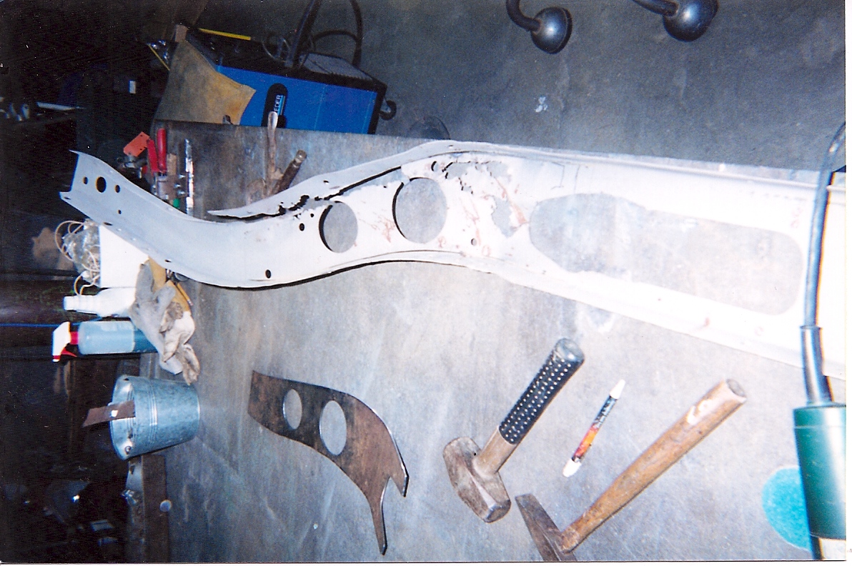

    The frame we used was pretty bad so we split the rails and repaired all the cancer spots. After all new frame sections had been installed we riveted the frame back together and put it on a frame jig to make sure the frame was square before we boxed and built all the cross braces.

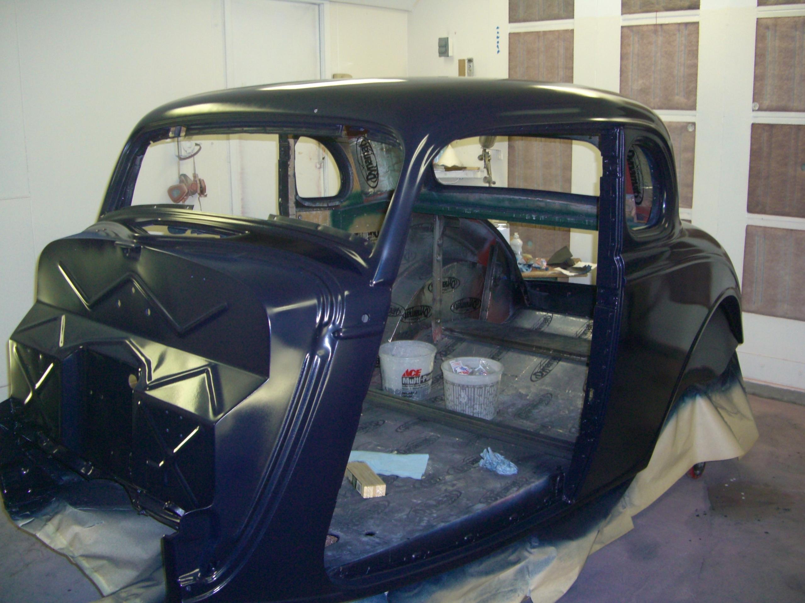

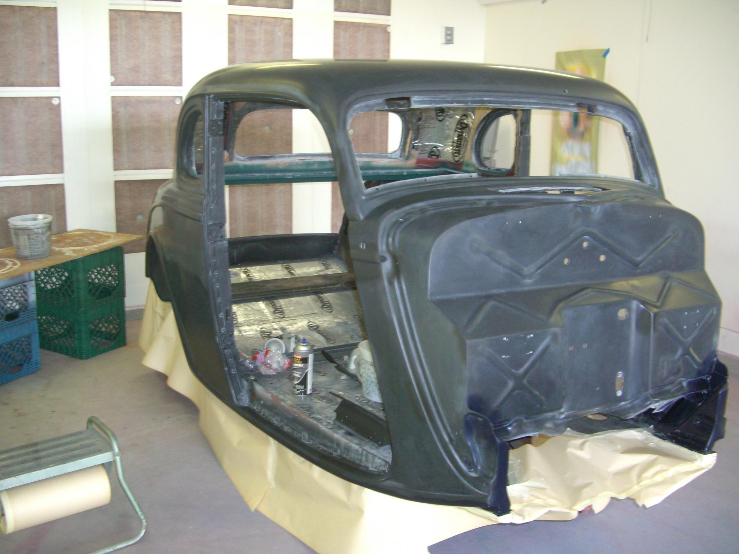

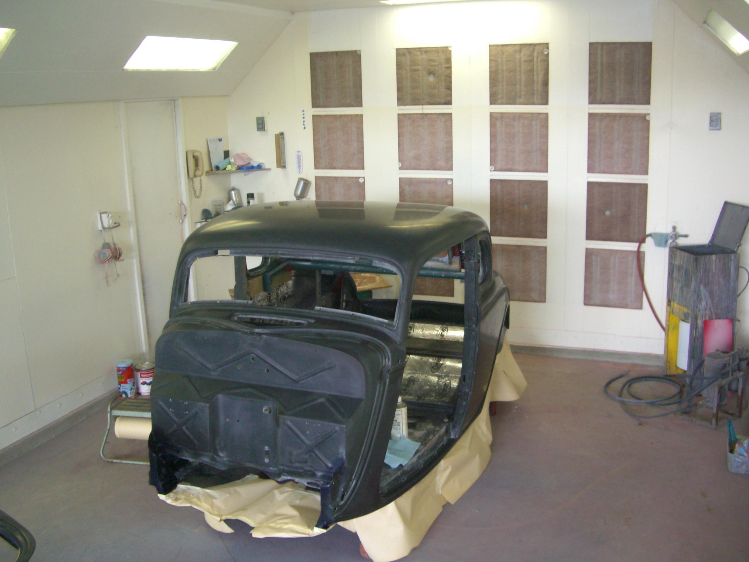

    Finally got the body work finished and in the paint booth.. more to come tomorrow!

    This is after two p***es. 57 cadillac Cobalt blue in Lacquer, its a lot of work to do a Lacquer paint job but will be well worth it when its finished.

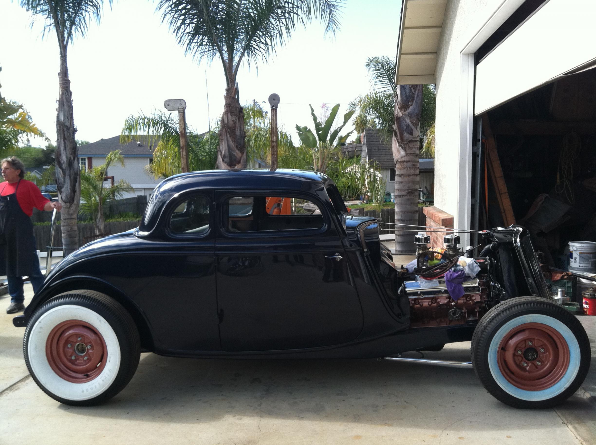

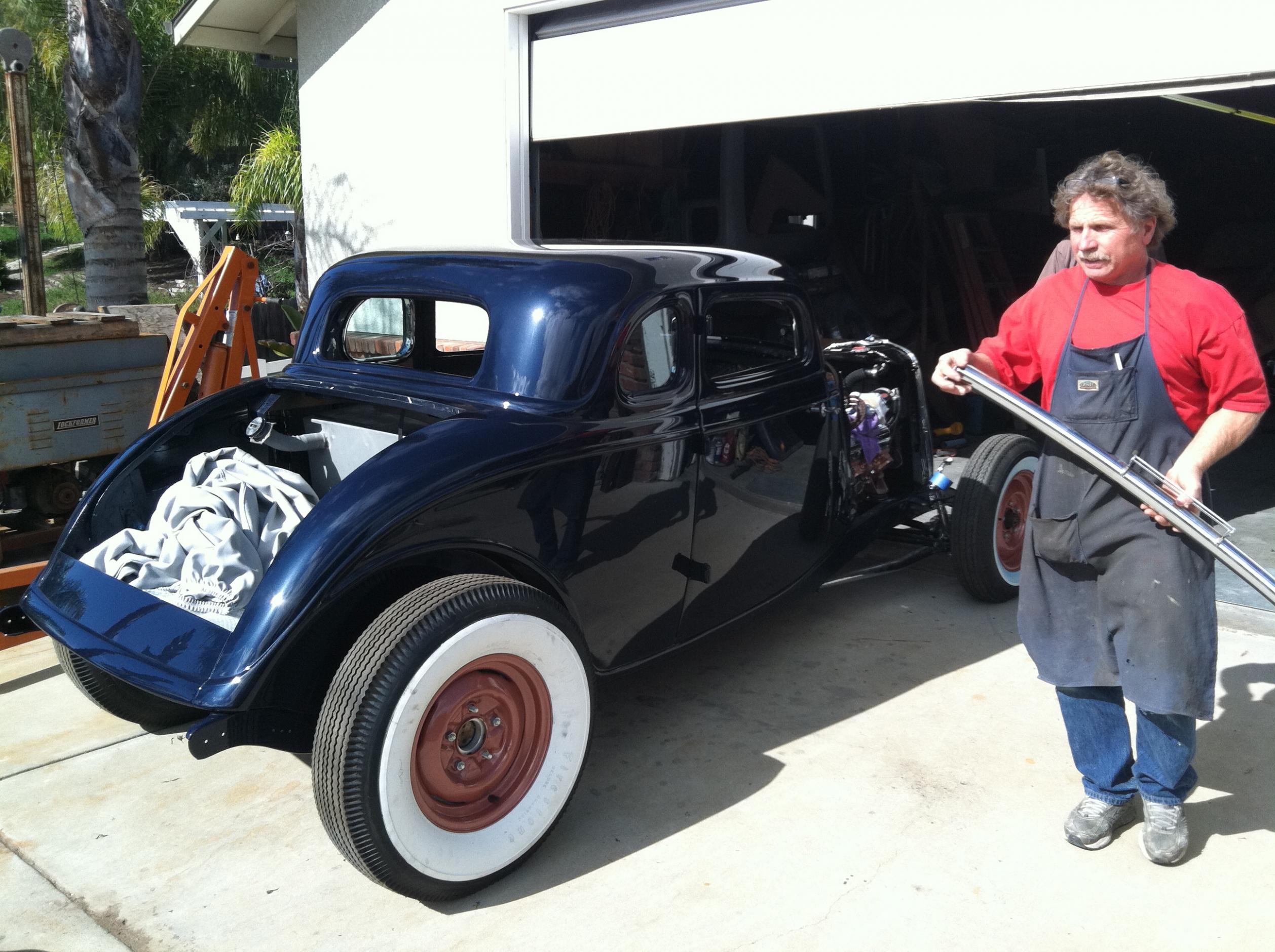

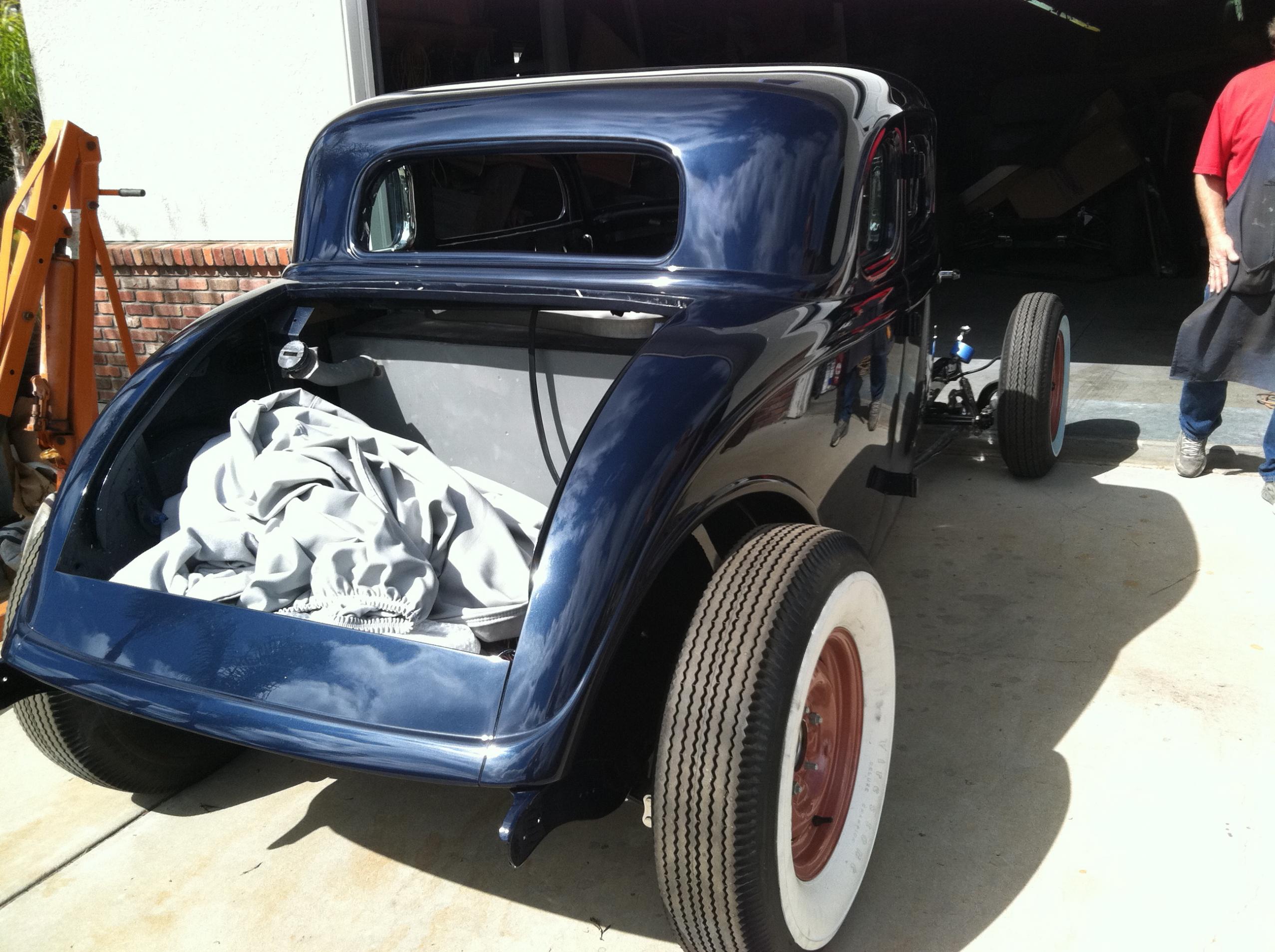

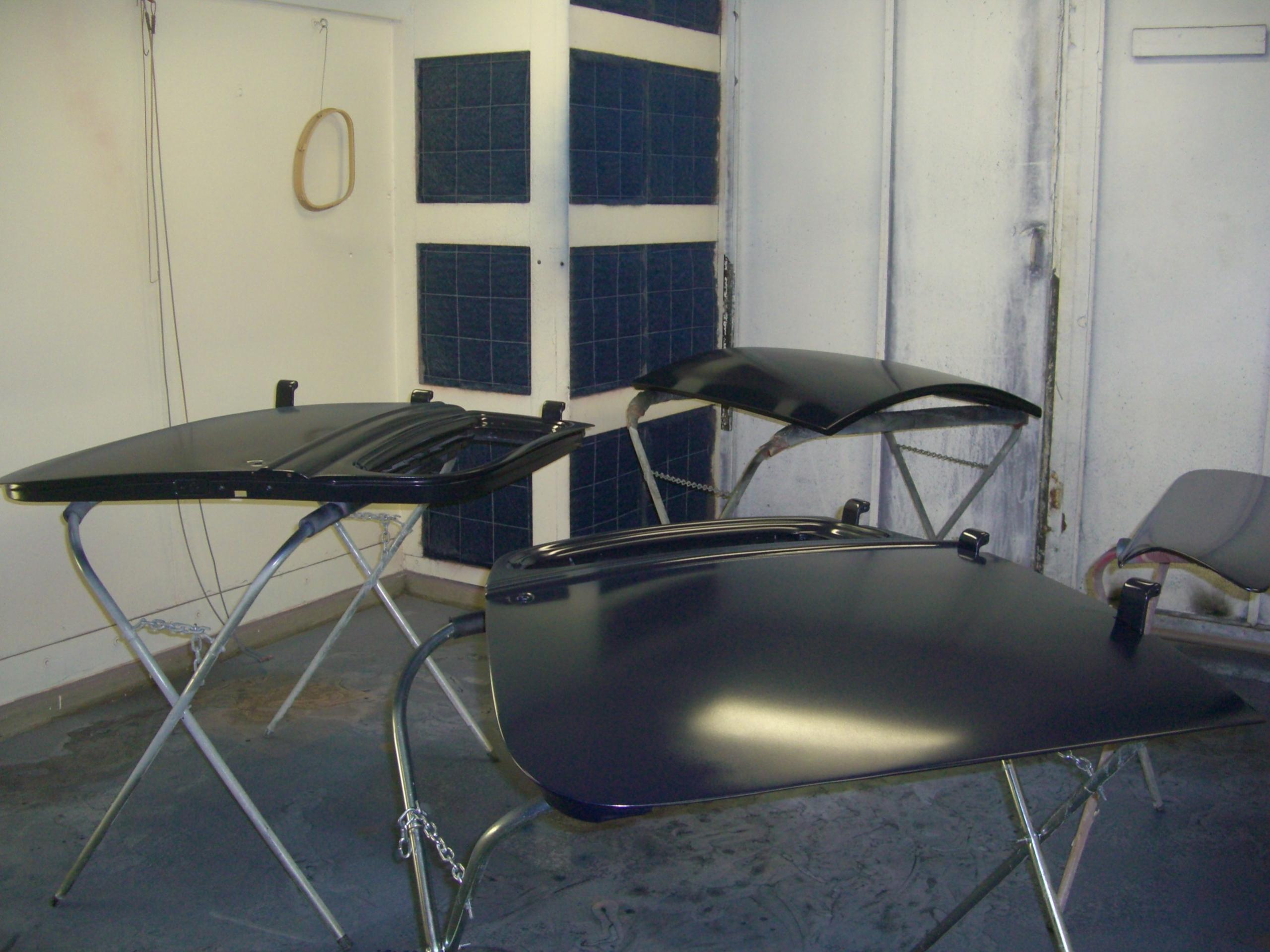

    Latest update... shes been painted, rubbed out, and beginning to be put back together.
