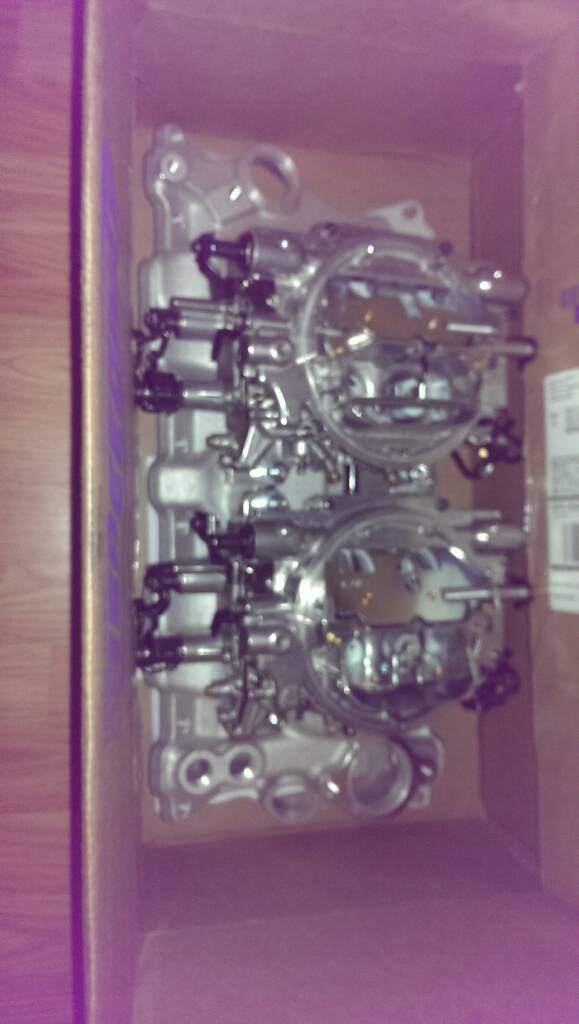

    Some of you know that a couple months ago I bought a '34 Ford roadster project car. My plan was to rebuild a 350 Chev TBI engine I have on hand as a 383 stroker, swap the 4l60 for 700R4 and disguise the whole thing as a 283. Faking something though really goes against my better nature, and I satisfied my conscience today by buying a very nice, mildly built 283 with a 350 Turbo already behind it from a guy who's replacing it in his '65 Chevelle with a blown LS (not that this matters one whit).
    I have, and would like to use on the 283, which has a 650 Holley on and Edelbrock now, the early Offy dual quad intake and pair of new Edelbrock carbs I was going to use on the 383. Here's the question:
    I don't know what cam is in this engine. I've heard it run, it's got a lope-y idle and, sounds nice and tight, no smoke, no blow by. I don't want to overwhelm the little 283. Would it possible to run just one carb, block the other off like people do with 3x2 intakes running just the center carb? The manifold has an open plenum.
    Or, progressive linkage and worry about it if it turns out to be too much carb? One of the carbs I have is a 600, the other is a 500, which I got thinking two 600's would be too much for the 383. I had the 600 initially which I'd bought for my boat, and never used, that's why I have a mis-matched pair of carbs.
    So, am I all wet, or will a high revving 283 be happy with those carbs?

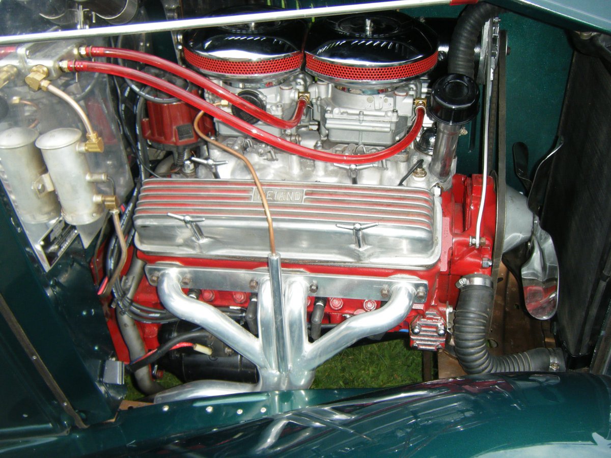

    You're right Brian, nothing says Hot Rod like dual quads! Have them on my'32.
    Here's mine 061.JPG My '57 Pontiac has Tri Power! KK

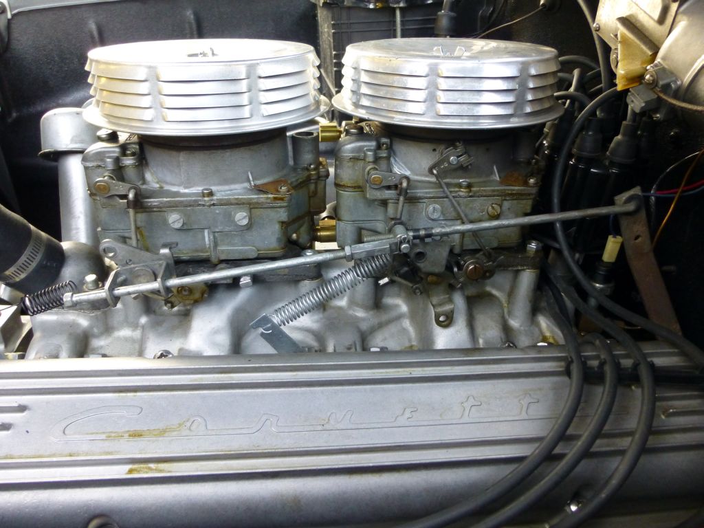

    you could make the stock 2x4 chevy progressive. correct linkage.jpg linkage work. its available as a complete kit.
