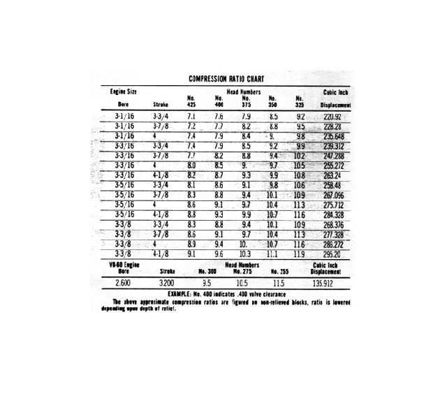

  4. Kiwi 4d
    Joined: Sep 16, 2006
    Posts: 3,884
    Kiwi 4d
    This will get you started. There are more comprehensive charts out there.

  7. dmarv
    Joined: Oct 10, 2005
    Posts: 977
    dmarv
    Alliance Vendor
    from Exeter, CA
    42merc is correct, the number on Offenhauser heads correlate to the valve lift of the camshaft. It is important to note that the compression ratio chart Kiwi 4d posted from the Offenhauser catalog is based on stock valve diameter, non-relieved blocks, and factory pistons. Enlarging your valve diameter will decrease the camshaft valve lift allowed. Relieving the block will decrease compression ratio. Pop up pistons will increase your compression ratio. To put it simply (as far as increasing your horsepower) if all factors on your engine remain the same, a higher compression ratio will increase horsepower.
