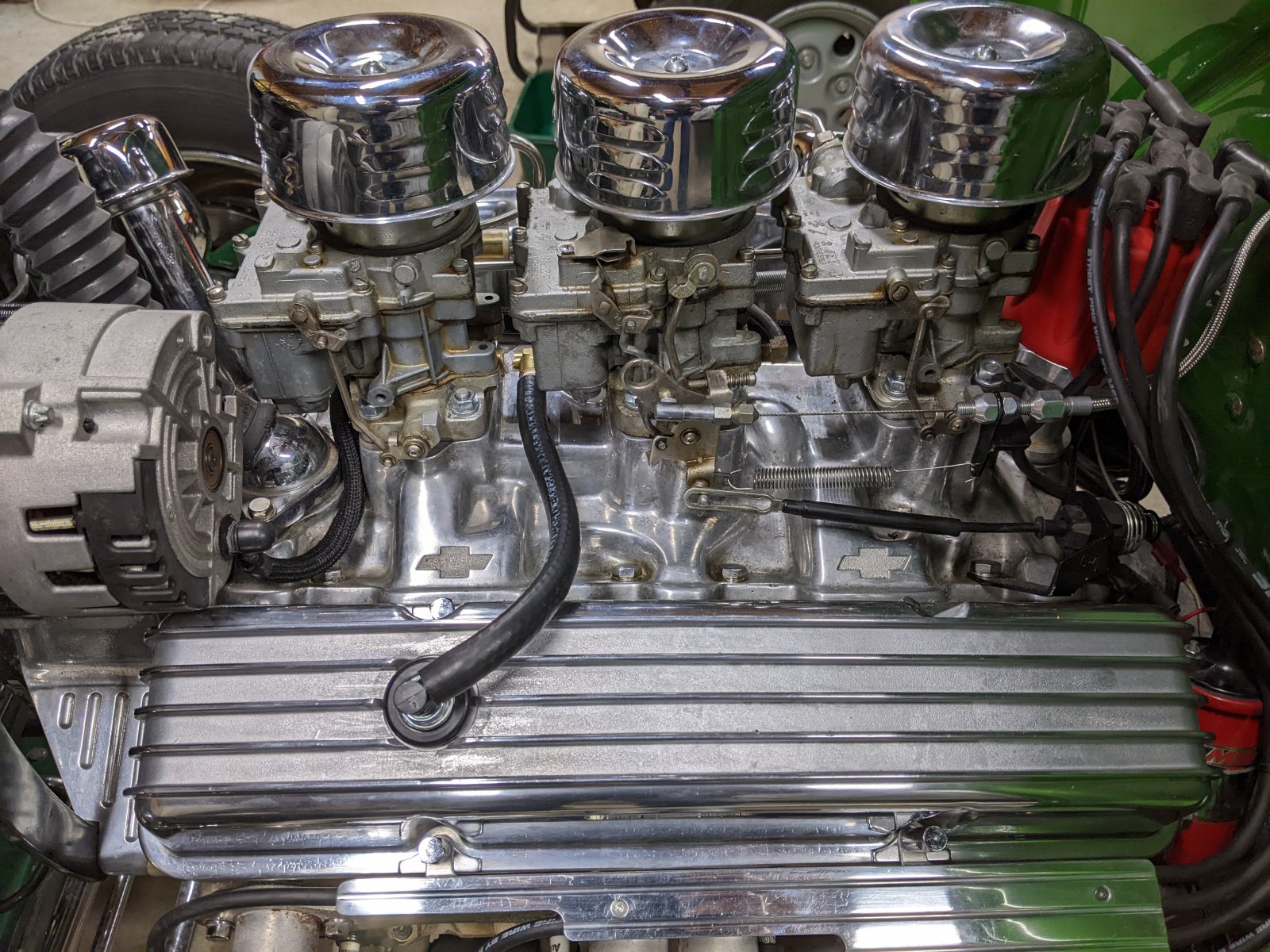

    So, I finally got the PCV system installed. As I mentioned it turned out that the rear carburetor had a plug full vacuum port. Since there wasn't enough room to install a fitting on the rear carb I swapped it with the front carb. The PCV valve is in the driver's side valve cover and it draws in air from filtered vents on the p***enger valve cover and the oil filler tube. I'm pulling 17 inches of vacuum I just hope the volume is enough. PXL_20221027_014951655.jpg

    Your system appears to also drawing outside air from the oil filler cap if it is vented.

    Won't the front cylinders end up a little leaner with the PCV in the base of the front carb; seems to me flow would be better balanced if the PCV was connected to the base of the center carb.

    If it is an open cap rather that a closed cap (filtering media) it is not functional. Even with a closed cap, just the rocker cover vents will not successfully ventilate the crankcase.

    Both the p***enger valve cover and oil filler tube are vented using filtered breather caps. The front carb may run a little lean but I couldn't connect it to the center carb port because it is used for distributor advance. I'm running a progressive linkage that doesn't kick it until at least half throttle. That said, you did get me thinking I need to recheck the air/fuel mixture at idle as it has probably leaned out a bit.
