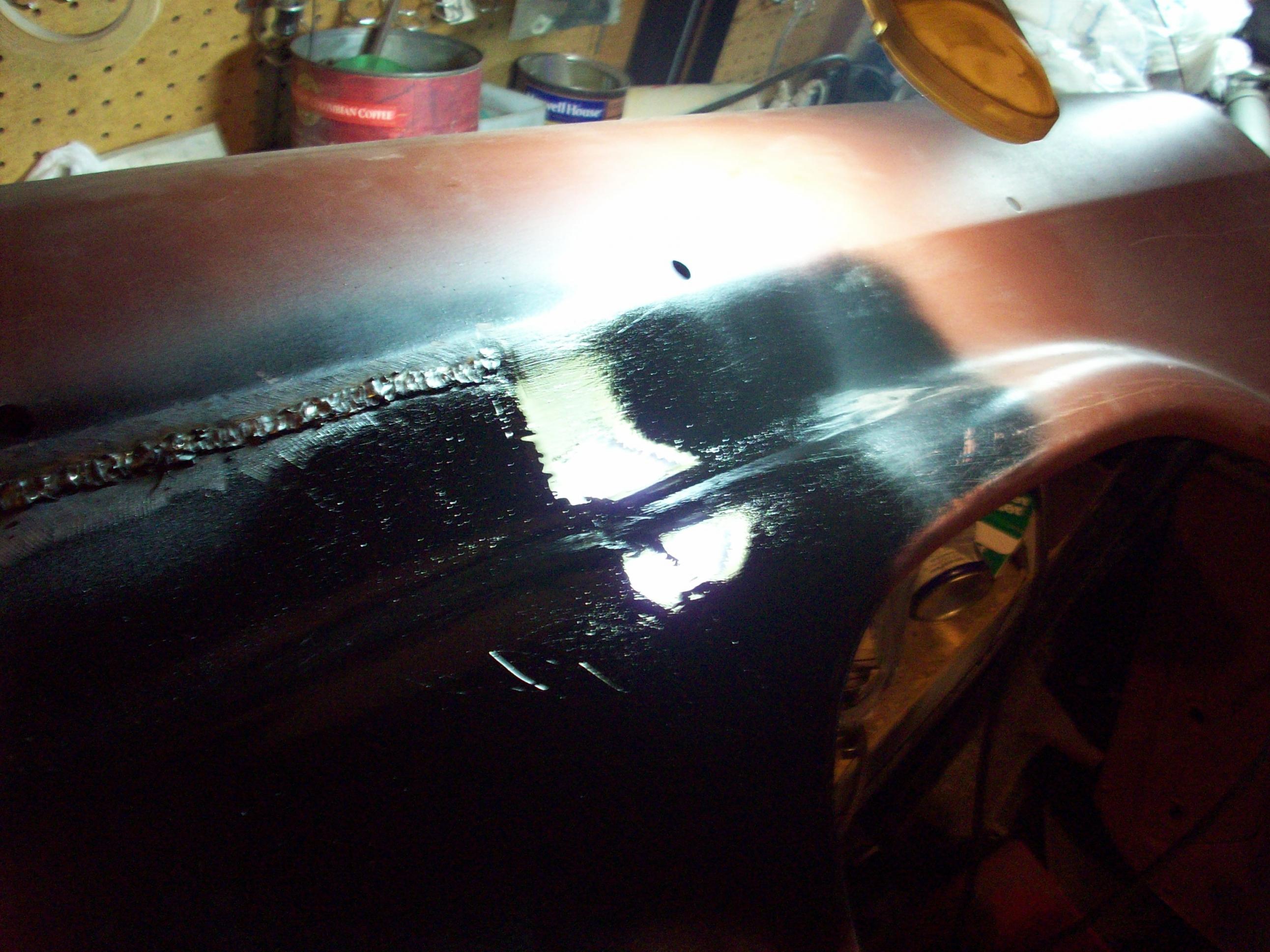

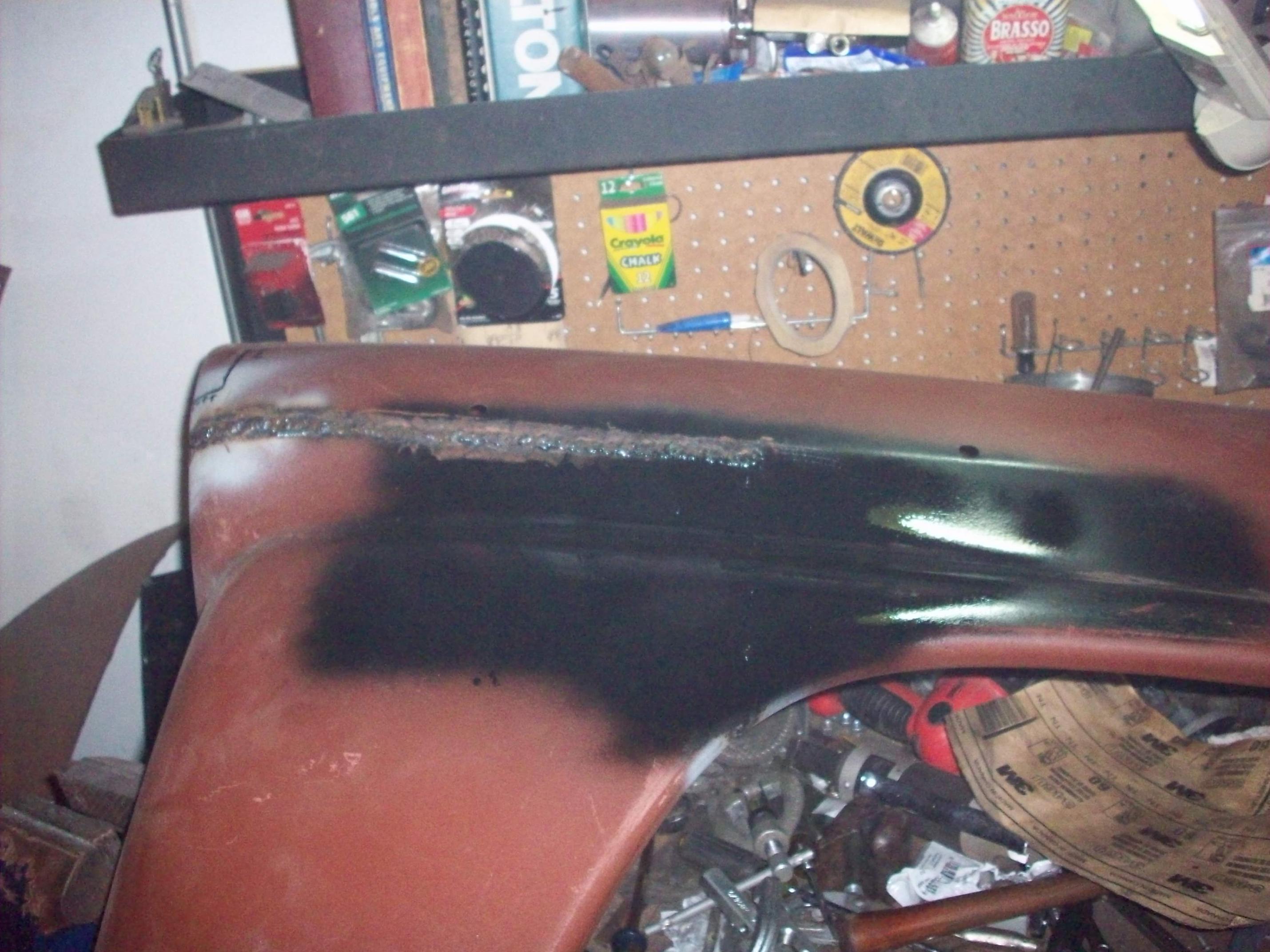

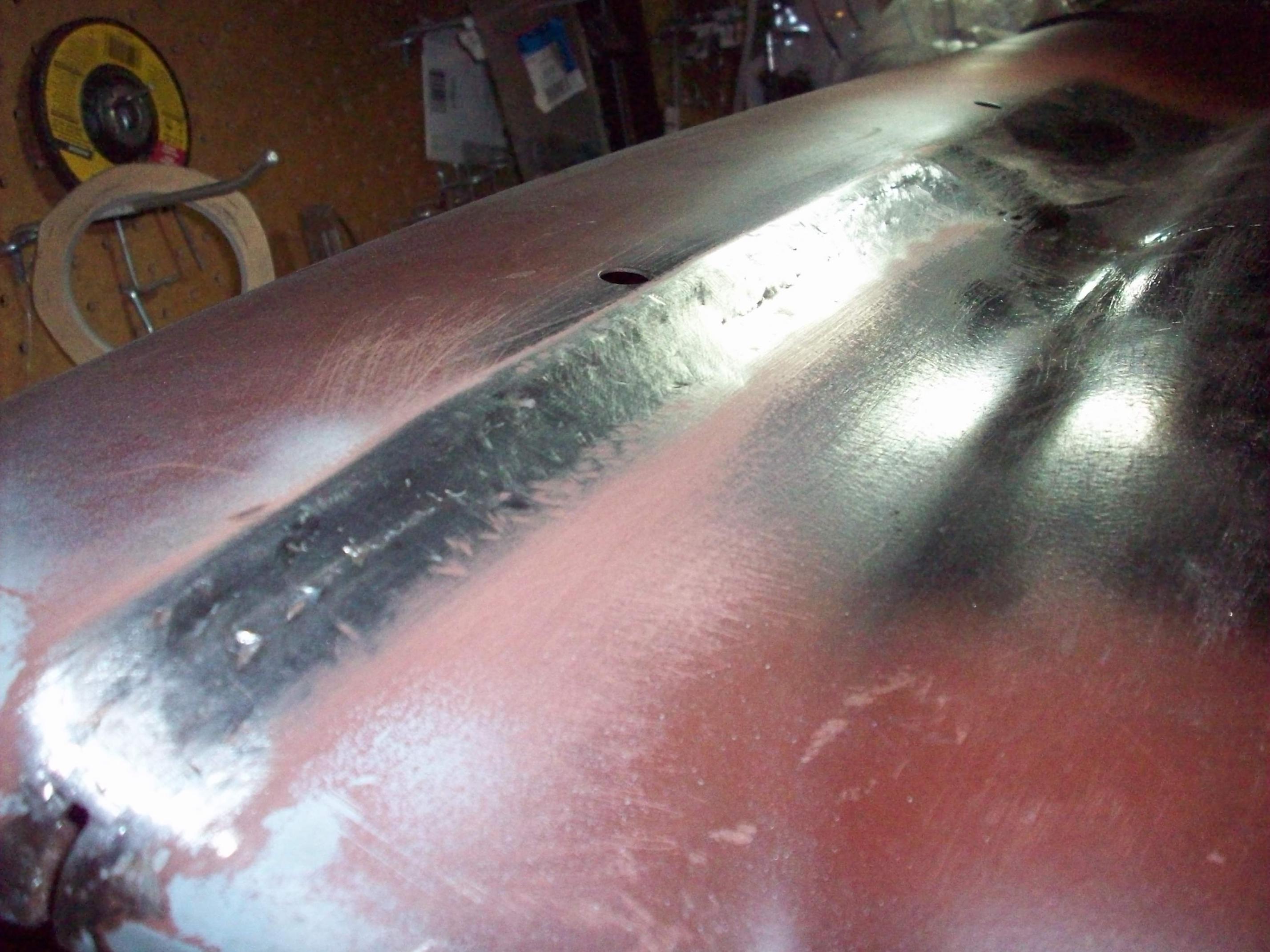

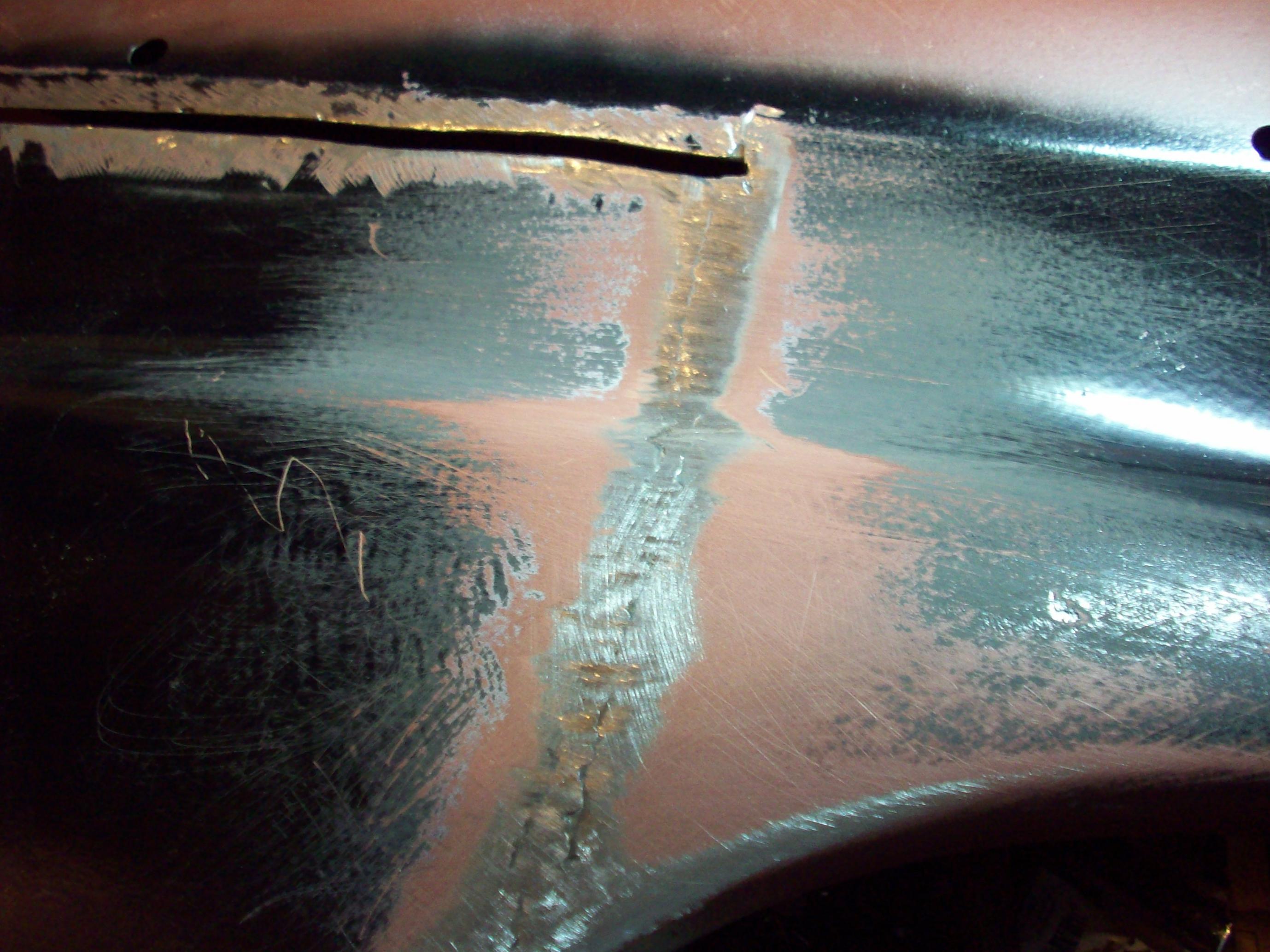

    Well here is that weld ground down in the pictures below... it is as close as I can get it and filler will just have to do the rest.. I wont be cutting this thing apart again any time soon. If I do need to I am just going to throw down for a new fender. :p Too much time invested as it is... but good practice for other bigger body work.

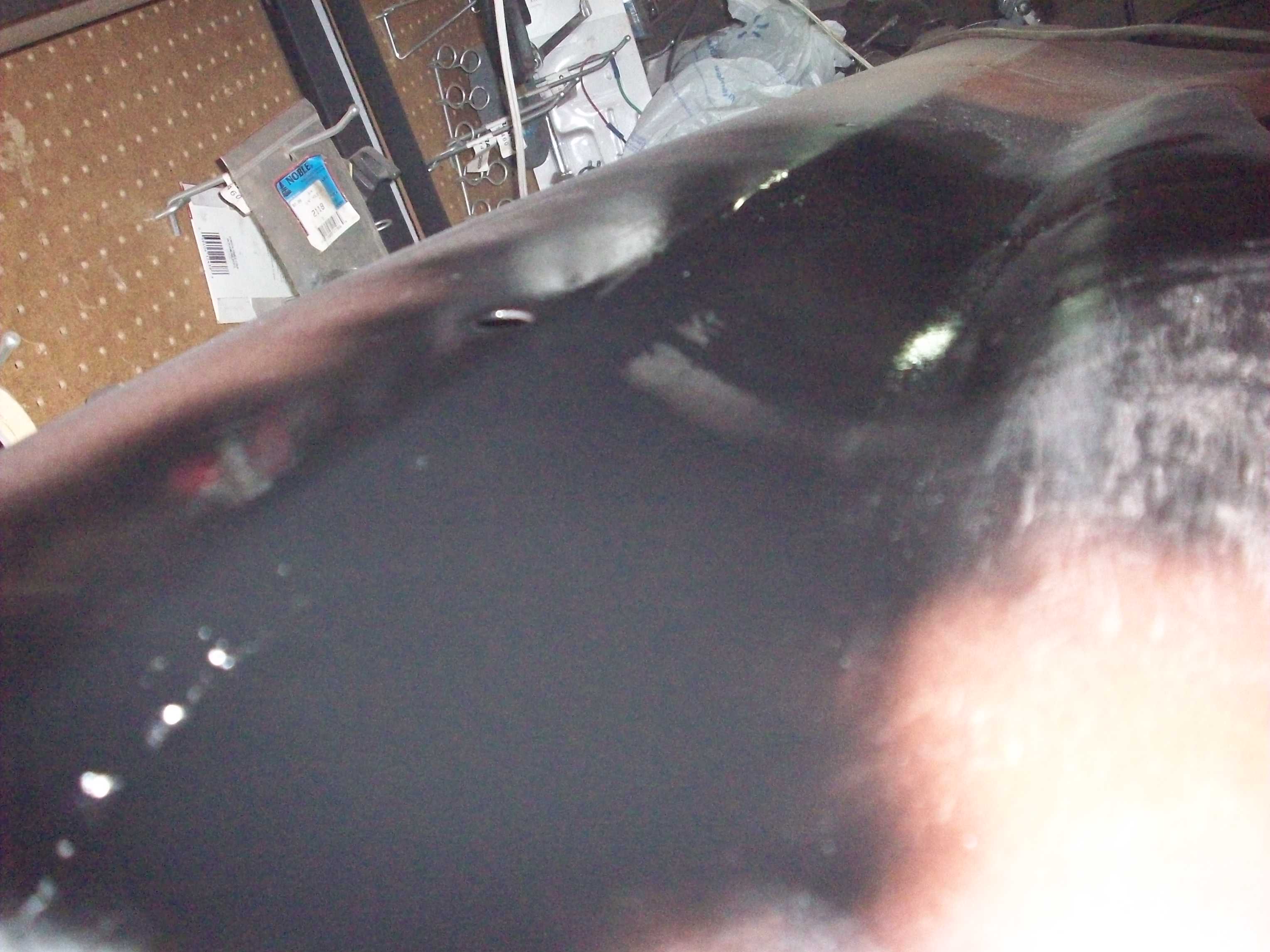

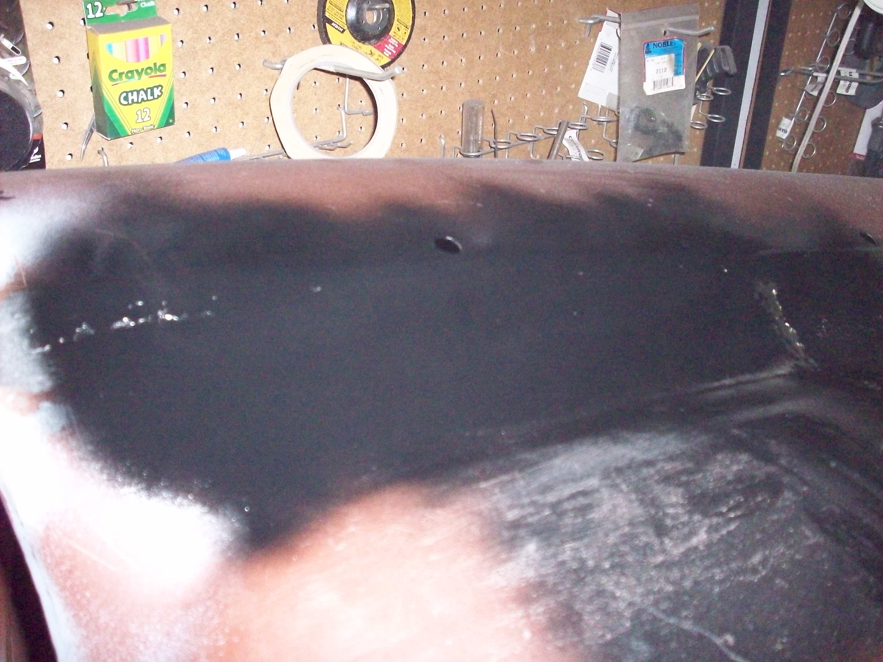

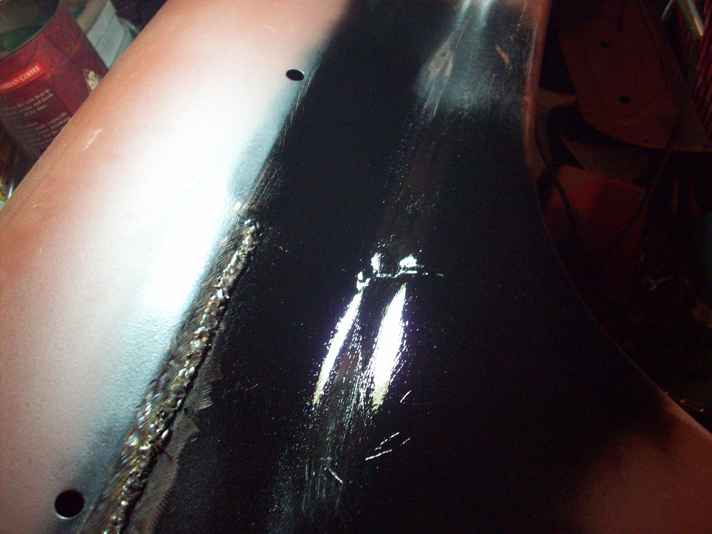

    Here are some more pictures with some gloss to see how far off the fender is at this point.. Its not bad, but I guess I can deal with it.. Its a hell of a lot better than it was.

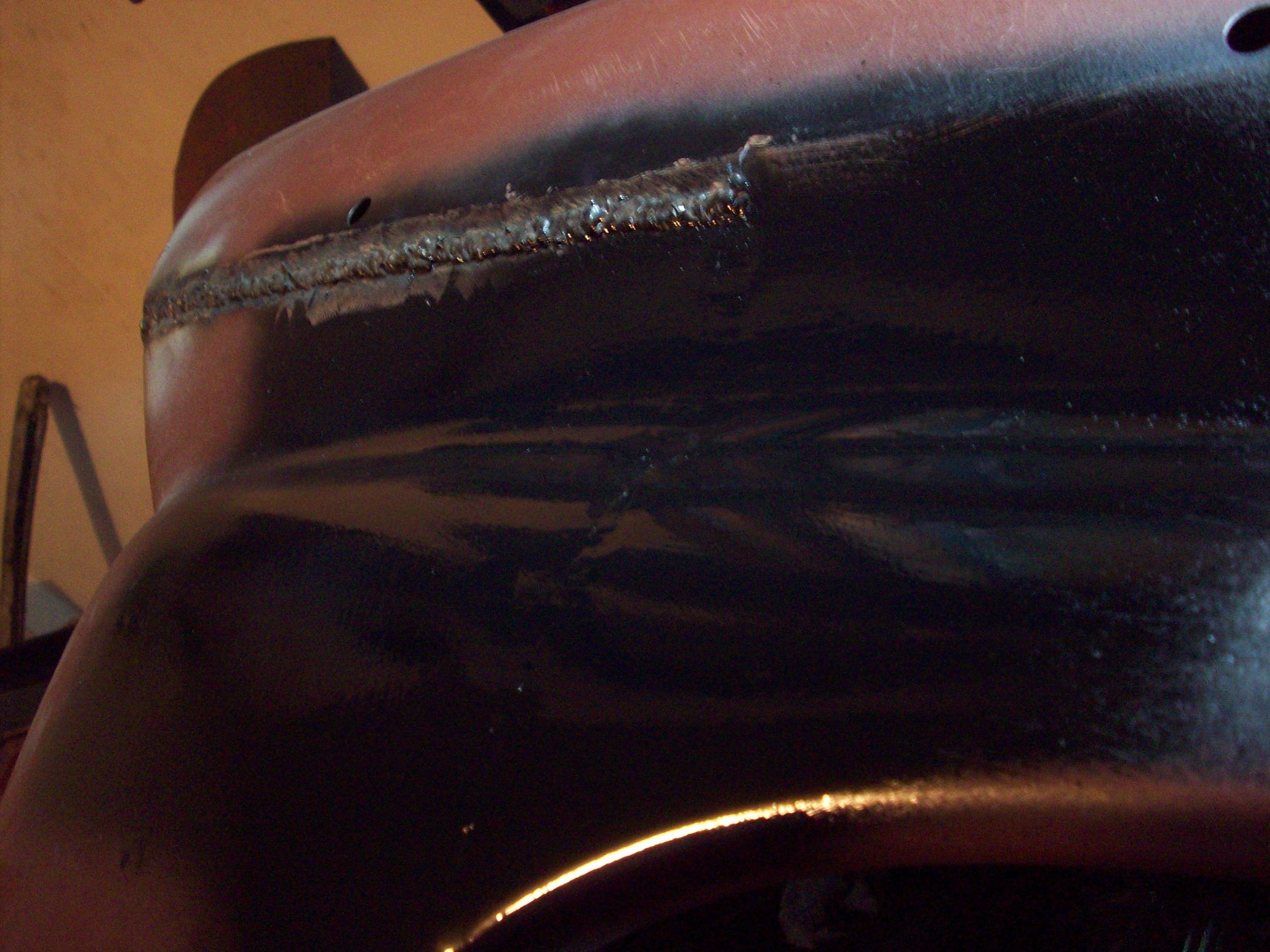

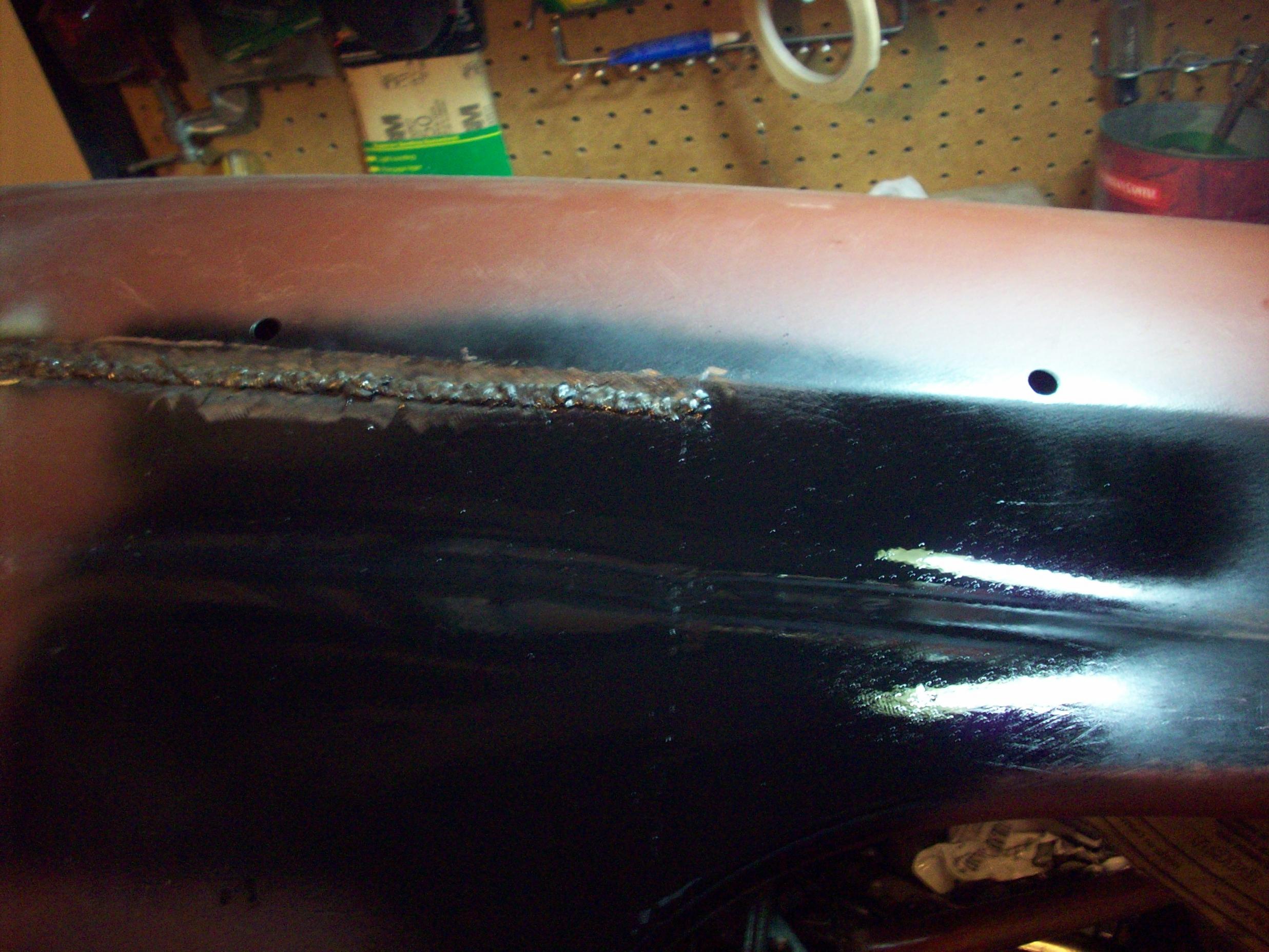

    One more batch of pictures.. a lot of smoke from welding.. Getting there.:eek:

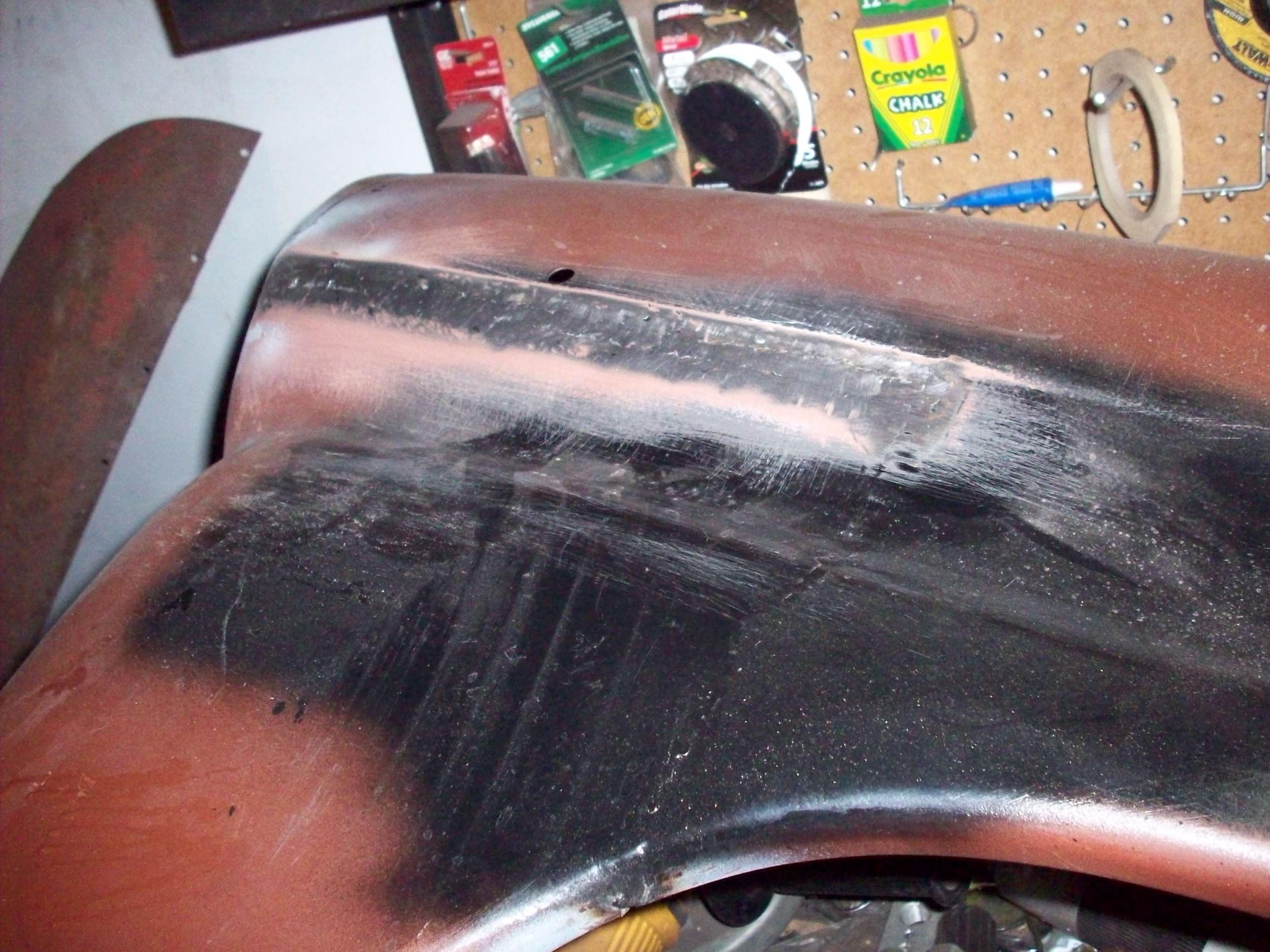

    Here are some more pictures.... the body lines are pretty straight.. everything else can be tweaked, but those.

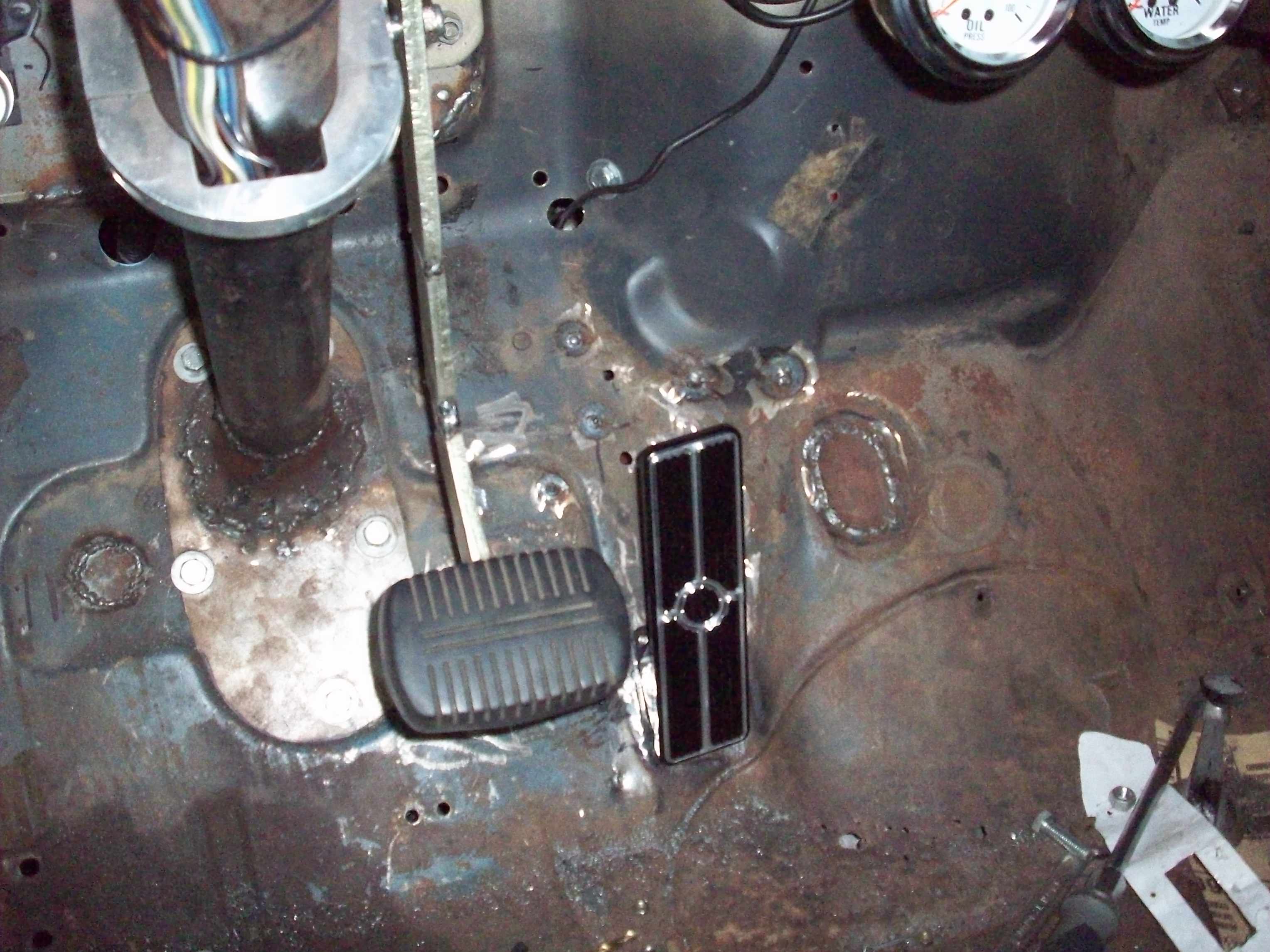

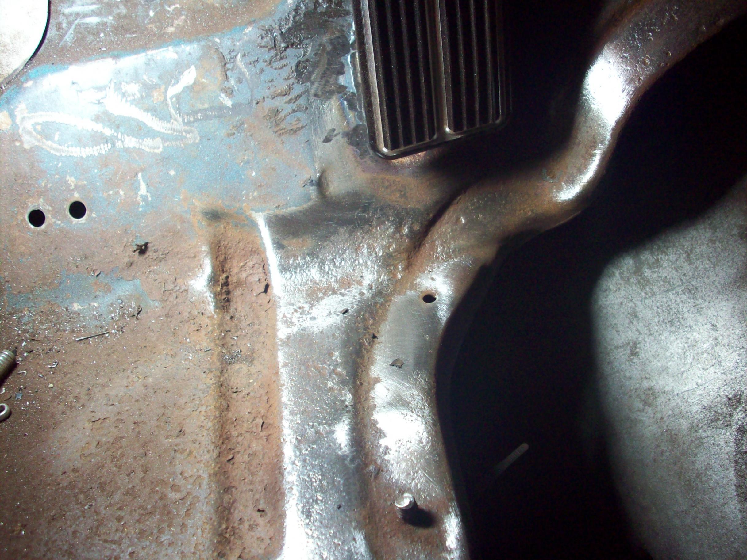

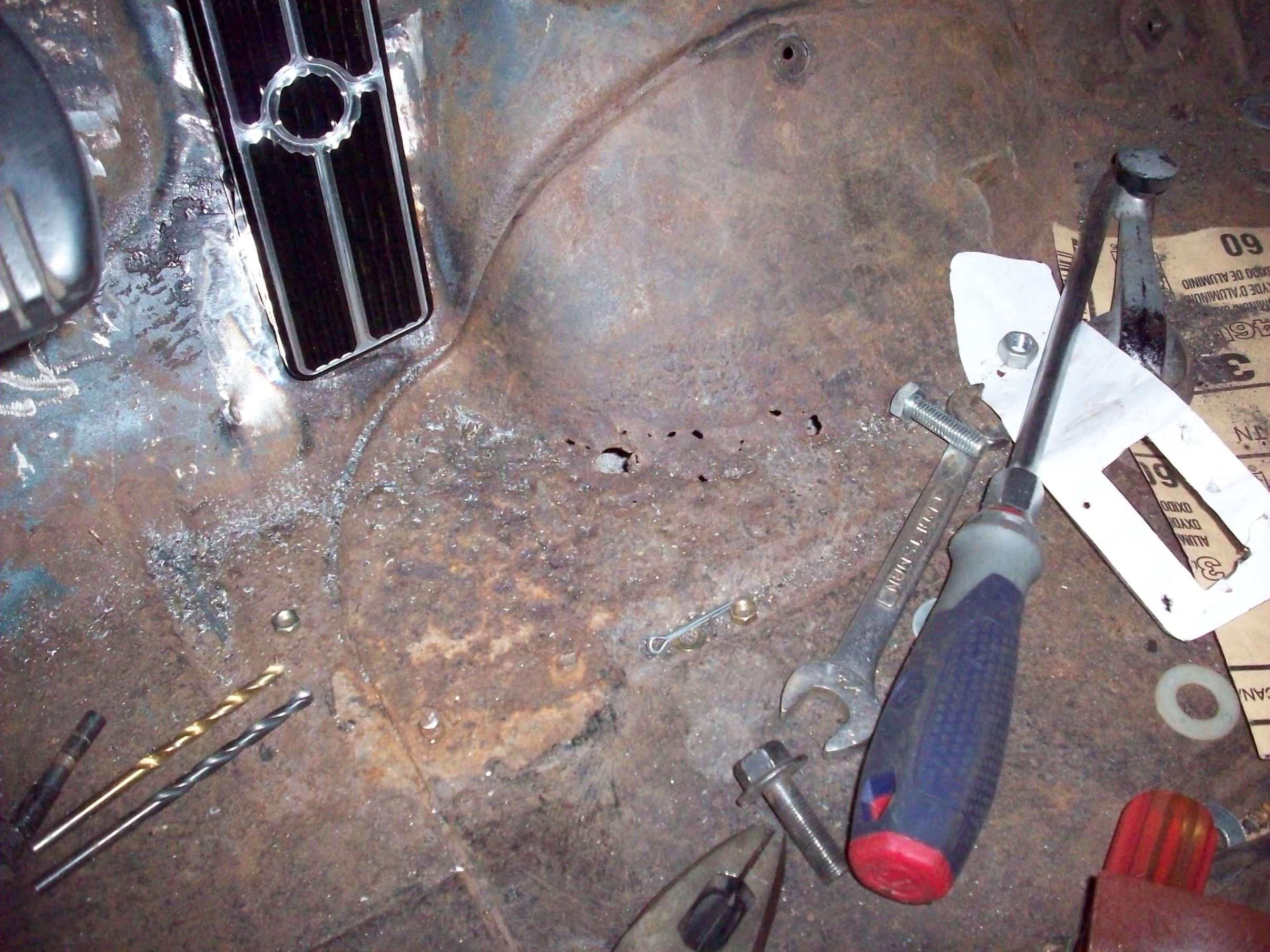

    Well I did a lot of cutting and welding to get this gas pedal in there. Took two hours to get everything positioned right too. I need to tighten down the bolts then I am going to hook up the rest of the throttle linkage and be done with it.. Overall I think it looks pretty nice. I am going to have to pull the engine sometime to plug all of the holes in the firewall and clean everything else up... eegad.
    Anyways, it was nice out today so I will follow up on this tomorrow and hopefully get it all taken care of. I am going to order a nice tv cable bracket for the ****** kickdown and then reposition a few things.

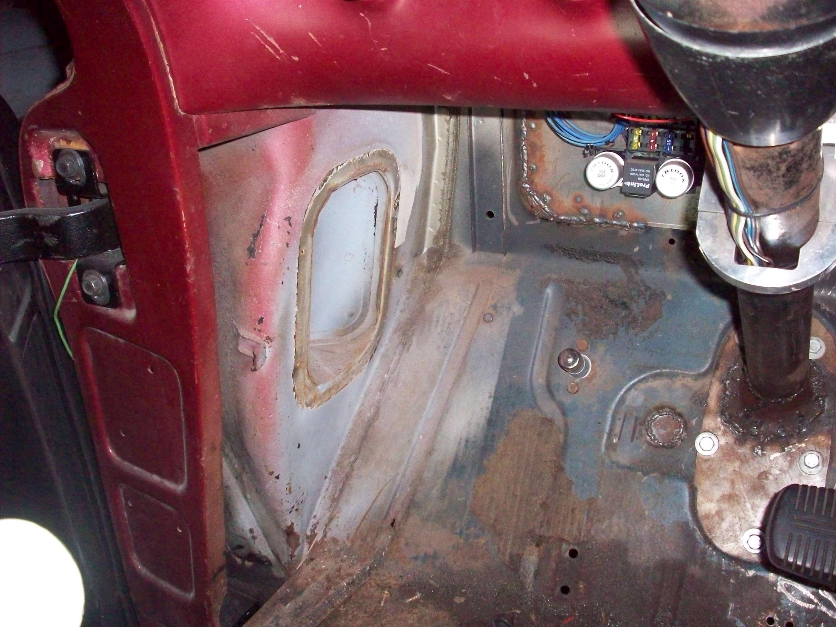

    Well I got the rest of the linkage mocked up (needs to be tightened down and I need two people or finally need to drill out the bolts for the ****** cover). please note the last picture of the nasty rot that the ****** cover has on it.... I will probably pull the ****** cover. I cleaned up the floor in the cab a bit by removing the vent door knob/choke cable on both sides and making a hole for my water temp gauge line that is under the dash. It was an easy day so far... I ordered my kickdown bracket and my battery hold downs then I will start cleaning up the engine compartment so its safe and decent looking.

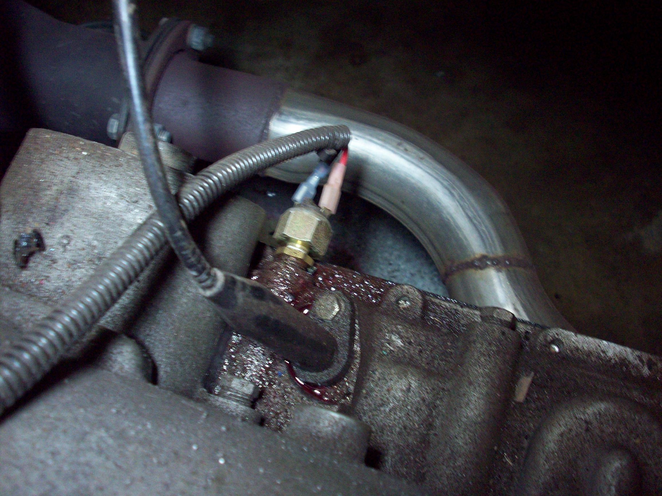

    1959apache
    put my new ****** kickdown bracket on and finally got to get that ****** cover off... I hate clutch head bolts.. a dremel tool, a hammer, and a flat screw driver is all you need! The rust isnt terrible, I will see If I should reuse this cover or just replace it (cant tell until I start seeing how thin the metal is. It's ungodly hot out this week, so I am trying to do little stuff so I don't die from heat exhaustion.. pics to come soon!

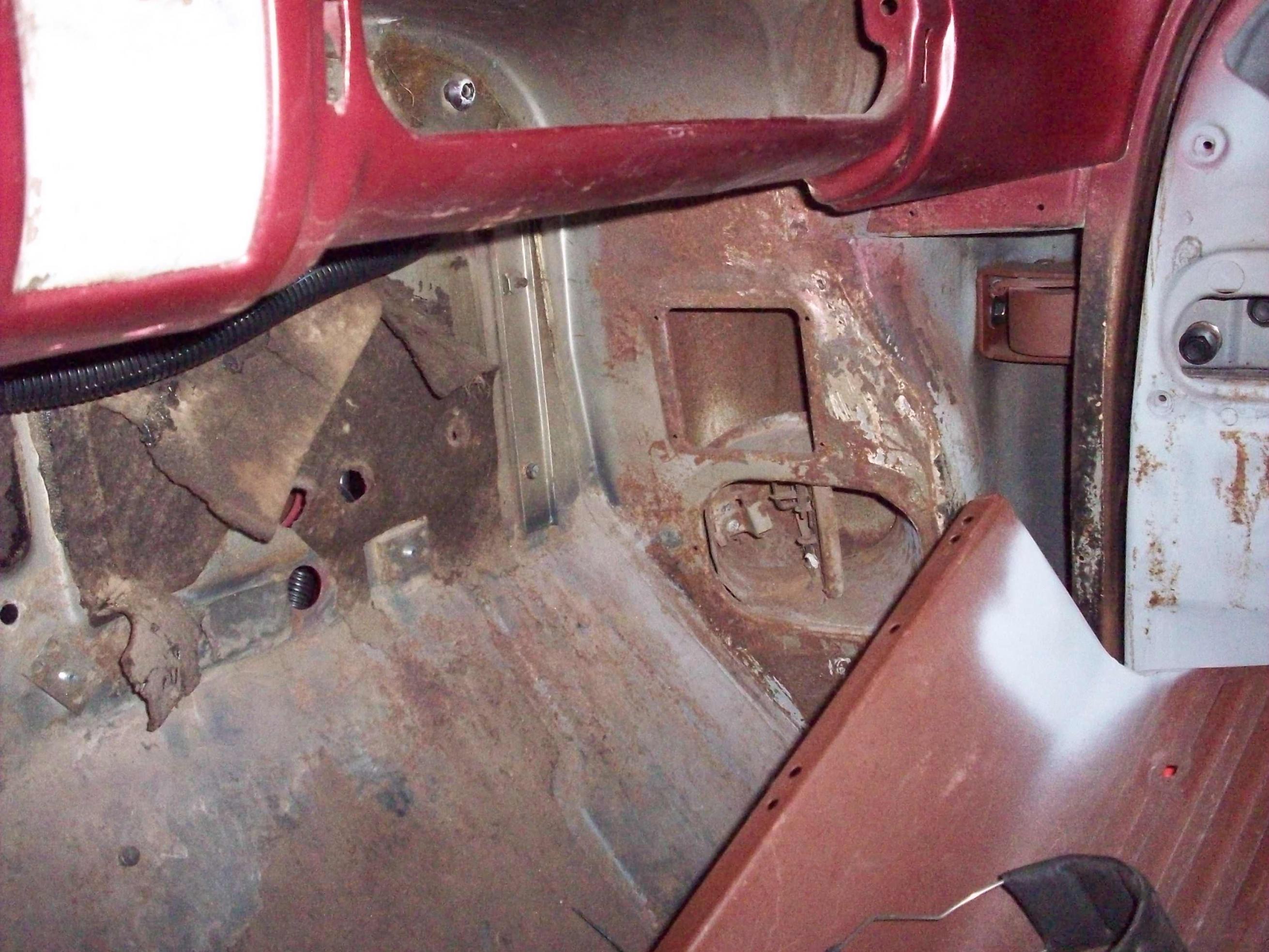

    Well I got the ****** cover off and cleaned up the old gasket material and I was certain that there was some significant rot underneath of all of that ****, but to my surprise it is clean as a whistle and just needed to be cleaned up!:) Pretty sweet! I am just going to buy a new ****** cover... the old one is too rotten and thin in most places that it would not be worth my while to repair it. One of the old gas pedal bolts was broken off so I will have to weld a nut to it and make it a bolt and back it out with a wrench (works every time).
    I also tried to clean up some other spots as well and some parts of the floor just have minor pitting not actual rot, so I am pleased. I got my new bracket set up for the ****** kickdown, but noticed a leak at the actual kick down insert, which concerns me with how much is actually leaking :(.... damn money pit;)

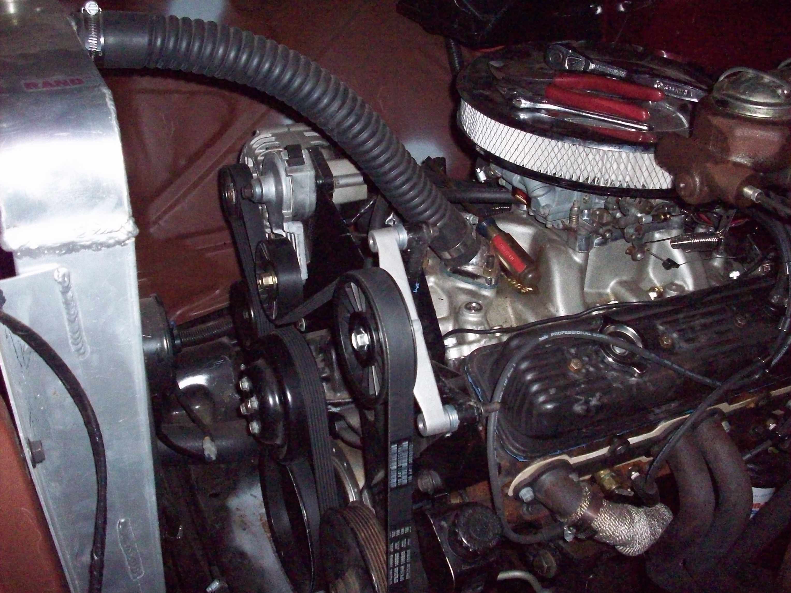

    Well not much got completed tonight, this ***** keeps fighting me every step of the way... First I can't find my drill bit that I dropped then it went downhill from there. I did, however, get the carb setup taken off, the original dual feed line on there and am in the process of removing the fuel pump and adding the block off plate and a few other things to the mix. :D I have yet to mount the fuel pump and get those lines taken care of, but will get to that soon. I am just ready to simplify everything here so it looks decent and is functional instead of a spider web of ****. More pictures to come..
    still waiting on my shim set..... but the pulley is on there...

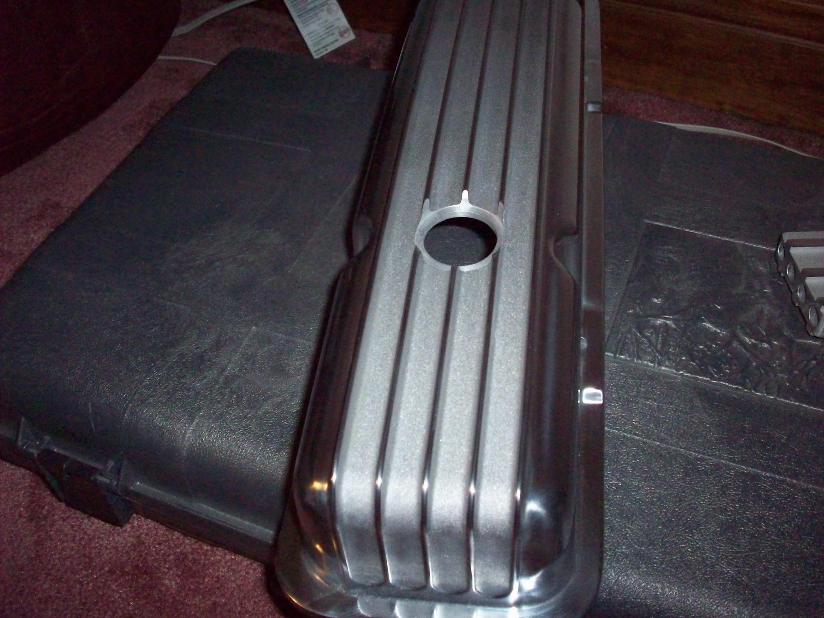

    Well I got my new toys today :D
    I am surprised that they were undamaged.. the packing job that this guy does on evilbay absolutely ****s balls. I am missing some hardware though, so I will be calling him again here tomorrow to get that straightened out.

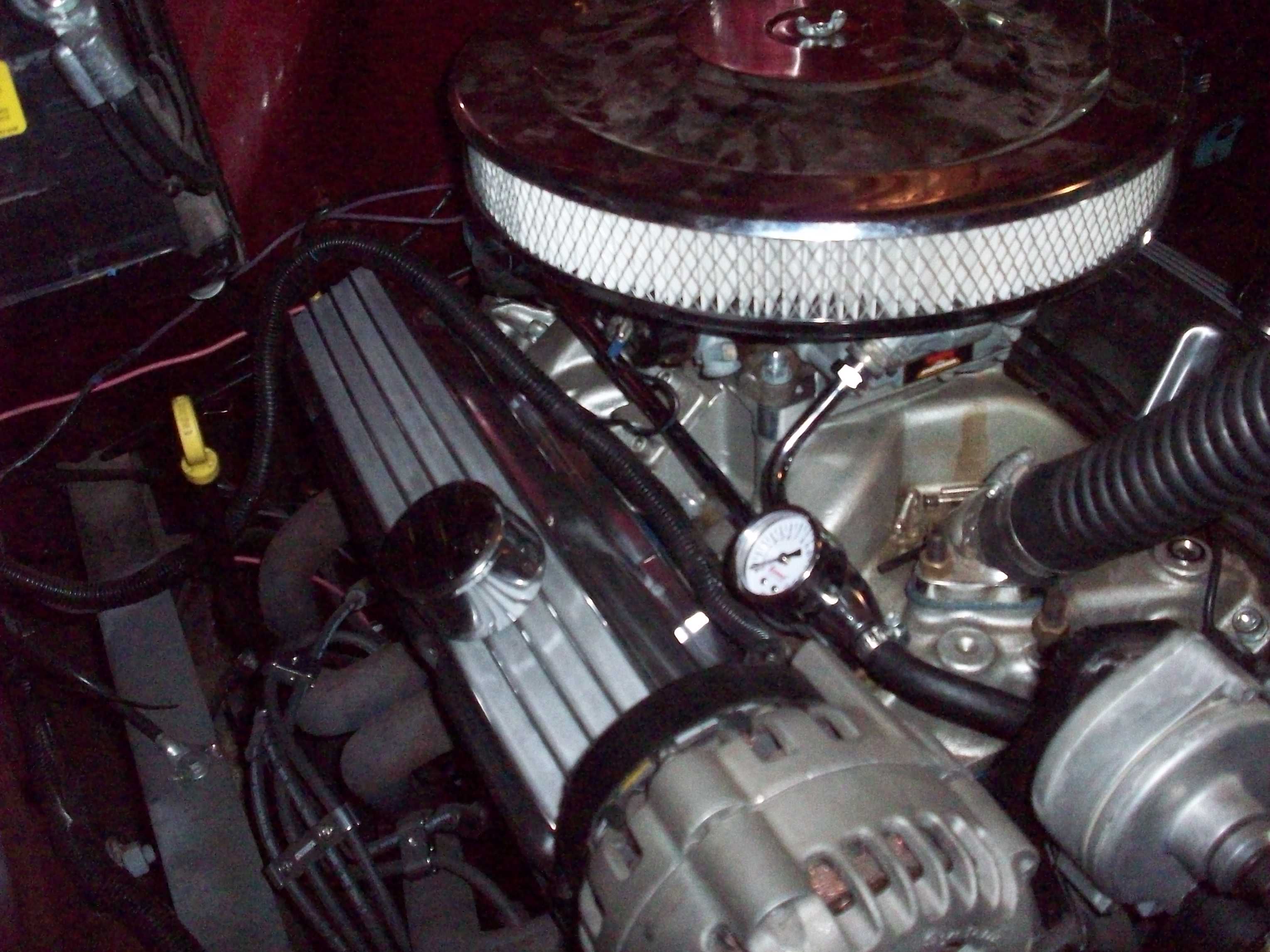

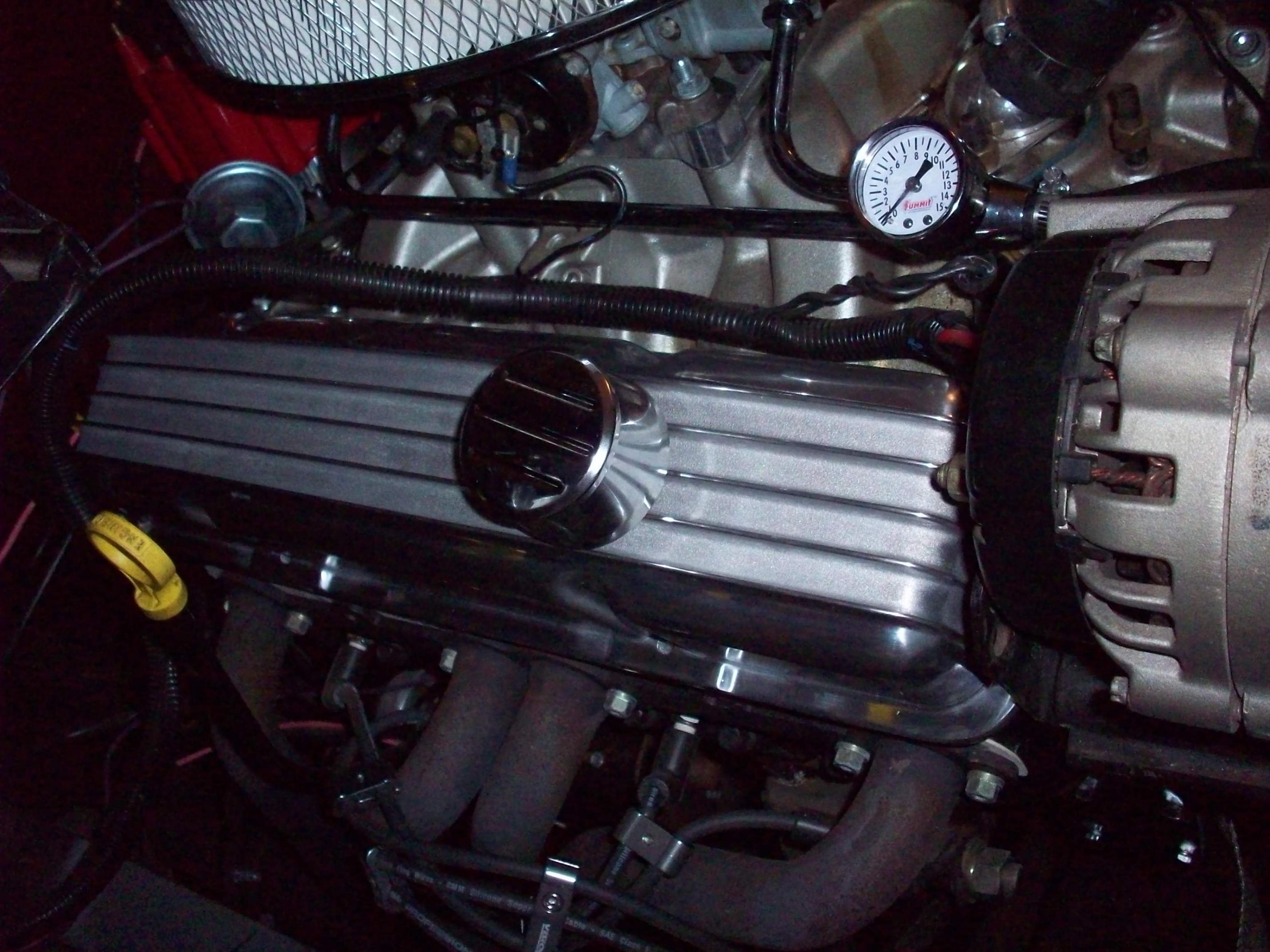

    I will have to do some research on breathers (what design I like) and I will also have to pick up a pair of cork gaskets for these covers. I really like those wire looms too. Now I am going to have to get rid of that tacky looking air cleaner and get some decent looking chrome headers on it and the engine bay will be pretty much done.
    I also removed the fuel pump tonight and am prepping to get the block off plate on and the front hoses run a little better. After that all I have to do is make a plate for the fuel pump and run the power wire to it and she will be done fuel system wise:cool:
    I am also going to work on the ****** cooler lines after this set up is finished just so It simplifies everything and makes everything a lot nicer/easier to work on. :D
    Overall, not much got completed tonight, but for 1 hour out in the garage I guess that is plenty.
