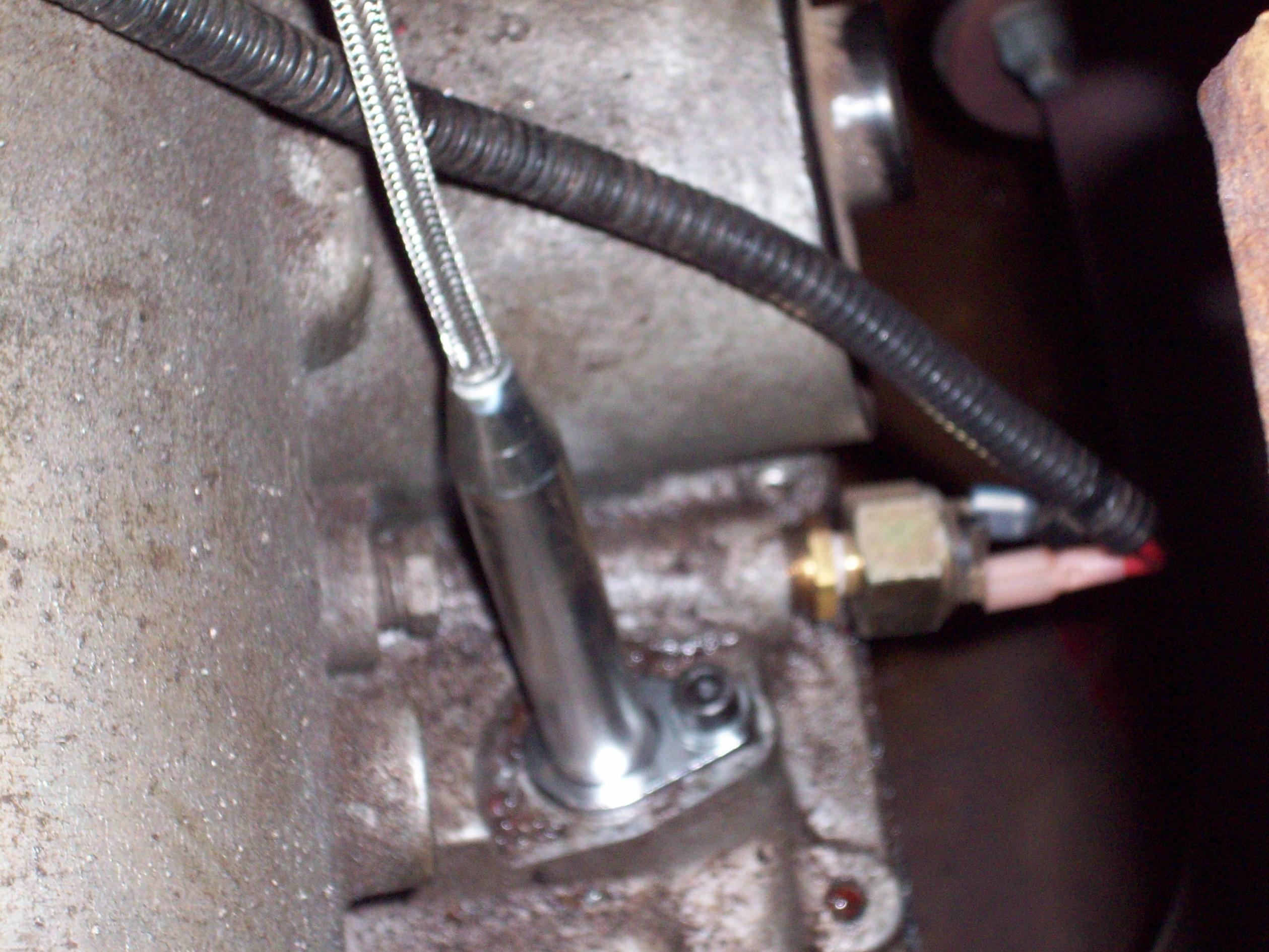

    Lokar makes a flexible dipstick for your trans. By the time you're done spending the money on it you'll be ahead of modifying the firewall. My trans. dipstick has the firewall mount attachment but it is mounted to a bracket that comes off the engine block. ( Its a Lokar knockoff from the swapmeet, but it works. It cost 30 bucks. )

    Thank you very much! That is great:D I will be buying one then! Thanks for the great info

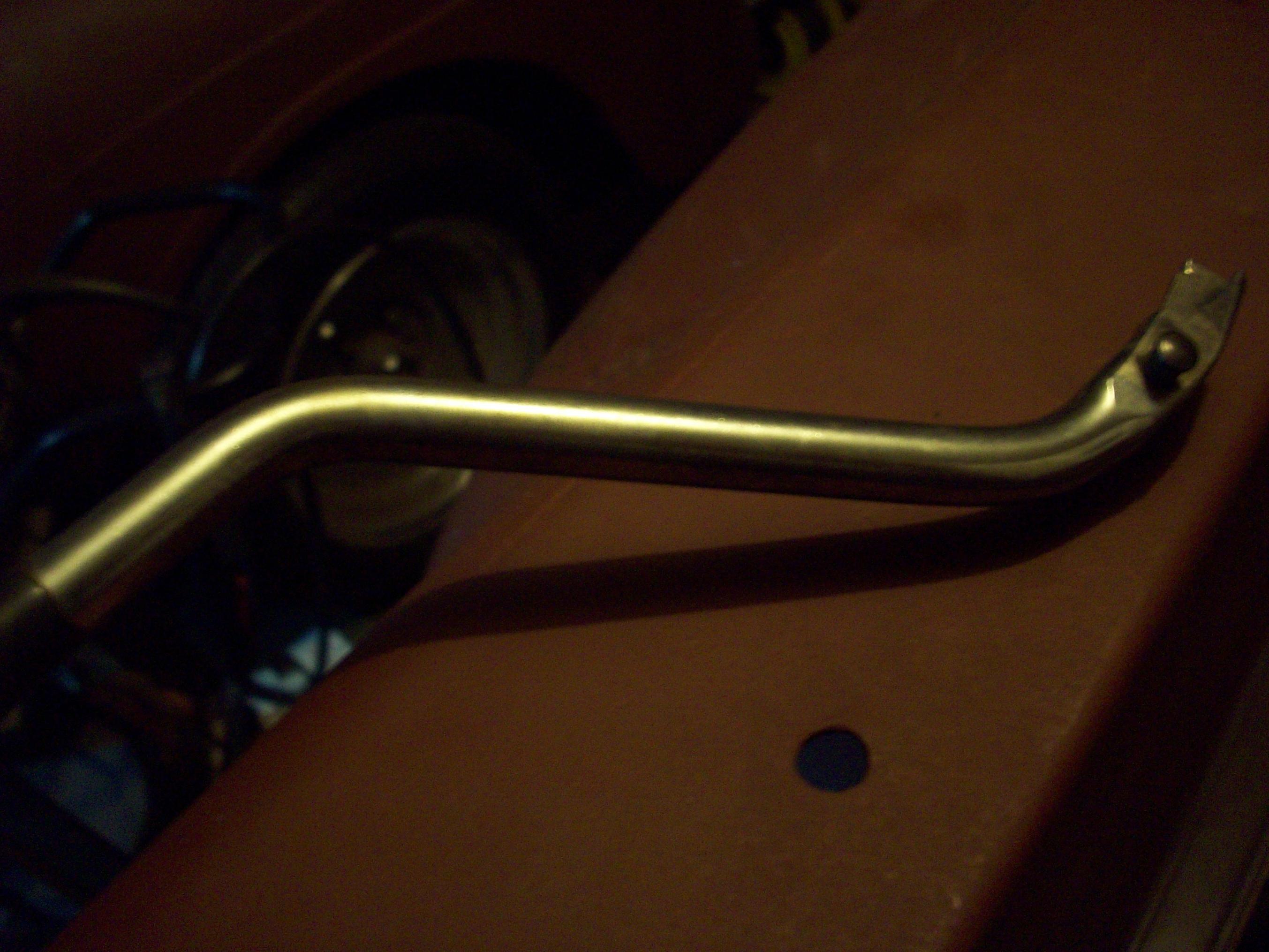

    Well not much got completed tonight, this b*tch was fighting me the entire night no matter what I did. So I removed and installed the new flex ****** dipstick tube (what a mess). Installed my breathers and my pcv line to the carb. Removed all of the old fuel line, installed the new fuel line, got everything hooked up. The only thing I need to do at this time is to go through and replace the inline fuel filter before the fuel pump and install my line clamps with rubber coating to secure the line to the frame. Then I will tackle this dipstick tube and try to get it so it will mount on the firewall. Then move to the ****** kickdown cable installation.. whew... what a pain

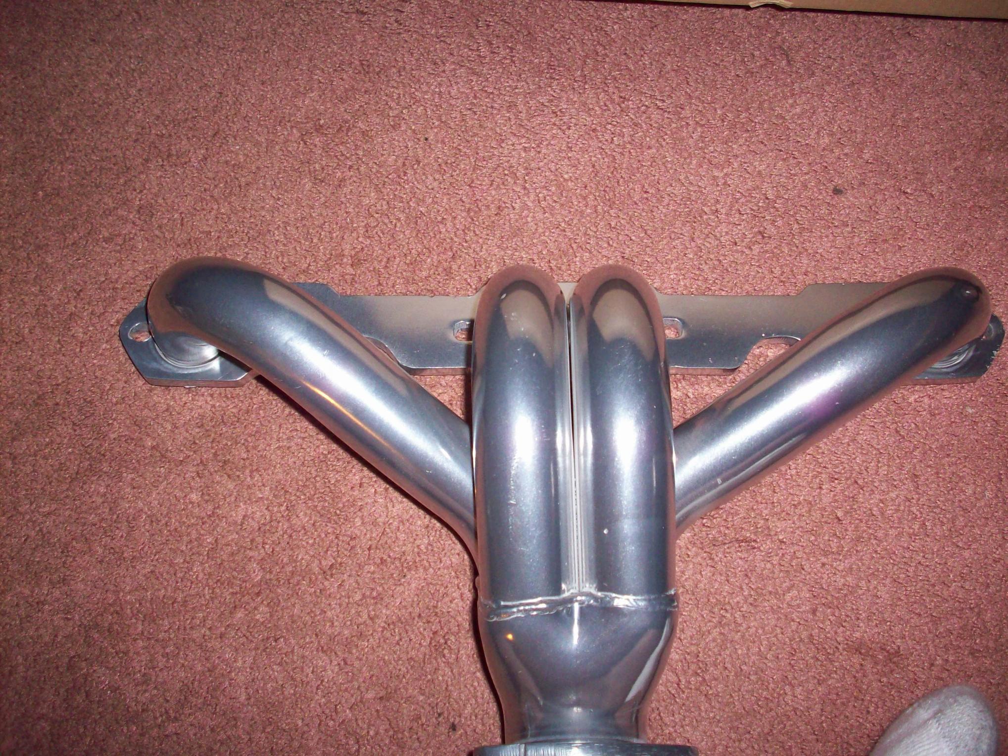

    Well my wrist is better, but progress is slow so I dont hurt myself again. I ordered a set of block hugger headers from evilbay and they are knock-offs that someone just rattle canned it looks like on their back porch and they were trying to sell them as "new"... needless to say it has been a fiasco, but good thing for buyer protection against FAKE items. :D I will never do that again.... Do not trust free shipping at all.......

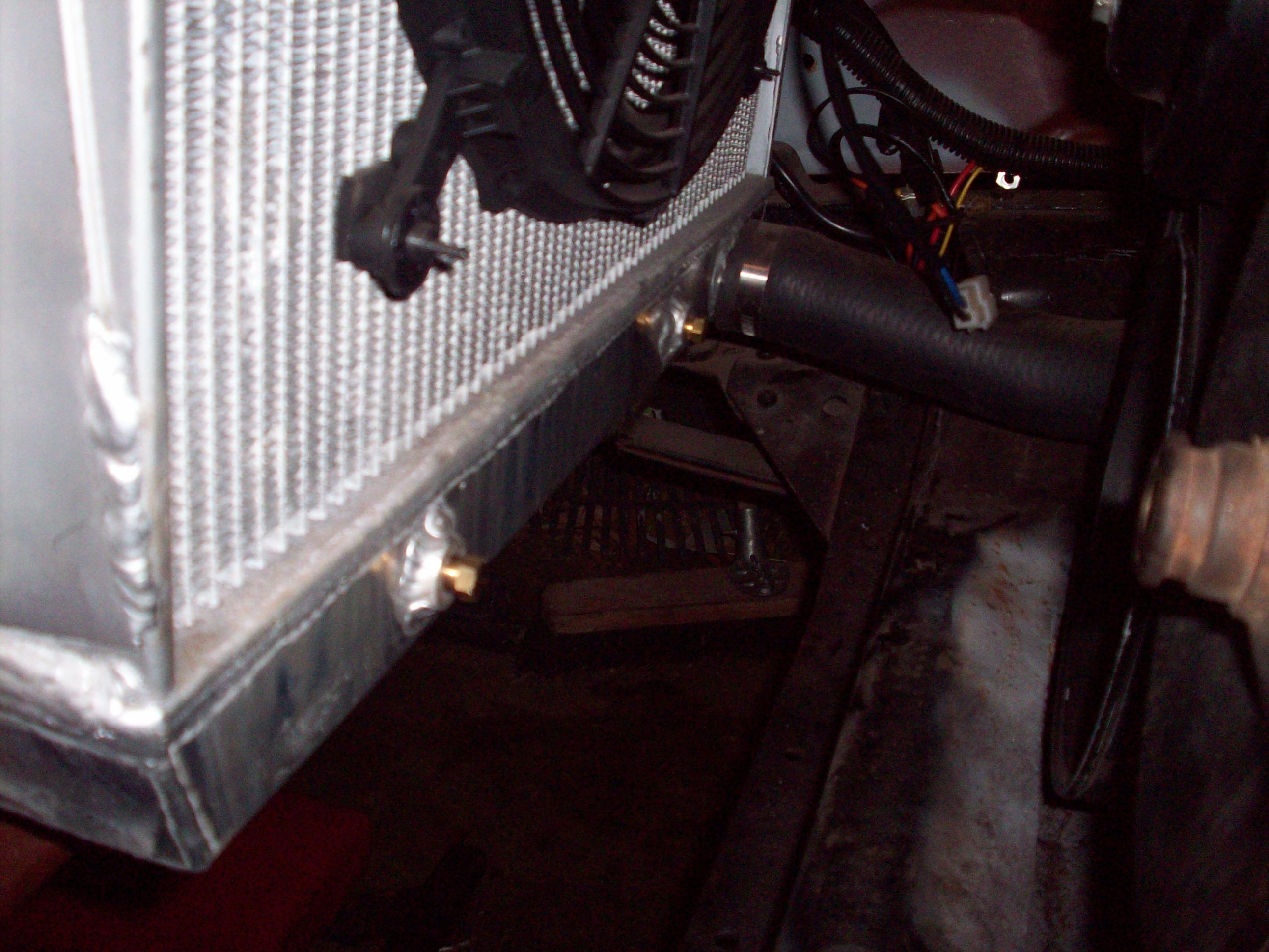

    Anyway, I got some plugs for the radiator... I am going to install a frame mounted cylindrical ****** cooler and just run the lines straight over (it will make it look very clean and will reduce how much line I need to use since the bends would require a lot of guess work and a lot of time to get them looking nice and in the correct position.
    The pics below are of the bolted on ****** cover to get it out of the way and so I don't drop any more **** down on top of the ****** (tools). and a pic of the plugs... not much of anything to post, but I am doing a lot of cleanup **** to make it look nicer and be a lot more functional with less failure points. I am then going to move some wiring or at least bundle it together so its not so embarr***ing to look at.

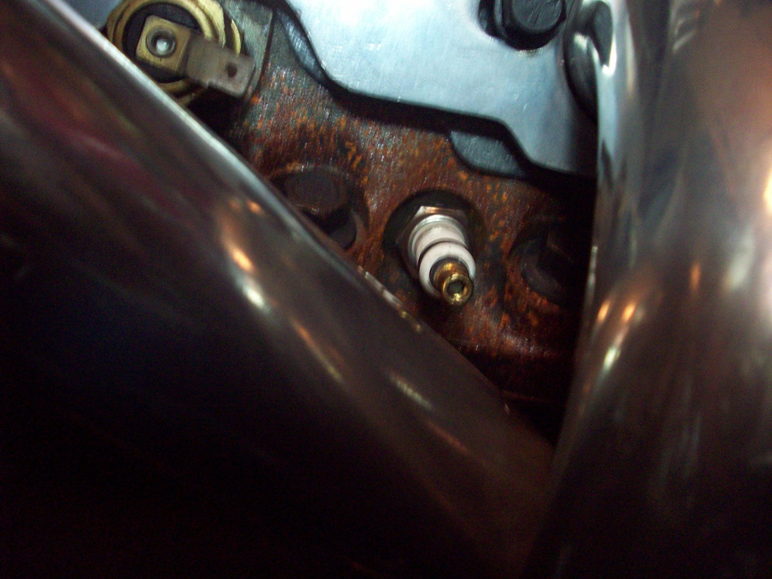

    Well I found a couple access issues with putting these block huggers on.... First the motor mount bolt (saw zawed like 1/4 of an inch) and now the header fits perfectly... its not worth me paying 8 bucks for a new bolt just to have it look pretty. I am also going to have to extend the steering shaft on the column about one inch to clear the headers, no biggie, cut in one place and add in another... I also decided to install the coolant overflow tank (I think it looks decent). I also found that the oil dipstick is going to get in the way so I am going to have to figure something out about that. Anyway, tomorrow I will install the ****** cooler and work on the steering column. I will have to pick up some angled spark plugs to clear the inner two pipes so my plug wires dont touch the headers. :cool:

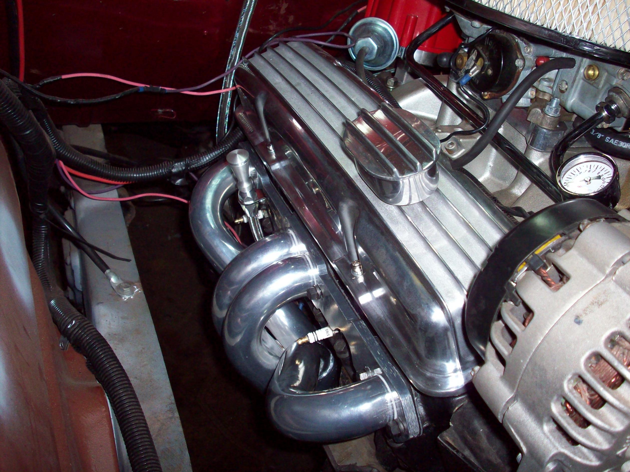

    Well that took forever.... The right bank of headers were on and off six times, I had to use the dremel tool to fix a couple of the holes and once that was done I had to install my flex oil dipstick, which fits nicely. Next on the list will be mounting the ****** cooler to the frame and then mounting lines to everything and finally securing all of the hardware down on the headers. My Dad made a good point that if the engine moves a little the steering column will bump my headers. Since he is the guru he pointed out a couple things just by looking at some pictures I send him every time I post here. I will share that later... enjoy.

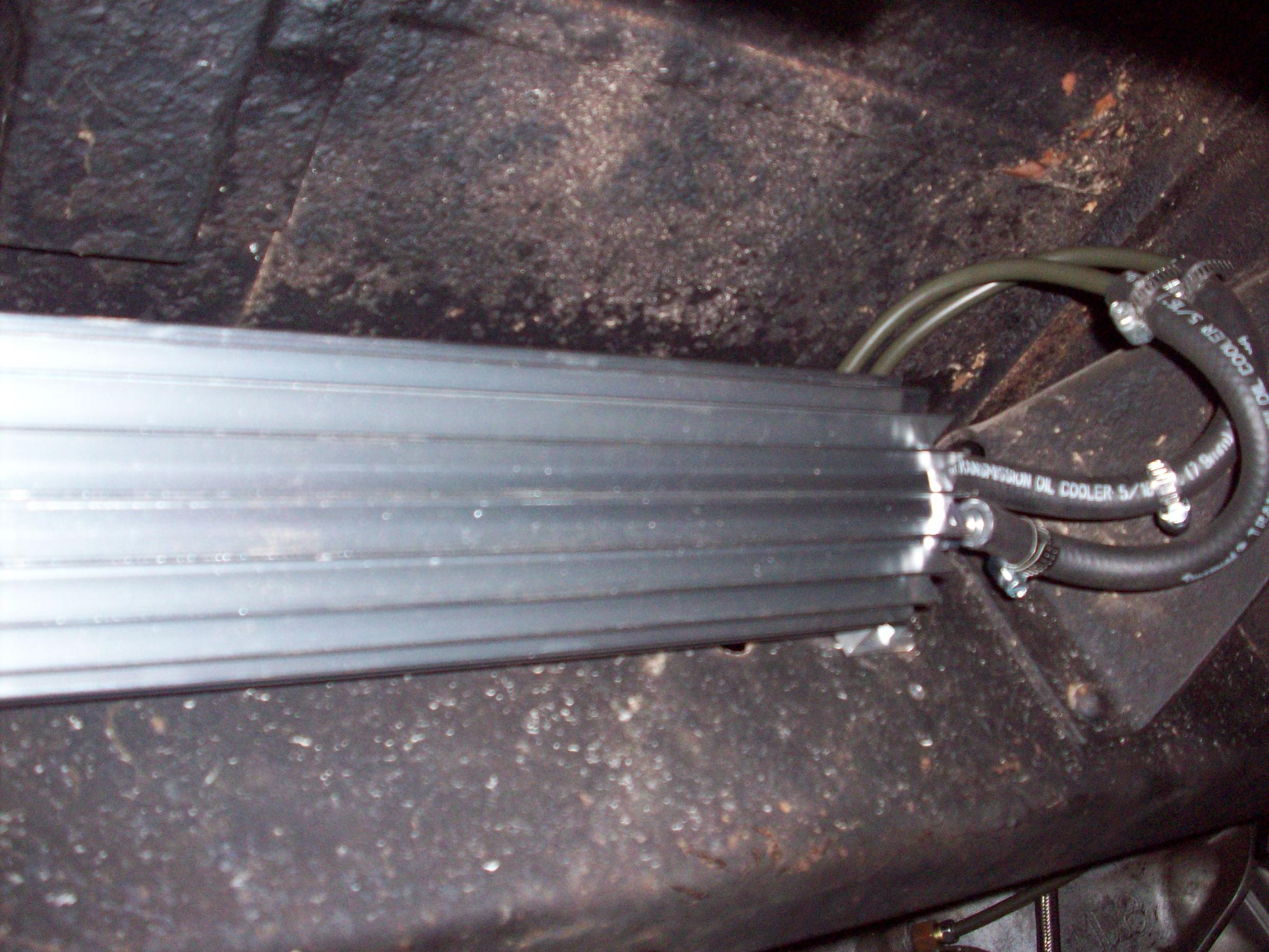

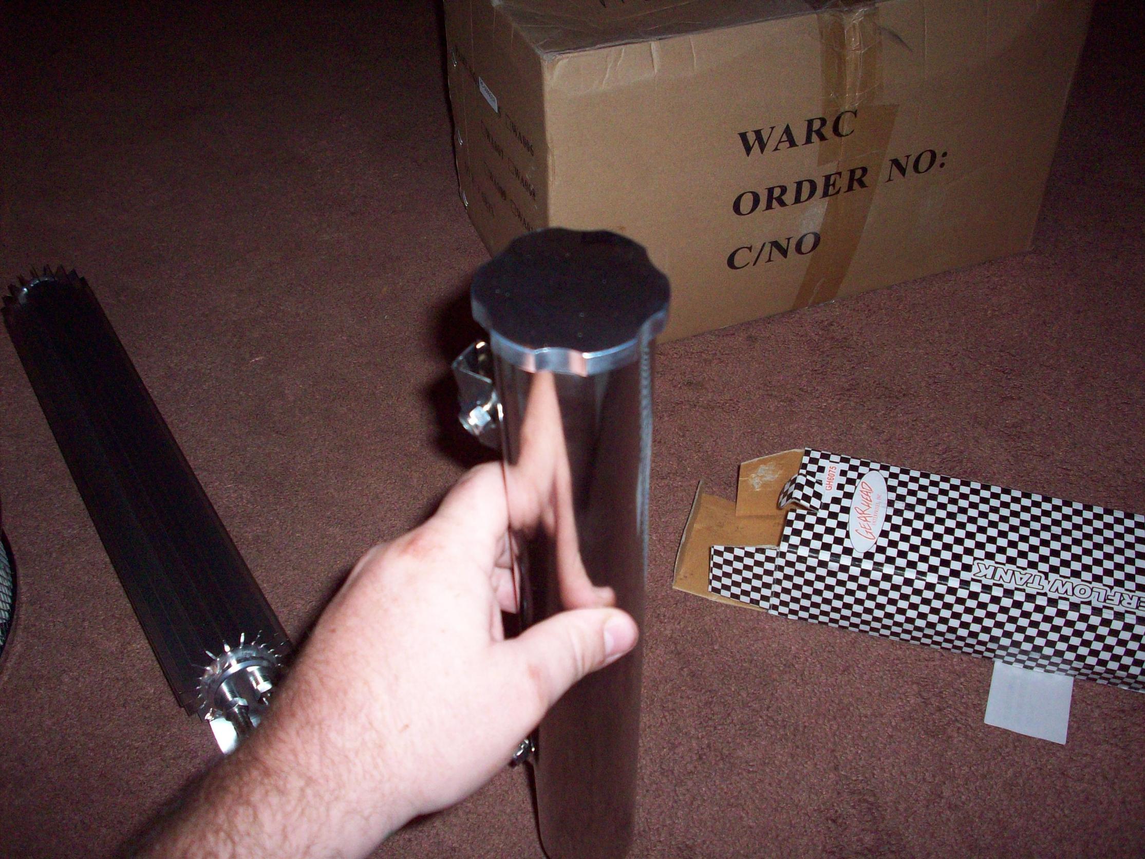

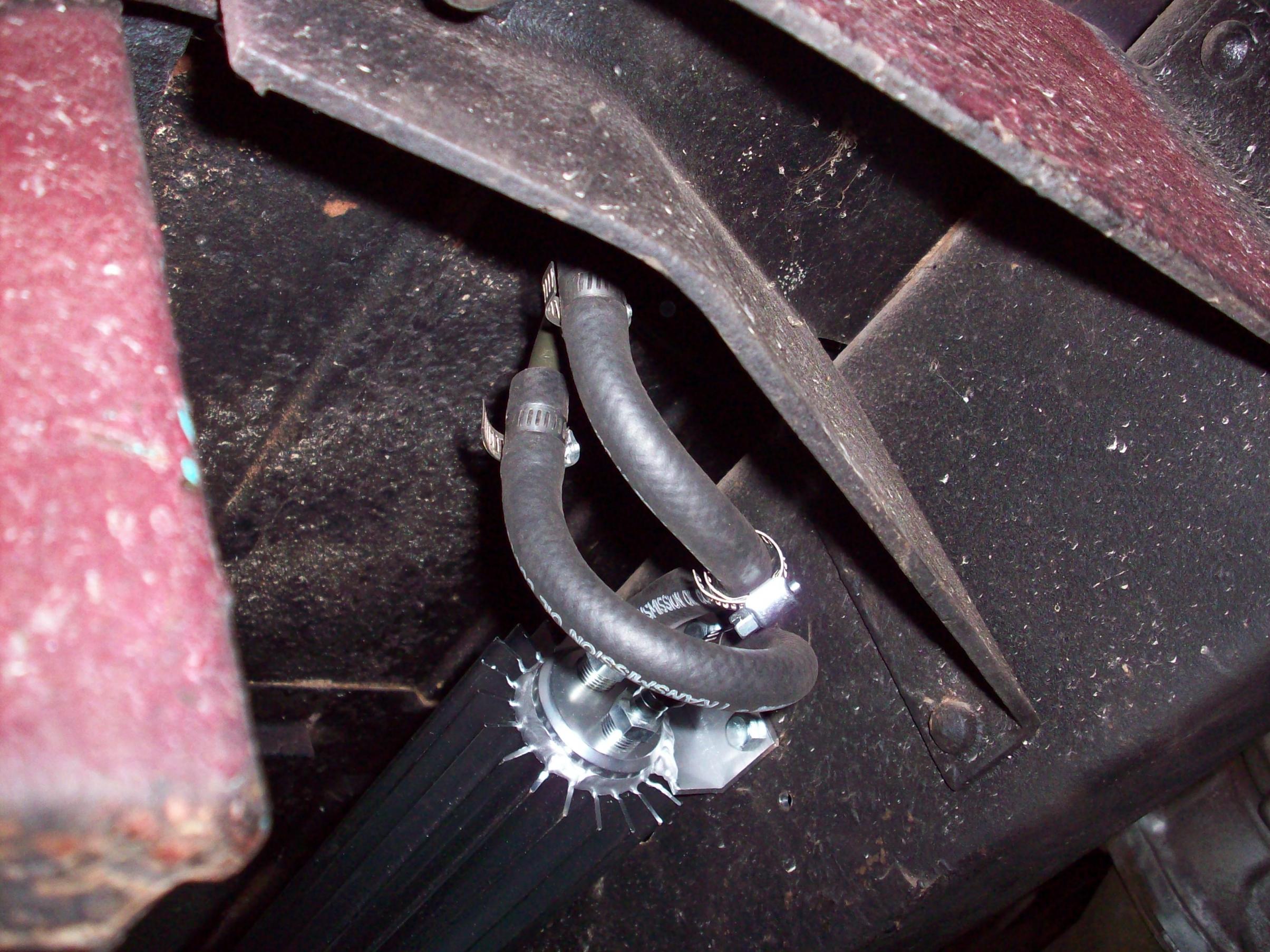

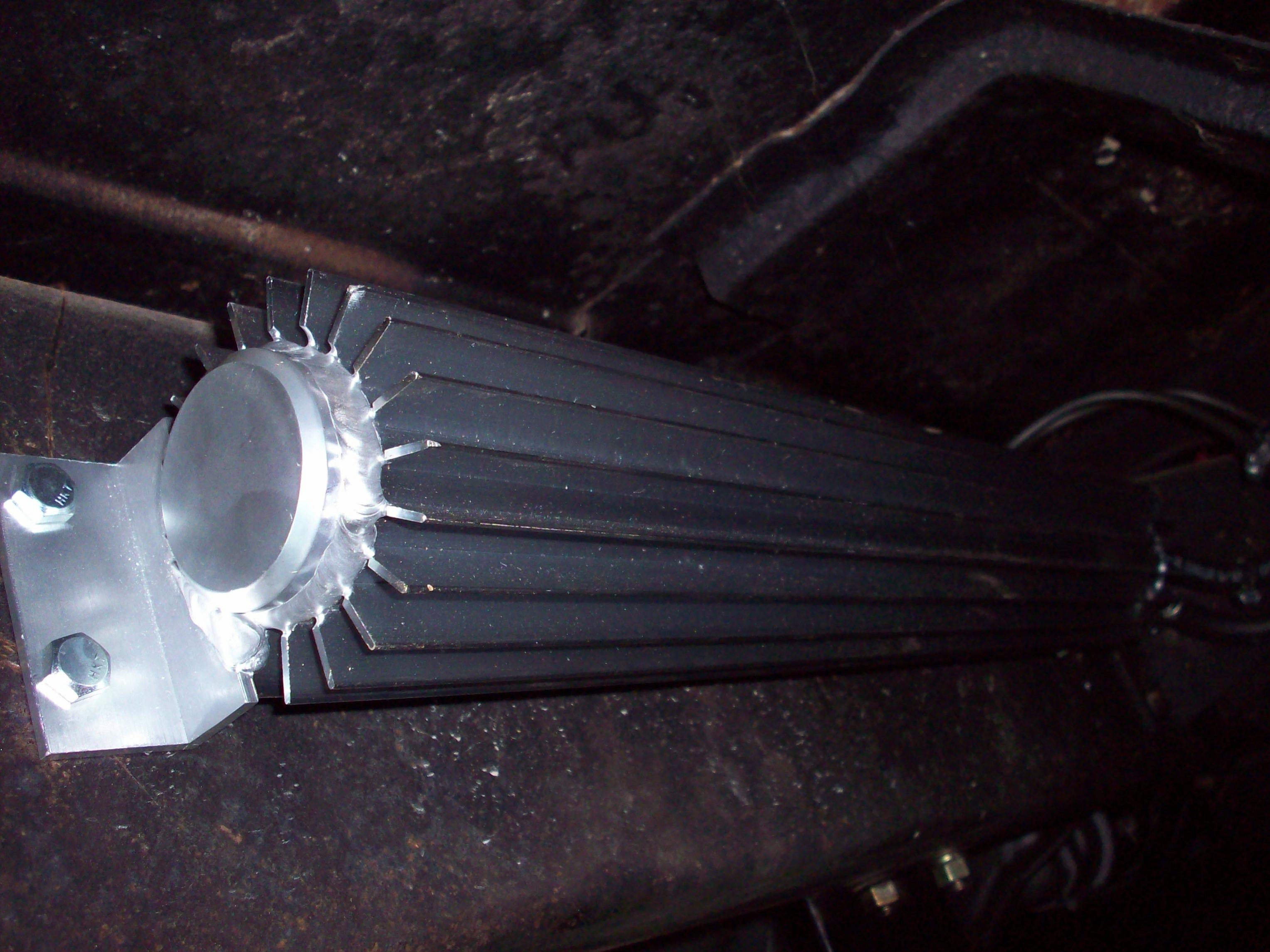

    Well I finally got the ****** cooler mounted to the frame rail. I am going to work on cleaning things up and making everything so that I don't have to worry about it later down the road. :p Here are the first batch of pics

    Here are the second batch of pictures... you can see what I mean when I say "I am going to clean things up..." There is a lot of **** that could be made far nicer. I am thinking of getting rid of that hide-away tube and just electrical taping everything. Some of it is melted because of the heat in the engine compartment, which hopefully with the new ceramic coated headers is significantly reduced.
    So now that I have a bunch of the **** installed from the second swap meet I need to buckle down and make sure everything is installed correctly, which means I need to run through EVERYTHING and plumbers tape and tighten down everything.... I am going to, after all of this, pull the column and slap the end of the steering shaft off and extend it an inch or two for clearance issues.

    I am going to be getting some angled plugs to work with my headers and will be finishing the install on all the parts this weekend after I feel better. I have been sick the last couple of days... I want to get this puppy fired up :D
