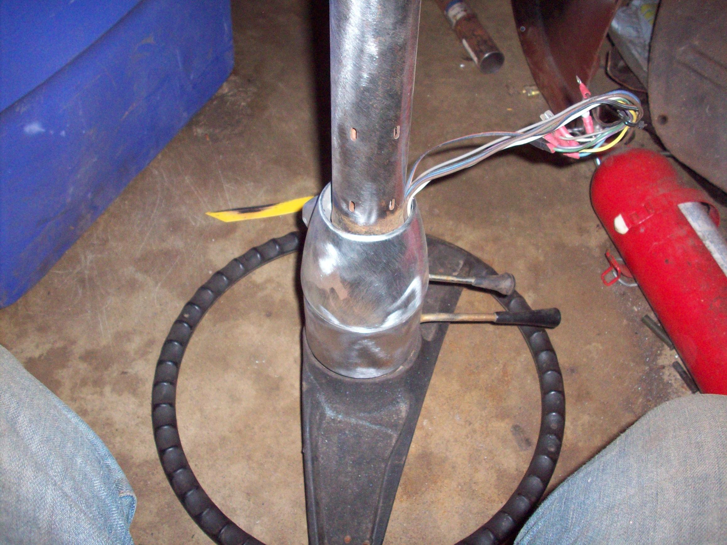

    and of the column getting stripped down. In order to do extend the column I had to remove and install the column multiple times... a lot of work..

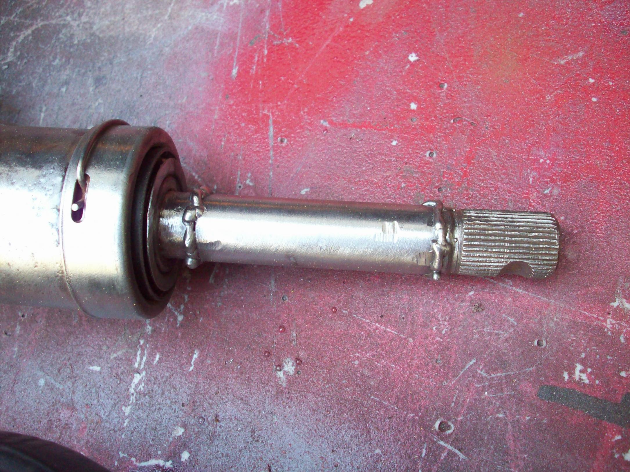

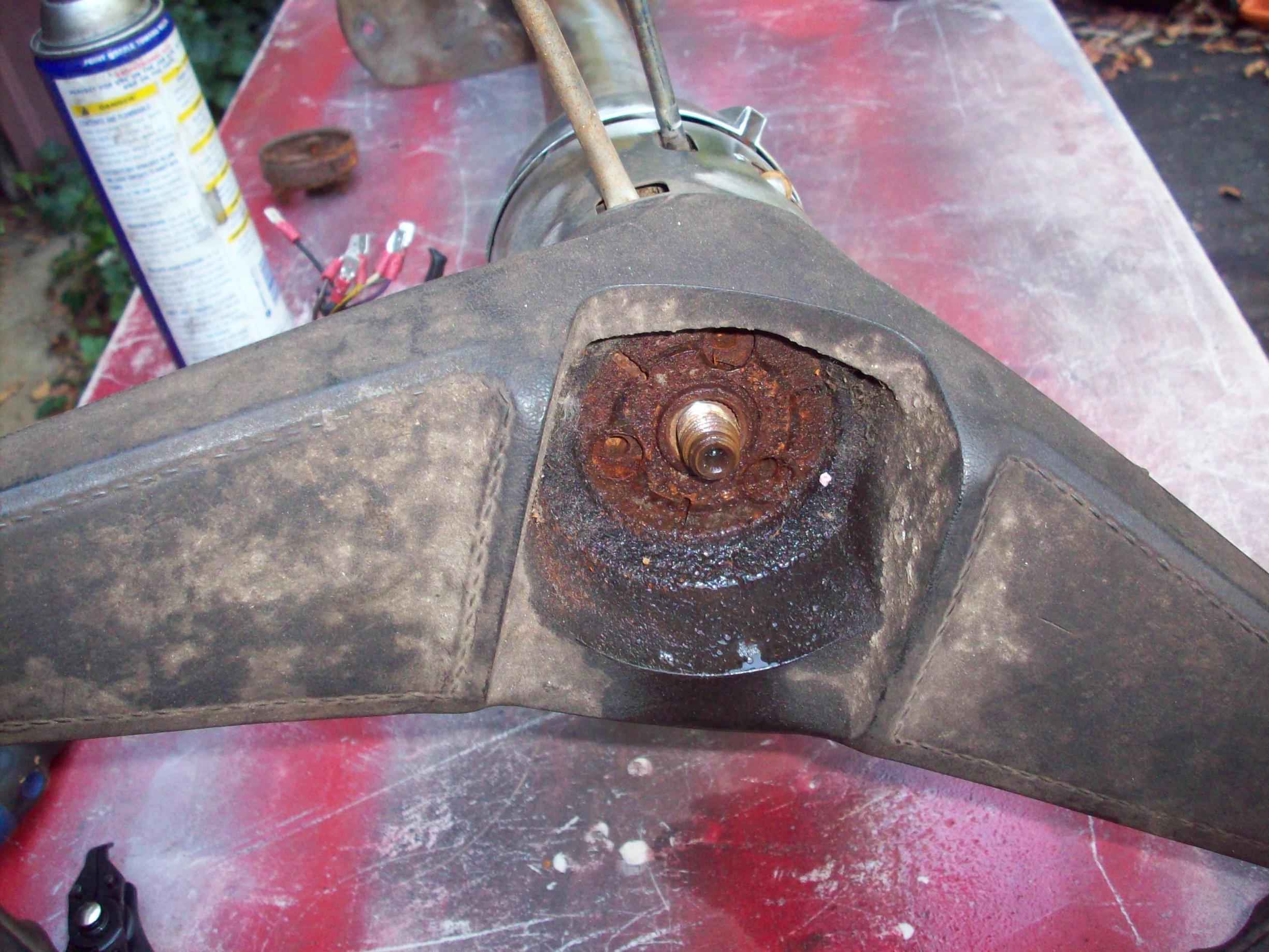

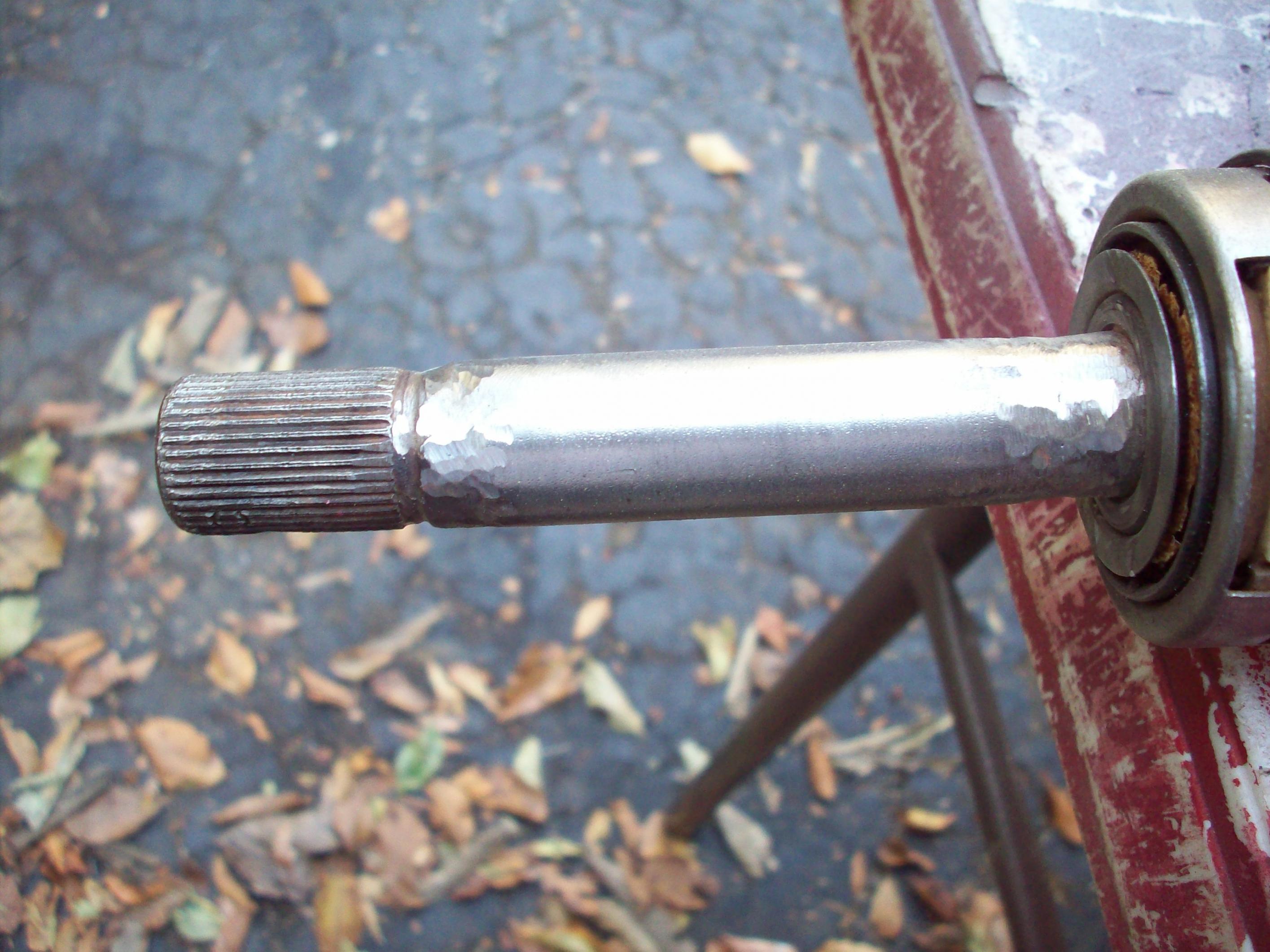

    So I decided to continue with the steering column and get it looking decent before repainting it. Here are some pictures of me stripping the rest of it down and grinding before the final weld bead :D

    here are some more pictures.

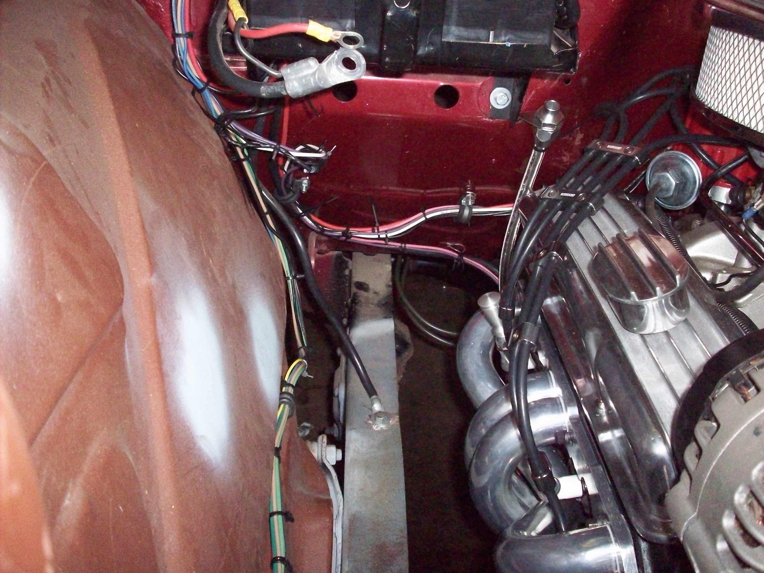

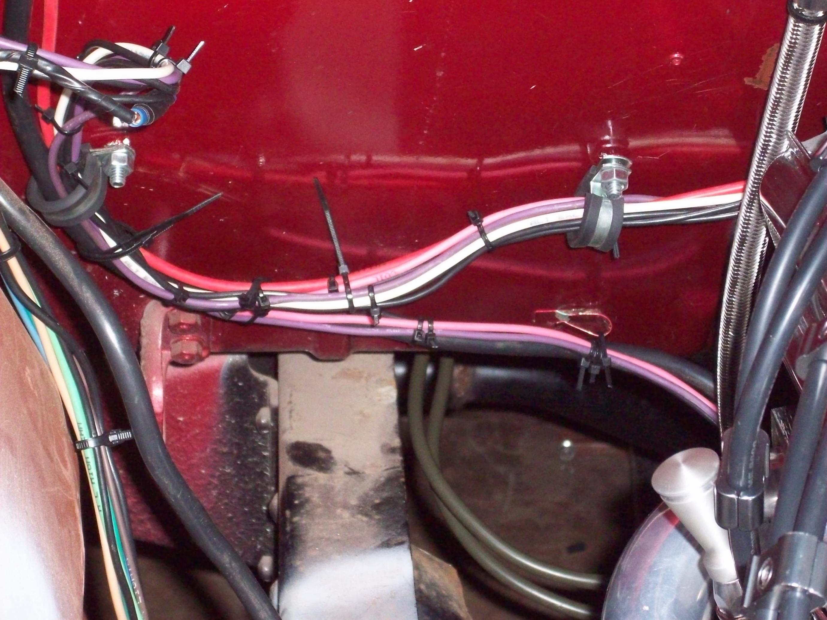

    Here are some pictures of me cleaning up the wiring to make everything a lot more safe. I went zip tie crazy!!! It is looking a lot better though.

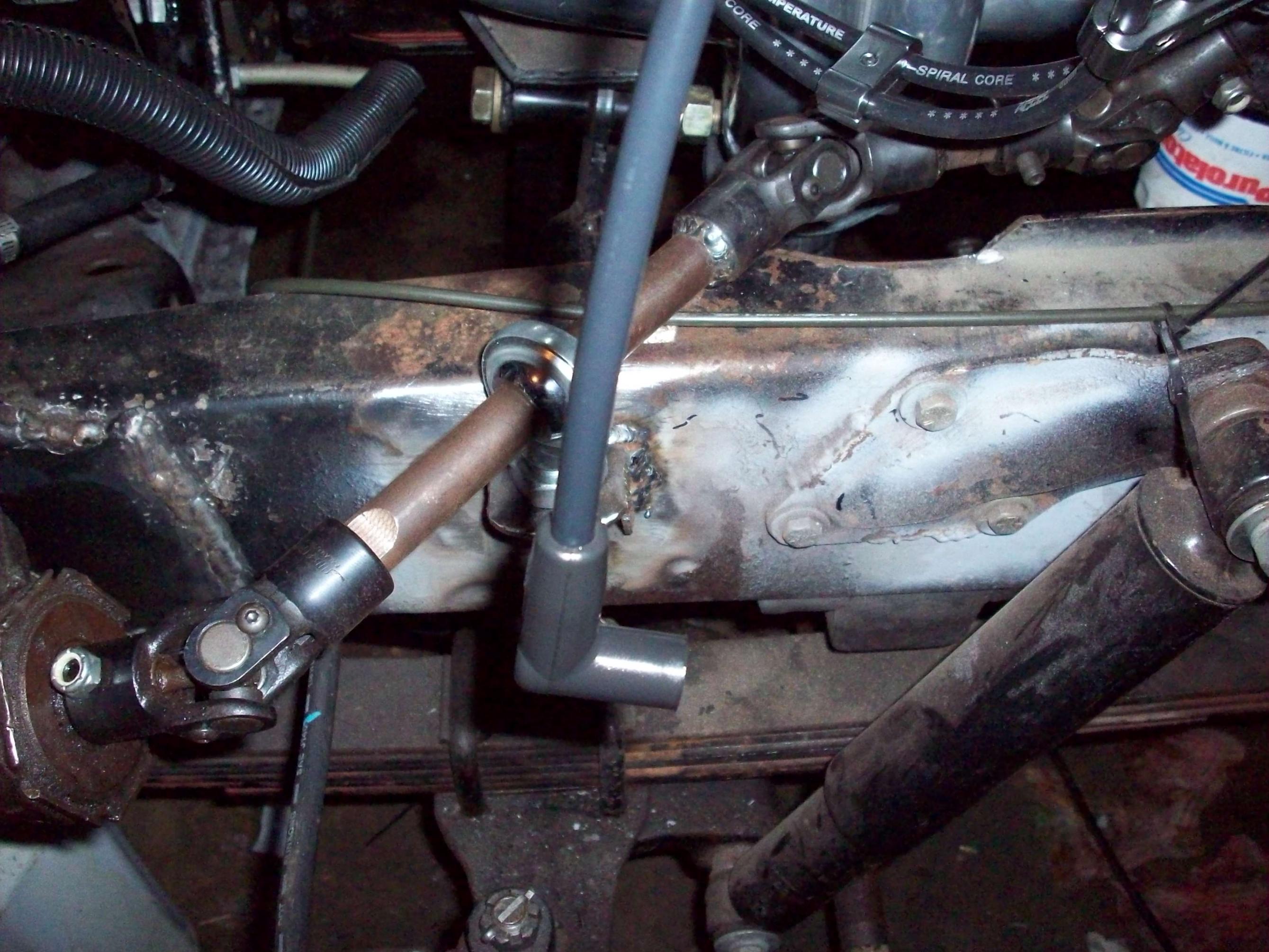

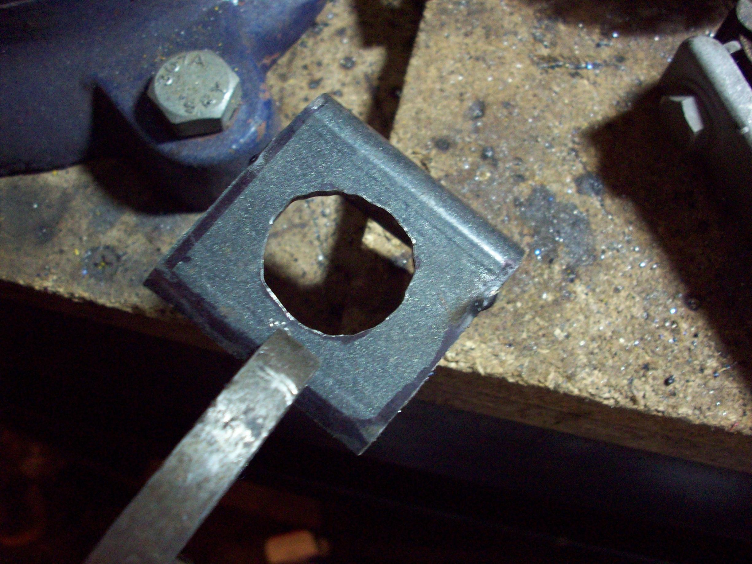

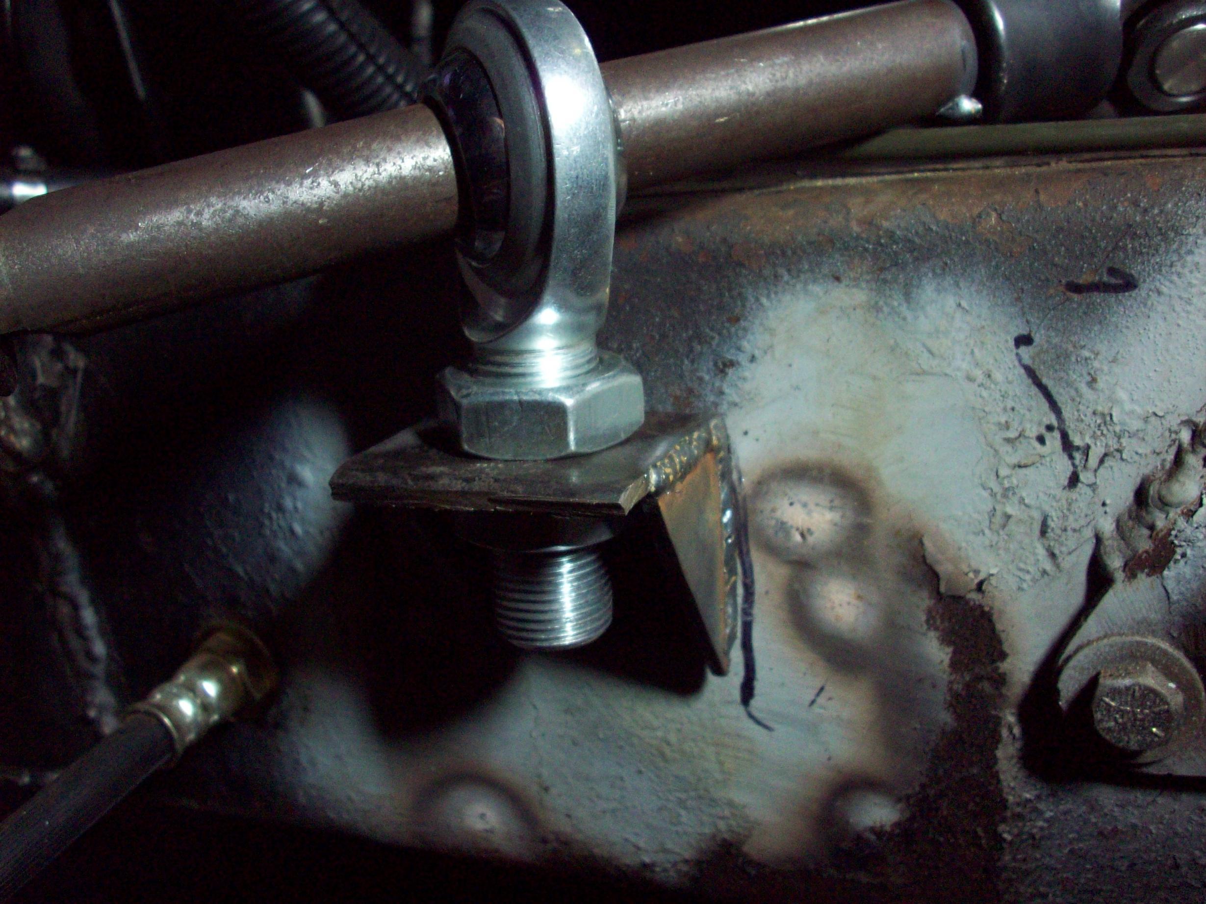

    Here is a picture of my new ceramic plug wires. Also, my bracket to stabilize my steering shaft. I will weld it to the frame and that portion of the project will be complete. Then to fix the other header since the plug is so far off and the boot wont fit over the plug. I will then go ahead and hook up the exhaust again. Then fire this thing up.

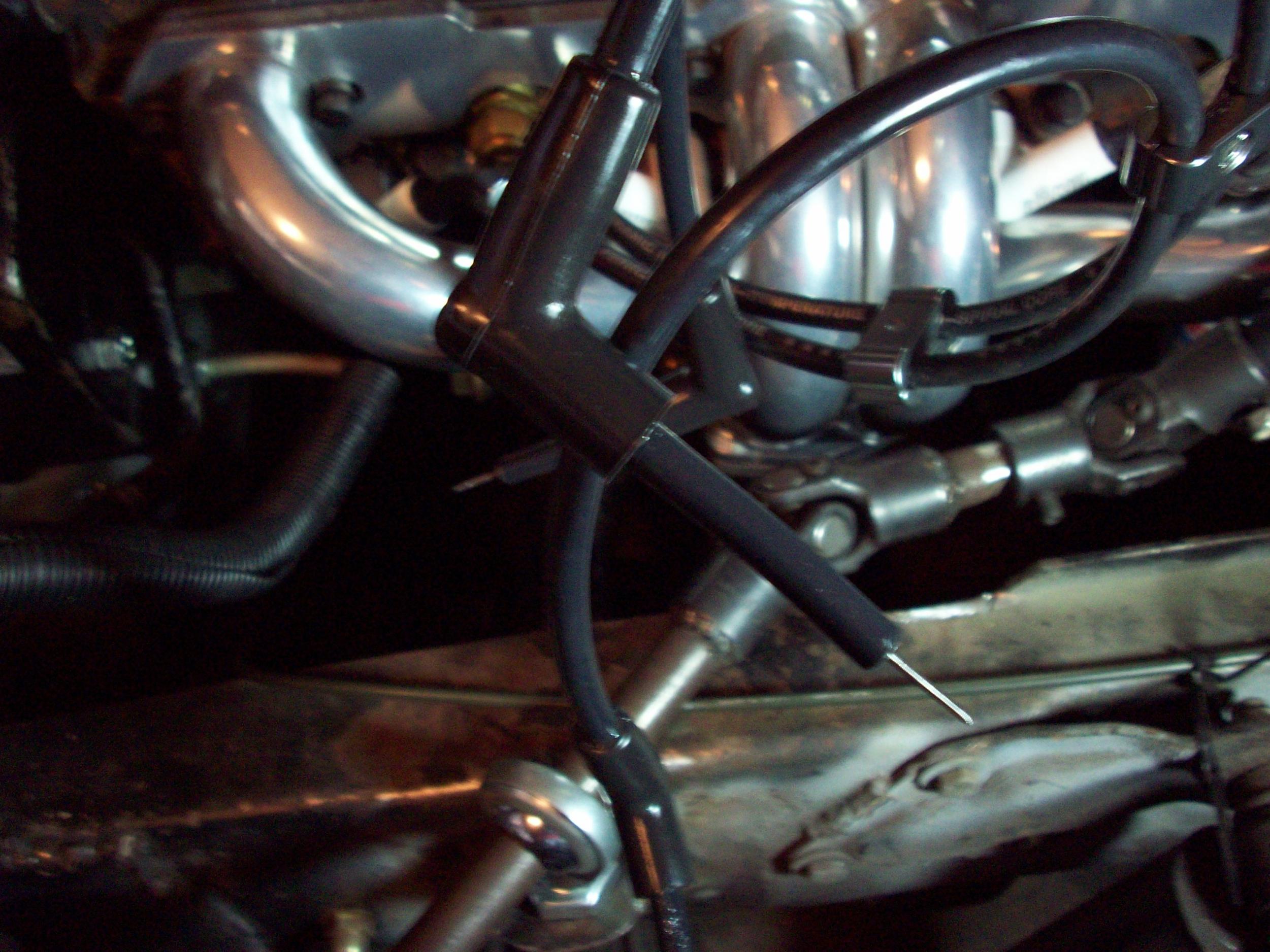

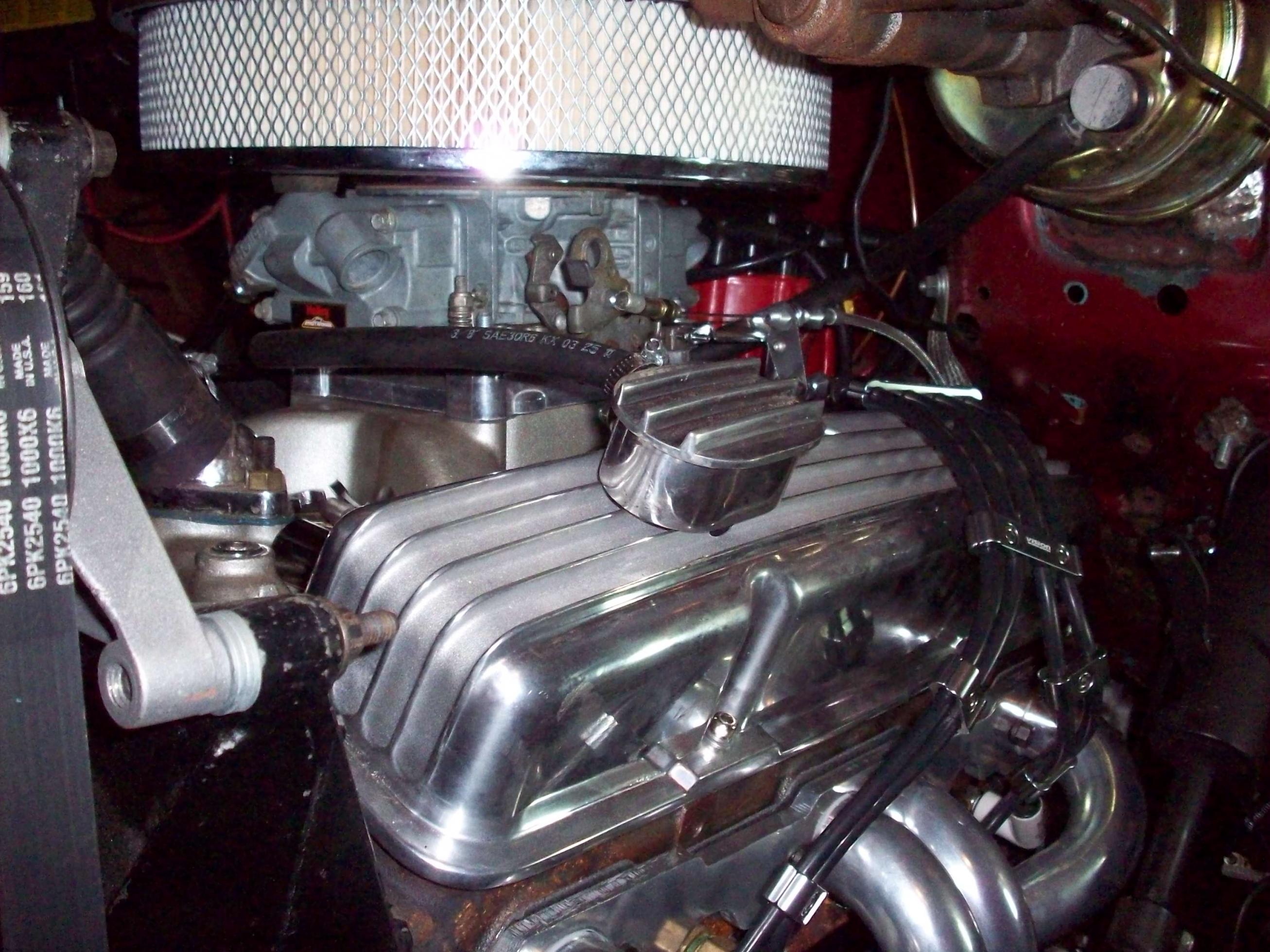

    Not much got accomplished today except taking the p***enger side header off six times to try and fit my new ceramic plugs. I got it close enough for the new ceramic boot to click to the plug, but am concerned if it has room enough to stay in one piece.. as in the header heats up and cracks the ceramic plug boot. I also didn't like the wires all over the place so I went through and put my wire seperators on, I will have to cut them to length soon and be done with them.

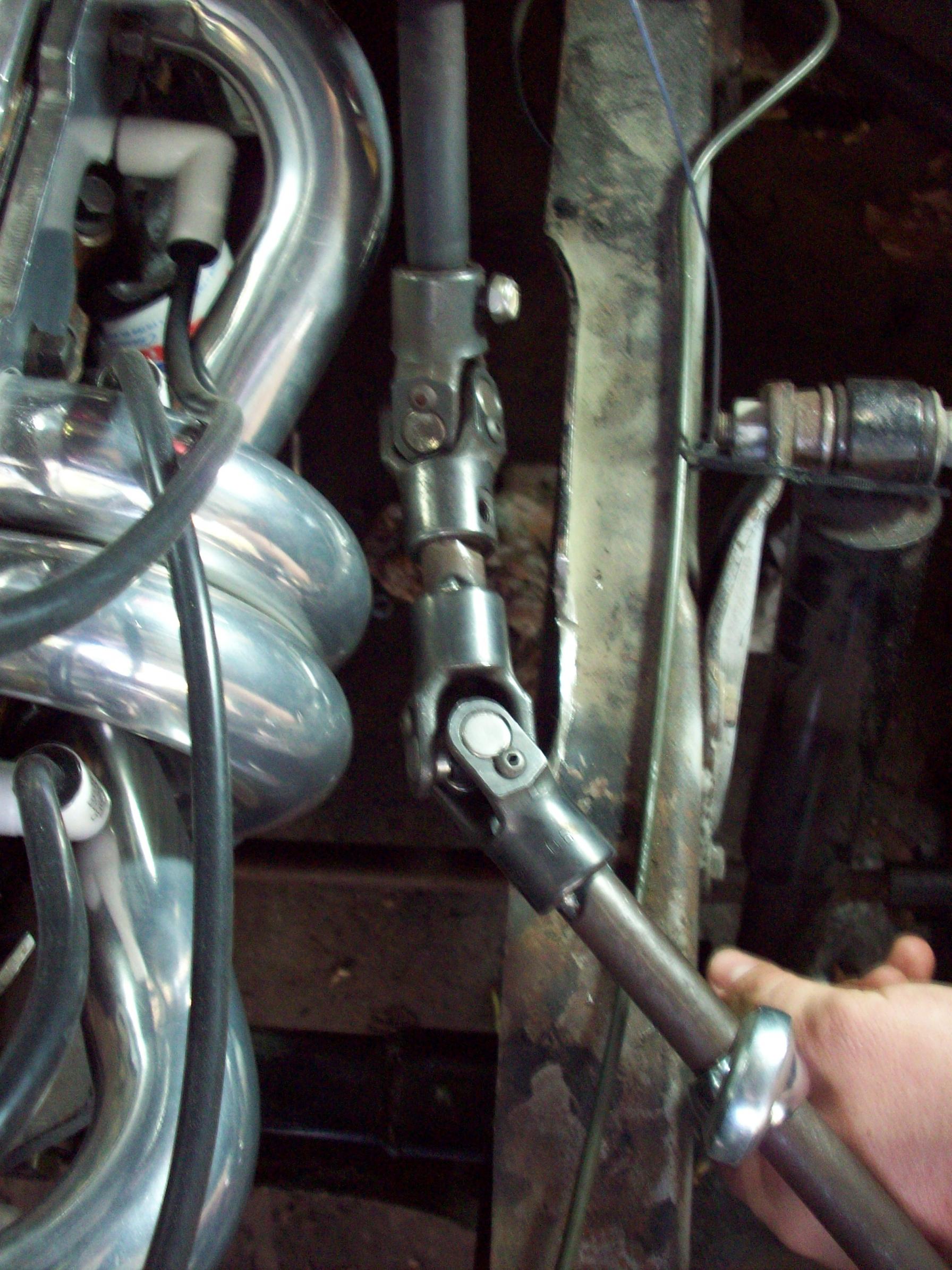

    Also, I also welded and tested out my steering linkage; I am happy with it.
    here are some pictures

    Well I installed the column the rest of the way and went through and got the plug wires a little closer to where I want them (I still have to do a little more, then cut and crimp them). I removed the ****** dipstick because the wire mesh pulled out of the end. They say you can't fix it and its basically garbage afterward.... what a bunch of lies, I got it fixed in about 10 minutes. The solution is 1 zip tie, wire cutters, and a small flathead screw driver. Finally I removed the rest of that hide-away tube, so I will begin to start ****oning down the wiring harness again. I think I will drop by a local speed shop to pick up a set of 2.5" to 2.5" header reducers for my exhaust so I can get the old setup off the floor and back on the truck. Hopefully I can get this running and around the block before November, which is my goal. I will post some pictures tomorrow.

    I decided to finish up the plug wires.. and boy what a tragedy those were. Took me 4 to 5 hours to get things cut to the right length and get them crimped and reinstalled...:eek: they were such a pain in my *** that i've satisfied my yearly quota of cursing in one night. The misses was on the other side of the house, upstairs, in a closed room and could hear me cussing up a storm. She helped me on one of the plug wires that were so stubborn that I needed two people to get it finished. Thank You Shannon!
    I learned a couple things that I'll p*** on. 1) use an enormous amount of dielectric grease (i'll post pictures on where to put it) 2) Then use more grease because the first amount you thought was enough isn't 3) my hands hurt 4) bend the tips of the clamps so they crimp down correctly.
    Here are the pictures:

    Here are some more pictures. The trick is to lather the wire about 3-4 inches up then put a huge glob on the end. THEN you have to get the boot and fill the end you are inserting the wire through with about 1/4 of an inch of grease, then pray the God of Speed is going to be nice to you today. Again, my hands hurt.

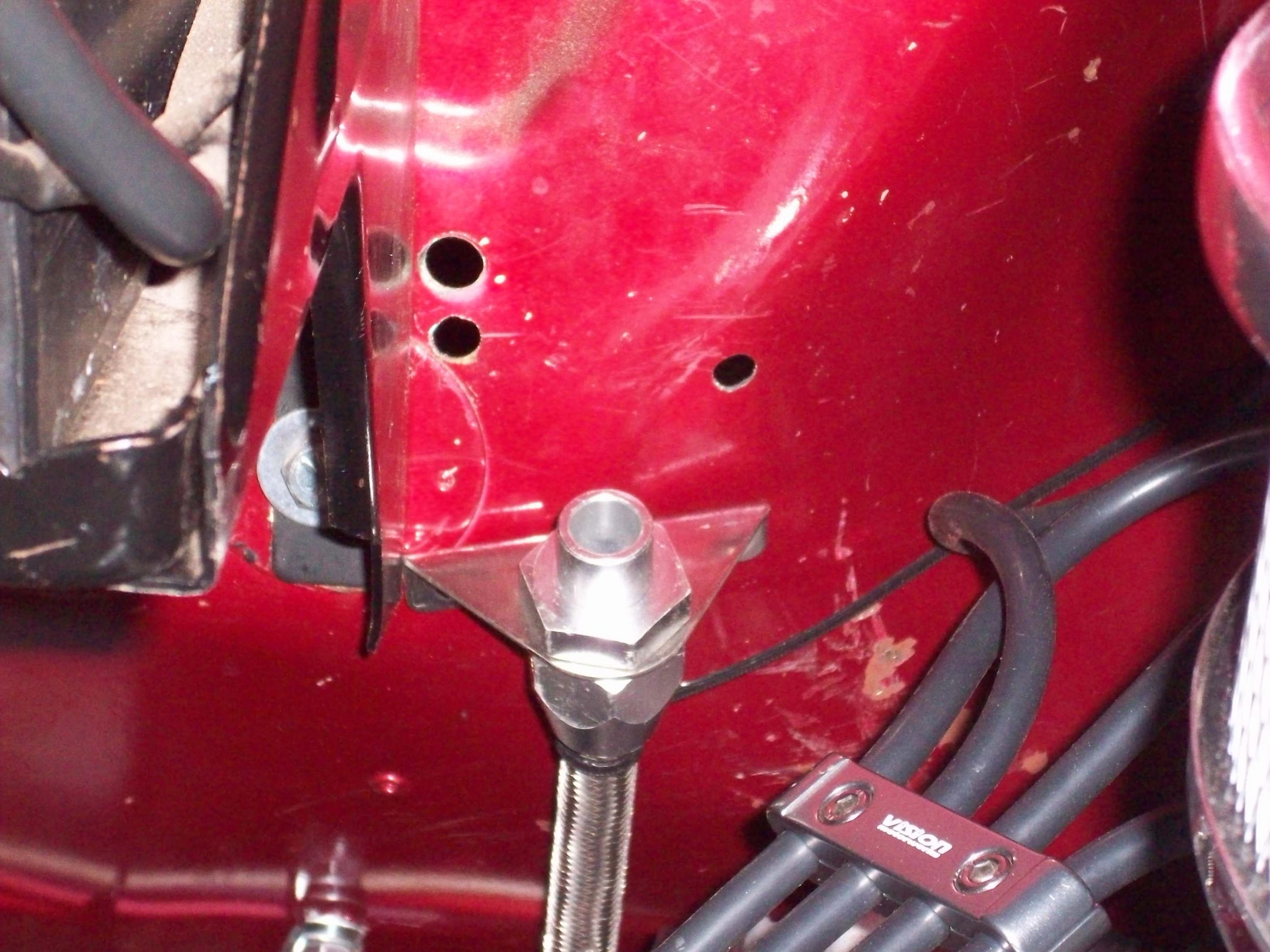

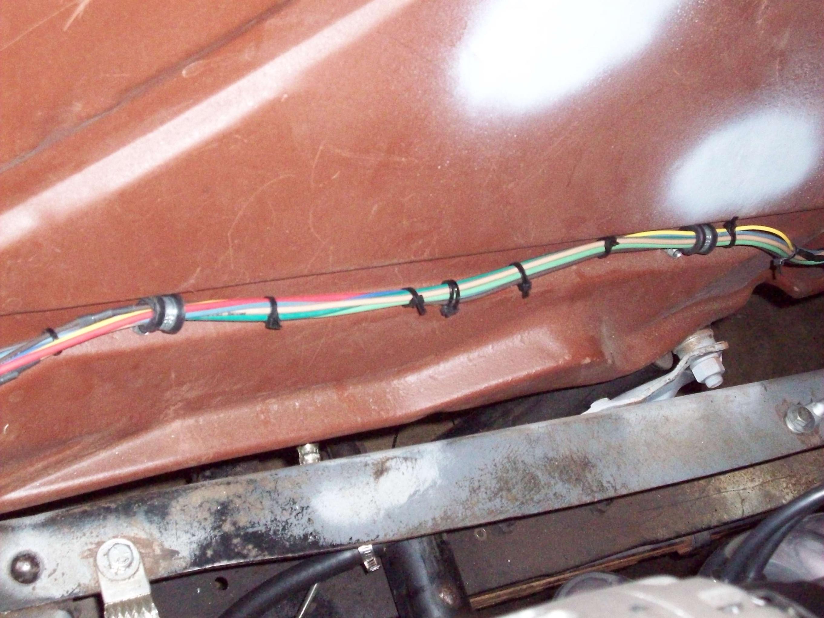

    I went through and started ****oning down the wiring harness to the firewall and the inner fender. I also reinstalled my ****** dipstick and am in the process of making new mounting holes for it. More pictures to come as I am only taking a break today.

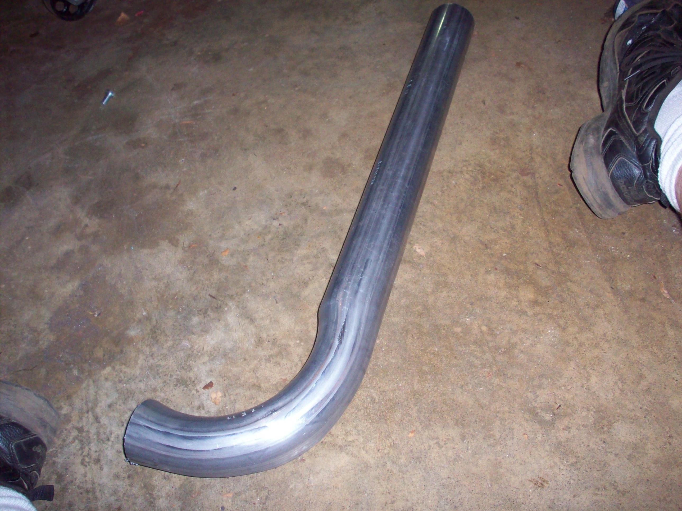

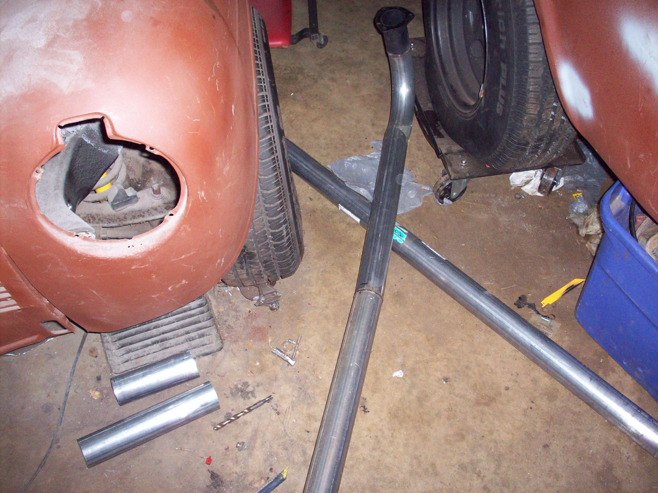

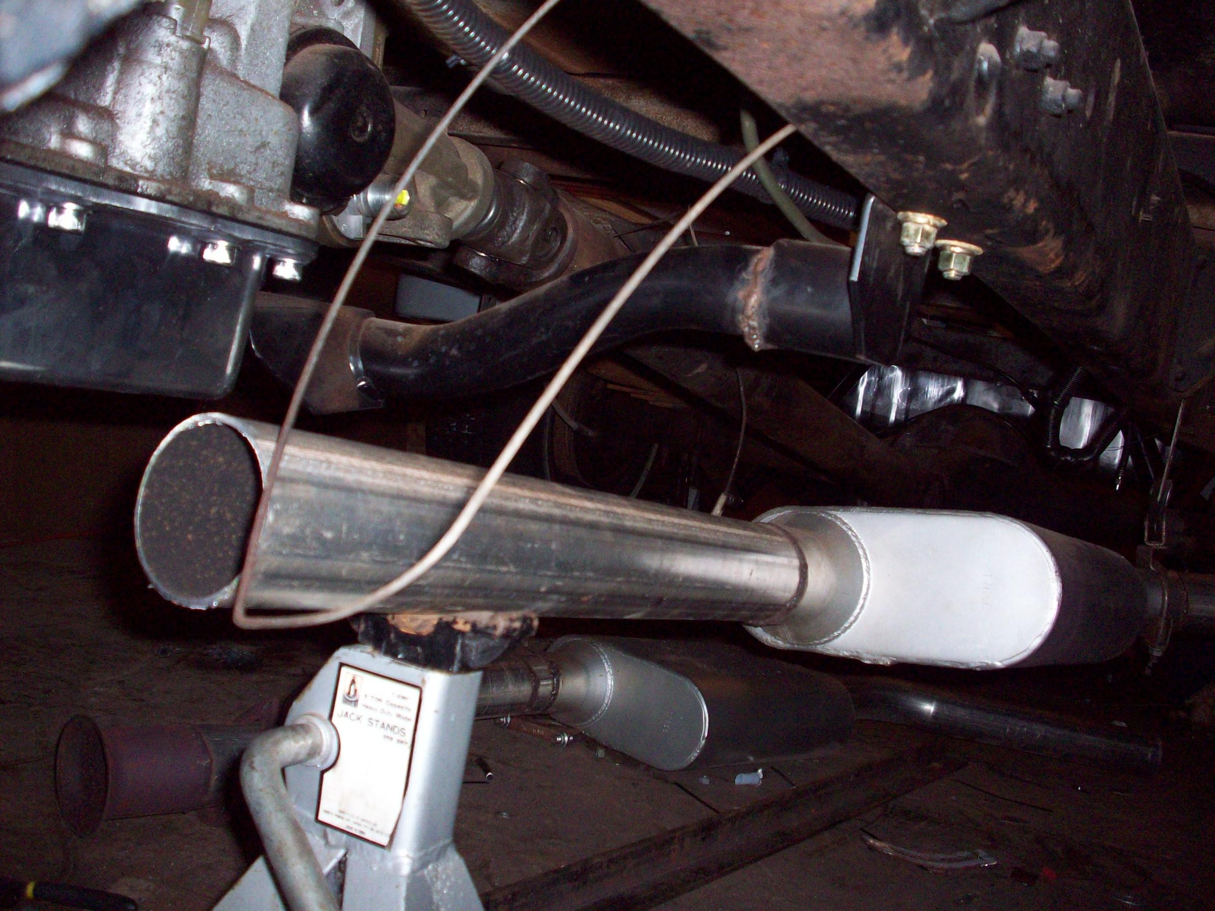

    I just now finished tonight the exhaust AGAIN... I bought a 10 foot section of aluminized exhaust and had a local shop bend it on the ends to 90 degrees. Since the guy who owns the place has a '56 chevy with a 454 in it sitting in front of the shop we started talking about cars and he just told me all of the bending would be free and to just let him know if I needed anything else. Cool guy; he was just happy that a younger kid was into old cars.

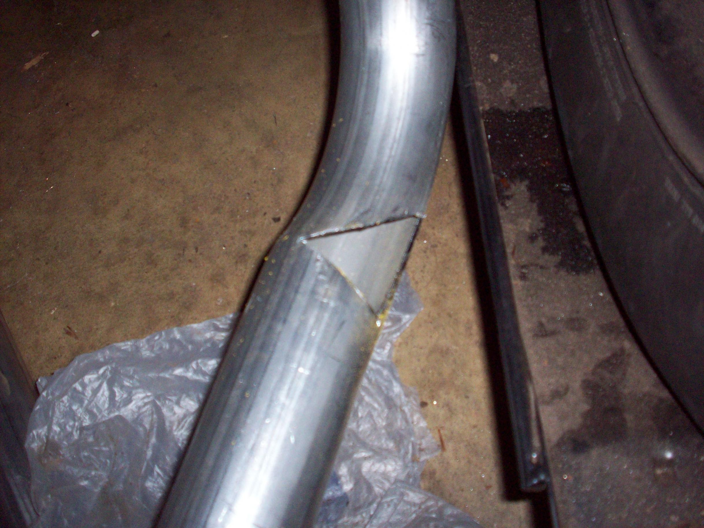

    Here are some pictures of my 6 hour day. The exhaust piping was dented pretty badly so I had to cut a trianle out, straighten it out and weld it back on, which was a lot of work. The drivers side was easy, mainly because I had room to work. Enjoy!
  30. 1959apache
    Joined: Nov 22, 2009
    Posts: 2,635
    1959apache
    Here are some pictures of the piece I had to cut out, straighten, and weld back on. Here is also why the p***enger side was a little harder to do. Here are a couple shots of the right side all welded up and ready to reinstall.
